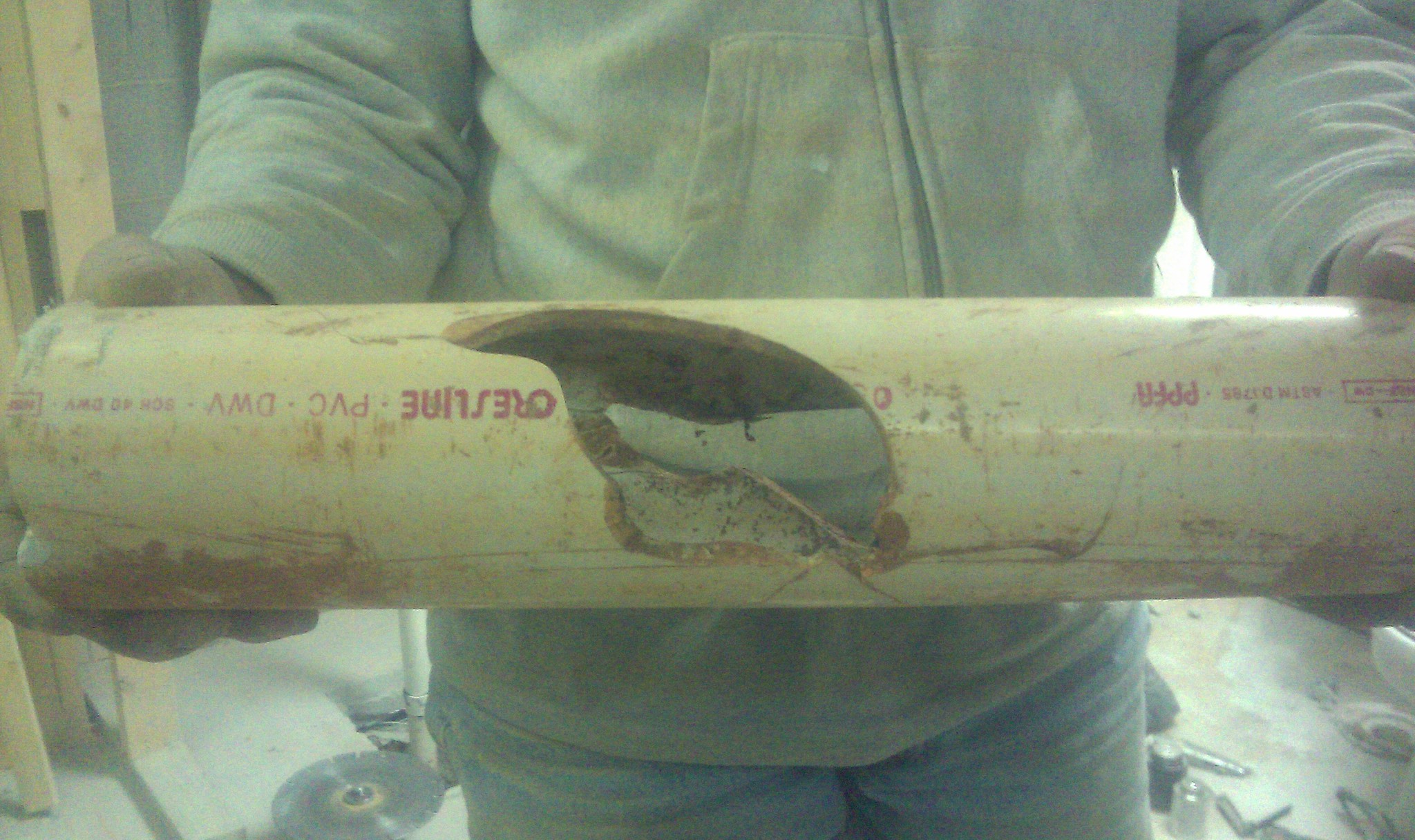

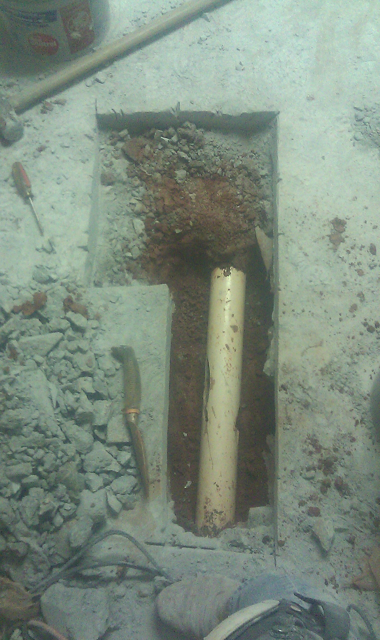

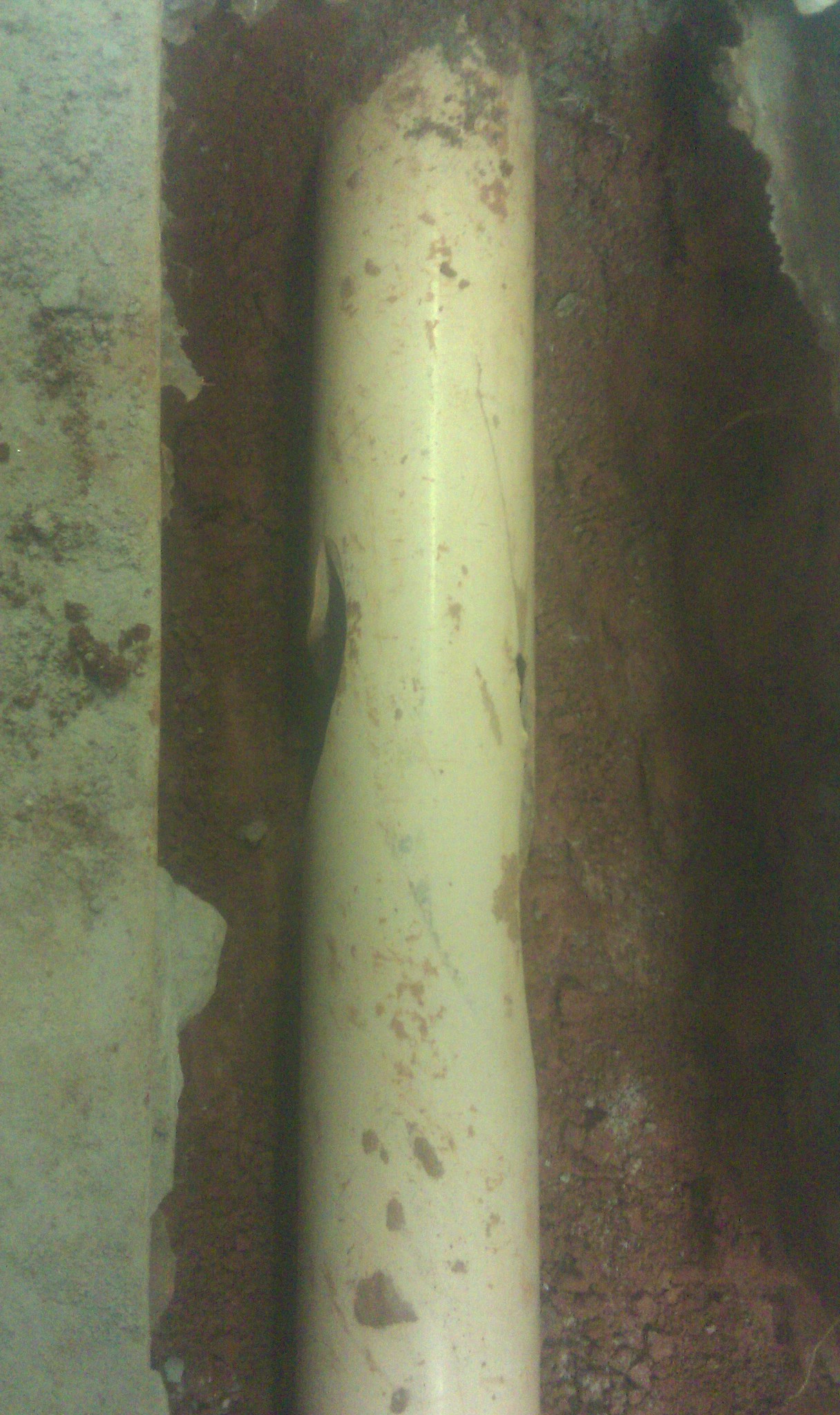

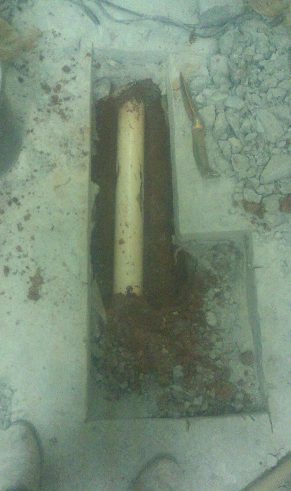

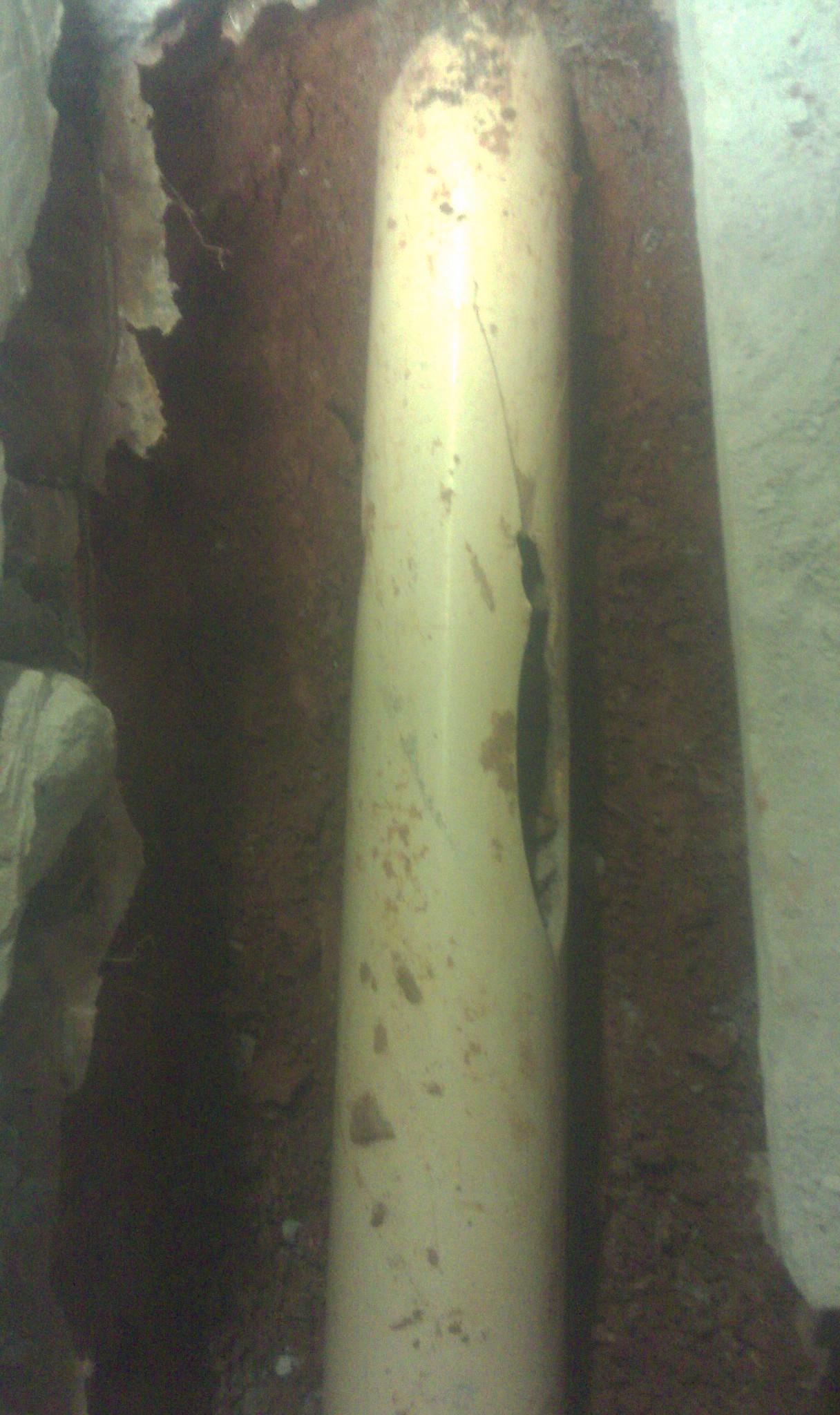

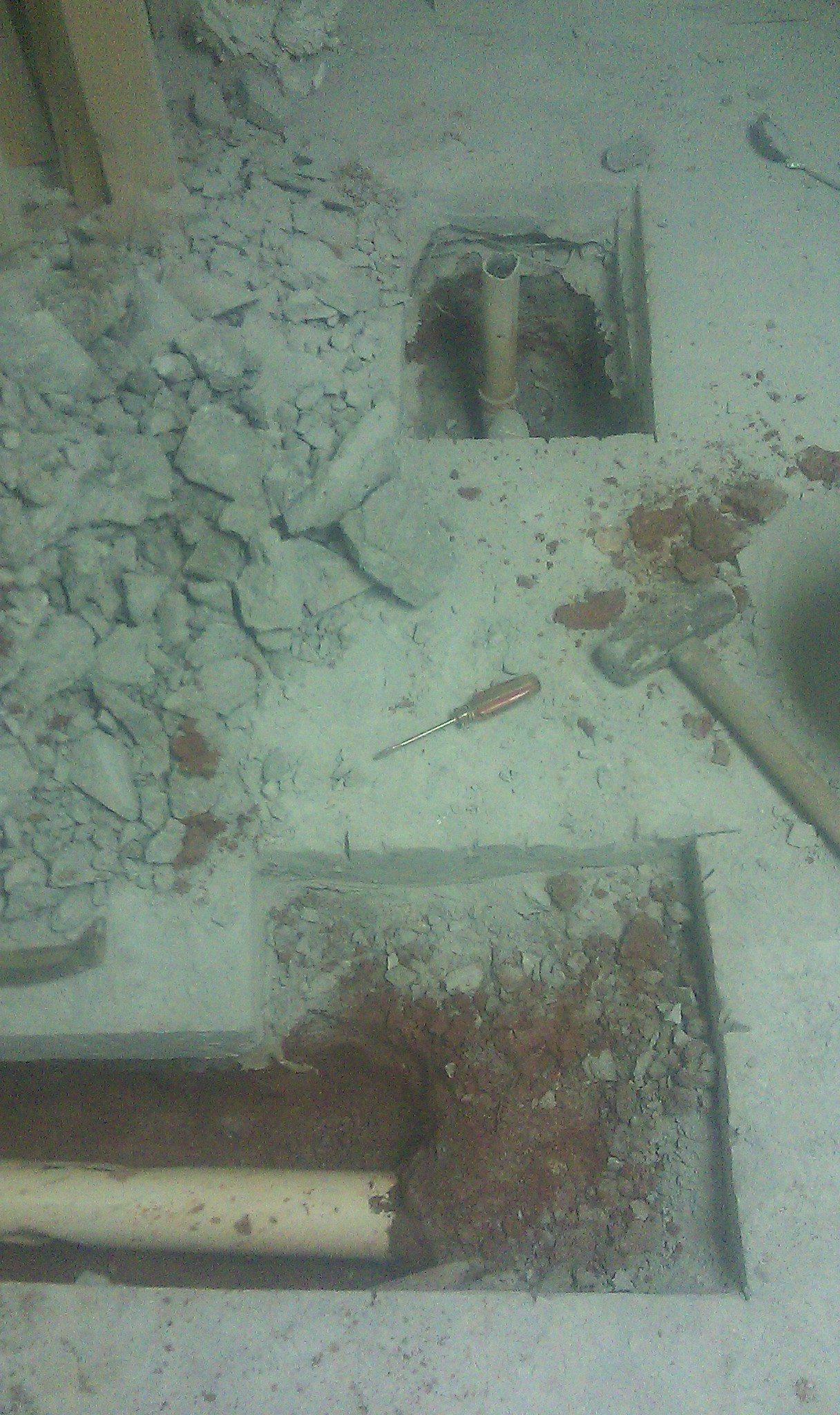

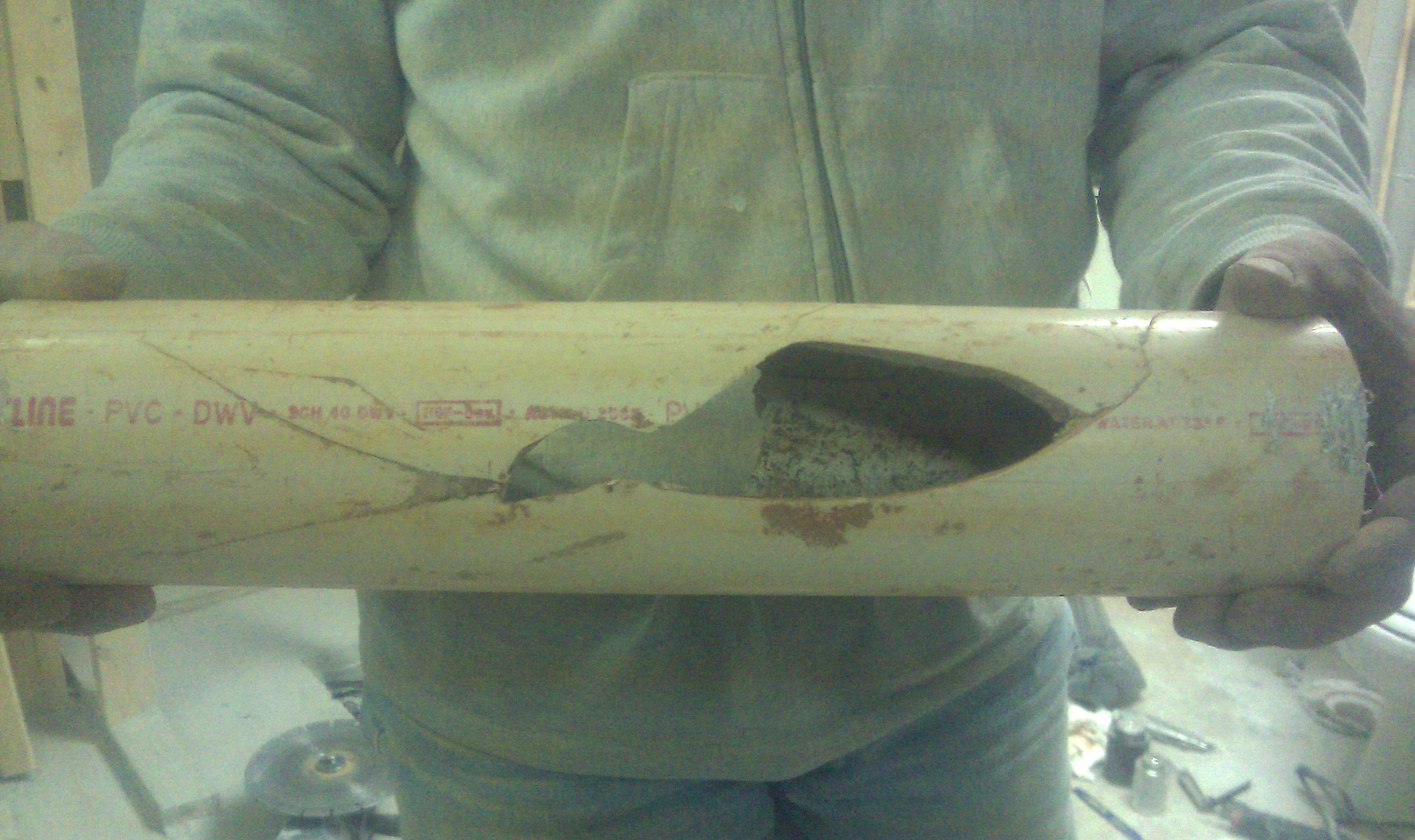

We bought this place about a year ago and I'm finishing the basement.
What would have caused this PVC pipe to break like this?
I think someone got wild with a drain auger.
I'm glad I found this before the basement was finished.

I think it was broken the day it was put in. Did you find any broken pieces? Looks like it was caught with a backhoe tooth.

I can't tell you what caused it, but what made you look for it? It to me looks like it was punctured from one side and through the other, but you would think the pipe would be indented on the punctured side?

I found a couple small pieces, but it looks to have mark coming from inside out.

When the main line to the septic tank got plugged a bit seeped up through a void in the concrete floor.

Very good catch! Hard to imagine schedule 40 shattering like that. How about a teenager throwing a cherrybomb in the toilet trick.
/ What Caused This?????????? #9
My bet is that it was broke when put in and just covered up. People through this stuff around like it will not break. It does, especially when really cold.
/ What Caused This?????????? #10
Any chance water froze in it at some point? Or there were rocks underneath it at that point and sand elsewhere? I would say it was broken when put in --or shortly after when the floor was poured -- pretty hard to do that after with even a power drain auger:eek:
/ What Caused This?????????? #12
Was broken since new / since before slab was poured or froze. Not gonna break buried sch 40 with an auger.

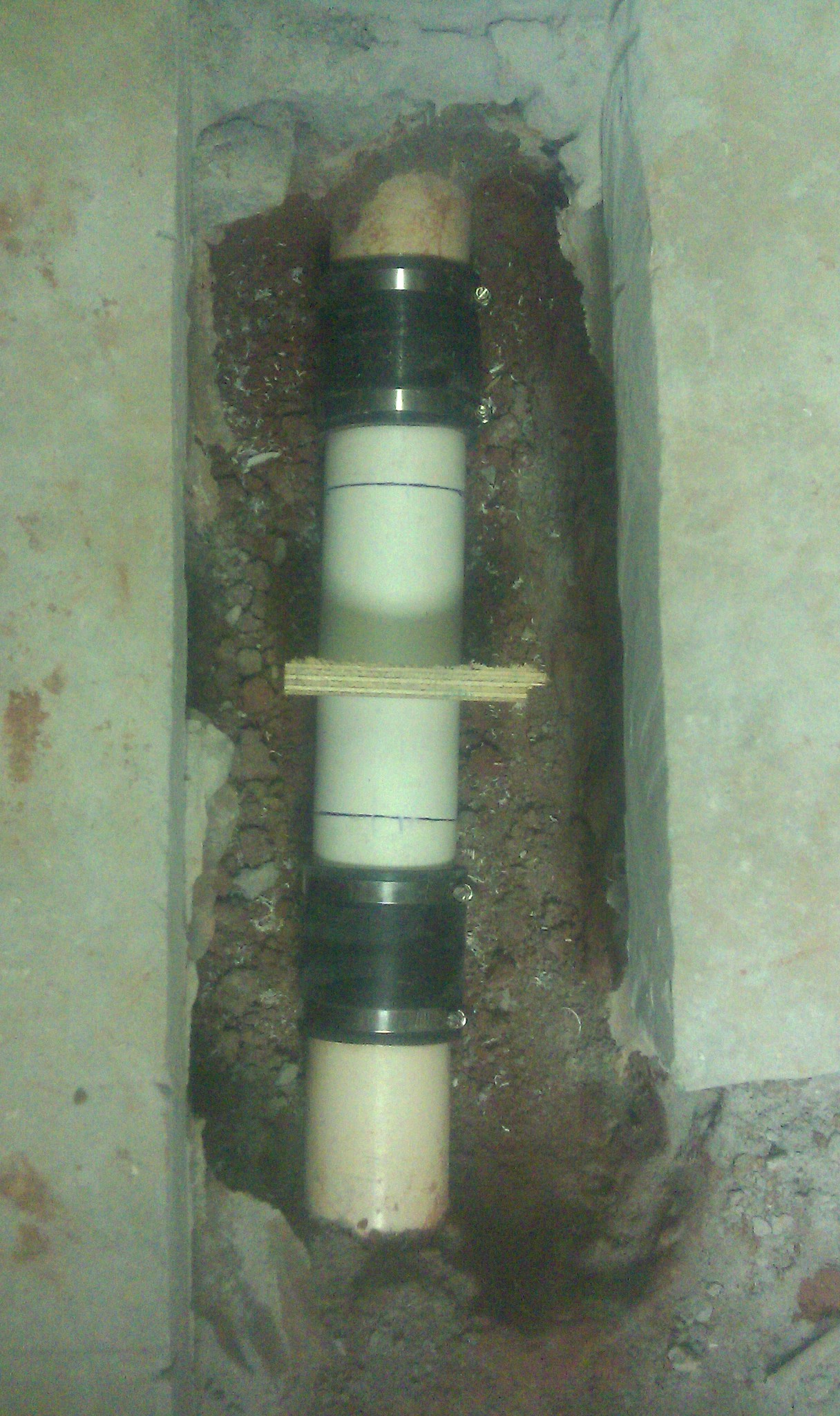

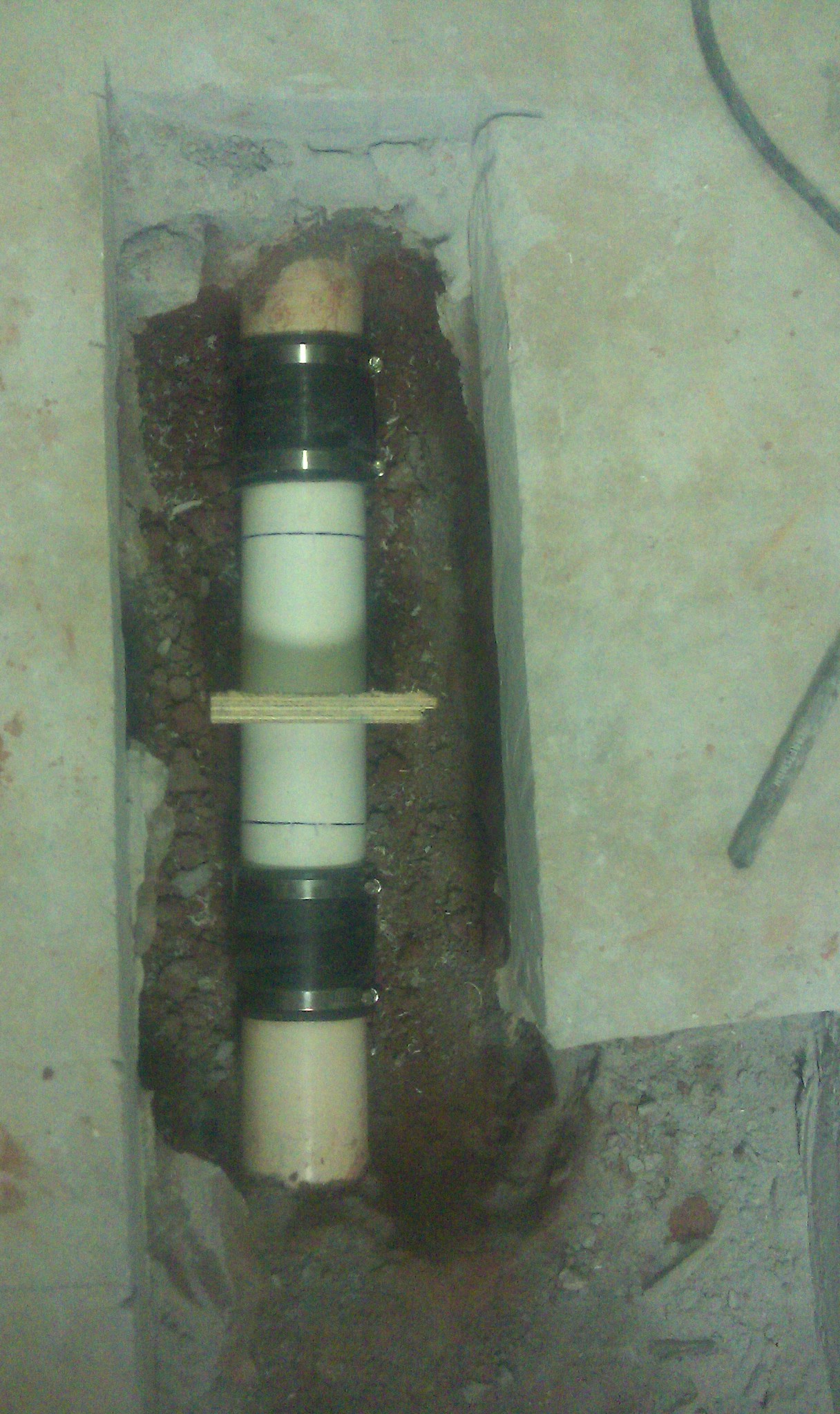

Thanks for the pics of the problem and the repair.
Sure looks a tough job getting to the problem.
I'm not familiar with the part/s used in the repair (I'm in Australia) - looks to be a piece of hose clamped on each end but what are the pieces in between, in particular the flat thing in the middle?

To me, it looks like it got snagged with a backhoe tooth, also. That's a pretty big chunk.
/ What Caused This?????????? #19
It is amazing what a contractor will cover up to avoid a minor cost that may cost the owner several hundred later to fix. My previous home had a sewer line that stopped up occassionally for several years, usually at the worst time. Finally I had a plumber run a camera down it and find the culprit. The power company had hit it with a ditchwitch and knocked a small hole in it which they just covered with a piece of plastic oil can. This kept the dirt out but allowed roots to grow into the pipe which would eventually stop it from flowing. A quick rotorooter and it was back going again but was a pain to keep doing about once a year. They knew they had damaged it, and just covered their mistake. Same thing happened with my UG power cables to the same house. It was a vacant lot on one side and while I was living in Canada, they built a house and the power company came in with their ditchwitch and trenched for his cable to connect up at the same junction box. Being too lazy to hand dig around the J box, they just started trenching too far back and knocked all the insulation off one of my 2/0 main feed cables which allowed the current to drain into the ground. I had 110V power but when I turned on the range, all the lights would dim. I had a little trouble convincing the builder of the house next door to replace over 200 feet of 2/0 cable but when I produced the chewed off portion, he agreed to fix it for free. I still had to pay the power company $100 for renting a temp. cable for a month before the builder could get it fixed. This was a $2000 repair that I came close to having to eat.
