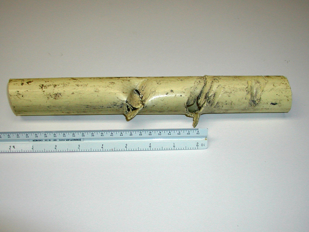

We bought this place about a year ago and I'm finishing the basement.
What would have caused this PVC pipe to break like this?
I think someone got wild with a drain auger.
I'm glad I found this before the basement was finished.
Could be that this particular PVC stick sat around in an outdoor materials yard for months before in was installed at your place. That white PVC will get brittle and crack like yours did. I've seen that happen with left over white PVC that I stored outdoors after installing my landscape irrigation system. Thing is even if you buy white PVC from an indoor materials yard, you still don't know where it was stored and how long between the manufacturer's place and your PVC dealer's.

I would guess that somebody ran over the exposed pipe with a skid-steer loader when they were spreading the stones.
/ What Caused This?????????? #33
I think your getting closer to what happened.
I've been in the building industry for 23yrs.
What I "think" happened, and none of us are 100% sure, right.
Sometime they use what is called a georgia buggy to haul concrete, for those that don't know what that is. It holds about as much as 3-4 wheel barrels on a tricycle type setup with about 10-12 hp engine powering it and you stand up on it and drive it like a bicycle. I don't think the pipe was exposed or broken when installed. I really think the pipe was just at the surface and georgia buggy or even more likely cause its heavier a skid steer with a bucket full of concrete crushed the pipe in the buzz of pouring, site noise and hurrying, it went un-noticed.
Just my opinion.
/ What Caused This?????????? #34
It is always possible that the pipe was not "broken" when installed, but could have had a "slap-crack" in it. This can happen when PVC is dropped on the ground and a 20' piece of 4" is not light.
Also, that is DWV. DWV, even though it is schedule 40, does not have to meet the same specs as schedule 40 PVC water pipe. DWV is not intended to hold pressure and is manufactured as such. That is why it is usually a bit cheaper then PVC.
If it had a "slap-crack" or a ding or dent, it could have held drain water just fine. Then, when someone was running a power snake though there, the head broke through the pipe at the weak spot.
If the pipe was "old" at the time it was installed, it would have been that much more brittle. DWV is not UV protected and sunlight will dry out the plastic to a very brittle point.
