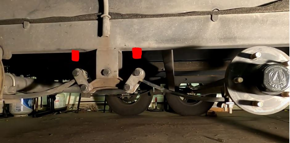

No they can't flip. I made the bump stops about 36 years ago to stop the equalizer from going high enough to let the shackle flip.
They are mounted to the frame above the spring eye, like the red blocks that I drew:
I don't own the trailer now, so found this picture on the www.

Trying to add the Moryde Wet Bolt kit to my 12k tandem axle trailer. I get under there to work and I discover this:
When I got done with the other side, it immediately swapped sides and did the same thing. I flipped it around twice, but it flopped over opposite each other every time.
Reviewing pics on the 'net shows that it's supposed to look like this:
iu
iu
What is causing this and what do I need to do to fix it. This probably accounts for why my trailer rides so crappy.
In the picture it appears that the mounting angle of the righthand axle is rotated counterclockwise leaving the spring eyes at an uneven level.
