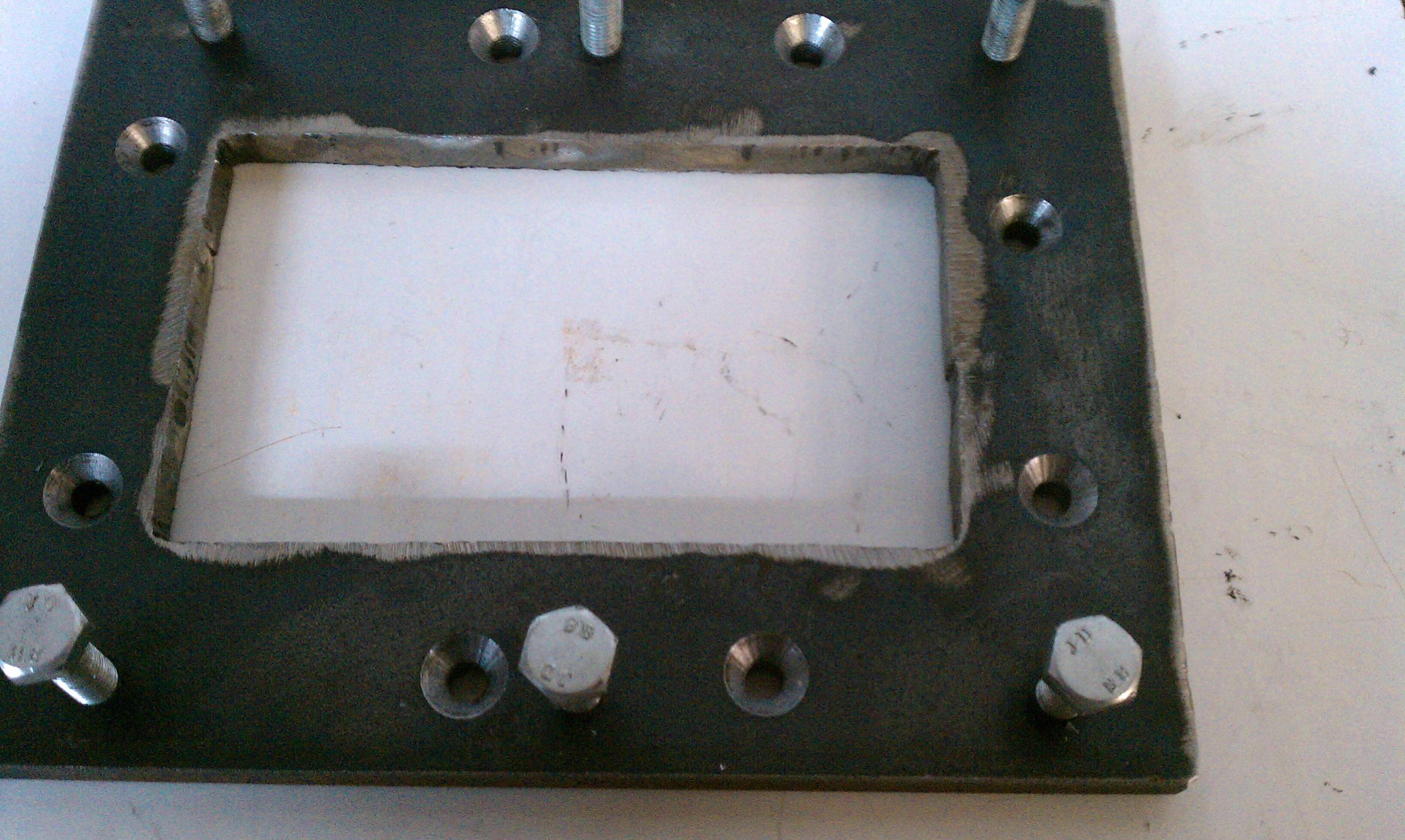

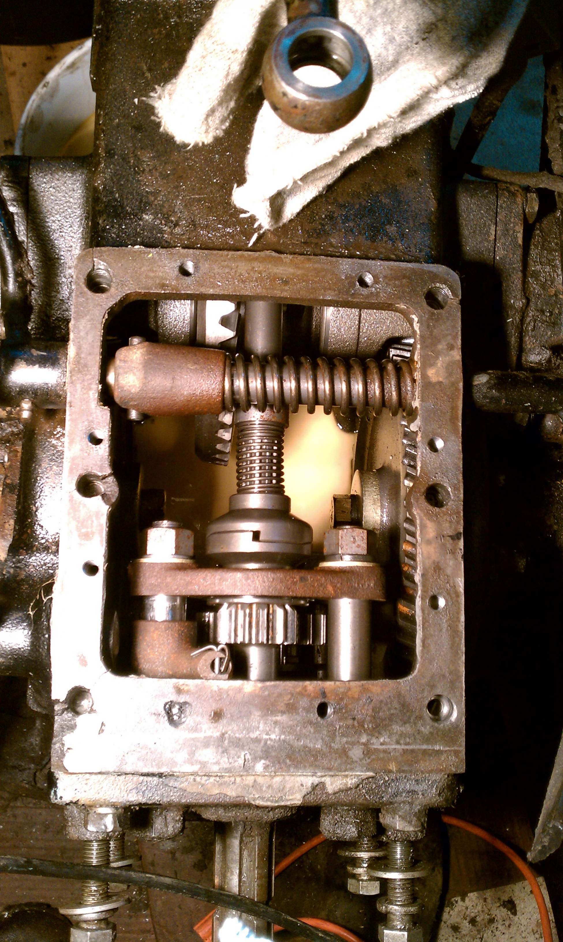

Well I hobbled it back together. I used a 1/2 steel plate, I drilled and tapped the 6 main mounting holes out to bolt the new housing to. Then I marked the meatier areas on the transmission housing and where i wanted to drill tap. I counter sank these corresponding holes on the adapter plate. It all worked great except the first hole I started to tap. The Chinese made tap broke off. But I went and got a better one, and the rest tapped great. I end up heating the broken tap up to bust it out. Any way its back together and works great so far. I forgot to get picture of finished product yet.

Well, I am impressed, if I ever start a company I would like to hire you.:thumbsup:
   / What could have broke this? 3 pt lift housing #35
Nice work, and a nice solution. Congratulations!
rScotty
   / What could have broke this? 3 pt lift housing #36
Nice work! Thanks for taking the time to take pictures and post all this info. Great fix!
   / What could have broke this? 3 pt lift housing #37
Great job!! Bet that won't break.
   / What could have broke this? 3 pt lift housing #38
Now that is fixing something and not replacing it.. Very nice work... most of todays techs just replace everything..Thus dont have the skill to fix something...
Id say after this its time for a hydro fluid change! Look at the milk in there!

Oh yeah. I have twice so far. its finally cleared up now. Also add some Seafoam additive to help dry the fluid.
