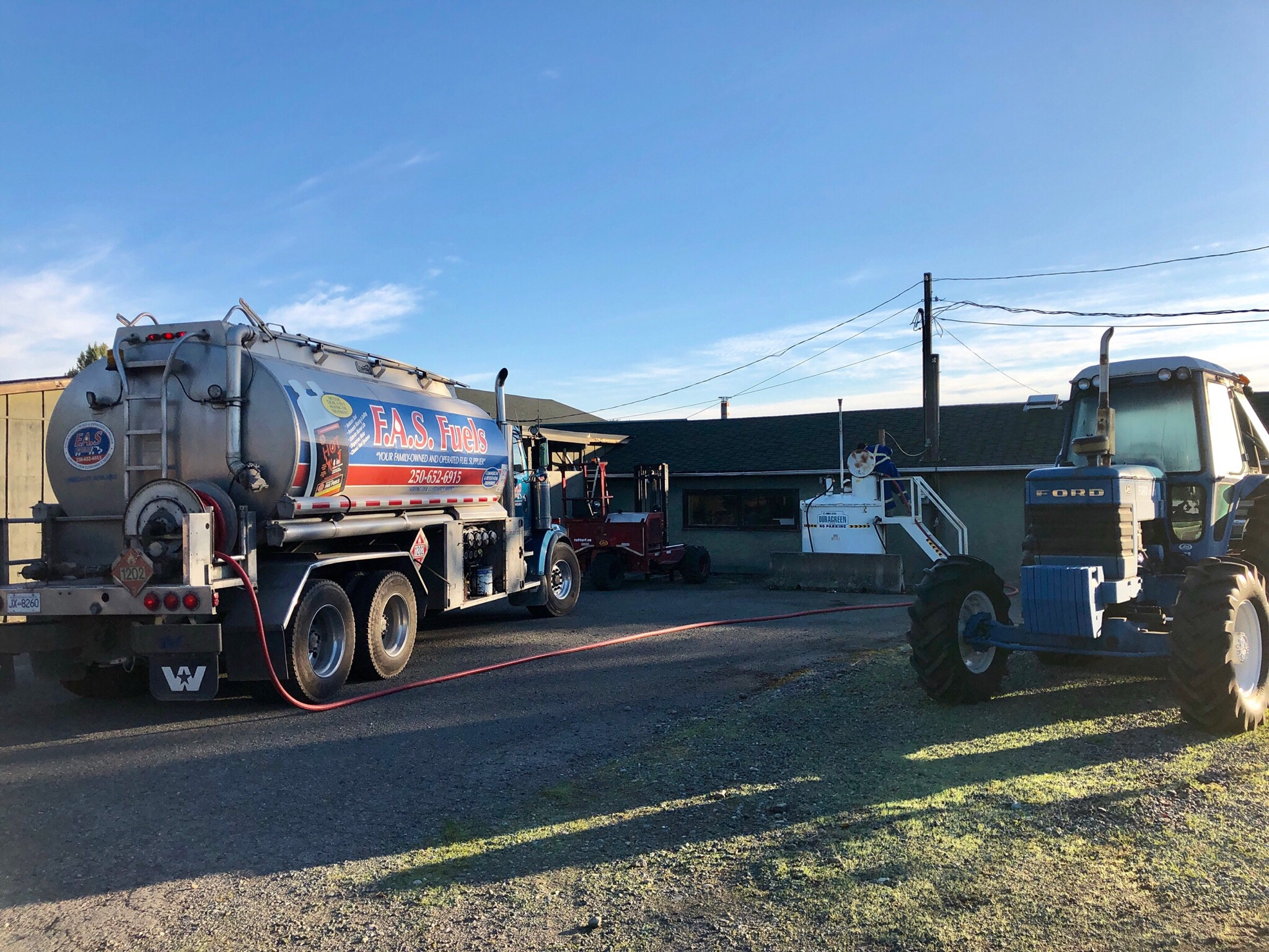

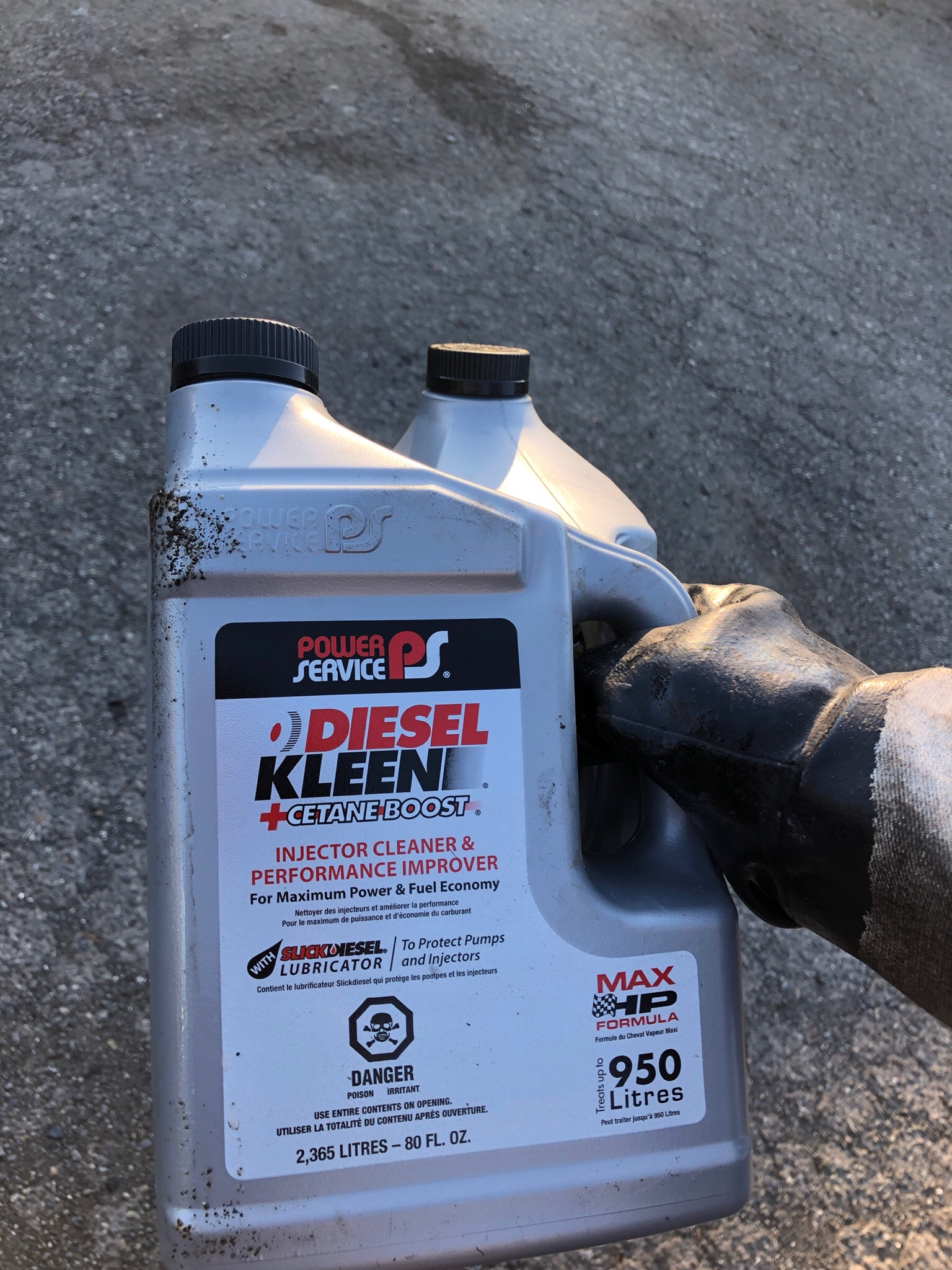

On the farm we had the bulk delivery driver add a jug of diesel fuel conditioner with each fill up. Done. Didn't have to think about it

Love the old Ford Terry!!!
   / What creates "bad diesel" fuel ? #28
Sadly gone, Richard.
No tractors , no trucks left in the yard
NONE ZERO NADA.
