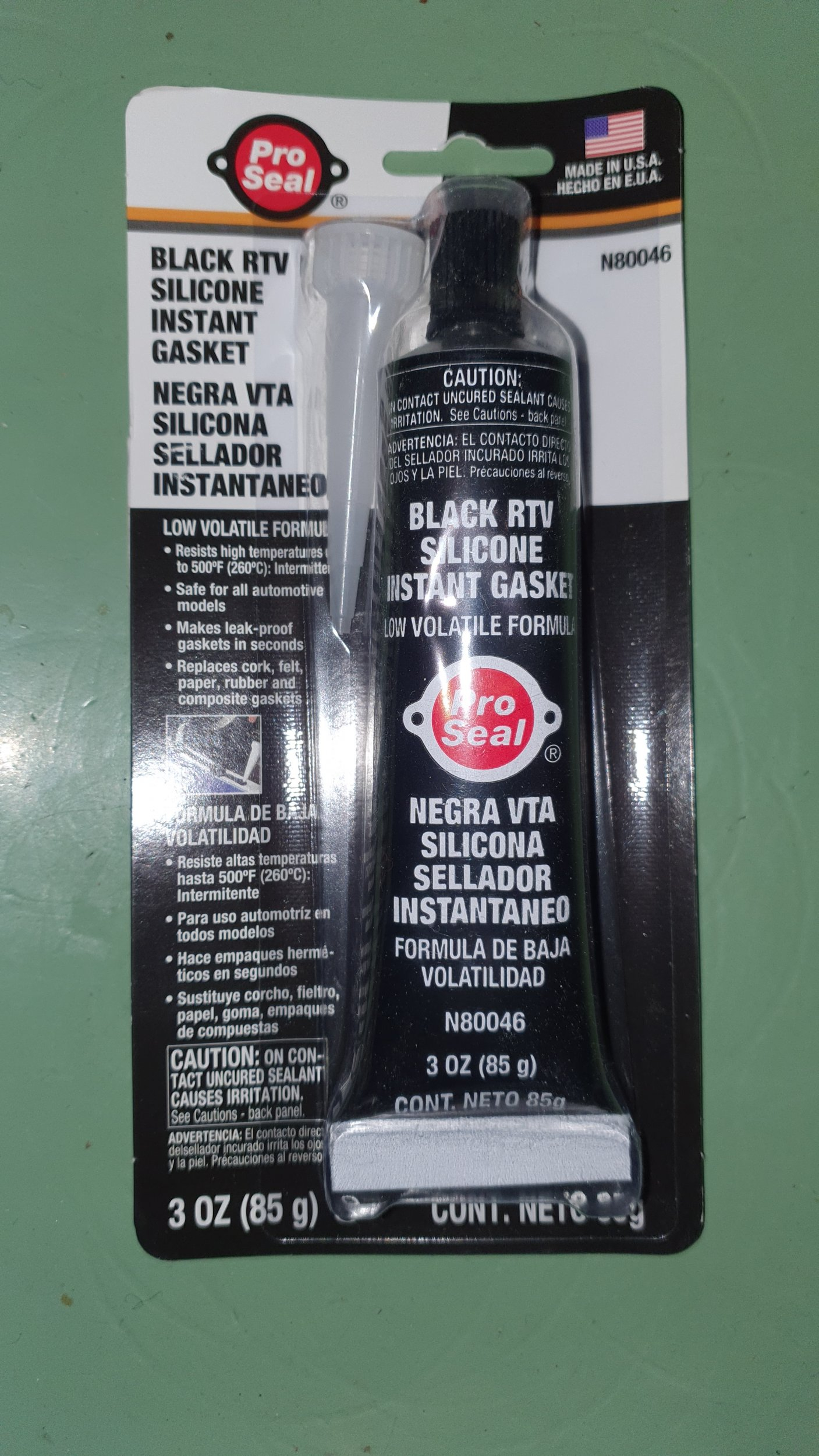

Is this product good? Found it on a local market for €5.5.
