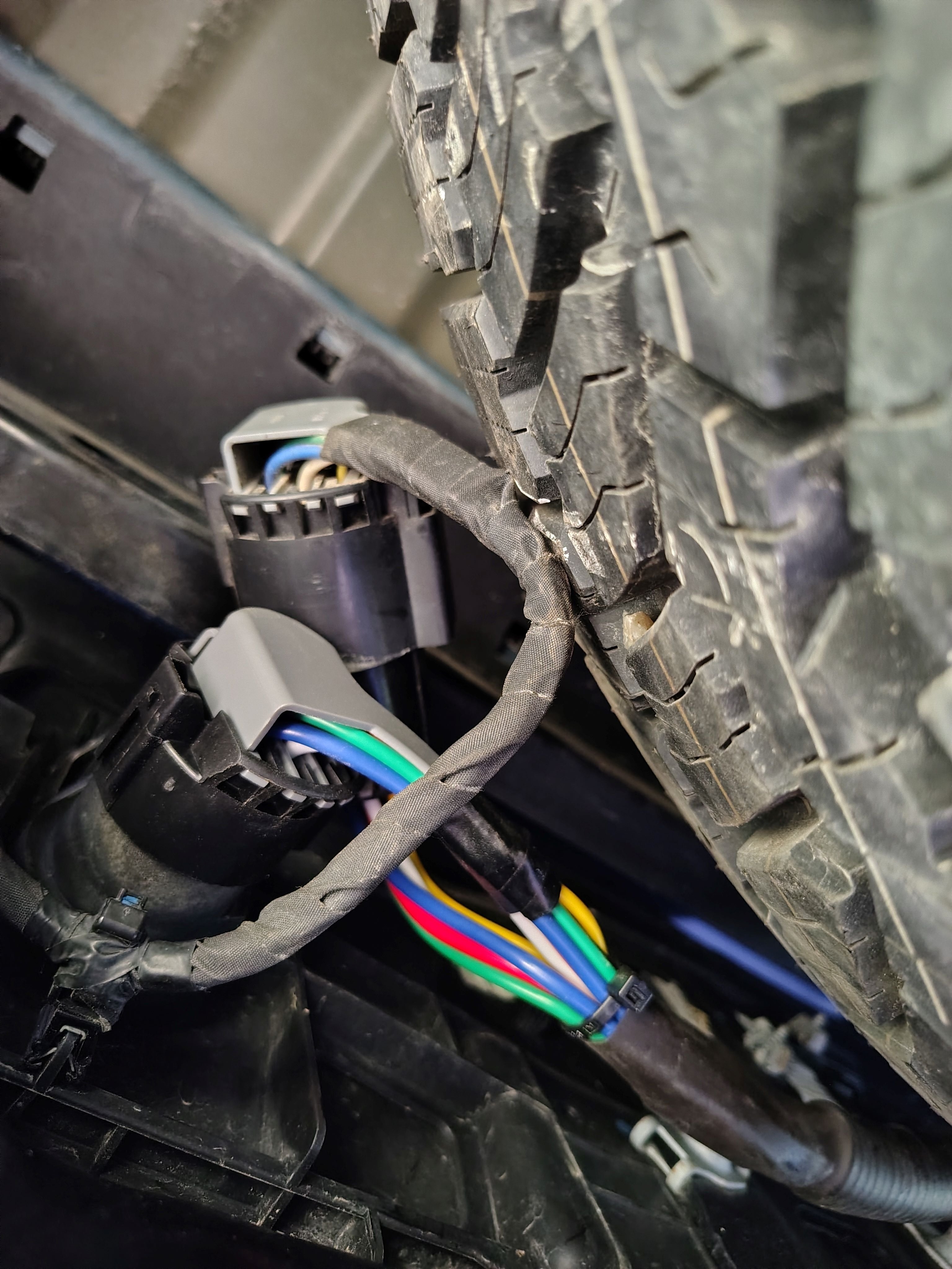

Interesting little purchase which ended up requiring another small project.
Bought a Setpower Fridge/Freezer to carry in the truck for trips and grocery shopping. I thought my fancy pickup had a DC power outlet in the bed along with the bed lighting, but no it didn't.
So I bought a wiring harness that was plug and play with the pickup, it's a 5th wheel harness that tee's into the bumper trailer harness and parallels it so the bed mounted trailer connector and the bumper one are both usable.
Then I've ordered a power outlet to 7 pin adapter.
plug harness at the bumper,

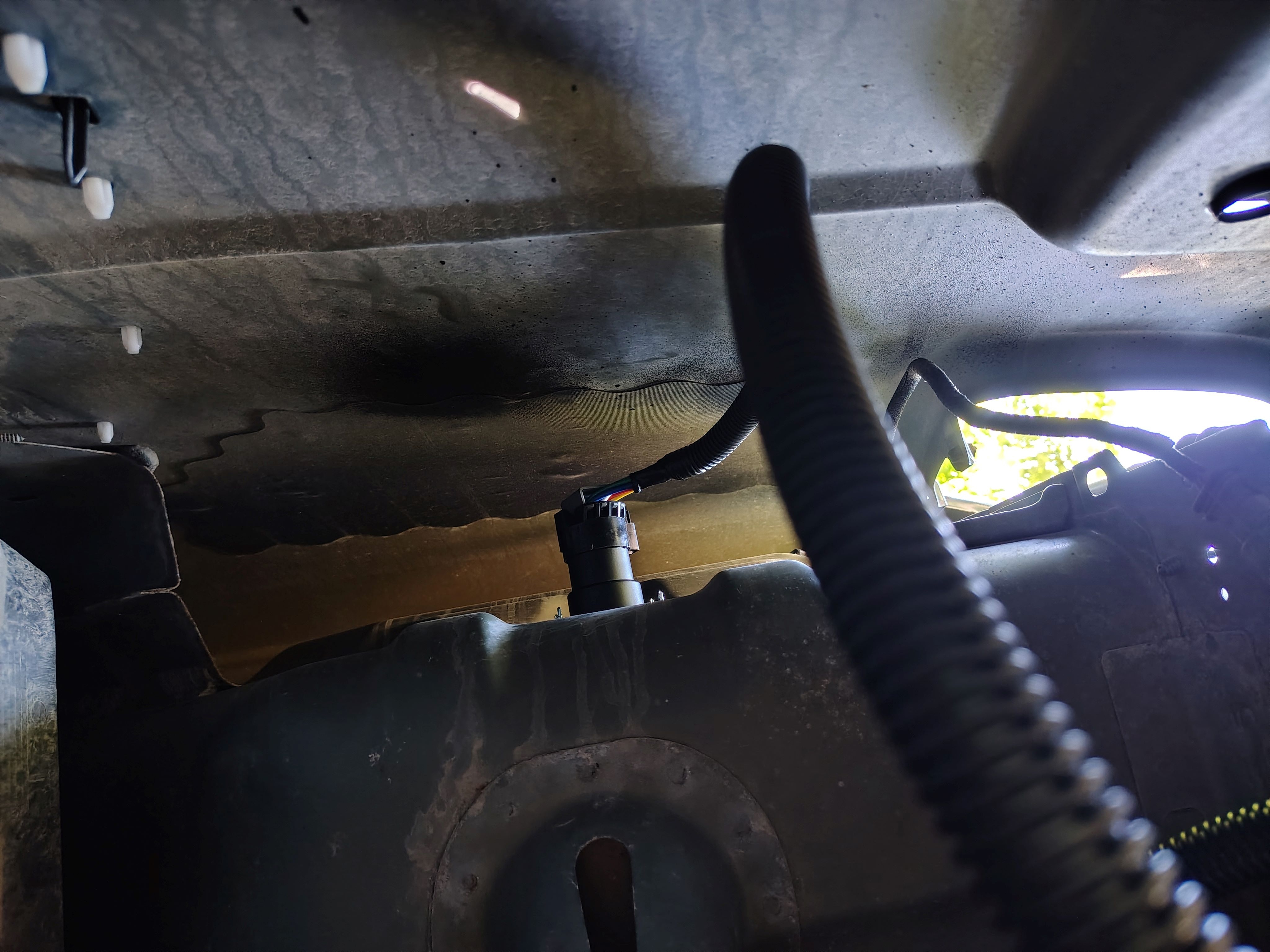

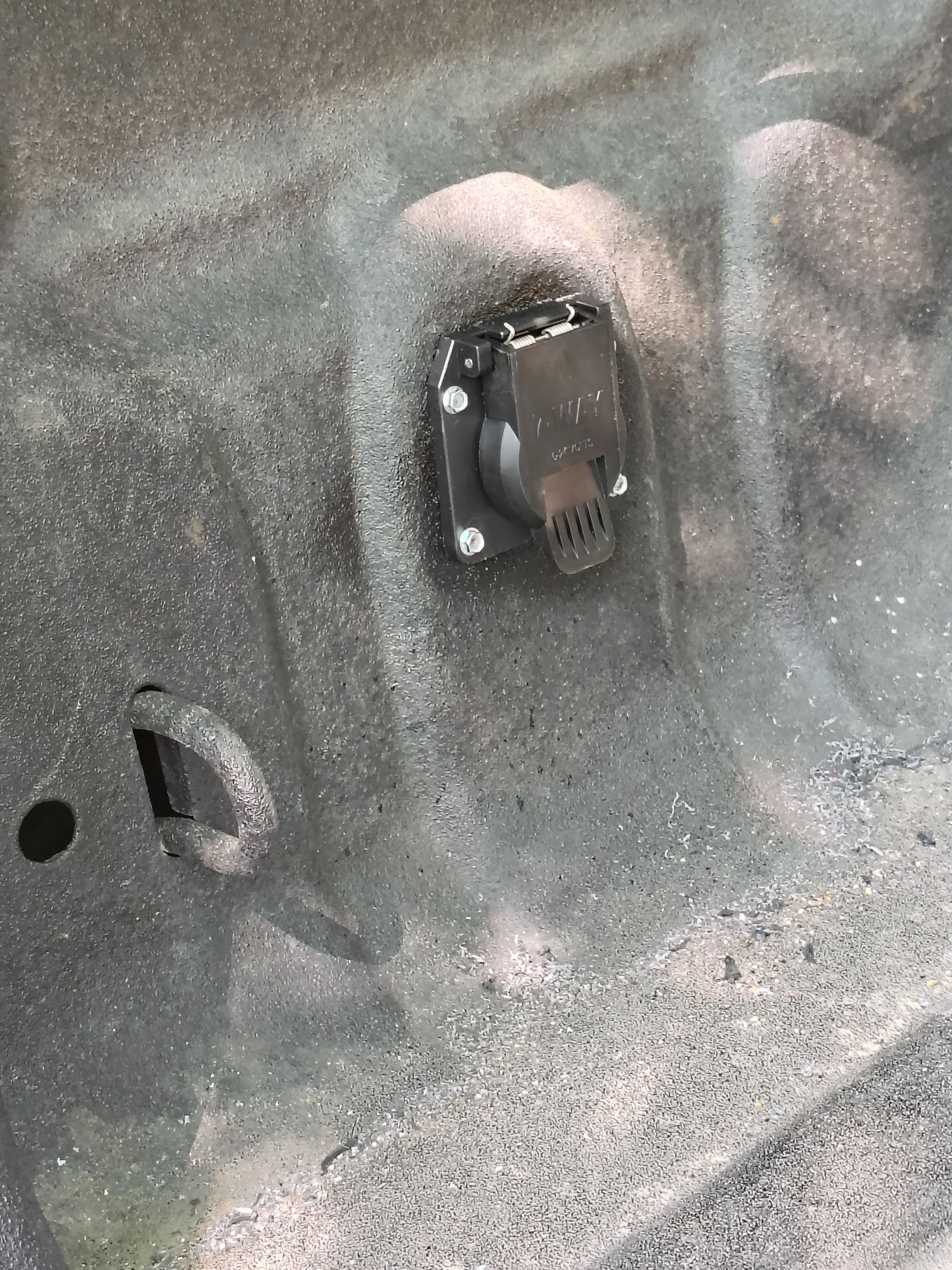

Had to bore a 2" hole in the inside of the bed for the 7 pin connector and then route the harness up to it and plug it in. It was a long reach up in between the inner bed and fender area to plug in the connector.
Installed connector in the truck bed ready to go,

Nice job, very clean!!!! LouNY👍🏻

Looks really well integrated.
Does the adapter have a fuse?
   / What did you buy this week? #2,310
I don't believe so, the fridge/freezer has it's own protection. It's a SetPower DT45. The power feed on the 7 pin has a 40 amp fuse in the trucks fuse block.
