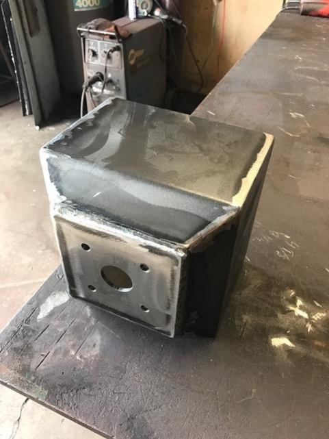

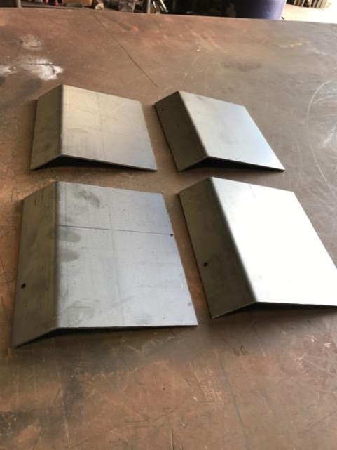

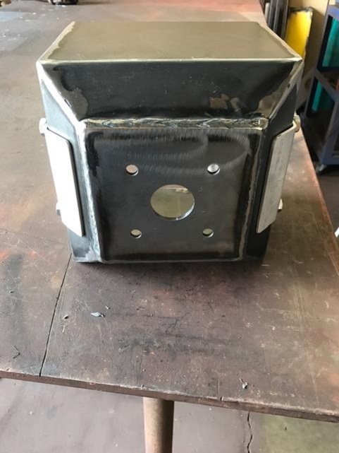

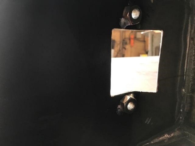

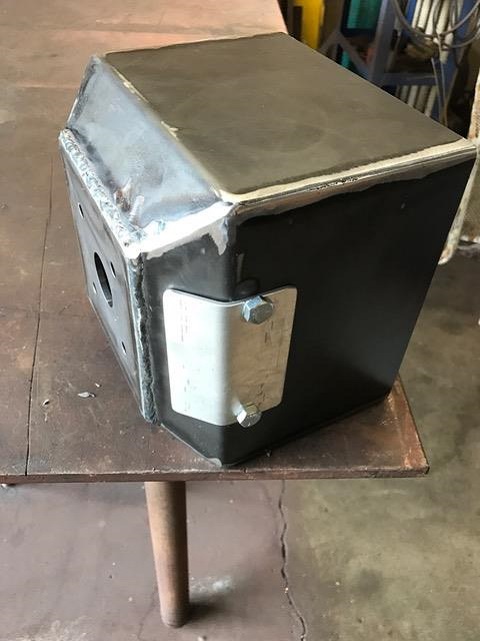

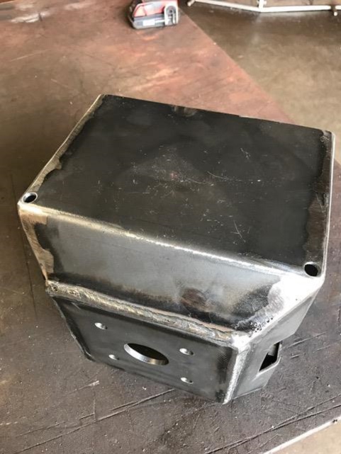

When installing the chain guards on the bush hog I remembered I tore the plastic shield off the gearbox so decided to make a new one out of steel. Found some scrap sheet metal with a bend and made it work. Had to cut a hole in each side to access the PTO shaft bolt and made some covers for the holes out of aluminum & welded nuts on the inside for the bolts. Drilled a couple holes in the bottom for water to get out incase it's on an angle when I unhook it. I took the PTO shaft with the clutch off and put it in the shop since I knew it wouldn't be getting used, no shed space for the bush hog in a shed and don't want the clutch & shaft to sit out in the weather all year. It's off to powdercoat now.

It's off to powdercoat now.<<<<<Why the powder and whats cost?
Powdercoat is very durable, it holds up well outside (the bush hog sits outside) and it looks great! The cost shouldn't be that bad but I couldn't tell you what it cost, I haven't paid for anything to be powdercaoted in years. The man who owns the company and me are pretty tight, he needs welding done he gets welding done, I need painting done he gets painting done :) He also borrowed my skidsteer once (for 5 months) lol.
