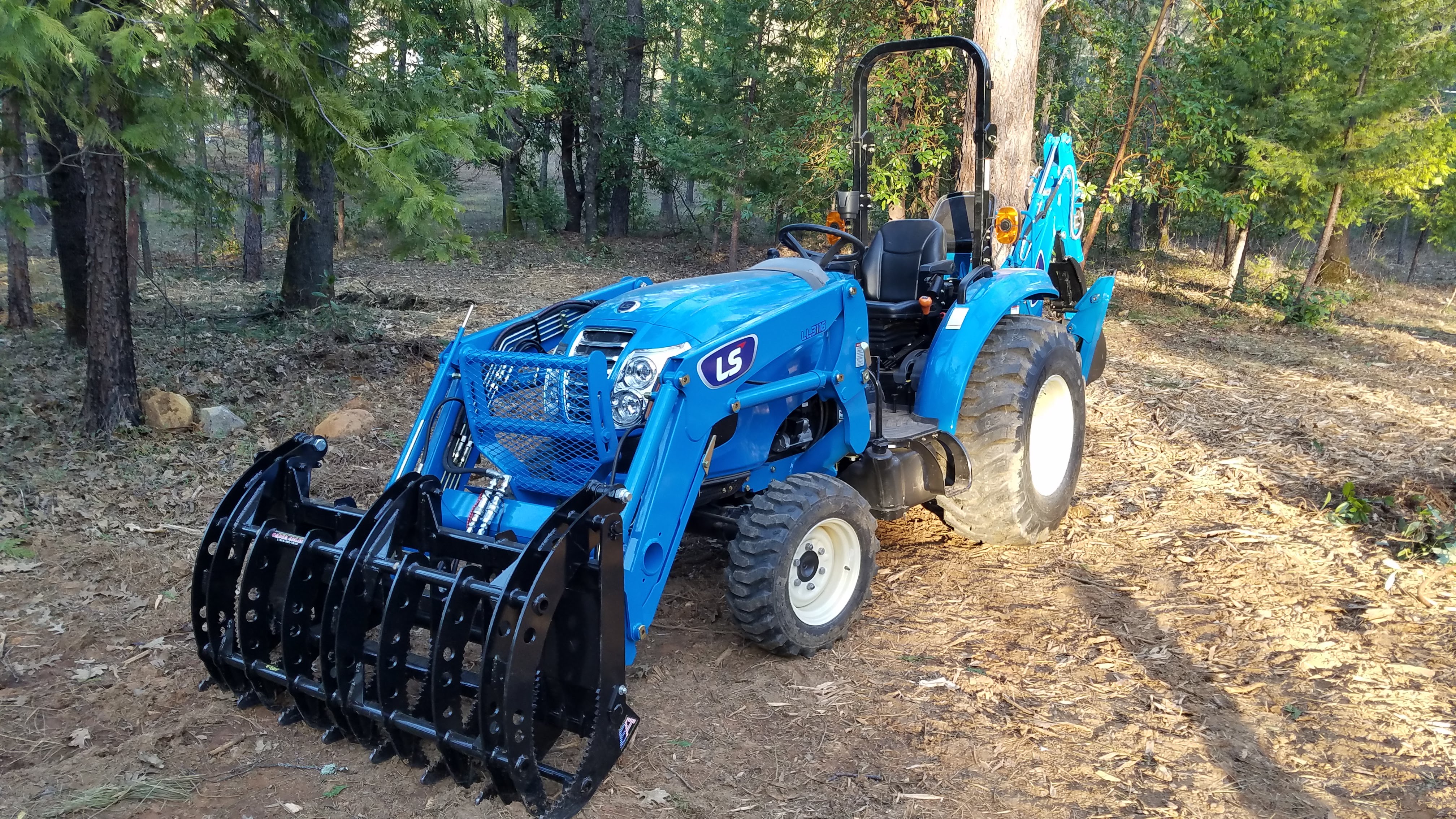

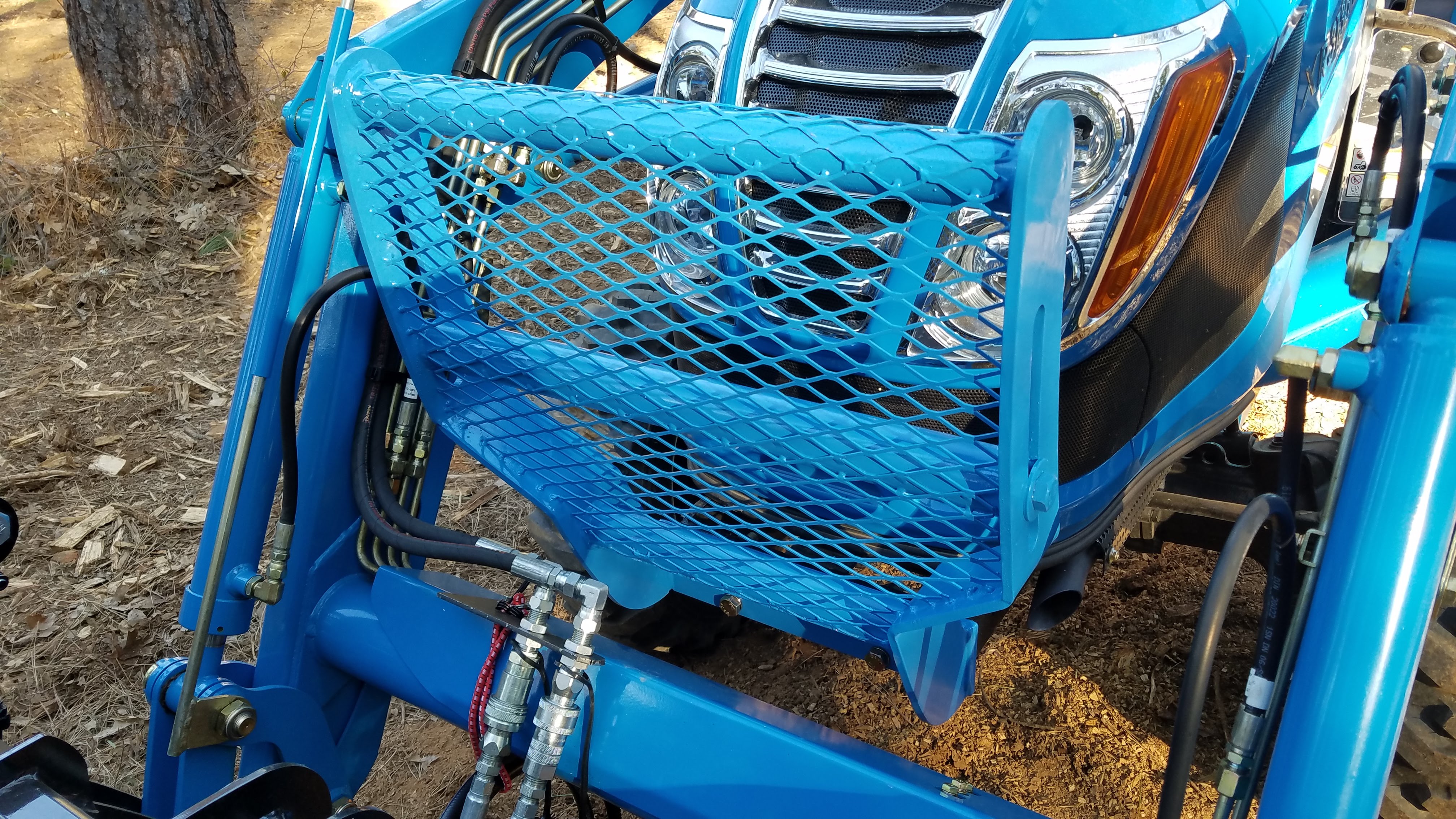

Got the grill guard upgraded to hopefully keep the LS from getting a black eye.

Yeah, there's PSW in the go-juice. Ran fine after that first few seconds.
I've been planning on some stainless steel expanded metal so I don't have to paint it.
