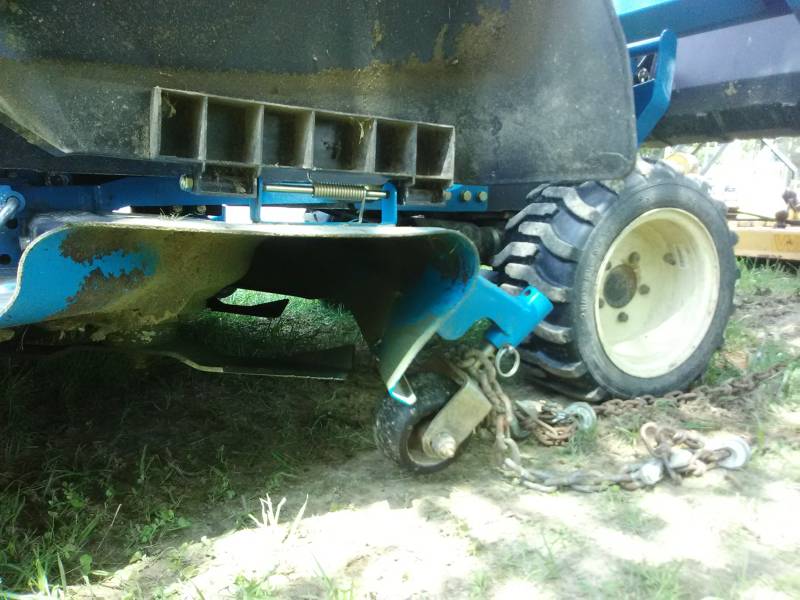

Broke it (again). Fixed it (again, sorta).
Mowing my steepest hill, uphill, so barely crawling. Caught a spot hard enough that the gauge wheel dug in rather than rolling over. Shoved the edge of the deck back into the blade edge enough to slash through the deck.
Was able to use that chain wrapped around a tree to work it back out. Had to move the chain a few times to different places on the deck and back up very very gently. Blades run clear now, but I'm still not sure what, if anything else got messed up.
I had been looking at the spot a while back thinking there was no reinforcement. My two riders have a bar that goes to the back side of the discharge chute. Not sure if I can add that here or not.

That hurts just to look at. I think every time I start a job, I get something to break. Fixing is no longer any fun.
   / What did you do on or to your LS Tractor today? #1,243
I’d say it gets easier, but actually just hurts a little less each time.
On my wife’s craftsman which had that reinforcement as you described, she bunged it up so bad the only fix was to cut out the latest bent area until she needed a deck replacement.
And not even gonna show what shape my brushhog is in.

Thing is, at close to 300 pounds, I hoped this deck was stout enough that this kind of thing wouldn't happen.
   / What did you do on or to your LS Tractor today? #1,245
These things should be taken to a competent welder when brand new for reinforcement if you can't do it yourself. Mower decks look tough and pretty when new but we tend to keep this type of equipment long past its useful life. Things are no longer built to last forever.
You may find a jack used inside the mower with blocks and some clamps will push that back out better than trying to pull with a chain! I hit big rock with my old 4ft hog and it bent the deck where the gearbox sits on top so that the blades were hitting bottom of deck on one side and dirt on other I was able to get a car jack between the blade hub and deck.and make it straight enough that it still beats down the brush!
