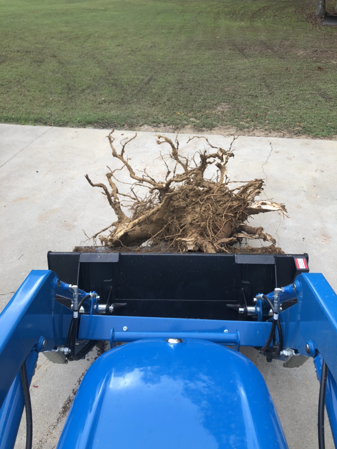

Another stump removal with my MT125. This is the second stump I removed. This one was smaller, but more difficult. Holly tree roots are a nightmare. Didn’t bother clamping on my forks to move It, I just pushed it. IMG_0758.JPGIMG_0759.JPG

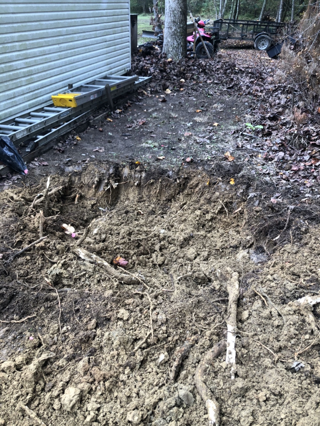

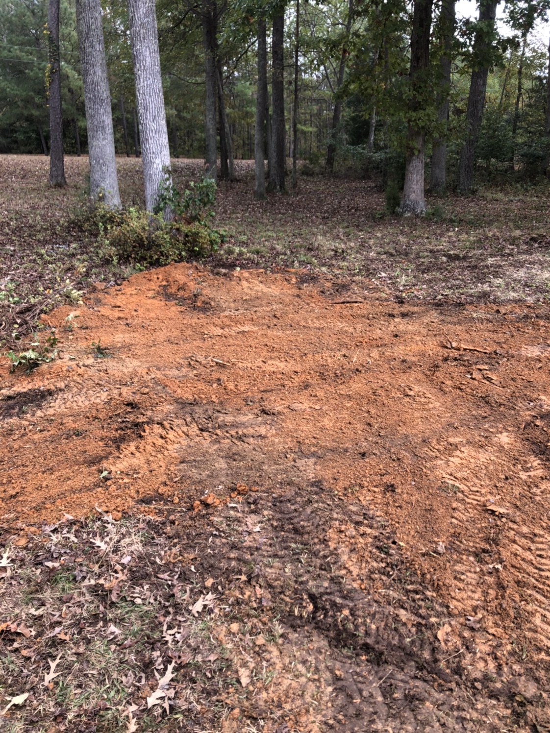

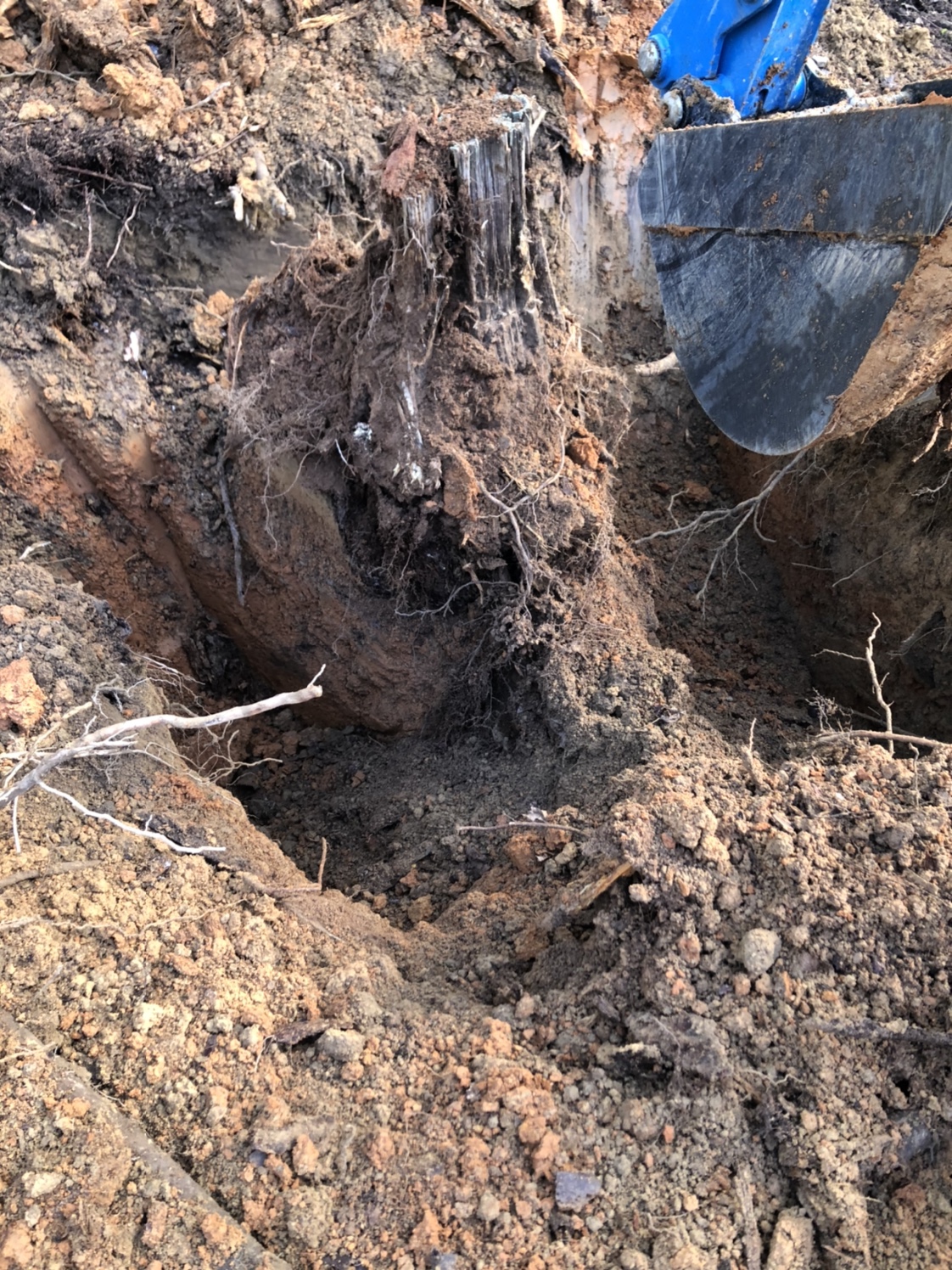

Stump number Three. The stump wasn’t much in diameter, but was deep. I did at least 5 feet down before the stump would budge. I couldn’t pull it out, but I was able to tip it over a ways and put dirt back over it. IMG_0766.JPGIMG_0767.JPG

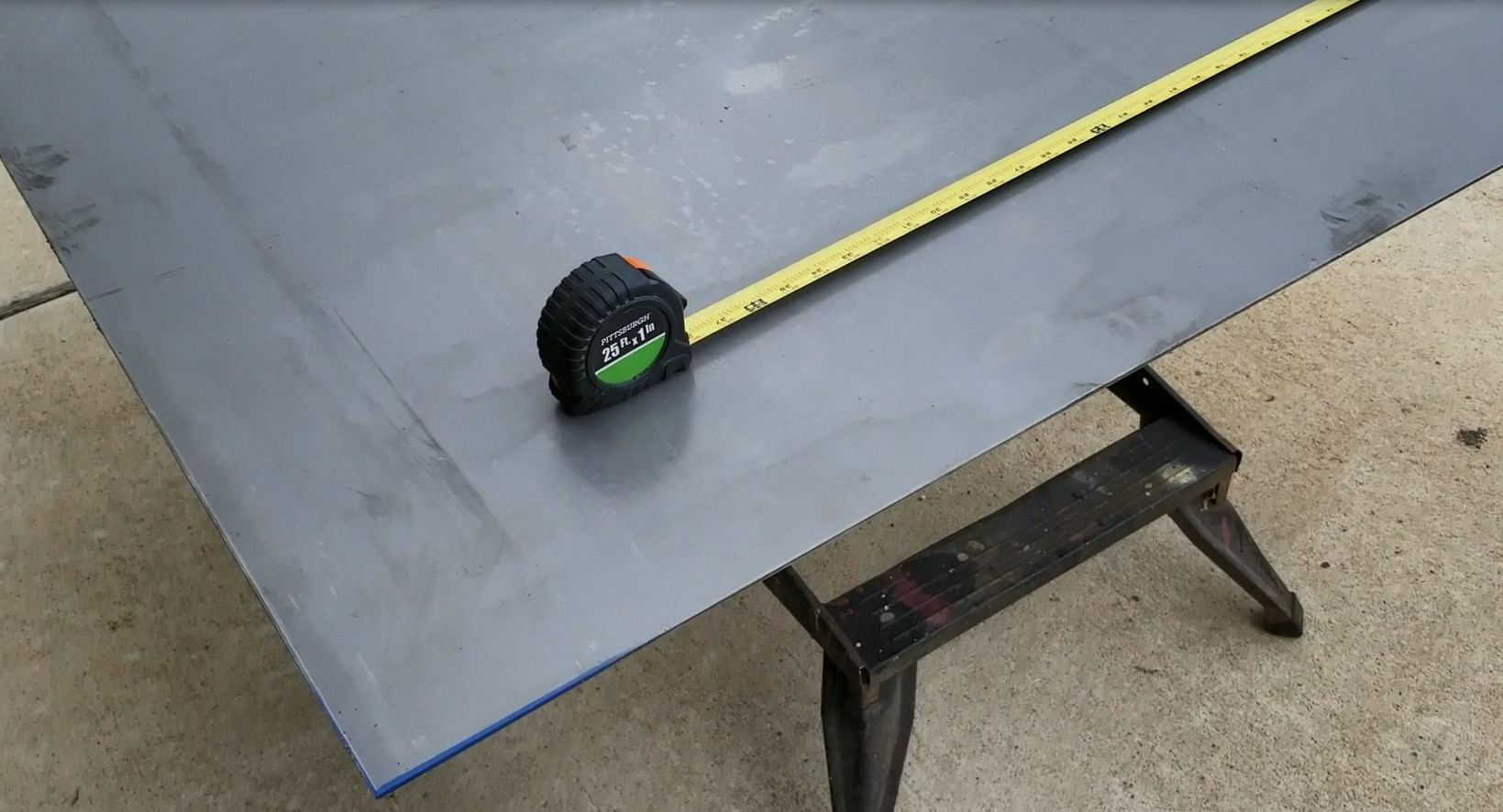

I did though put on my tractor skid plate I made for my last tractor on this new one and it fit great.
I made a video on that and will upload it soon.

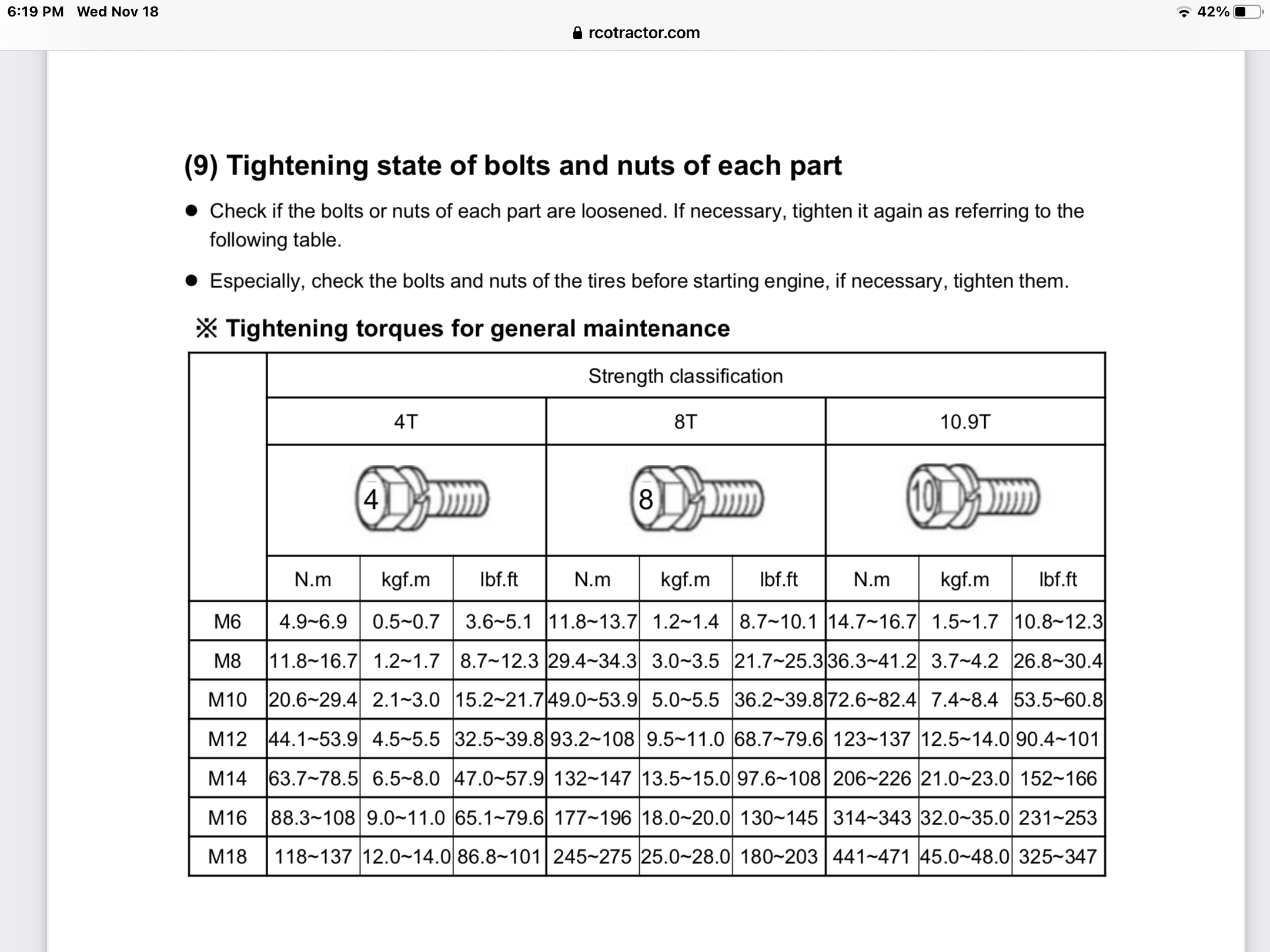

   / What did you do on or to your LS Tractor today? #1,528
Here is the bolt torque list from page 5-11 of the manual....
#1,529
Yeah, I saw that, but I'm not sure what size or hardness the rear lugs are. The parts books seems to call them as M12, but doesn't give me the hardness either. I picked 65 since it's kind of in between there somewhere. I can't find the lugs called out separately like the other machine posted above.
