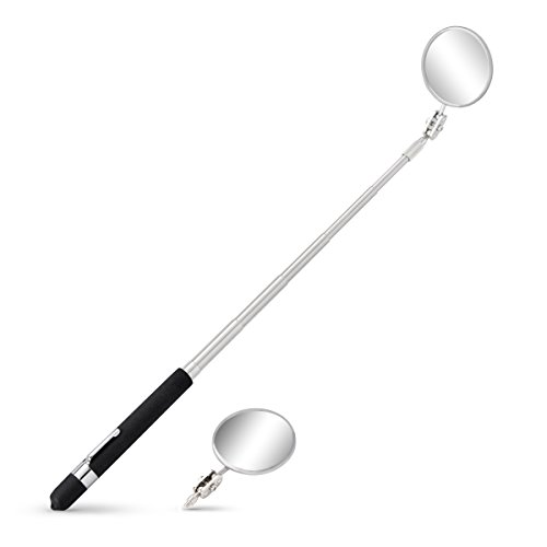

Have you seen the mechanics mirror with a short handle you can see behind things with a flash light very handy to have
willy
I just put my old cell phone with long pliers under or behind things with video camera going then just watch it! Really works good when by yourself and need to move something to see what is happening!
