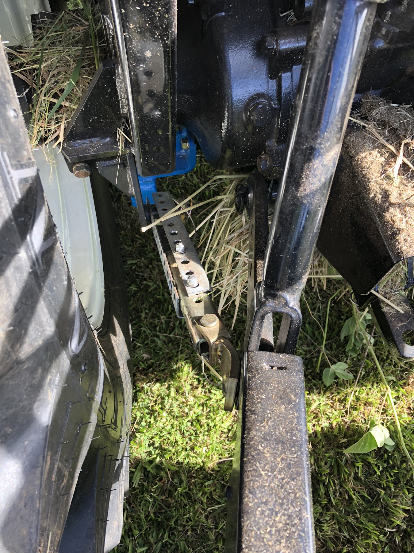

Funny thing is I looked at the middle pin that keeps them together and thought the way the ring was bent to go around bar was a good idea. Guess not. Both Kioti and Case had a keeper chain or wire so not to lose them.
Will have to look at a temp fix. Anyone actually replace the link? Doubt my dealer has one, but will check.

On my Mitsubishi when I lost one I decided to make two new ones that were stronger than original ones since I was always using bigger attachments than the tractor was I made for but they are simple all thread adjusters but 500hrs later they still work to keep lower arms off tires!

This is just a temp replacement, but am pleased to say it has heldup well to about 3 hours bush hogging today.
Didn’t have appropriate pins with holes so used bolts. Will be a pain to change, but OK for now.
Ordered replacement from dealer today. No idea when I’ll get it, he’s still waiting for parts for my #3 rear remote.
