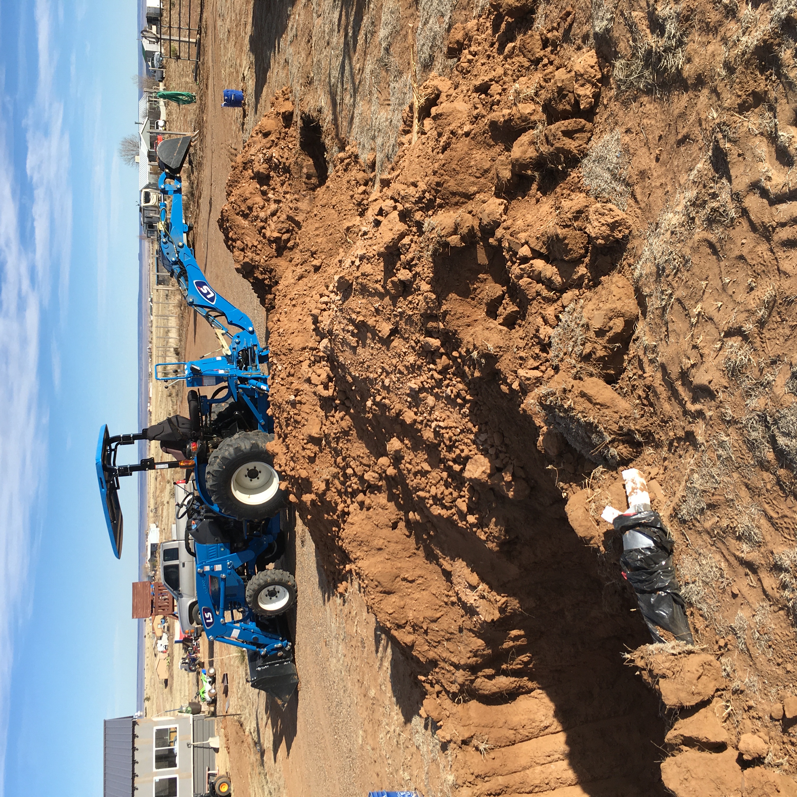

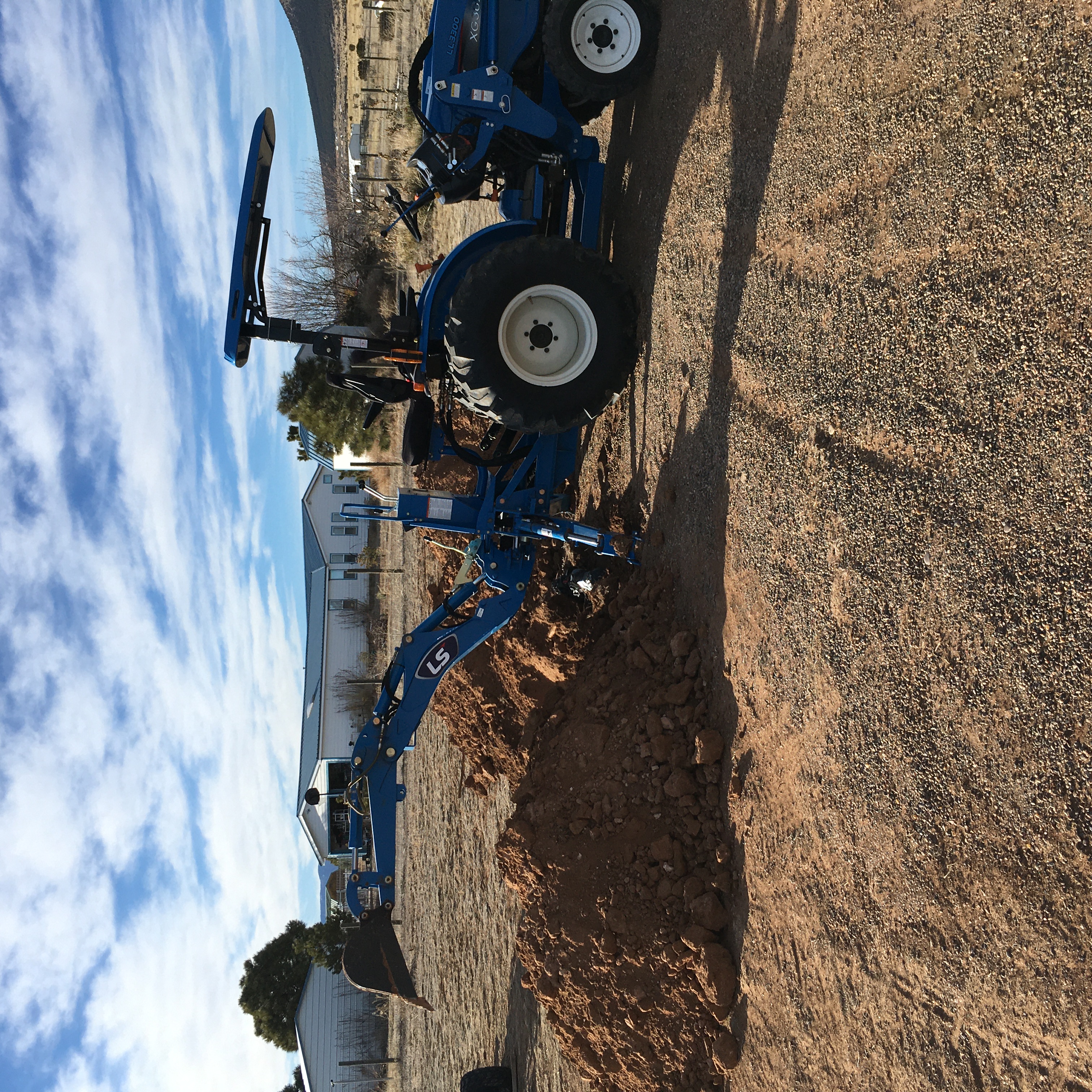

Neighbor asked me to dig six 4x4x4 holes for some trees he is relocating from a job site. Got the first 3 done this afternoon, the ground was rock hard and dry. The LS BH did good! The next 3 will be done tomorrow. More seat time! YEAA!

Very nice. Any excuse to get some seat time in works for me too.
   / What did you do on or to your LS Tractor today? #964
Sure looks dry. Hope the trees survive. Good work.

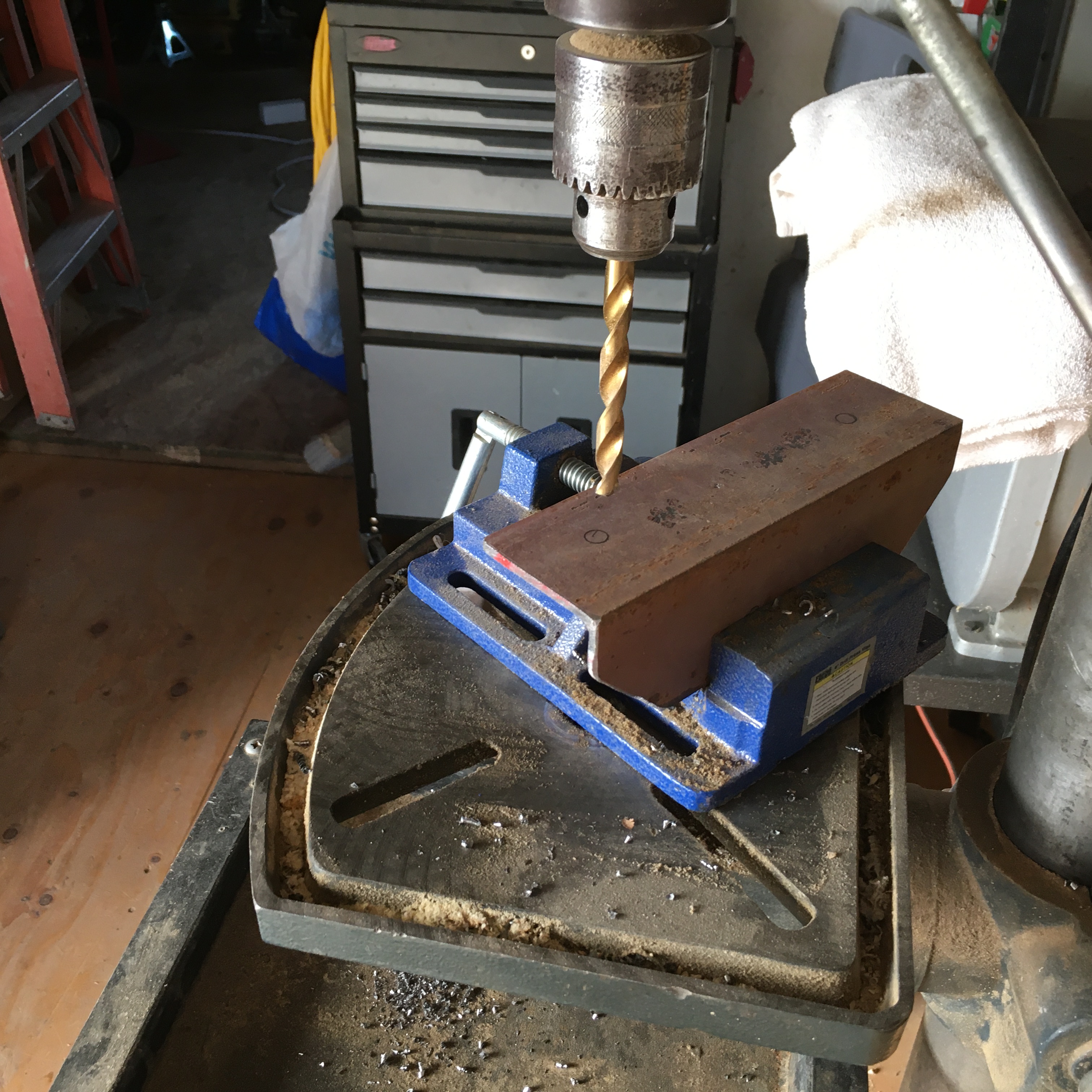

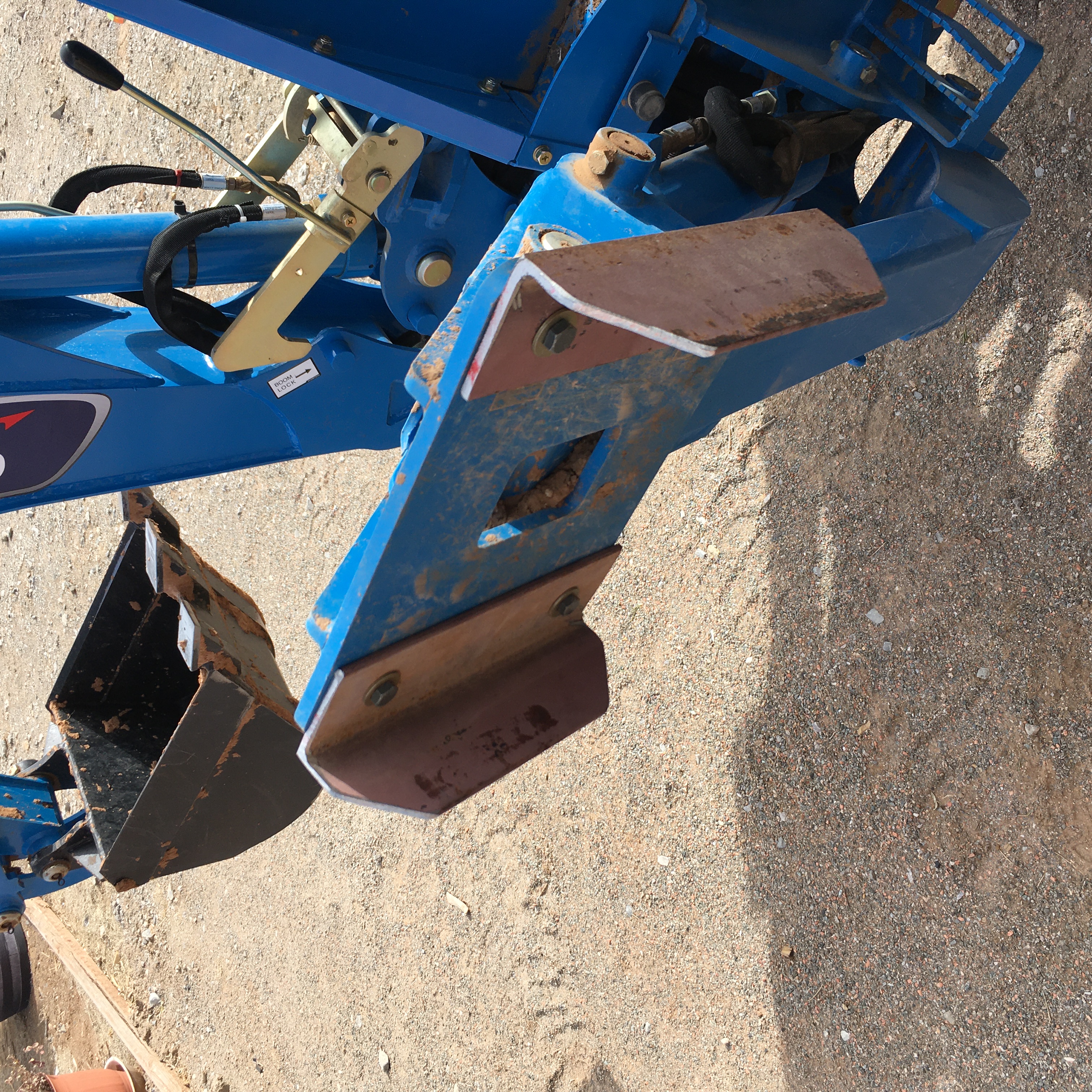

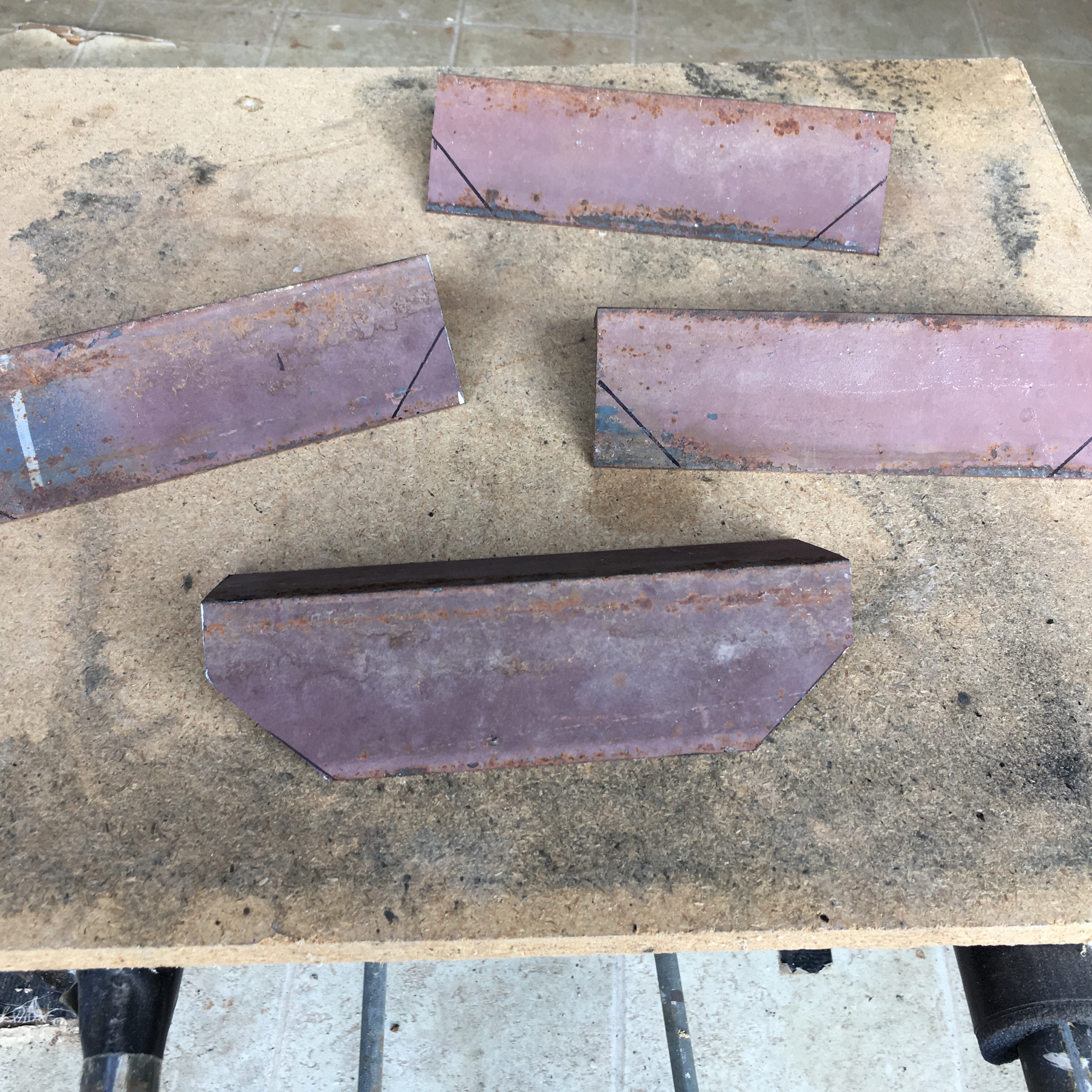

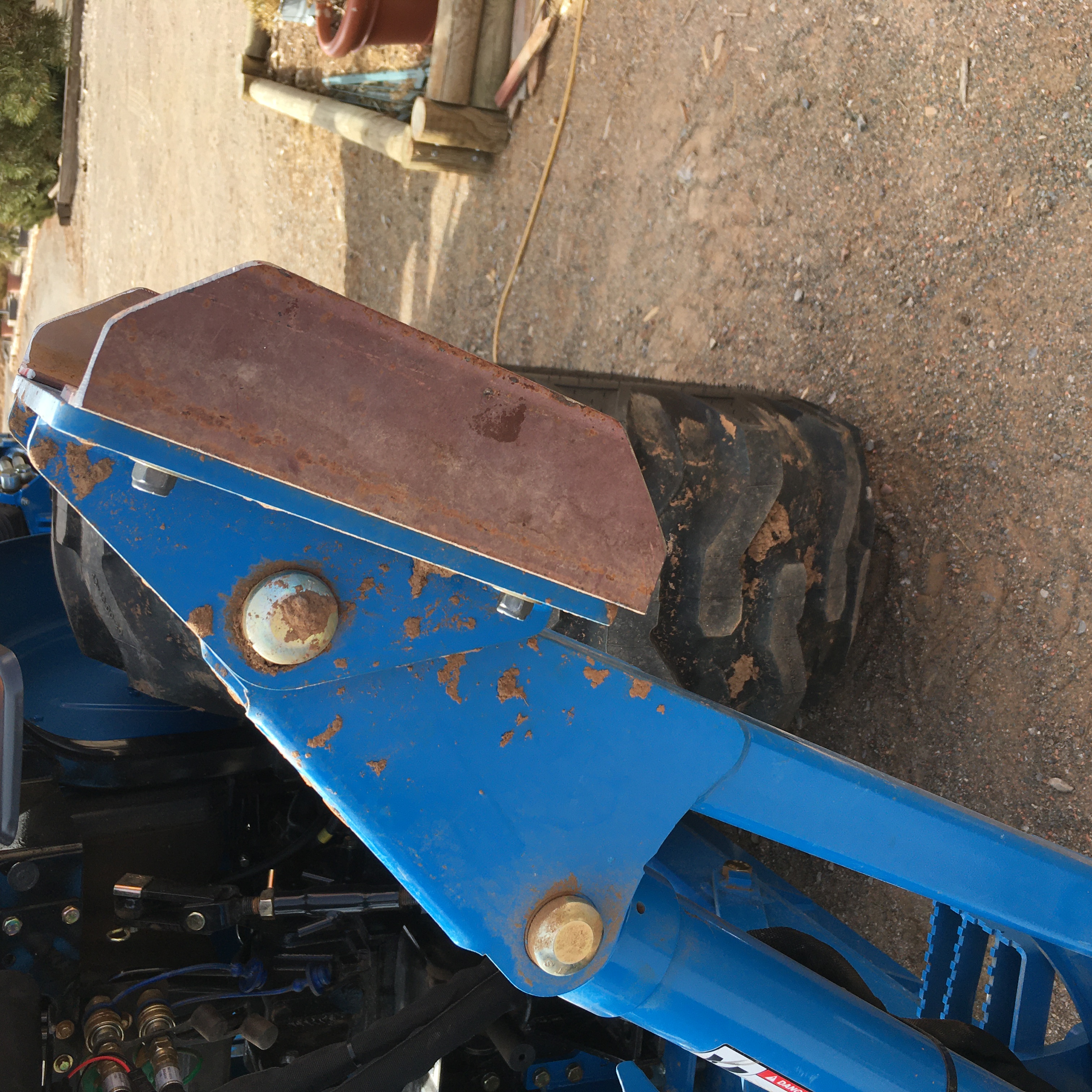

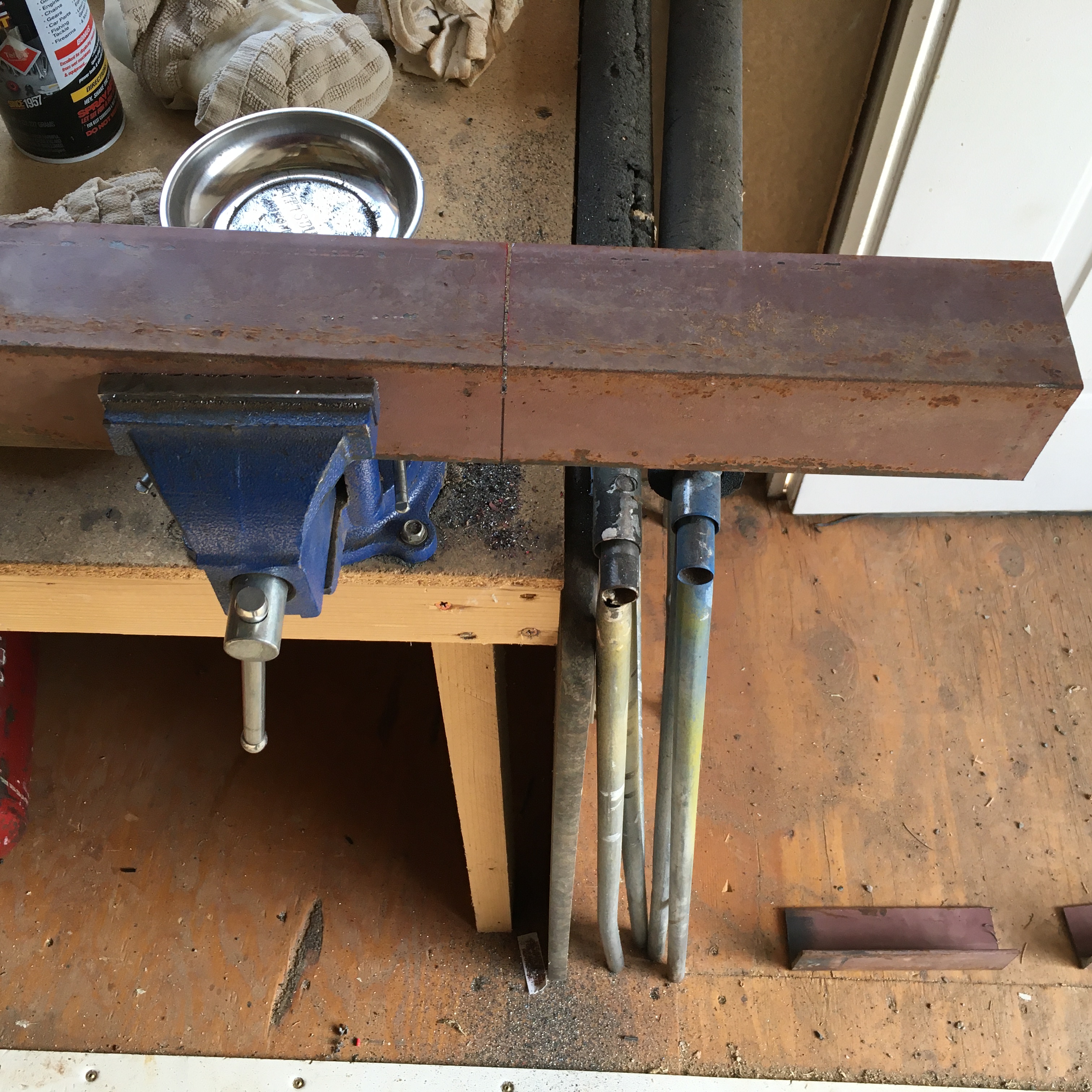

After digging those first 3 holes, I soon realized the BH stabilizers having flat, smooth plates was a “ no go “ . So, I added some “ claws “ to the plates. Took about an hour... makes me wonder why I kept procrastinating making them. Made a big difference, did the next 3 holes today, about 20 minutes faster per hole, not having to constantly reposition the tractor.

Figured you'da done that first off when you got it.
   / What did you do on or to your LS Tractor today? #967
Yea, me too! I put them on the 125, but thought the heavier weight and much bigger tires would work. I just kept procrastinating.....

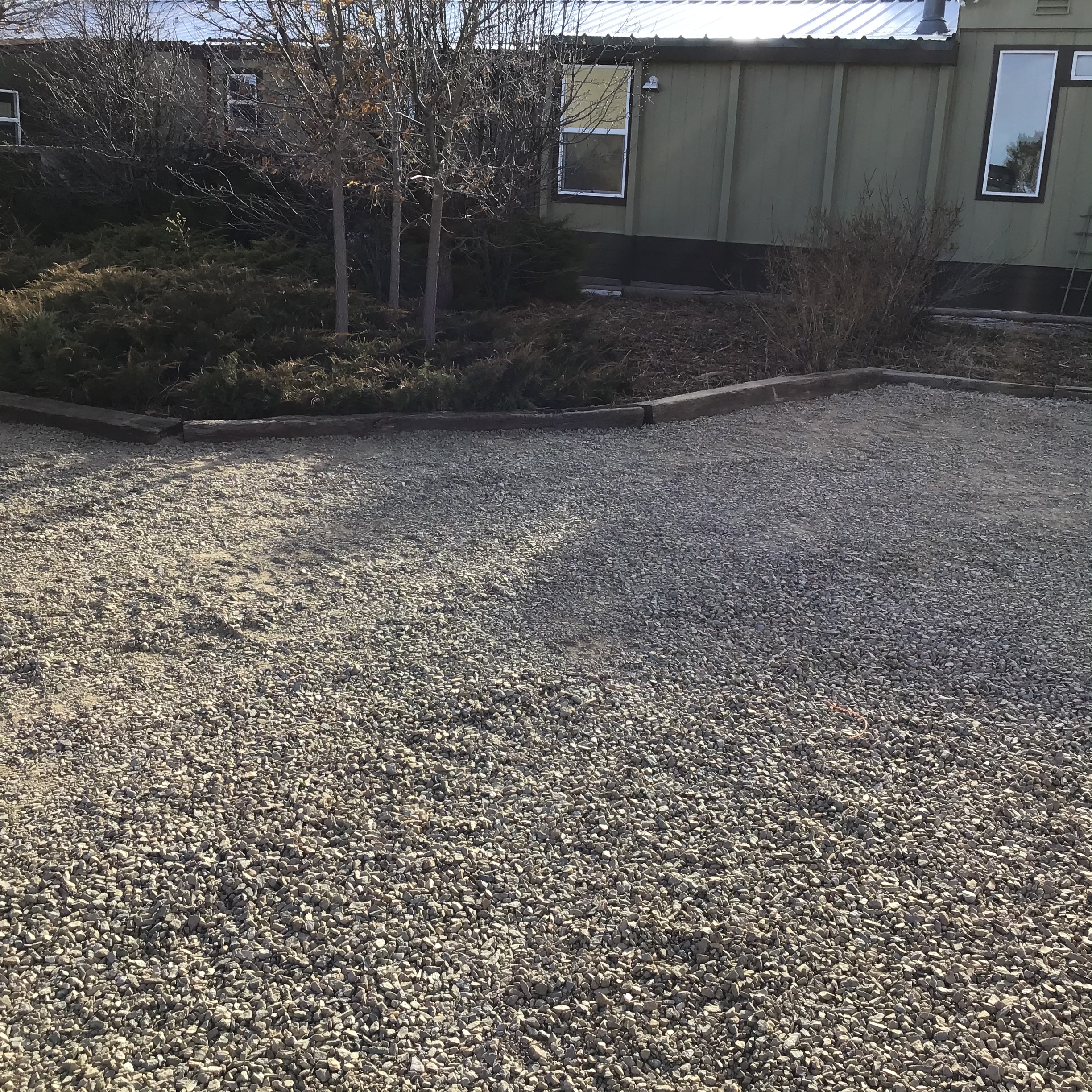

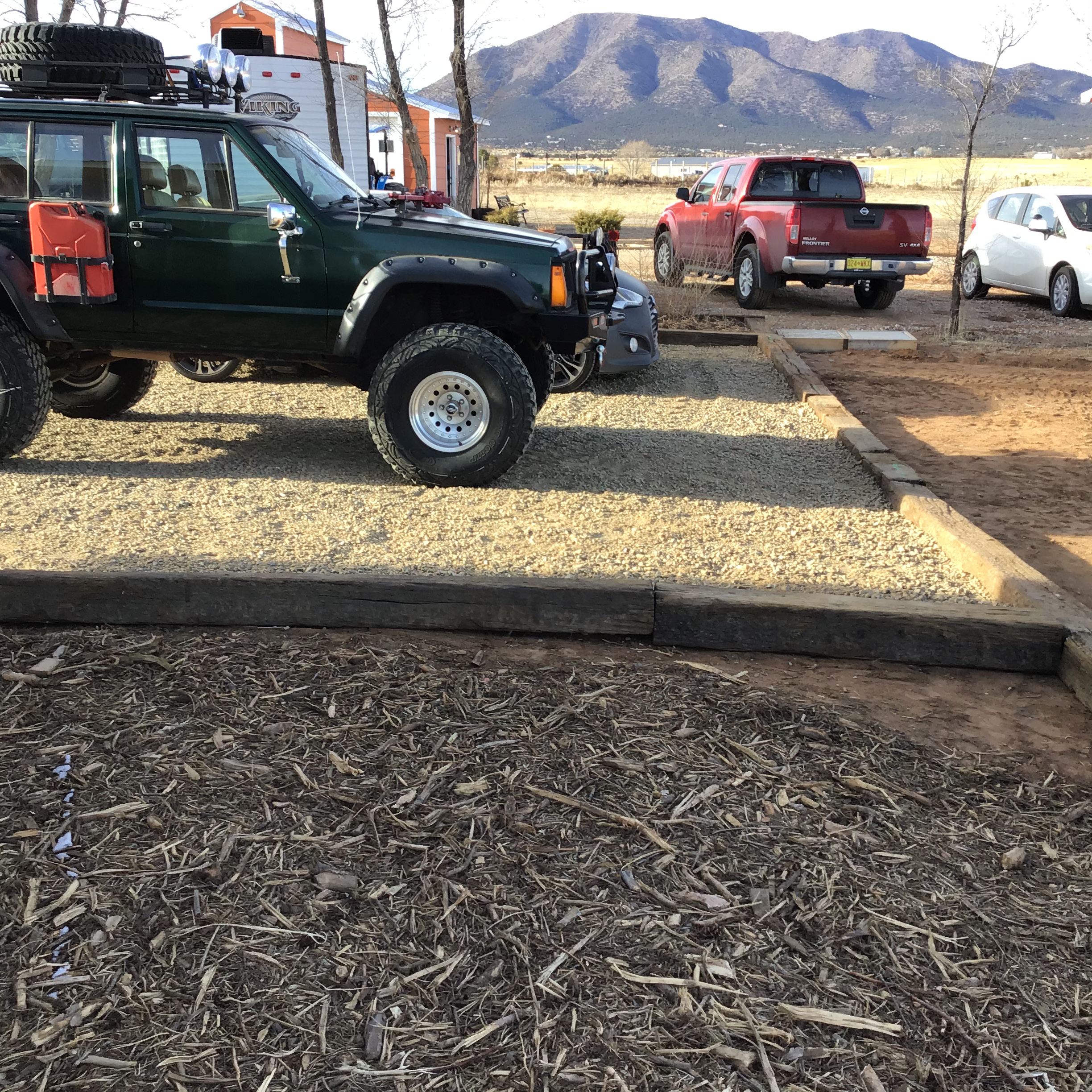

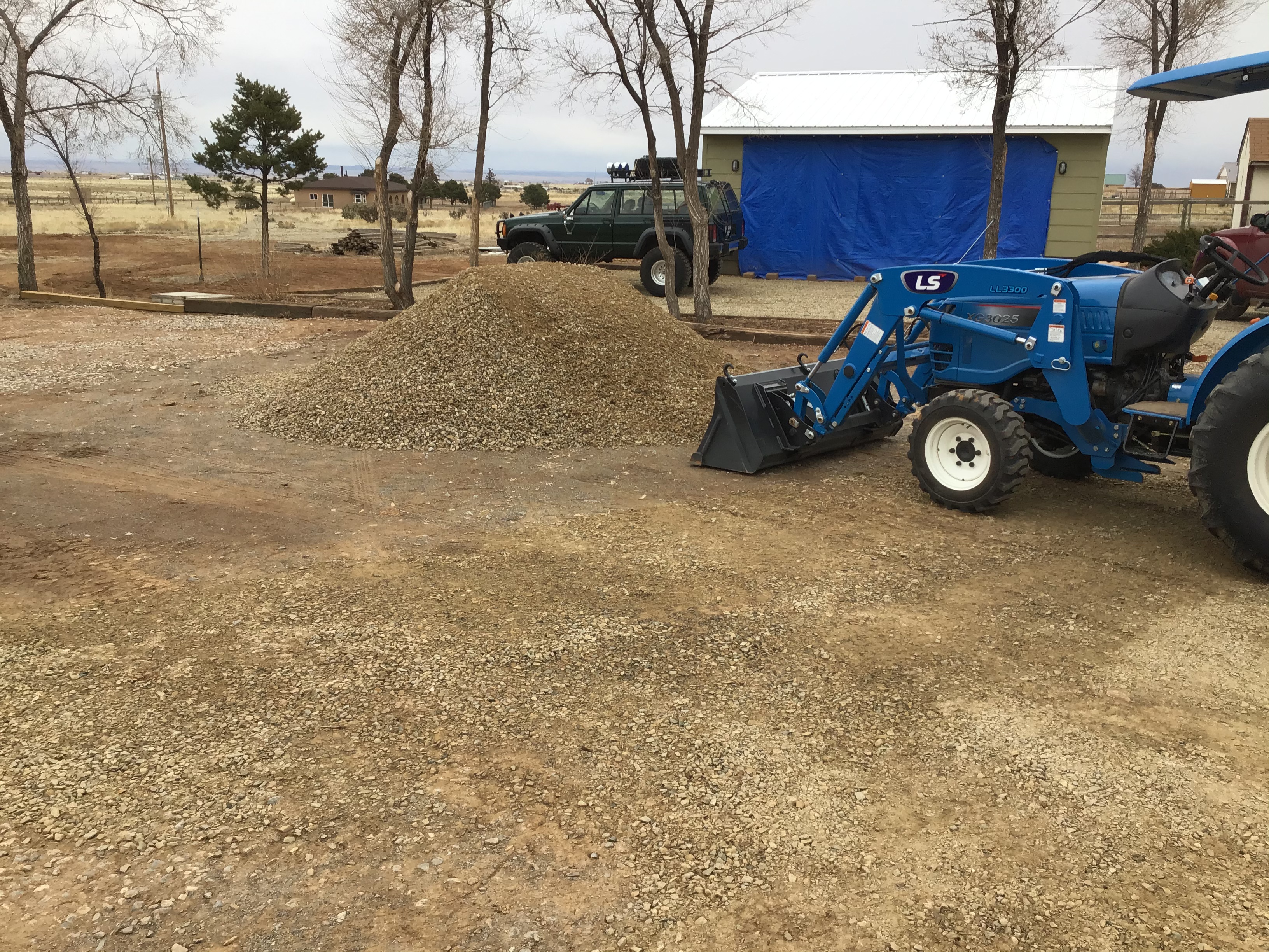

Been busy spreading gravel! First area was in front of the son s new garage build. We set all the RR ties, then spread 24 tons of gravel.
Oh, and some mulch too!

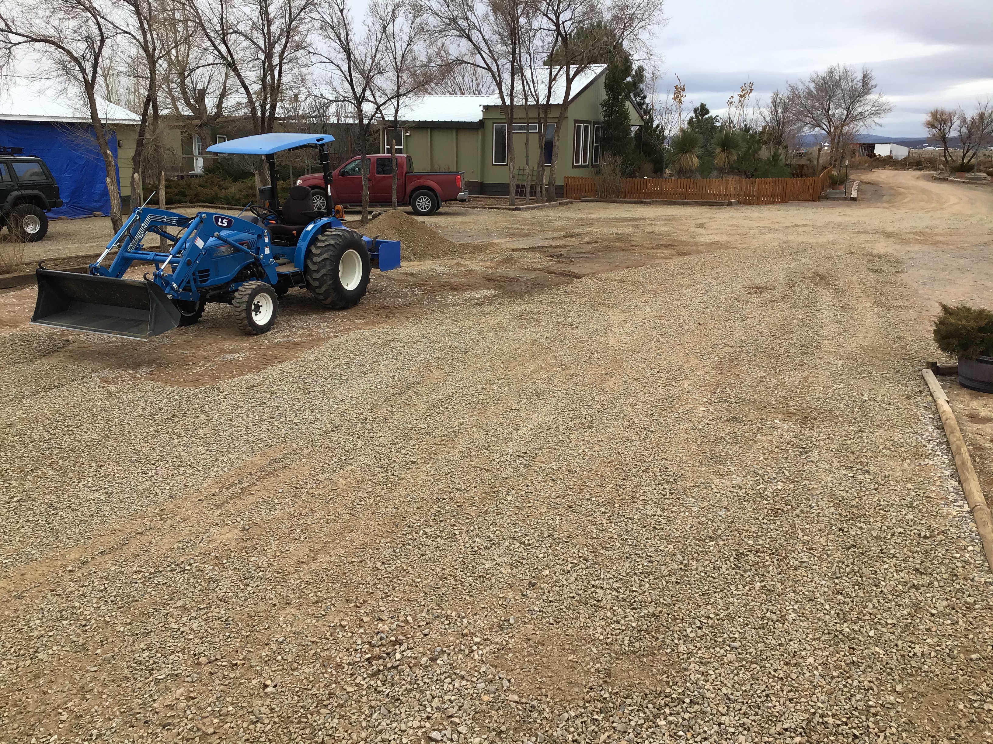

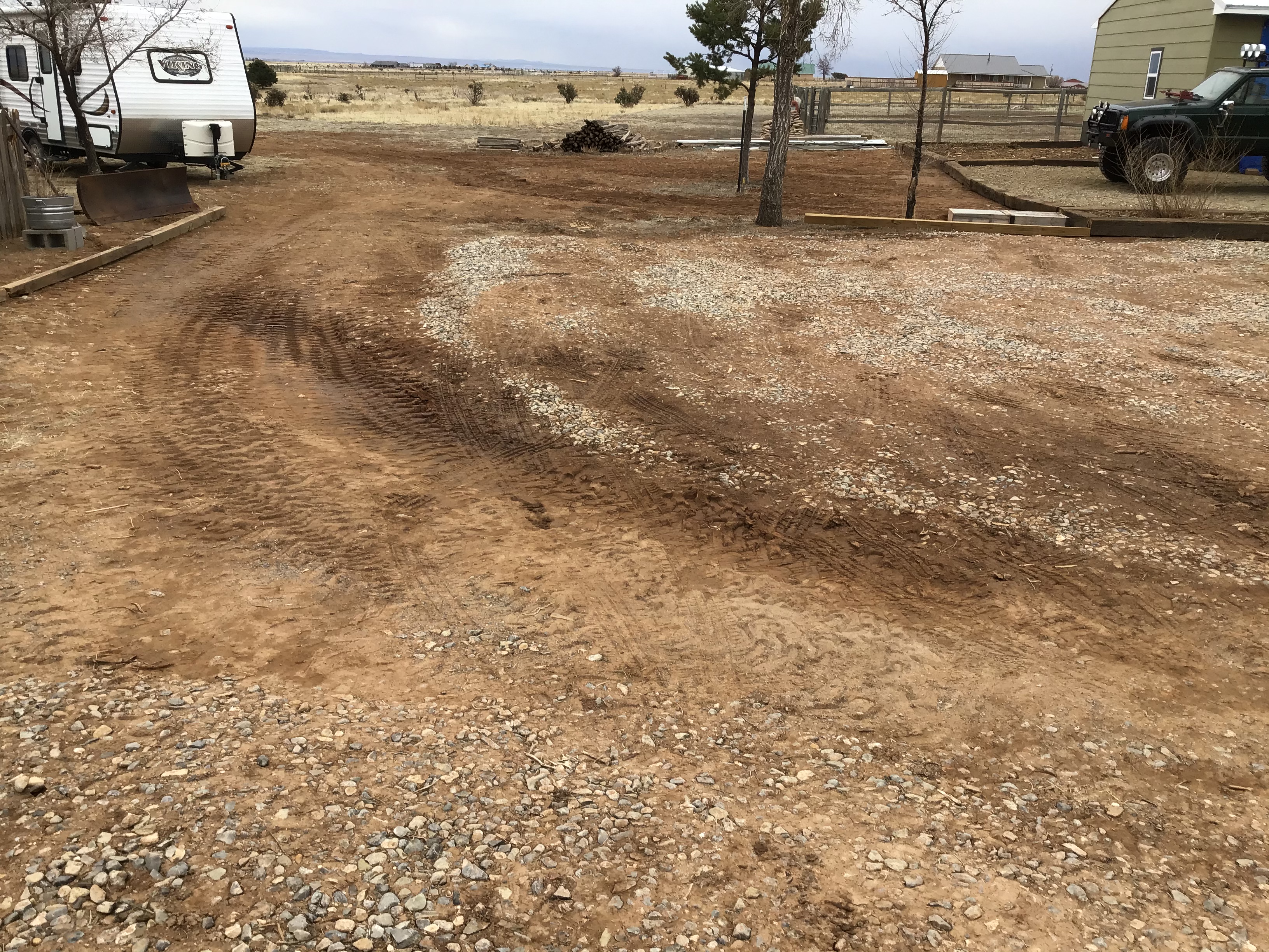

It turned out so good, we decided to put more stone in our driveway, filling in a bunch of low spots and areas of mud. Spread another 28 tons of stone today. It is now much much better! Wifey is happy... no mud!
Some before pics....

And some after pics...
