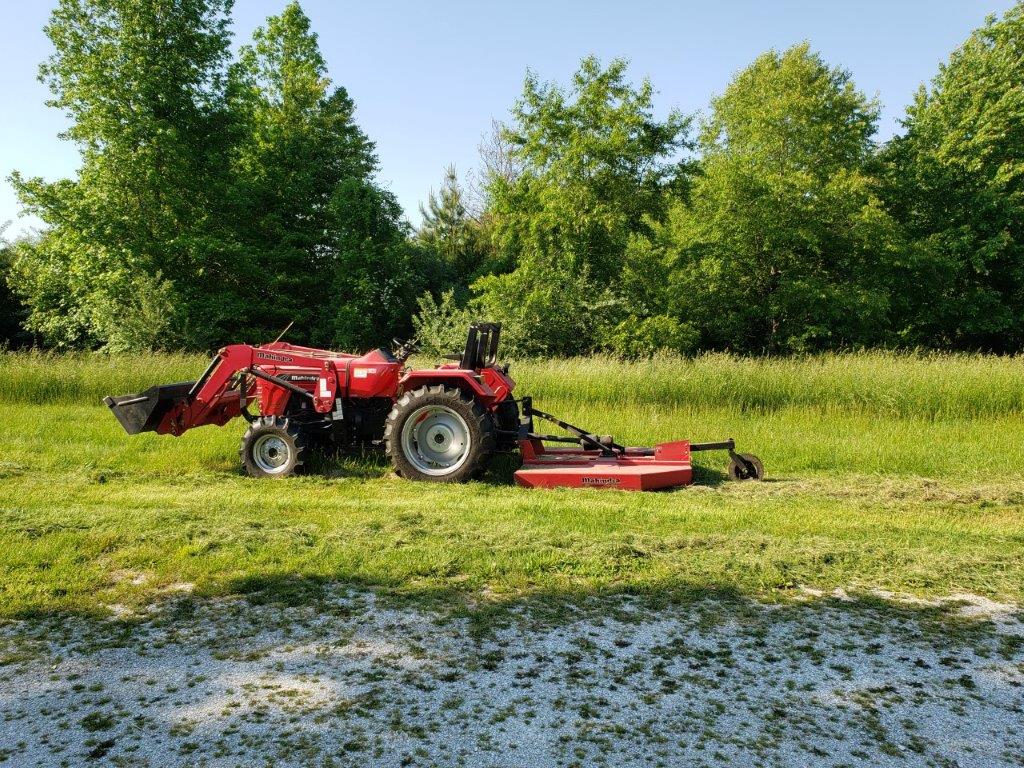

It's definitely mowing season here in Delaware; lots of rain (mostly on a weekend!), and the pollen is rocking and rolling!

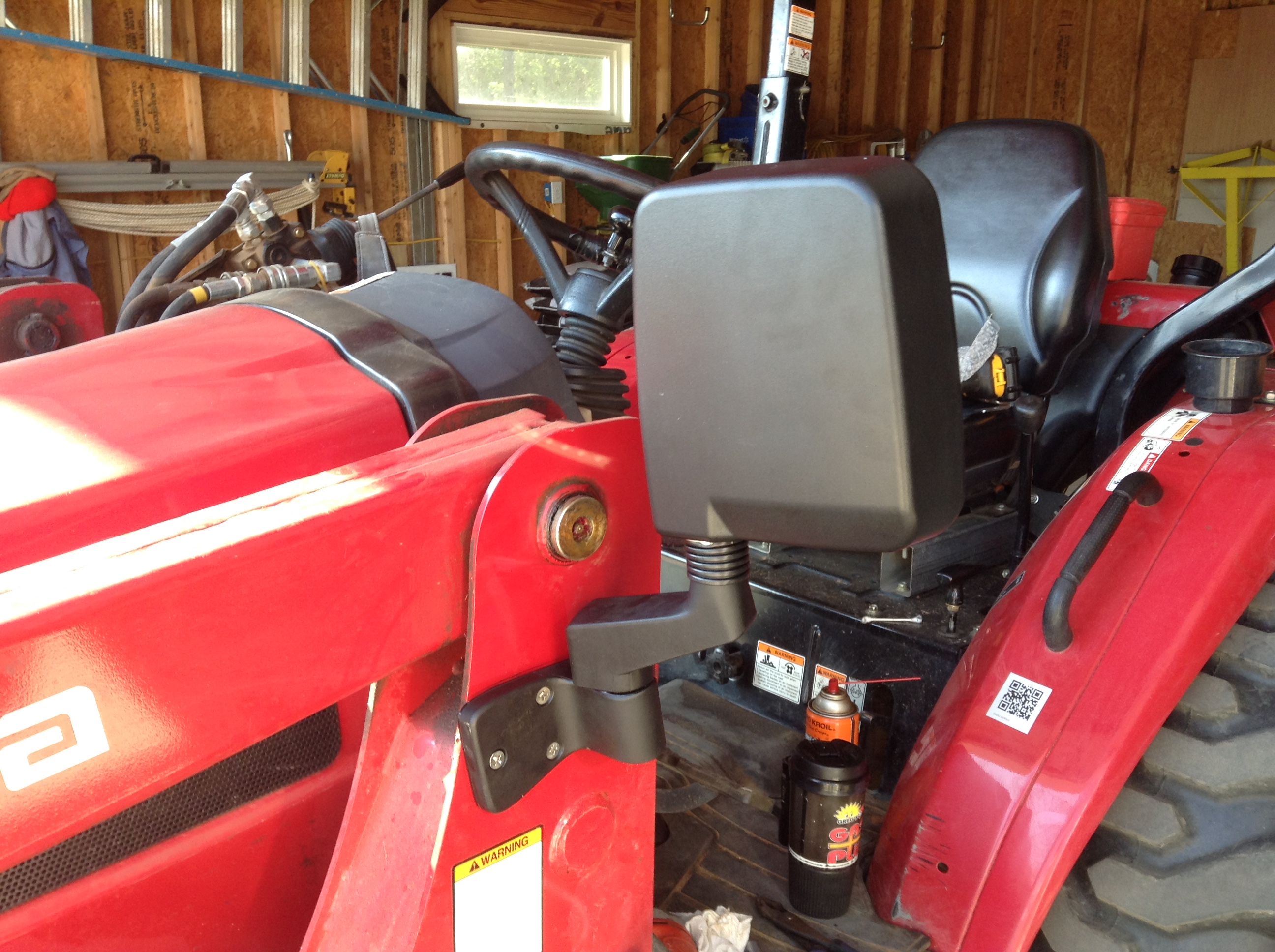

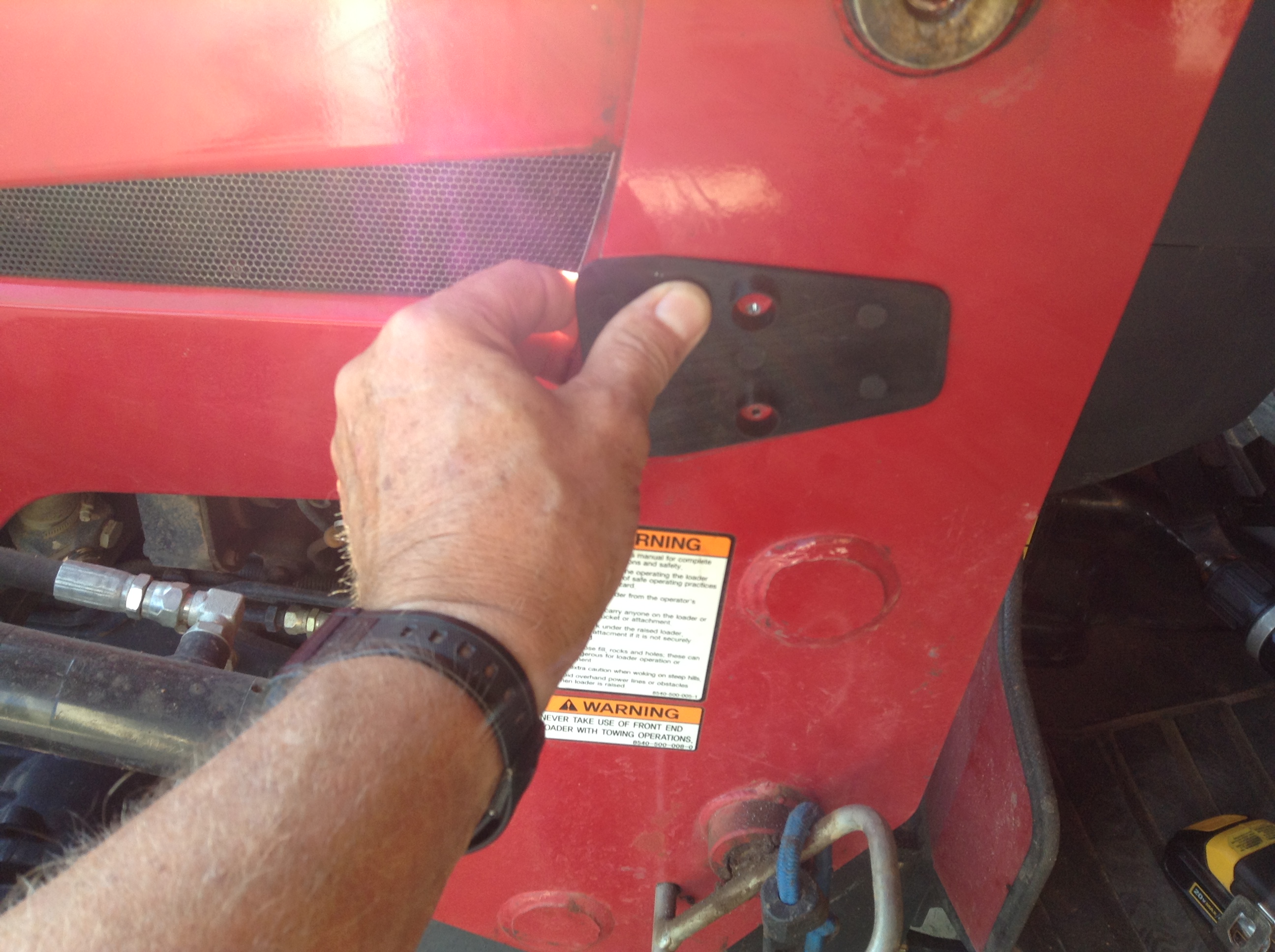

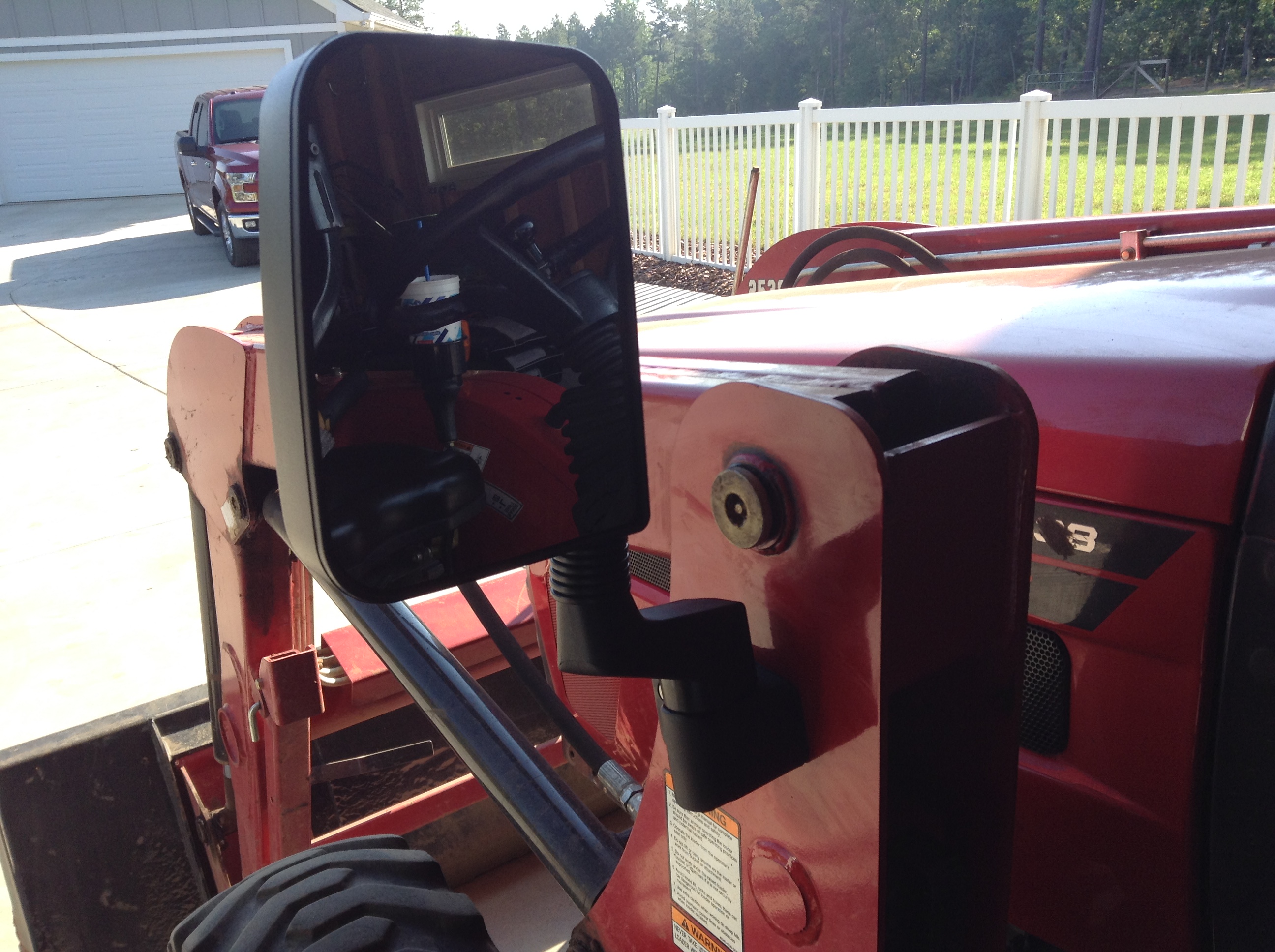

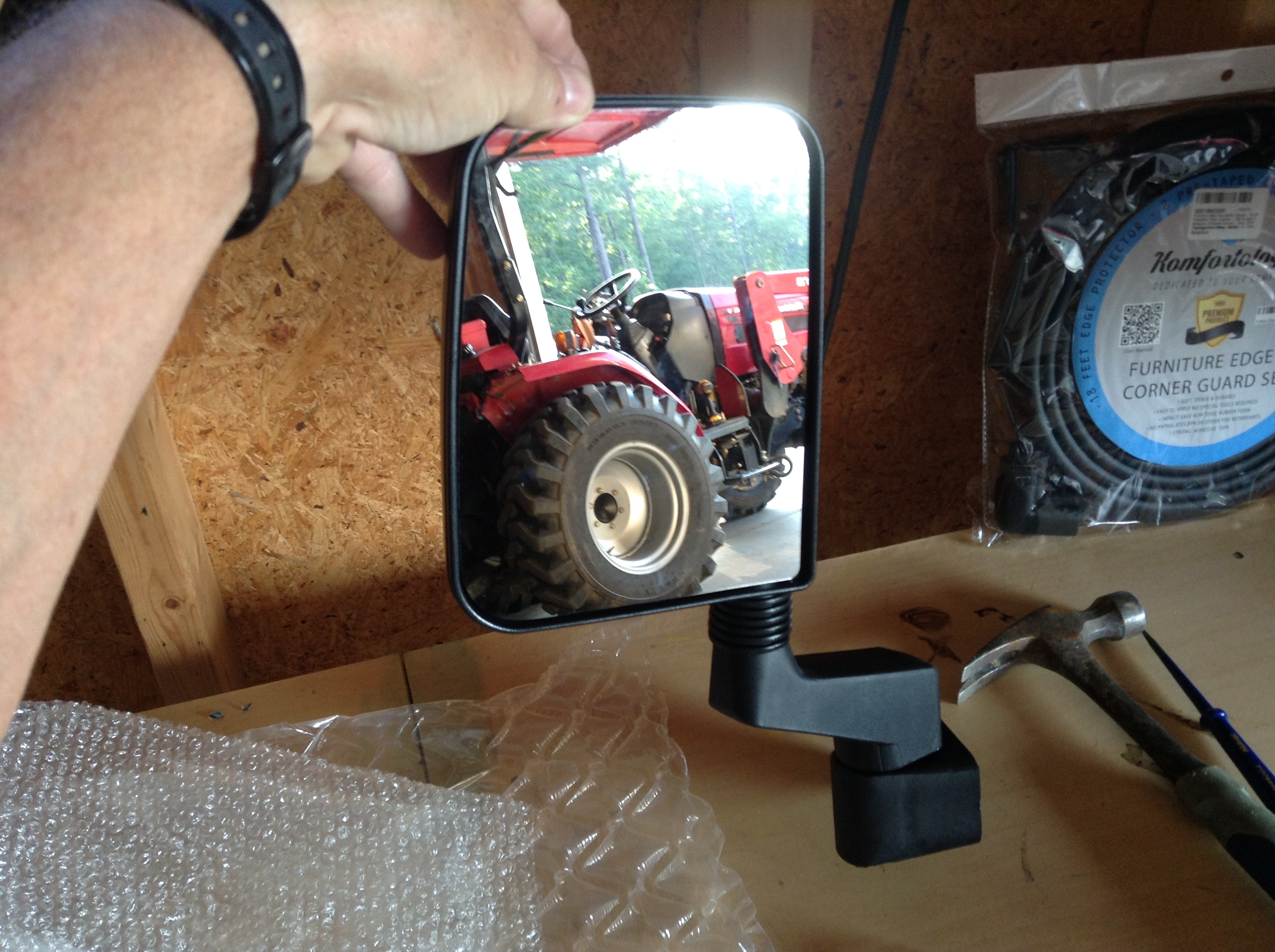

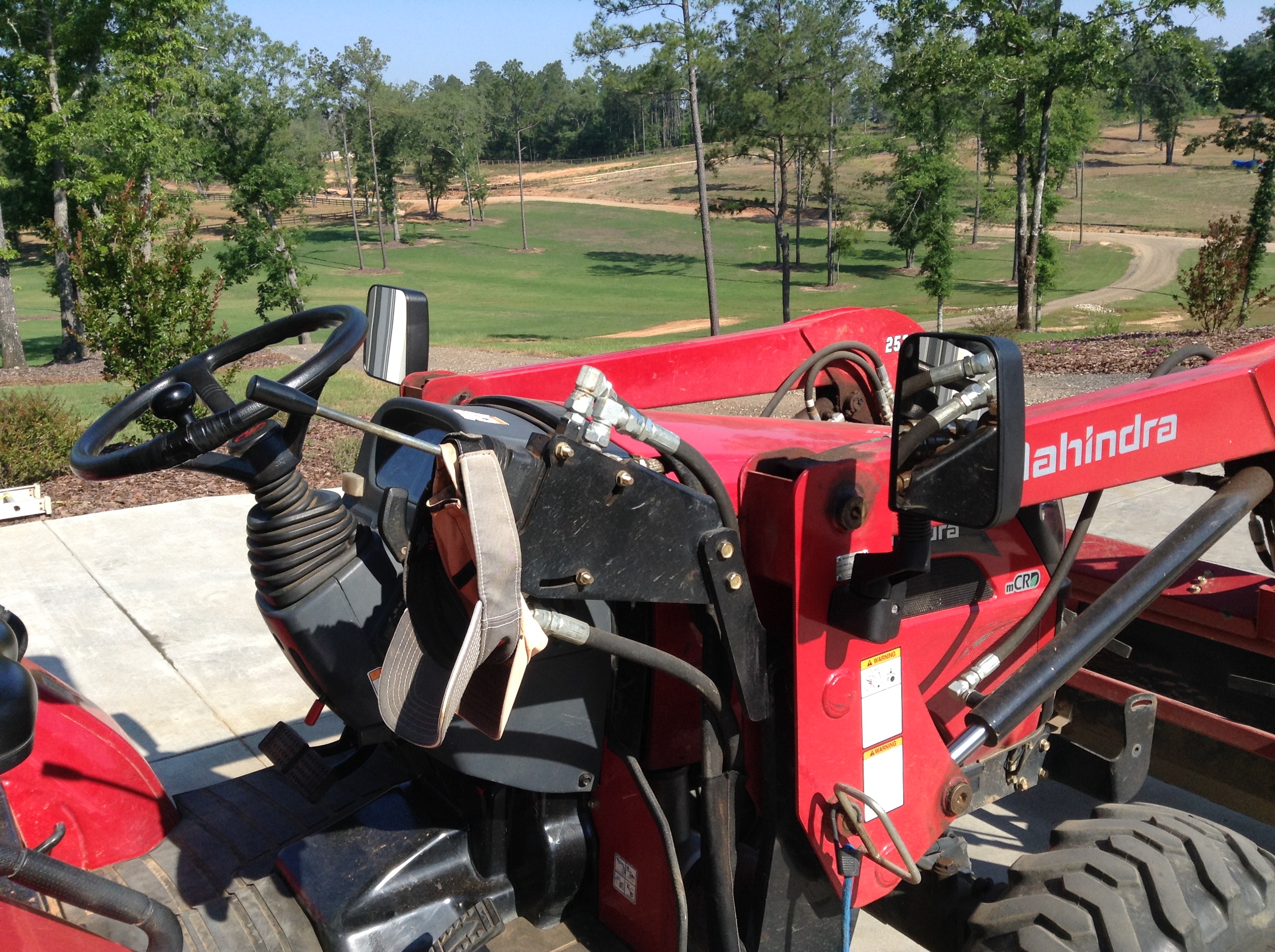

My Saturday morning project was to install a couple of side mirrors on the beast.
Picked up a pair of adjustable mirrors 6"x7.5" with articulated arms off of eBay. Got the pair for under $30. But the idiot seller didn't include the mounting bolts, as advertised, so I had to run to HD to pick up 6. (I'm amazed HD actually had 6 metric bolts to fit in stock!)
Anyway, found a place on the support structure of the FEL where I could drill and tap holes to mount them. Never had done a hole tap before, so it took me a little longer than you experts, I'm sure, but I got 'er done!
Couple of pics for those who might be interested.
That's interesting, nice idea ! How's it working out, vibrations ?
I've been thinking about mounting 6 x 8's on some 1" sq. Tubing, just hadn't figured out how I was going to do it and it wasn't high on the List of Things To Do ! My main problem was keeping the mirror steady, minimal vibrations.
They look like Jeep Mirrors, and they eliminate the need for additional bracing or mounting !
Now to test them in a work situation.
I like it !

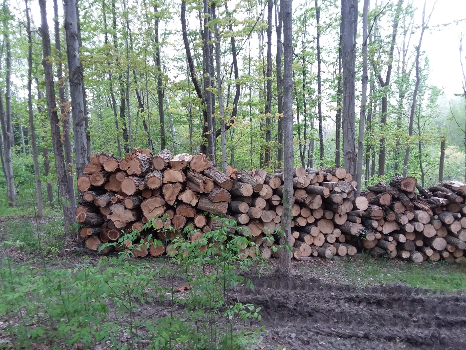

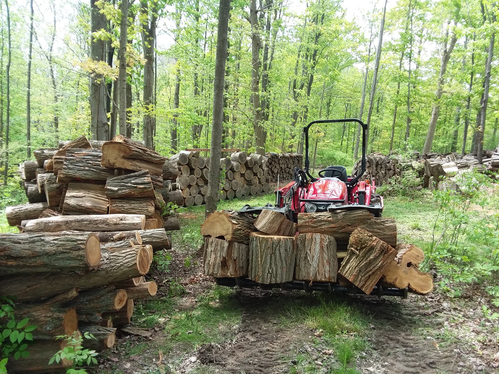

I move wood for a few hours today
Mounting is nice and stable. Got 3 6mm bolts on each one. And you're right Scrambler, they are Jeep mirrors ('85-'02). Articulating arms so you can fold them back if you want in tight spaces, but they are actually inside the outer edges of the back tires, so I think they're "kind of" safe.
There is some vibration. Not horrible, but it's definitely there. I put some 1/8" plastic foam (from for sale sign) between the mirror and FEL, and that helped a little. Rubber may do better. Haven't gotten around to trying that yet.
But the mirrors let me keep an eye on the edge of the mower deck (PTO) and my landscape rake when I groom the road and driveway. Saves my old neck from getting more creaks...

OK on Vibration and rubber mounting.
I think I have the same set in my Barn, they were going on a Jeep Project I was working on and then lost interest.
As far as a rear view, anything would be better than my nothing... I have to keep spinning around to keep things in check.
I am still thinking the 6 x 8 Mirrors similar to a Big Rig will work too but I am worried about too much vibrations,, we will see !
Keep us posted !
