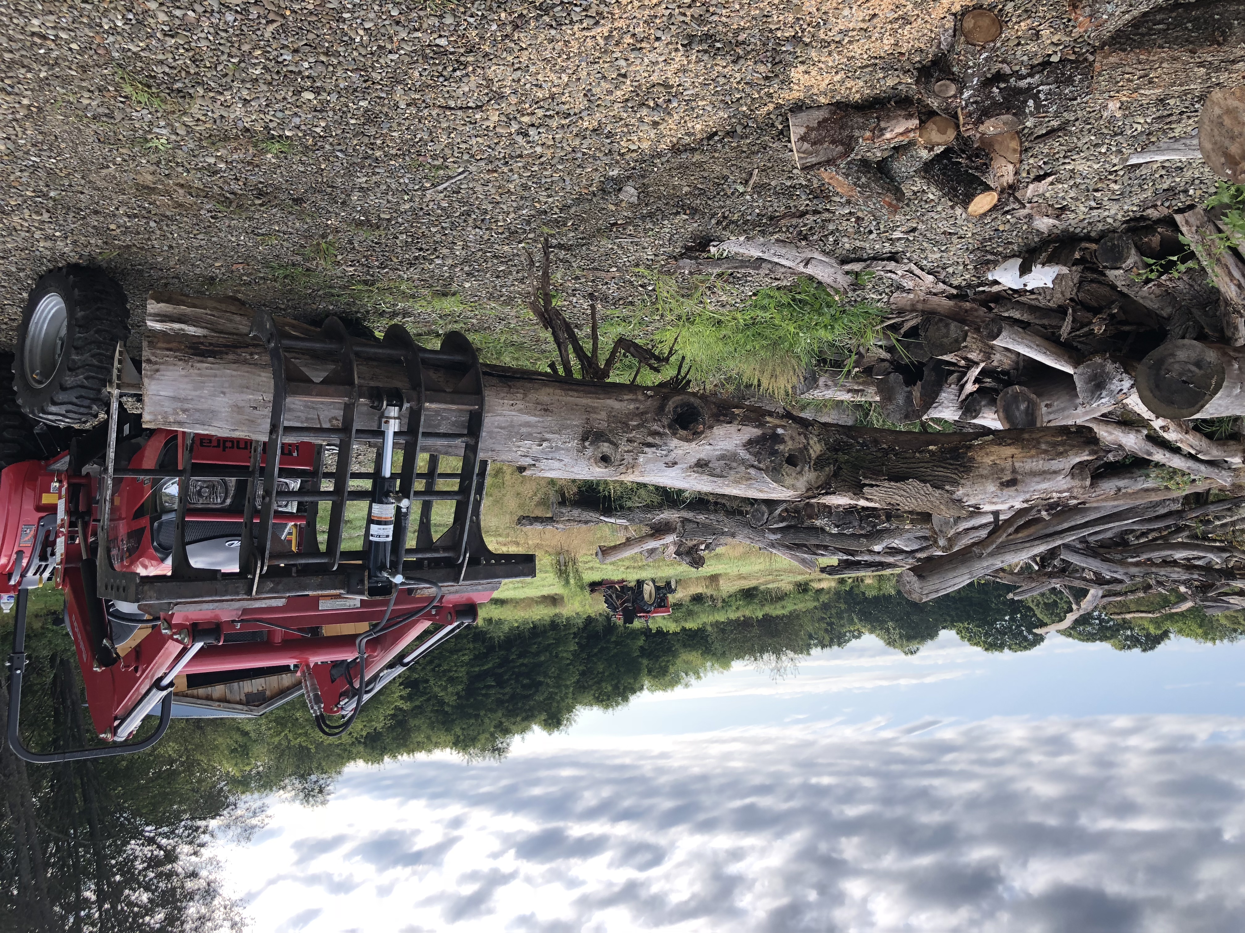

9ACA2FB9-364C-49A7-B8C3-D062D928D903.jpegUsed the tractor to help save my back cutting up firewood.

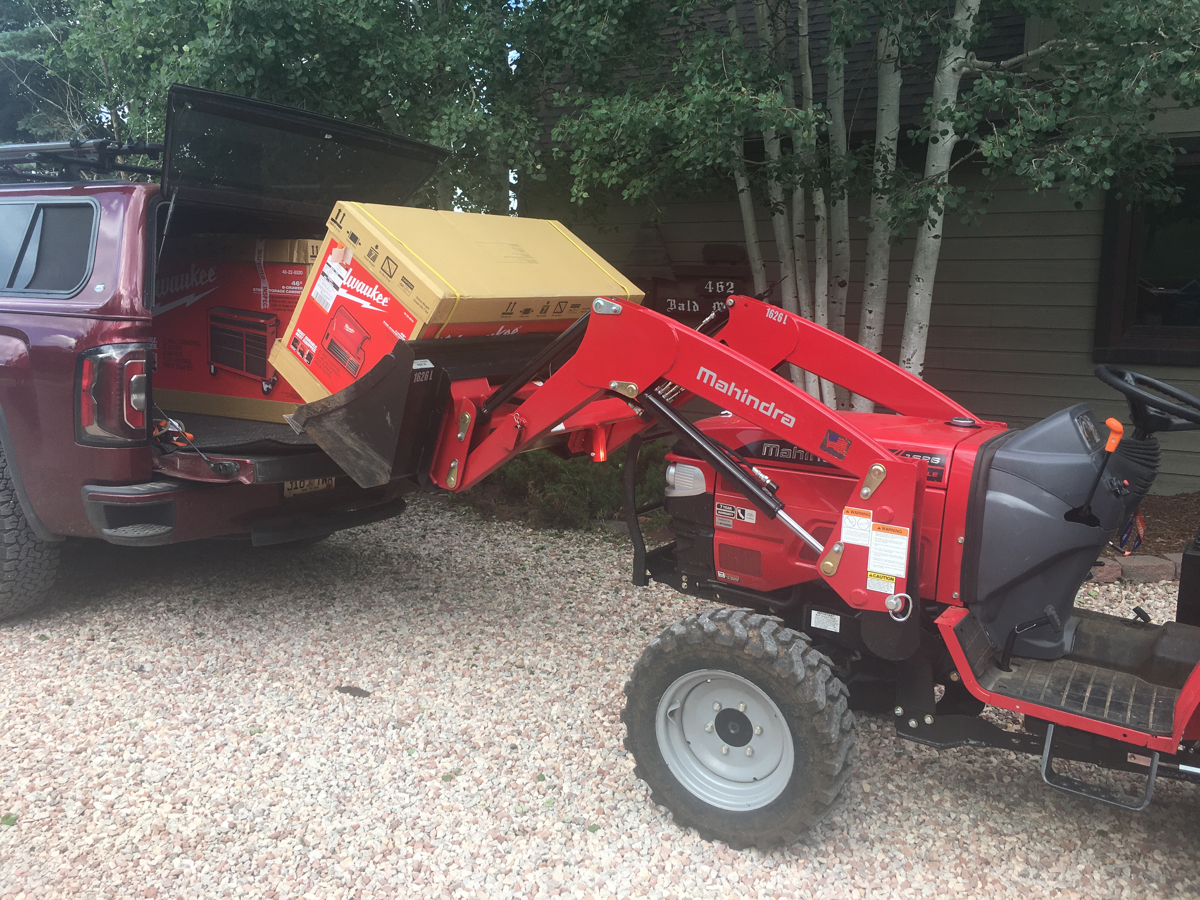

That moment when you get the thing home and ponder how youæ±*e gonna ask the wife to help..... then you remember you have this new tool that can lift stuff :)

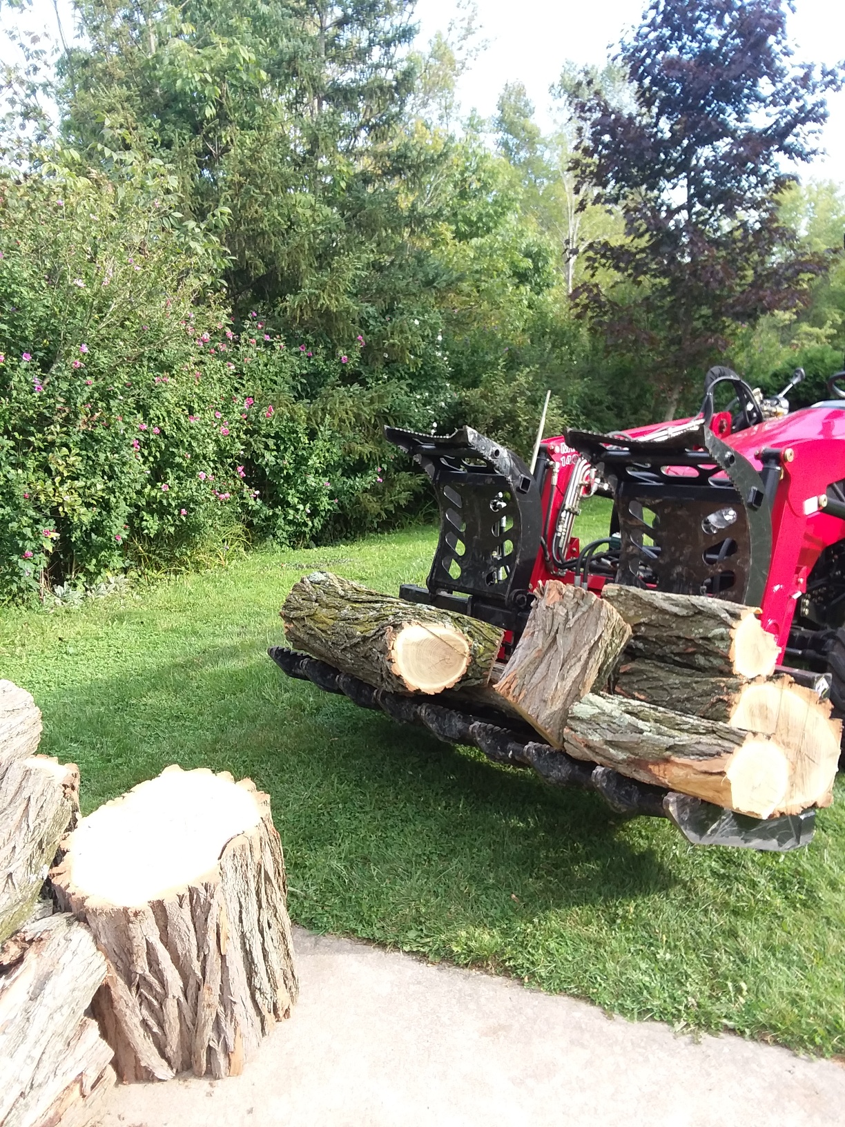

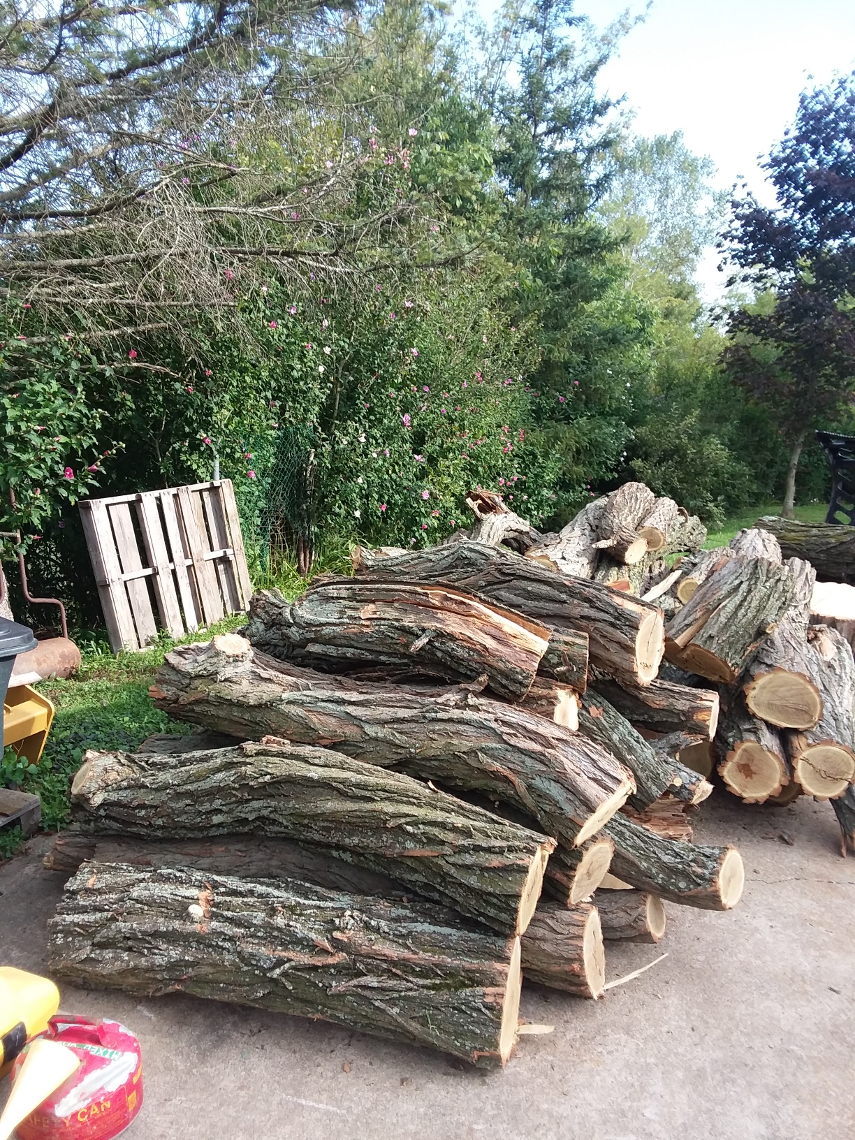

Just moving some wood.

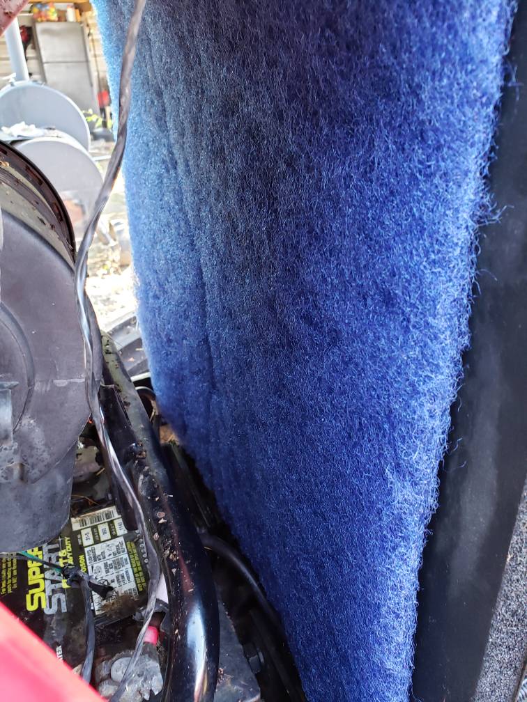

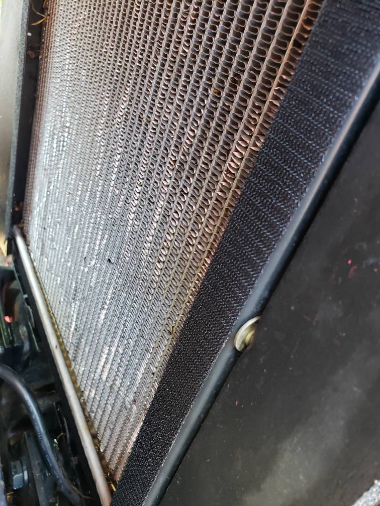

Here's a mod I did to keep my radiator from clogging on my older 4025. I cleaned the frame with electrical cleaner, and applied velcro, then put the filter material in front. When it gets dirty I can just shake it off. 20190902_155459.jpeg20190902_160412.jpeg20190902_160507.jpeg20190902_160737.jpeg
