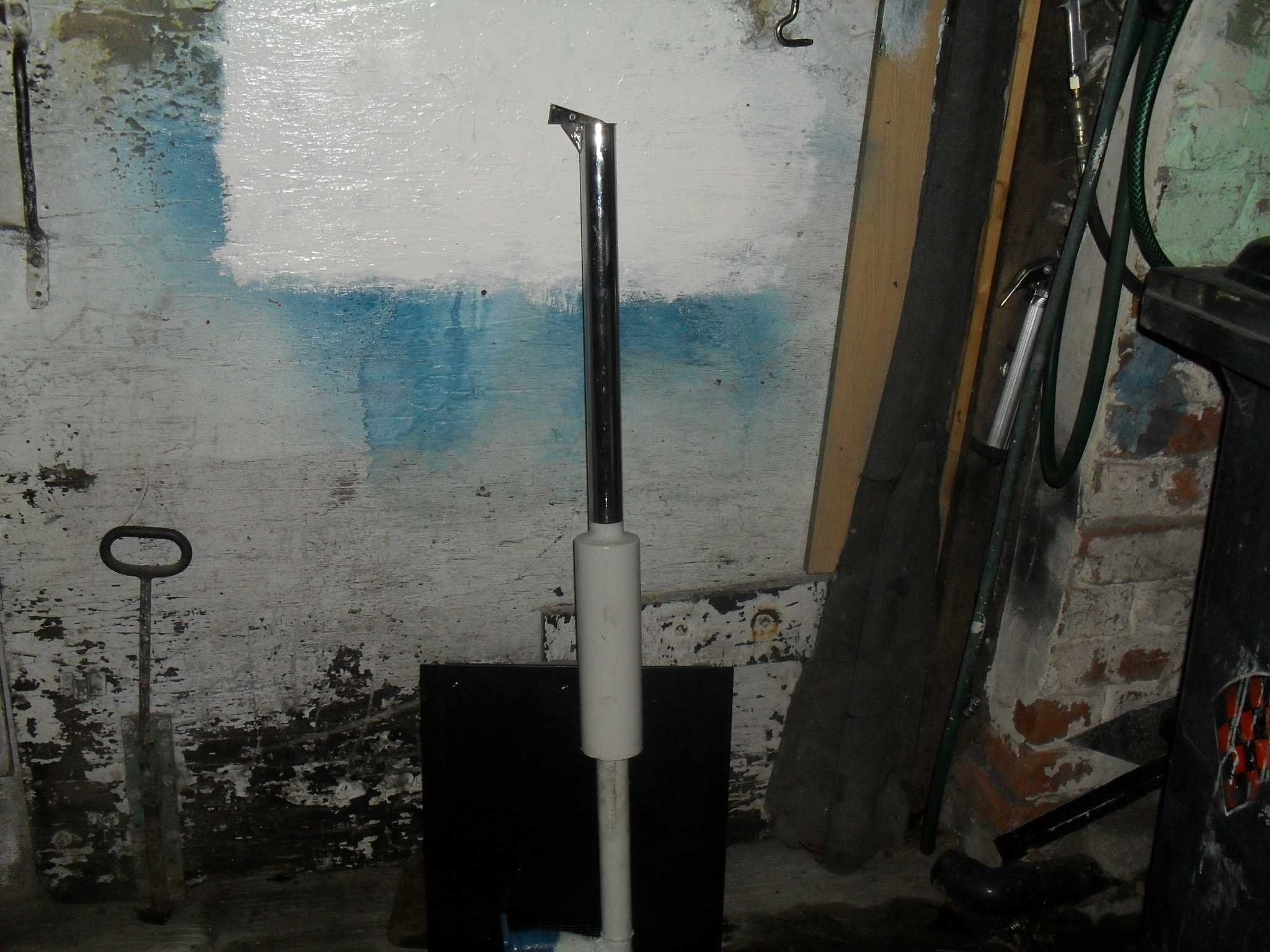

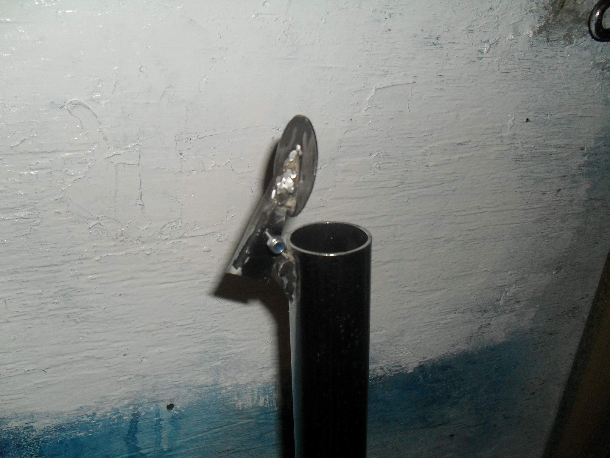

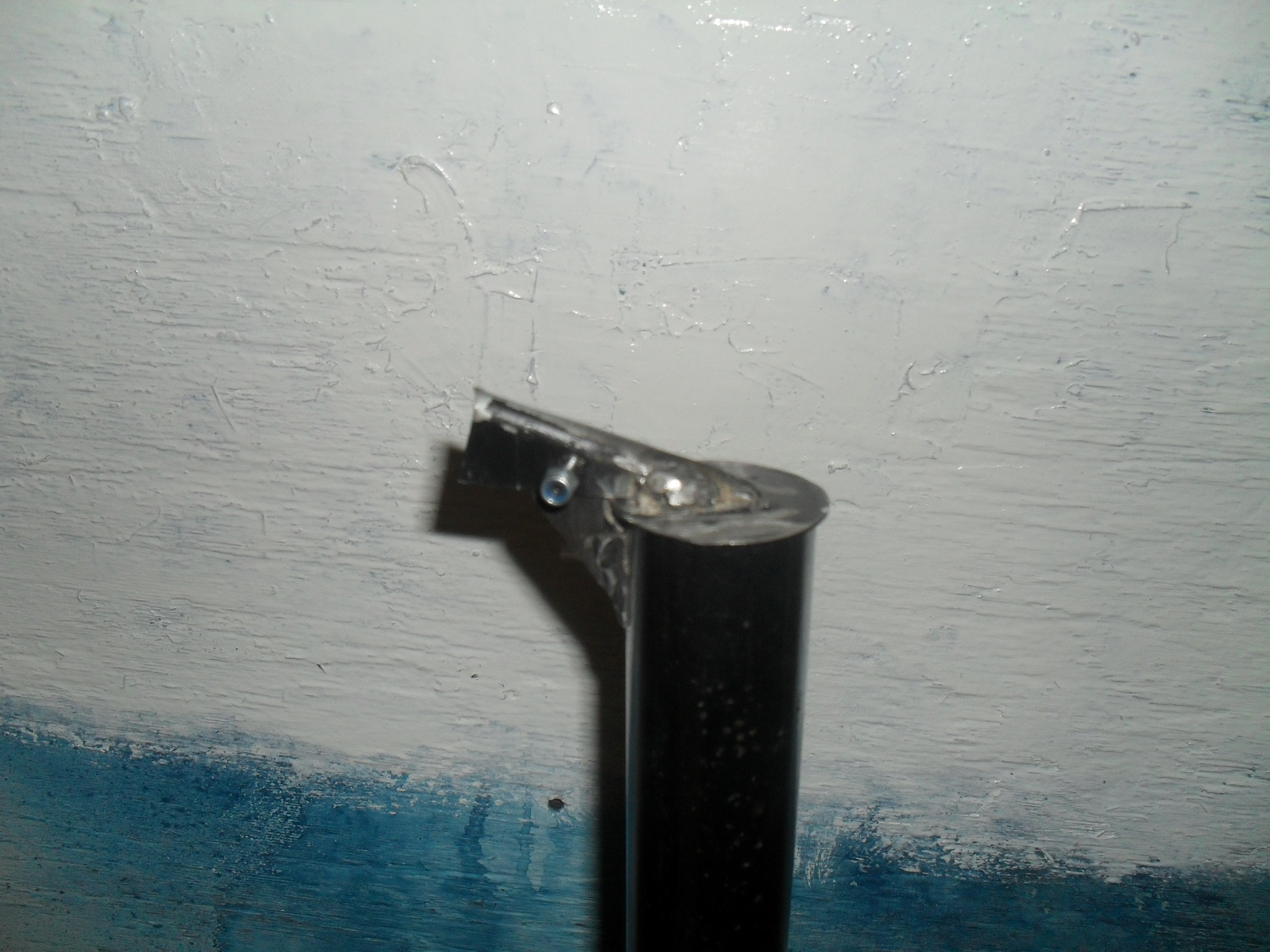

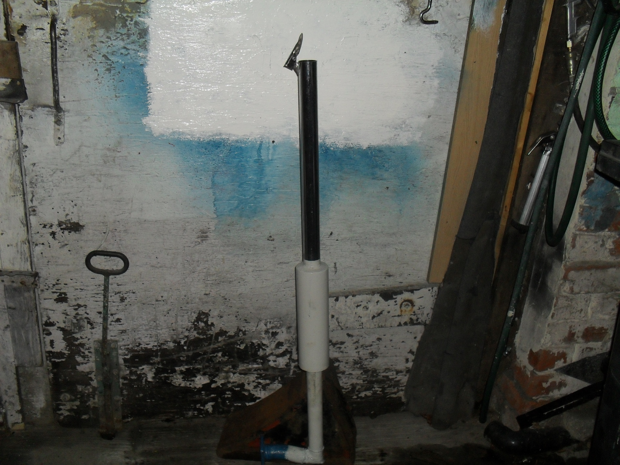

Made the raincap to finish the exhaust off, ready for a little paint now and see how she looks.
All made from scrap, who needs to pay 150 pounds ($225) for a new one:D

Had another few hours by the fire fiddling with the tractor.
Fitted the exhaust stack complete with raincap on top and heat shield at the bottom to hide my crap welding.

OOhh and started the engine just to watch the raincap flutter up and down:)

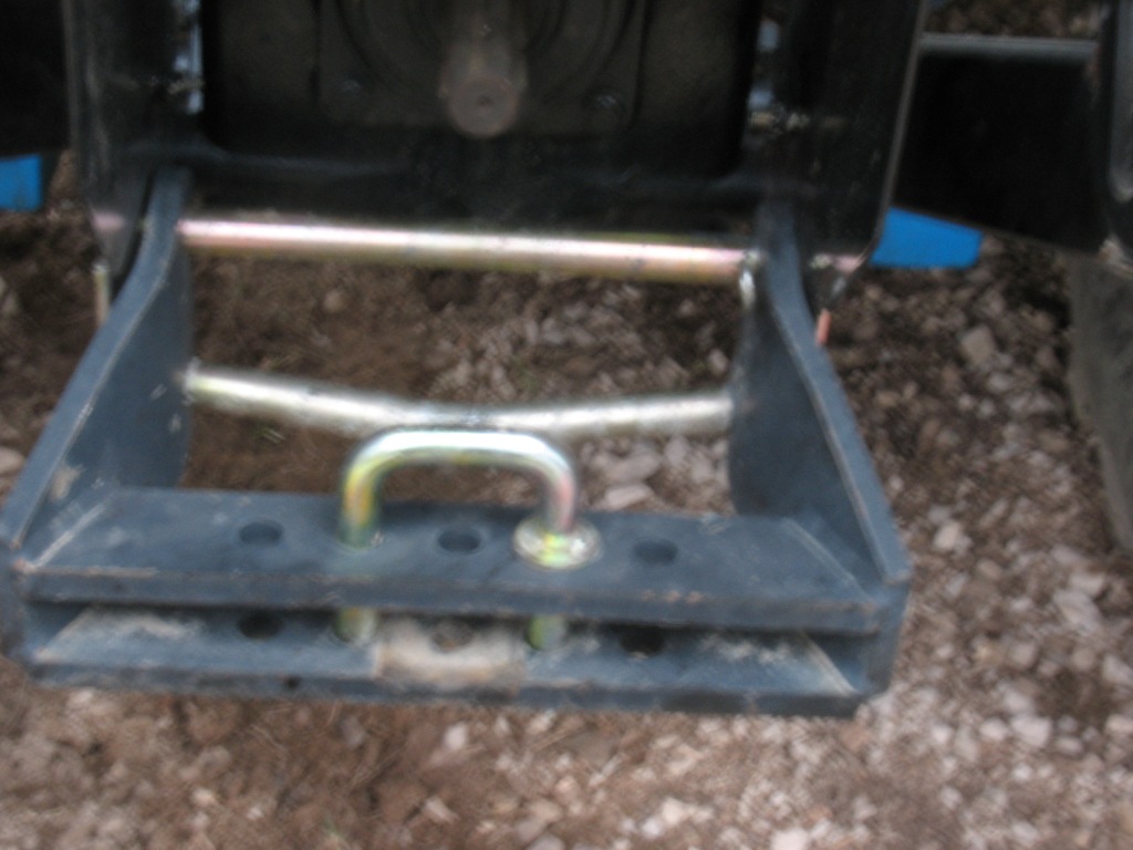

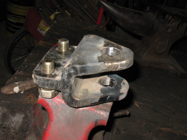

What I did to my tractor today: fixed the broken drawbar hitch and bent rod. It got bent & broken trying to pull out a fully loaded 14 yard dump truck with a 3/8" chain. Actually broke the ears off the pin attachment point for the drawbar. I welded them back on, but have my doubts as to it holding much as the bracket appeared to be cast iron rather than cast steel. At least it didnt crack out when I welded it with 7018. That bent rod was a PIA to straighten. I picked the whole rear end of the tractor up with hydraulic jack centered on the V bend and didnt straighten it when cold. Had to heat it with a torch to get it straight enough to remove from the bracket then pound it with a 16# sledge hammer to finish straightening it.
