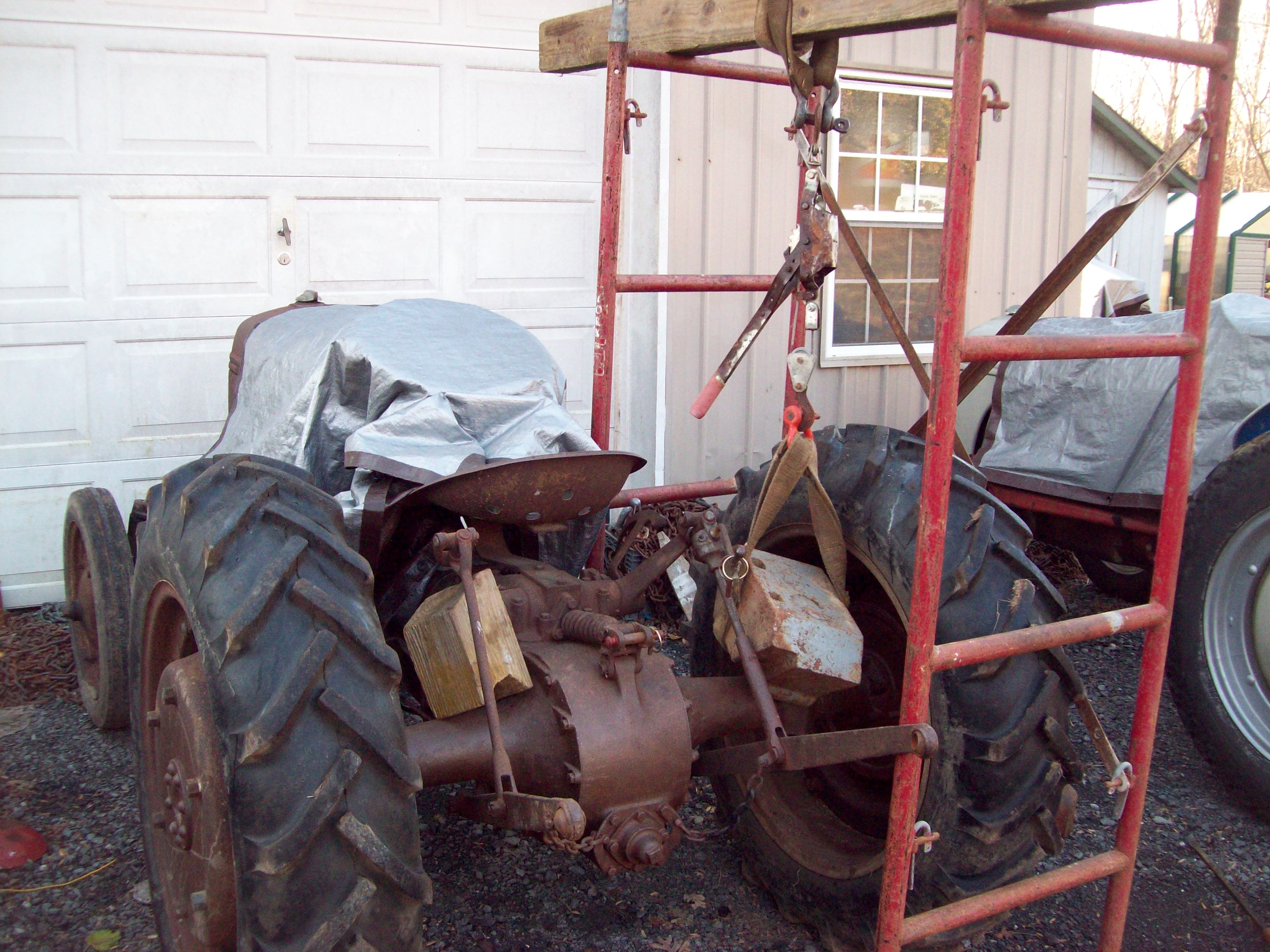

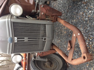

Thanks guys. Got the dearborn snowplow frame mounted on my 2n yesterday. Hoping we get no snow and I won't have to use it this year. It never seem to work out that way, although last years snowfall wasn't bad at all.

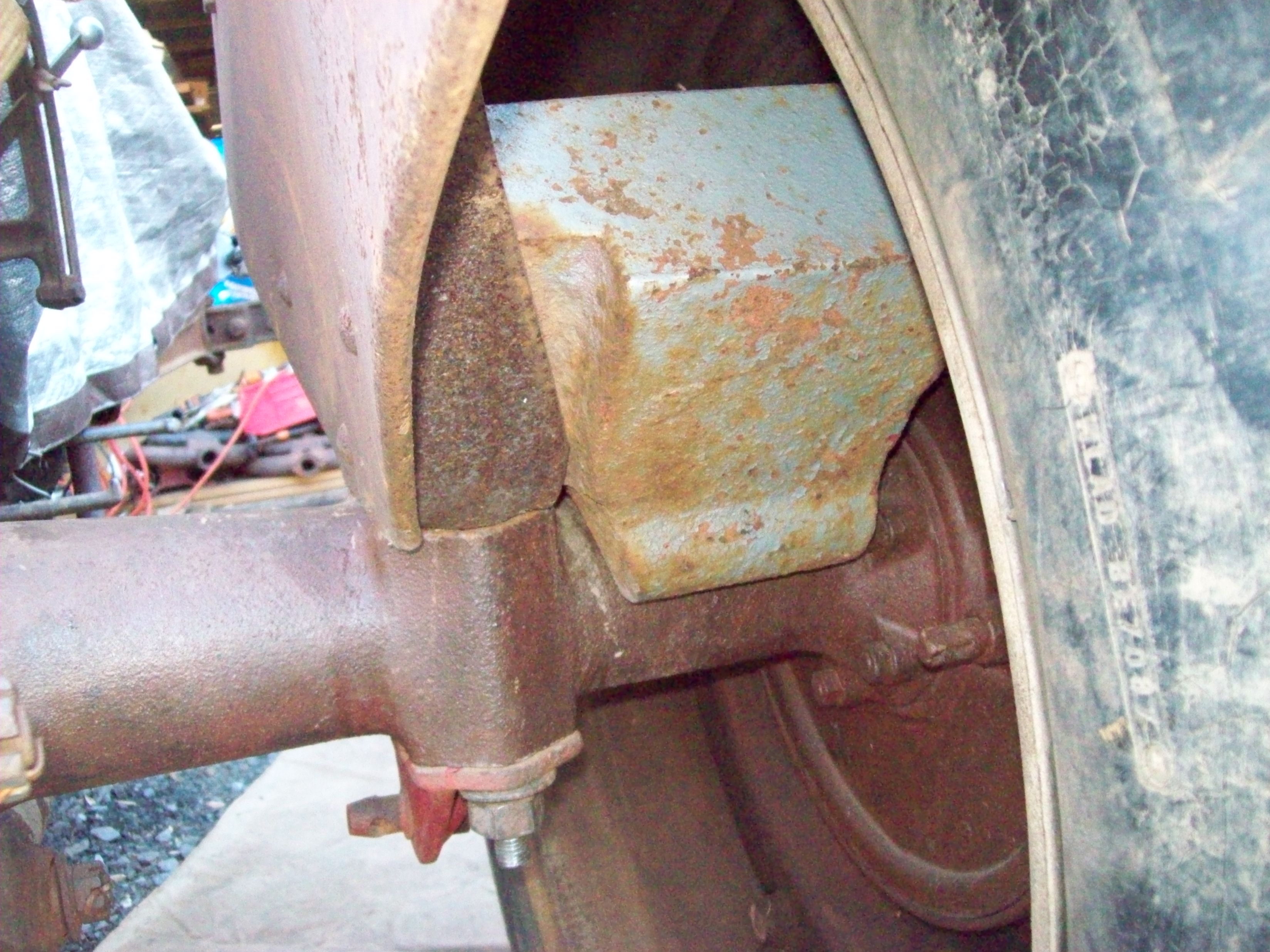

Also mounted a set of axle weights on the '40. Getting a little to old to lift them on without help.
Kirk

Couple chucks of iron there, Kirk. Heck, that'd be a job for anyone - regardless of how youngish they are.

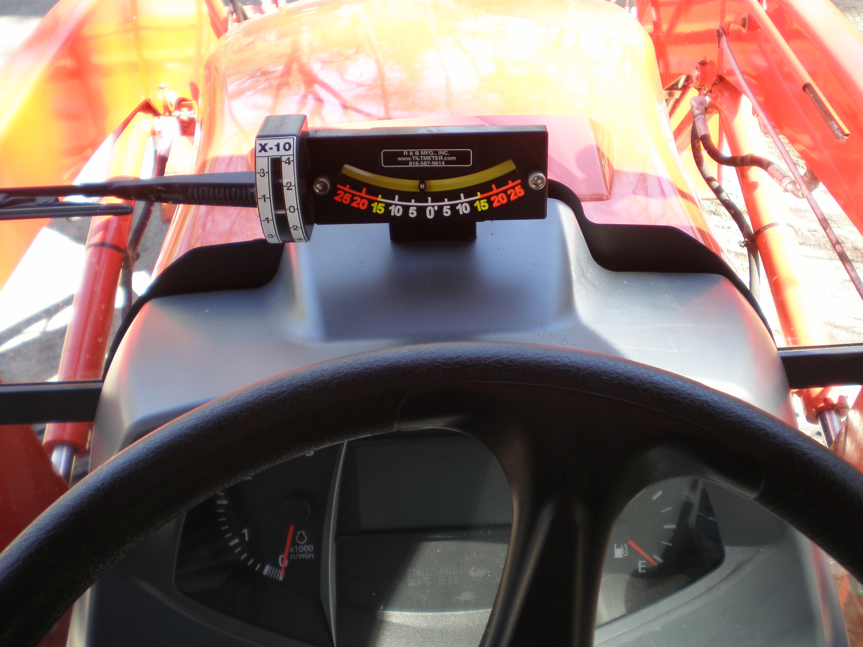

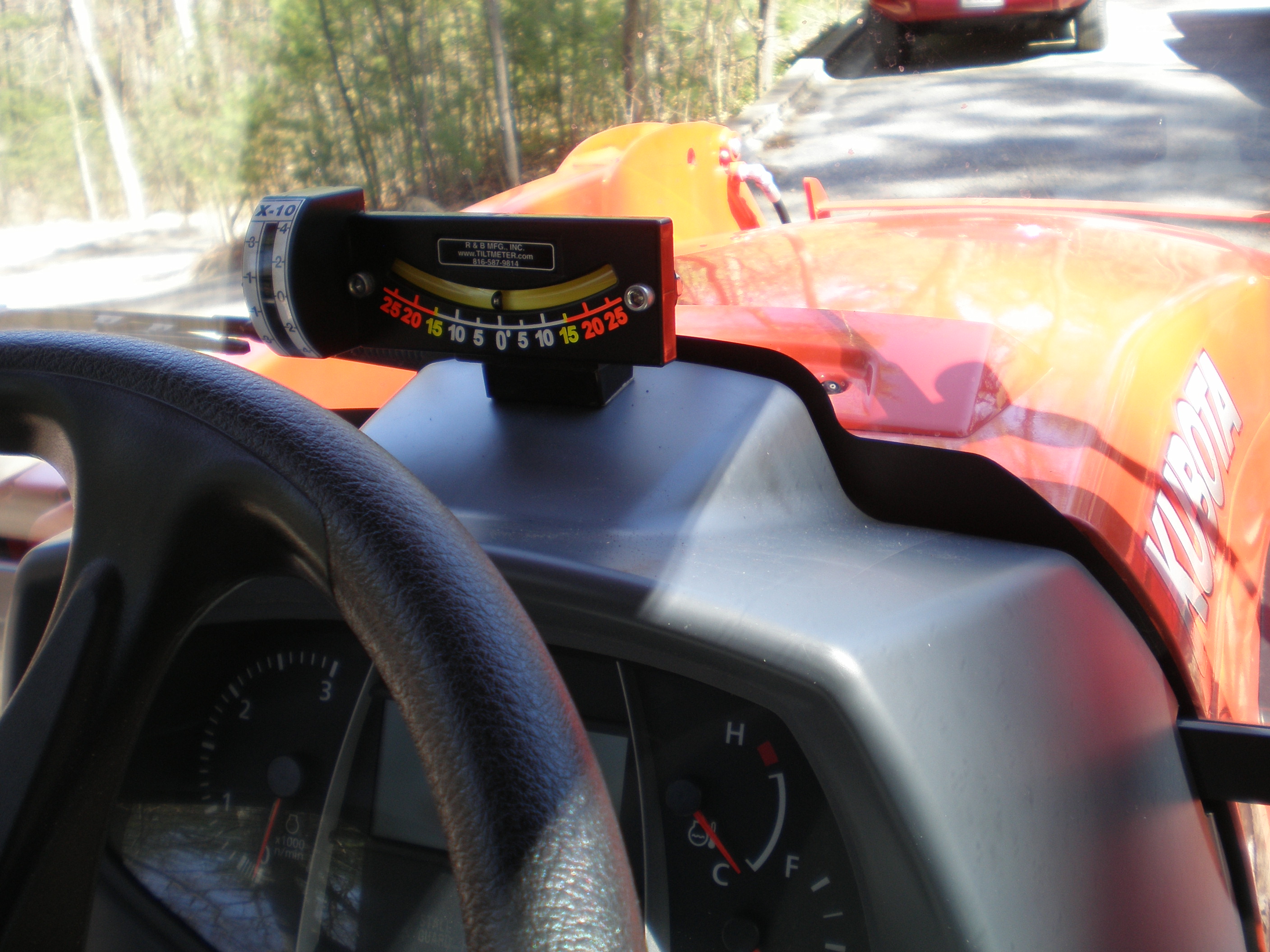

I bought a "tiltmeter" from the store here on TBN and installed it today. Real easy to install and it came out great. Lots of hills and uneven areas on my property. This works nice!P4220001.JPGP4220002.JPG

Wouldn't have guessed landscape would be so rolling as coastal as Rowley is, must be handy to have that tiltmeter. Thanks for including a photo!

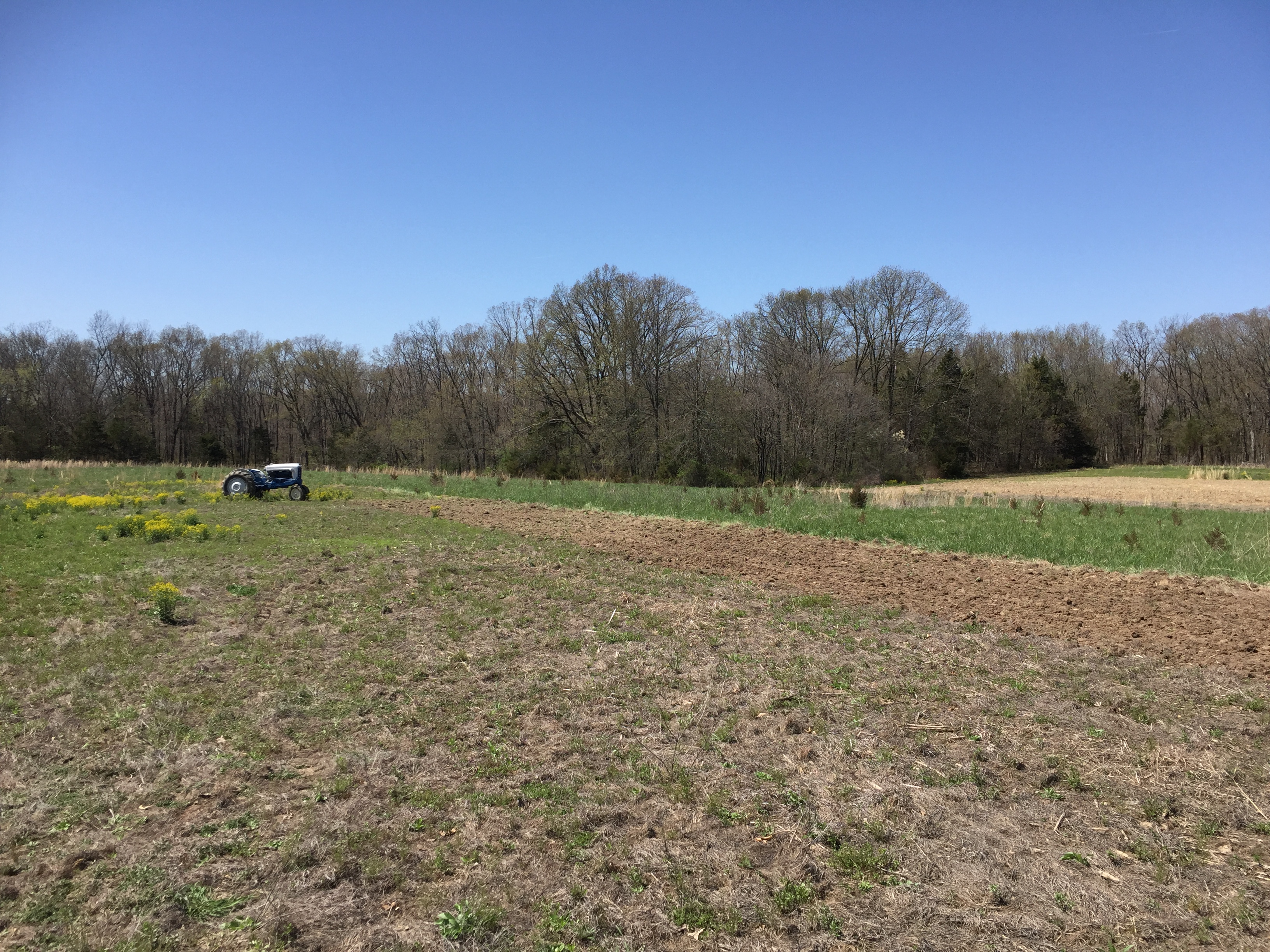

This past week I went up to my little 20 acre hunting paradise and put in a couple of acres of food plots. I brush hogged some trails in the woods that needed maintenance, then disced and dragged the plots after seeding. Discing seems to be a decent load on the tranny. Without a temp gauge for the tranny how do you 'monitor' tranny temp?
It gets pretty warm/hot to the touch. I can place my palm on the tranny case between my legs for a couple of seconds, but its pretty darn hot. My gut tells me all is fine, but I know you guys have a millions hours of experience. I have a '63 4000 with a SOS. What is the highest gear I should be discing in? As always, thanks for the input. The input from this place has been priceless. Here is a pic of my tractor next to small dove food plot I planted a while back. I put in milo and sunflowersIMG_5268.JPGIMG_5268.JPG
