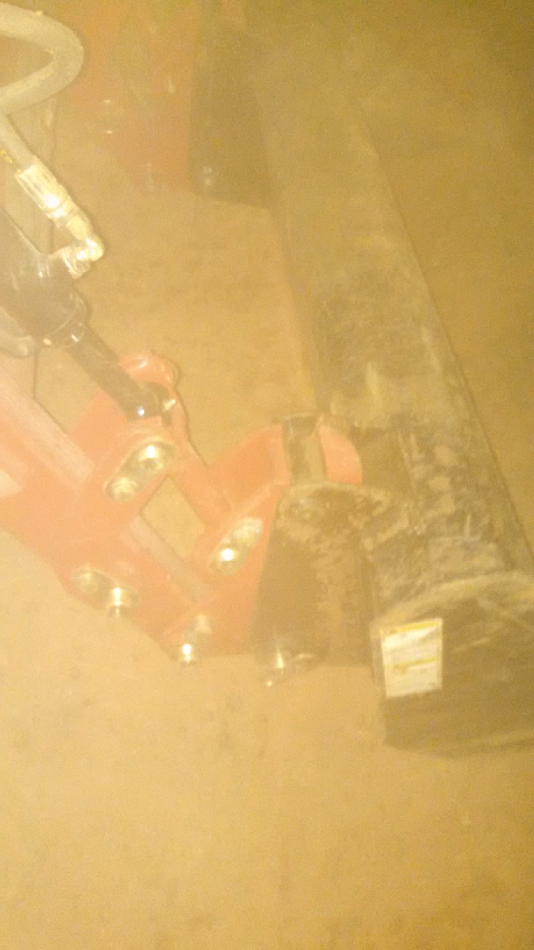

Here is what I have Winston. Hopefully you can see it. Bucket attachment requires a pin at bottom and a hook type deal at top. Everything I've looked for online seems to be a bust beyond hiring a fabricator to make me some forks. bucket2.jpg

Here is what I have Winston. Hopefully you can see it. Bucket attachment requires a pin at bottom and a hook type deal at top. Everything I've looked for online seems to be a bust beyond hiring a fabricator to make me some forks.View attachment 498694
That does look like a type of quick attach. I am hoping the Mesquite gentleman will contact me back.
He did email me back and I sent him your picture and awaiting his response to that.
I know vn tractors is a sore spot for many and sure not meaning to bring everybody down on this gentleman. Just want you to see his ad. vn YNM FX 285 Tractor with Front End Loader
I did speak with "Andy" on the phone and he said your loader is an older model, the new ones are no longer like that. Very hard for me to understand him with my old ears. One or both of us didn't speak very good English. He is not from around here anywhere. Seemed to indicate you might have to go with bucket clamp on type forks. Looking at your picture I would think there might be quick attach forks out there that might not be that hard to adapt to your loader. Got to have a little fabrication abilities I imagine.
   / What did you do to your Yanmar today? #96
Worried that the bucket clamp on style might damage my bucket if I try a pick that may be a bit too big. Then I'll be looking for a hard to find bucket or fabing a fix for it too. If the attach points on the new style bucket in the CL ad you sent have the same spacing, it seems like it would be a easy fab change to accommodate my top hook style. I'll wait a bit to see if a set surfaces. Otherwise I guess I need to practice my weld beads and start from scratch. Thanks for looking into it Winston.
