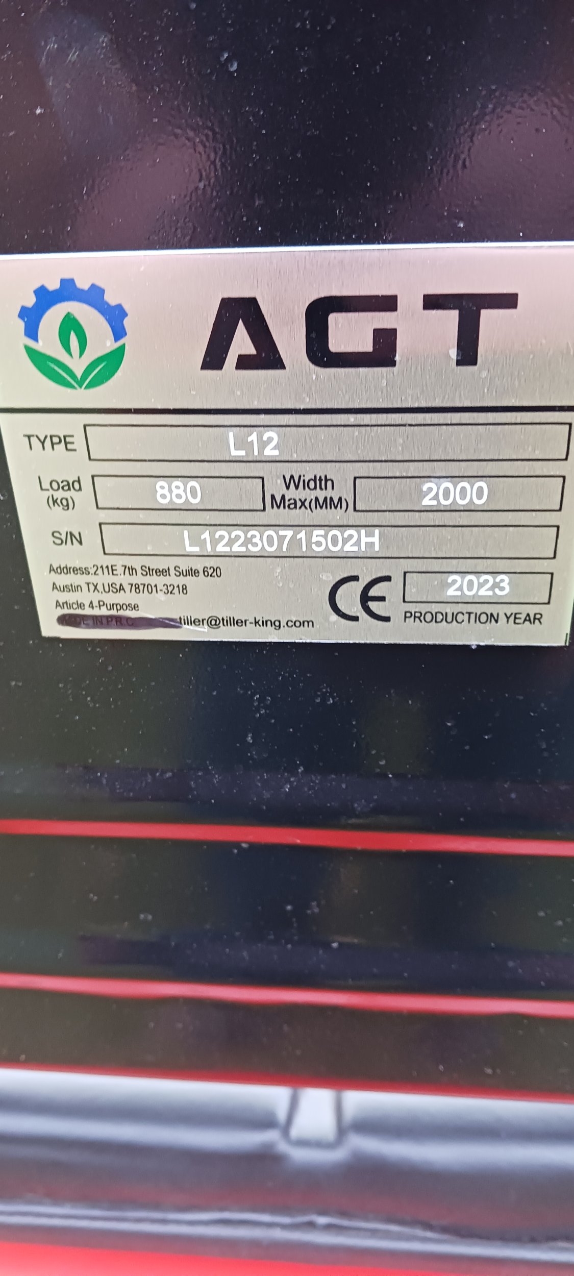

There has been a lot of people buying these little diggers, so I want everyone to know the Flaws you may find on the L12 by AGT or Agrotk. First, there is a known issue with the hydraulic pick-up tube. Its too short and if you are operating on an incline, you may experience pump cavitation. The manufacturer knows about it and has sent some owners an extension to fix the issue. They have not sent me one yet. Second, the choke cable is not installed correctly and if you dont check it, you may have trouble starting the Briggs engine. Third, most of these diggers have issues with excessive heat. You will want to follow some of the posts here to find ideas to help cool your engine and hydraulic system. Fourth, Its nice that the L12 has a factory installed oil cooler and fan, but it has NO hydraulic filter other than the 100 micron screen in the tank. These are good little machines IF you give them extra love . That means keeping fluids clean and changed regularly, and proper filtration is very important. If you buy one of these guys, budget an extra $200 for the filtration you need to add. Fifth, you may get a machine that is put together very well, or you may get one that has loose parts everywhere. Be prepared for some checking, tightening, changing, improving, improvising, and researching. My machine has 22 hours and not a single loose bolt yet, and I have checked everything. your results may vary!. So, the important question is this;; Would I buy it again? YES, I would not hesitate to buy my L12 again, and I gave more for it than 20231125_164752.jpg they are selling for now.. Last point,, use caution when considering an auction machine. Check for an AGT identification plate. A legitimate serial number will start L12xxxxxxxx

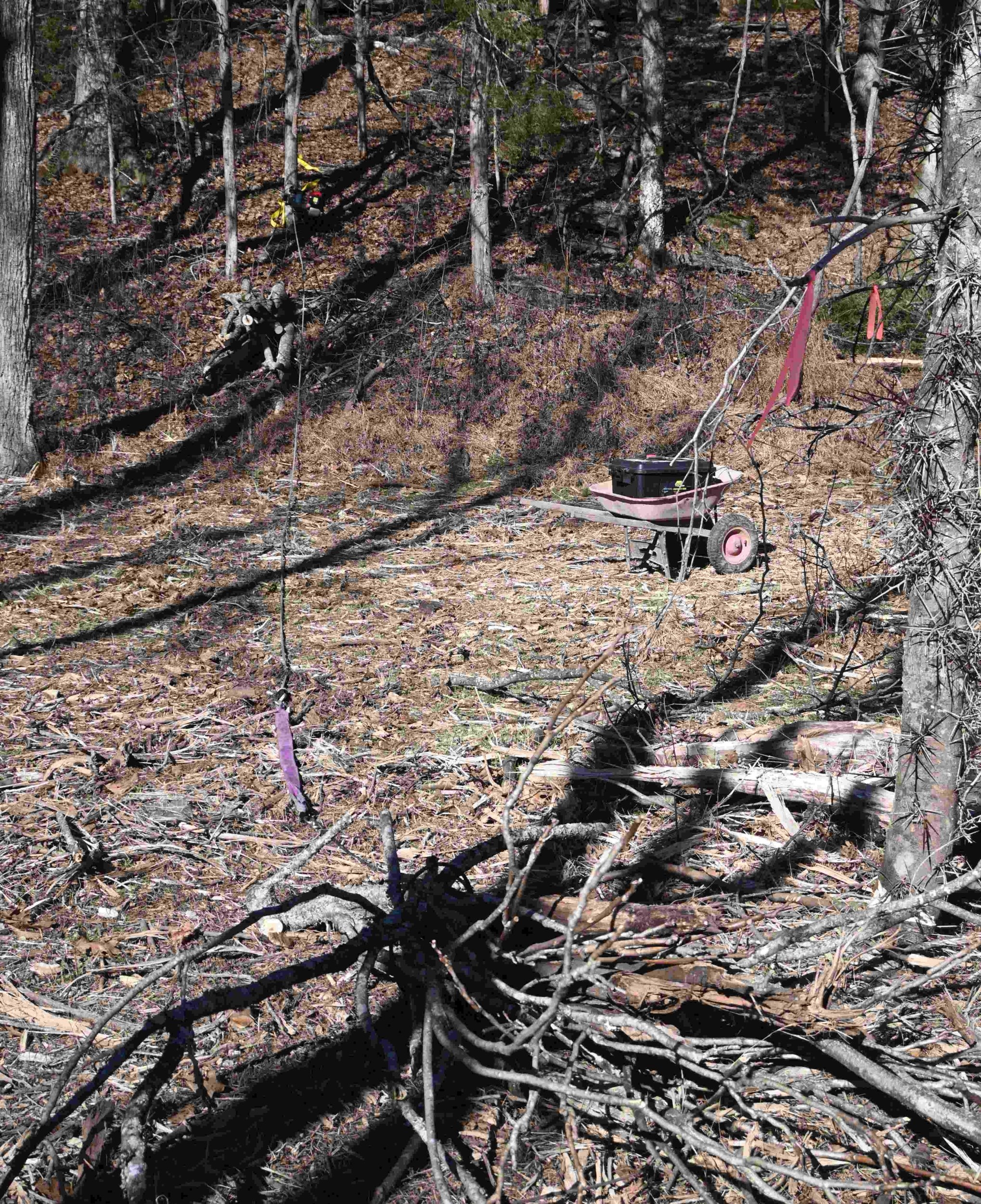

I forget who suggested it, but someone suggested using a tow behind yard cart in one of the other mini x threads.
Between carrying a portable which, rope, pulleys, chainsaw, etc., I think a yard cart would be my best option if there's a way to add a simple tow hitch?
The thorn tree to the right is one of the reasons a tracked mini appeals to me. Plus, there isn't much room in some of the areas I need to work for a full size tractor. A grapple would be handy for dealing with the thorns.

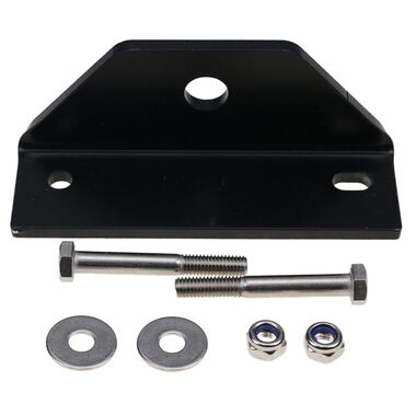

I think you can easily attach a hitch to the blade and then spin the house so the bade is behind you towing the cart. you could weld or bolt a Zeroturn hitch to the blade.husqvarna-zero-turn-mower-rear-hitch-kit-for-rz--z200-models-587-48-12-01.jpg

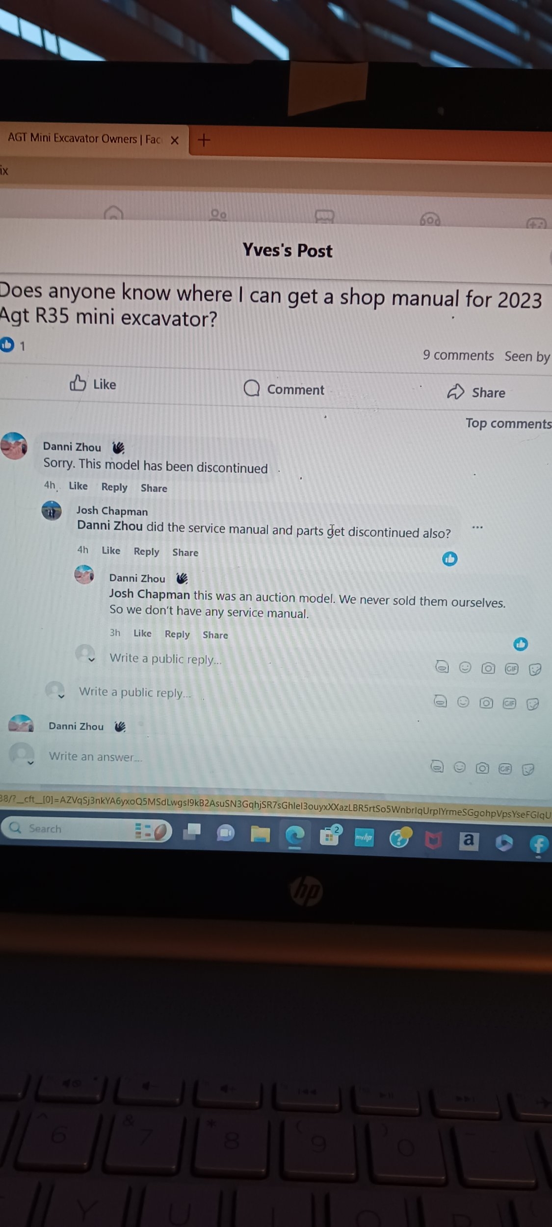

Someone asked why I am hesitant to buy auction machines. I've noticed several posts like this so I thought I would share the most recent one. Link didn't work so I took a pic. Its currently on FB group.

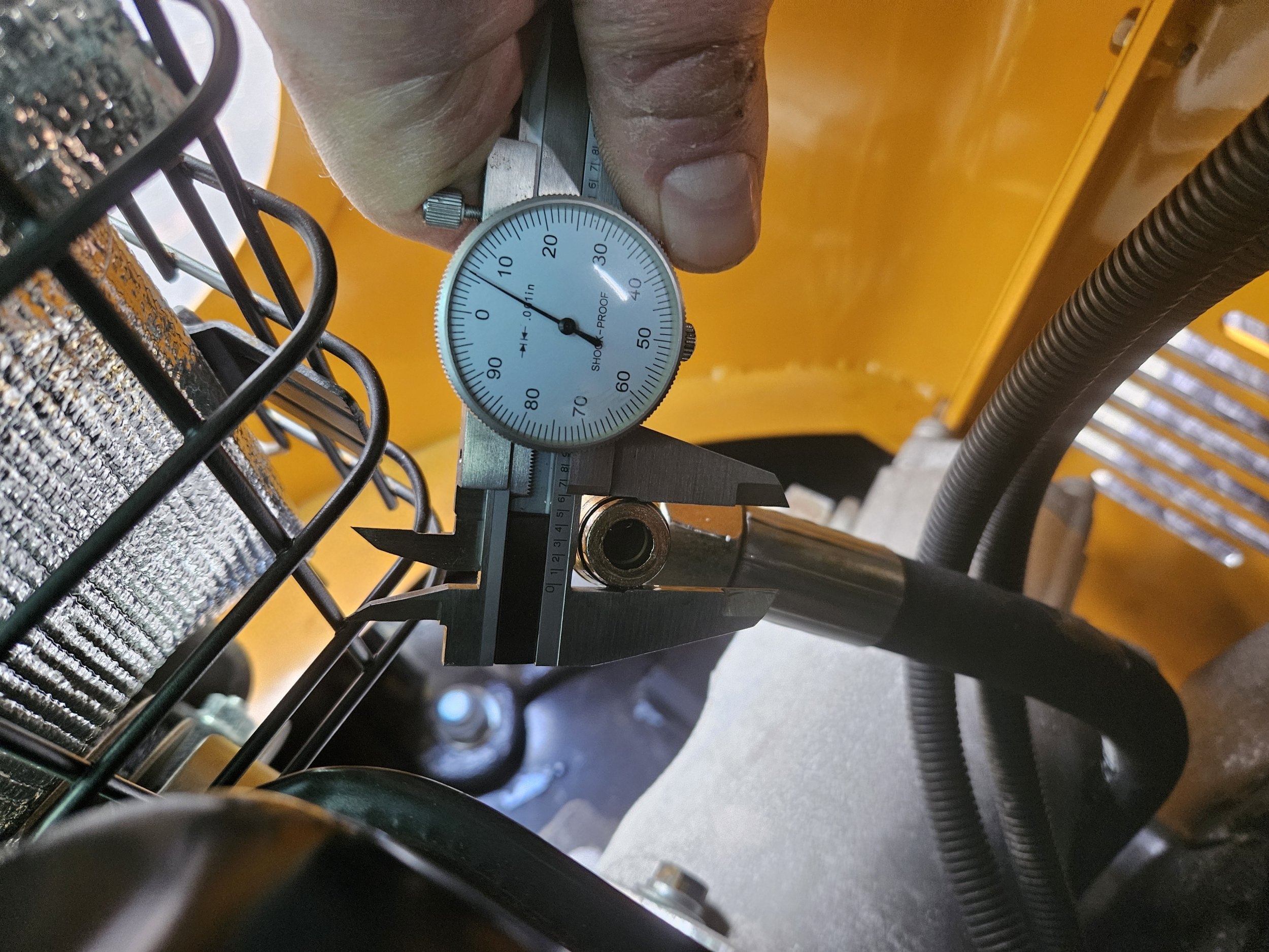

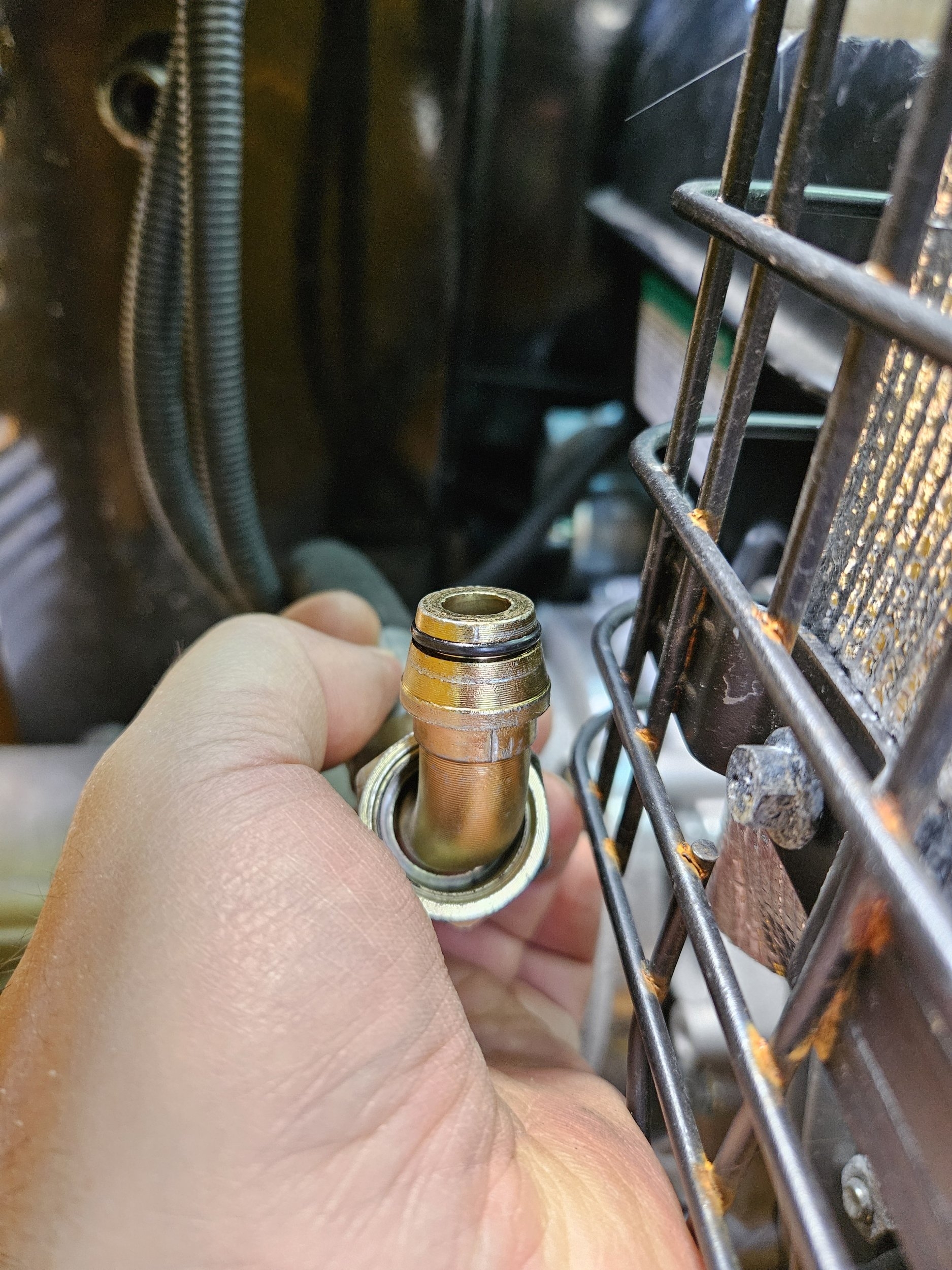

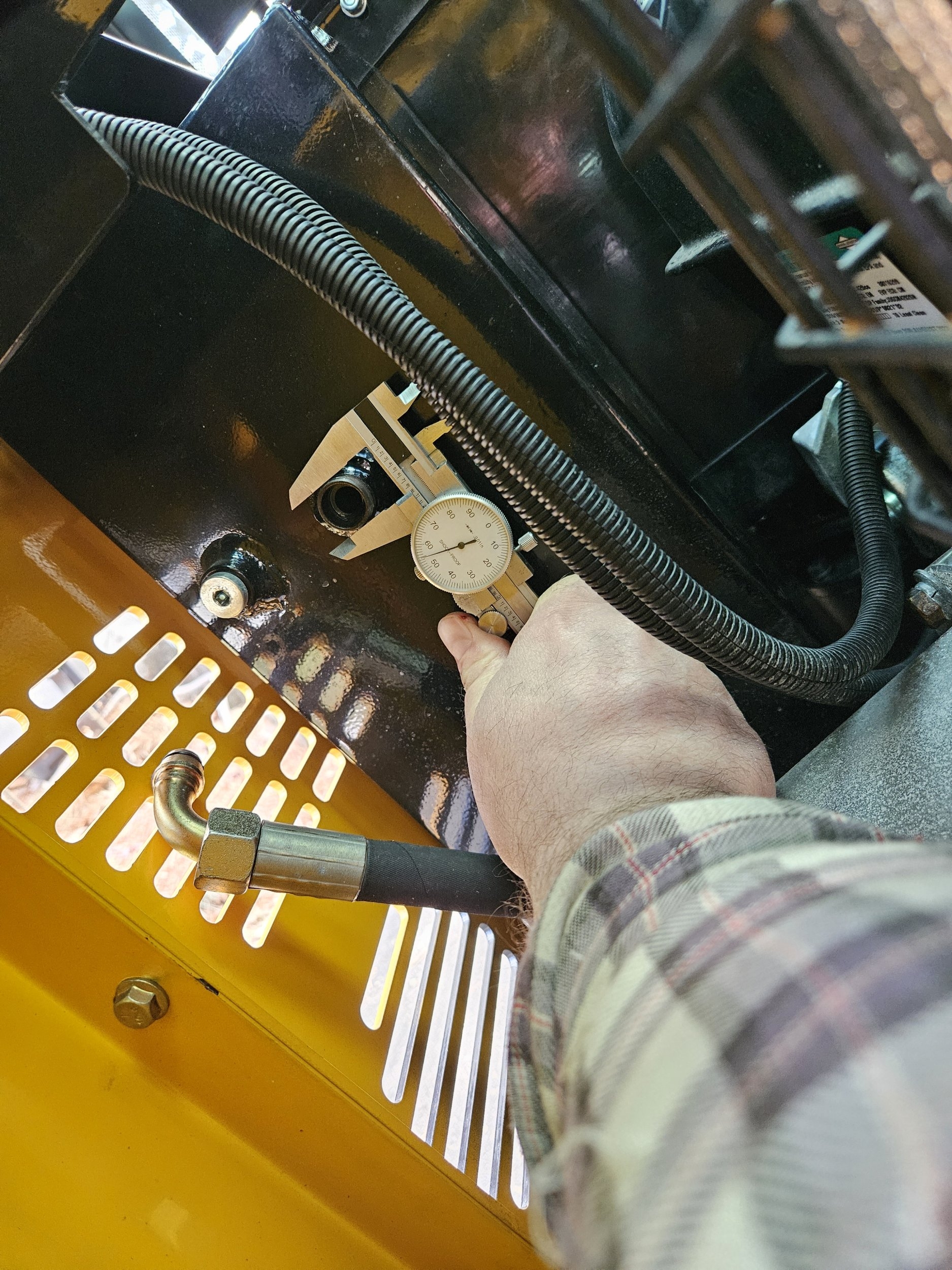

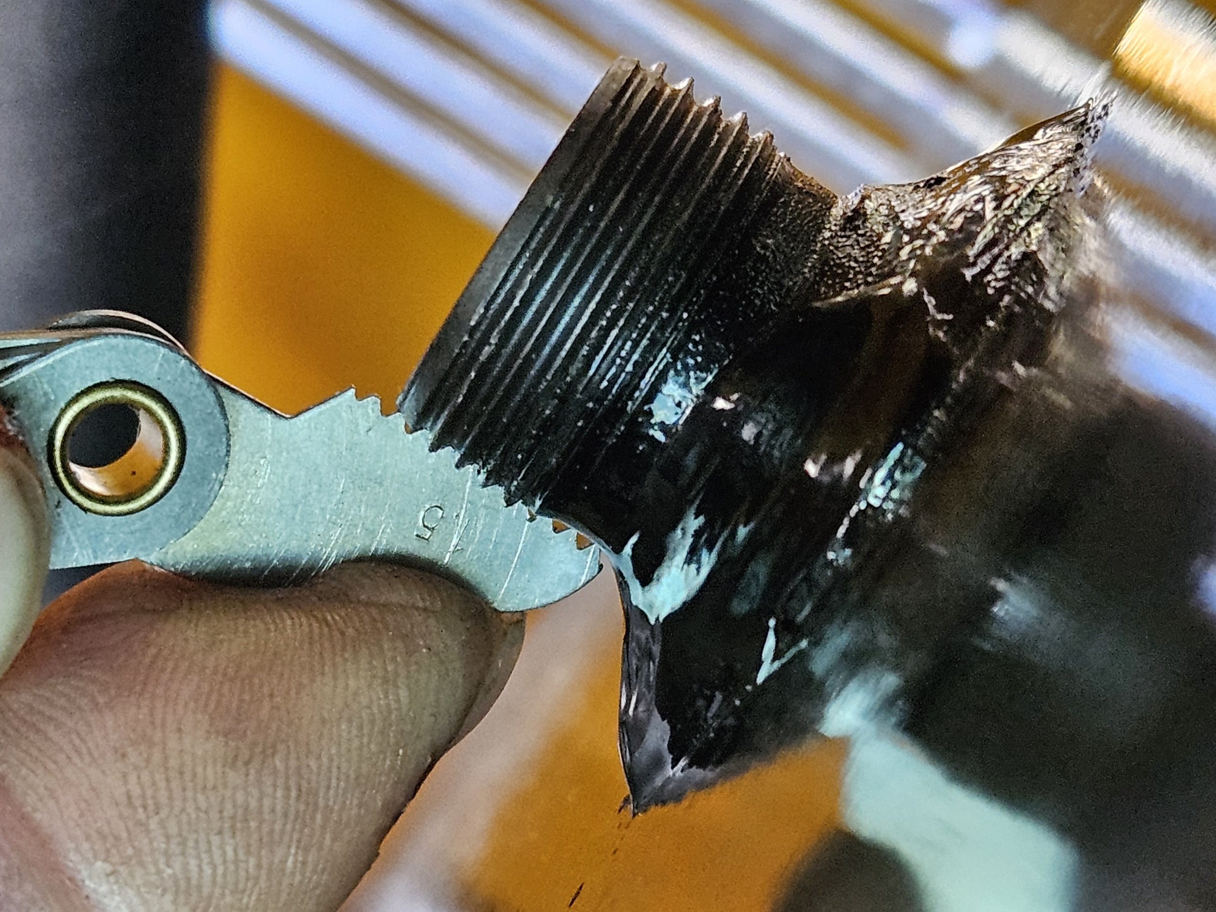

I pulled the hydraulic return line off today and took a bunch of measurements and pictures to help find the right fittings to convert to/from the inlets for my hydraulic filter that I'm adding. I haven't even had a chance to try to figure out what fittings I'll need but here are the pictures of the fittings and measurements.

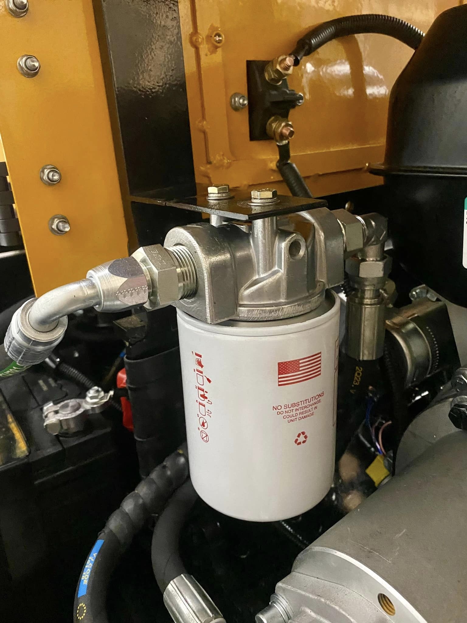

If this is the filter you are installing, it may be as simple as 2 adaptors. My setup is much more complicated due to the factory cooler, which is rumored to have fittings not available in the USA. another option would be to remove your 2 lines and take them with your filter and have 2 new lines made.
   / What did you do with your Chinese baby digger today? #210
You want to measure the OD of a male threaded fitting. These are DIN metric O-ring fittings. Here is a chart of the ODs for DIN Light:
The OD is going to be 12, 14, 16, or 18mm. The thread pitch will likely be 1.5mm per thread. I doubt you have DIN Heavy fittings.
I post a chart from DiscountHydraulicHose.com on the back of my workshop door. They have all the fittings you need, plus don't forget to buy some extras, including plugs when you order. Or just go to a local shop if you have one.
