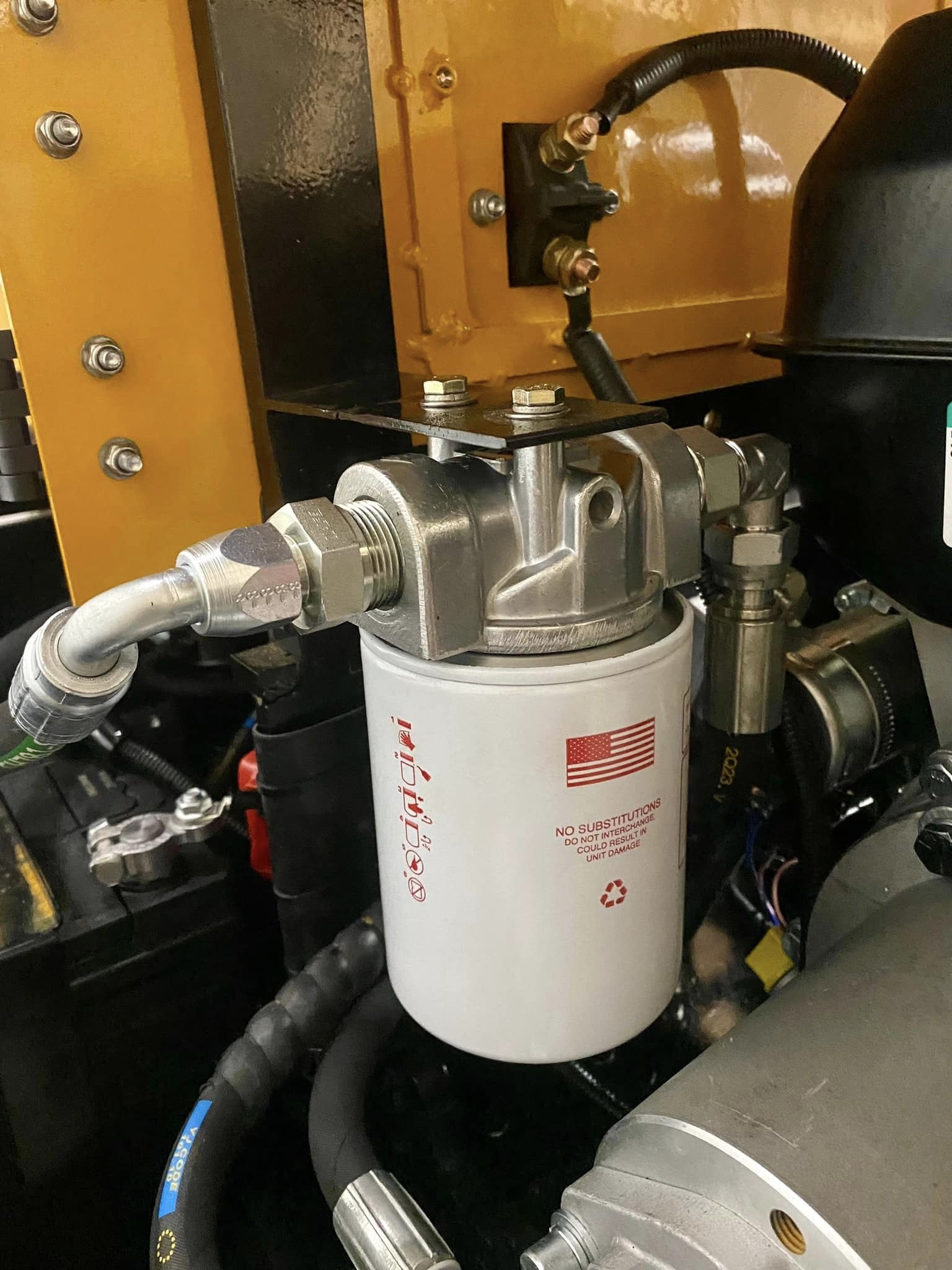

If this is the filter you are installing, it may be as simple as 2 adaptors. My setup is much more complicated due to the factory cooler, which is rumored to have fittings not available in the USA. another option would be to remove your 2 lines and take them with your filter and have 2 new lines made.
Yes that looks like the one I have and I'm hoping to be able to plumb it in with just 2 adapters.

You want to measure the OD of a male threaded fitting. These are DIN metric O-ring fittings. Here is a chart of the ODs for DIN Light:
The OD is going to be 12, 14, 16, or 18mm. The thread pitch will likely be 1.5mm per thread. I doubt you have DIN Heavy fittings.
I post a chart from DiscountHydraulicHose.com on the back of my workshop door. They have all the fittings you need, plus don't forget to buy some extras, including plugs when you order. Or just go to a local shop if you have one.
I did measure the OD of the male side - it's one of the pictures I posted. Based on that measurement I think it's a 22mm and I confirmed it is a 1.5mm thread. I need to adapt to 3/4 NPT inlets on the filter housing. For the hose side of the housing I think I want a 5007L-15-12 adapter, but I don't see a -12 (3/4) offered - I'm only finding -08 (1/2). I'm not sure yet though - I'm still trying to verify.
I think the adapter for the hydraulic tank side of the housing would be 5307L-15-12, but again I don't see a -12 offered - only the -08. I may end up having to use the -08 1/2 NPT adapters and use another pair of adapters to go from the 1/2 NPT to 3/4 NPT.

I think the adapter for the hydraulic tank side of the housing would be 5307L-15-12....
Remember that the tank side of the return filter is low pressure, so you can use anything. I used the OUT side of the filter to support it, and therefore avoid having to fab up a support bracket. Also, filter upside-down is OK, and may allow for easier servicing.
I ordered a filter head with 1/2 NPT inlets instead. Then I should to get it inline with just 2 adapters.

For those who have the DIN M22 x 1.5 return hose called out in the reference sheet (which mine is) I would suggest a different hydraulic filter housing to anyone looking to add one. The one called out in the sheet has a 3/4 NPT inlet and outlet but I haven't been able to find an adapter to go directly from the M22 to 3/4 NPT. I did find adapters though to go from M22 to 1/2 NPT so I went with the Buyers FH625 which is a 15 GPM Return Line Filter Head with 1/2 Inch NPT Ports and a 25 PSI bypass.
