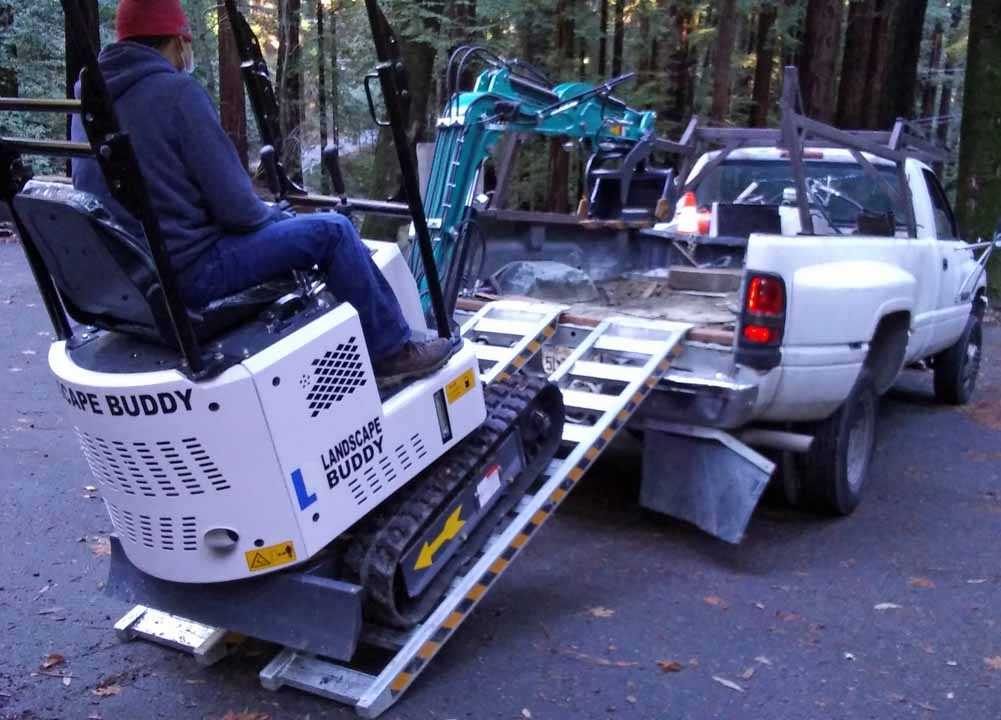

One of the earlier posts had a picture of a mini that had gone over backwards when trying to load on a trailer. I noticed that the boom was forward rather than how I do it with the boom facing opposite of the trailer so that I can use it to prevent any potential of tipping. Adding more rear ballast would guarantee you need to always have the house and boom face the downward side.
That is a traumatic video. View with caution.
That said, on steep slopes, there are ways to safely have the boom uphill, or boom downhill. Swinging the boom around from uphill to downhill leaves you at risk of rollover because then the downhill boom has to be used as an outrigger and there is a moment when you have no outrigger.
You can not dig with the boom and blade downhill on a steep slope, since any additional force, or just lifting your outrigger tips you over. I have not tipped over, but I have experienced these limits many times.
Also, when driving up a really steep hill or ramp, the boom downhill, acting as a outrigger, puts most of the traction on the downhill ends of the tracks. So, extending the boom and dipper way out uphill is the only way to get up. Boom-downhill is only for driving downhill, sliding the outrigger.
I posted this earlier, but Jason is driving up his roughly 40% ramps with boom uphill, extended. Blade-uphill would also help with balance, but he wanted to move the machine further forward than that would allow.

Is the machine Jason is putting in the truck similar to our machines? In other words, can I expect to go up slopes like that? Thats impressive. I also like the 2nd gen Dodge..
   / What did you do with your Chinese baby digger today? #239
It is the same basic size, but built in HeChuang factory, not Rhino factory like mine. This particular one has the Kubota D722 10hp engine, hyd thumb, and swing-boom, added at the factory at his request. Filtration and cooling, too, IIRC.

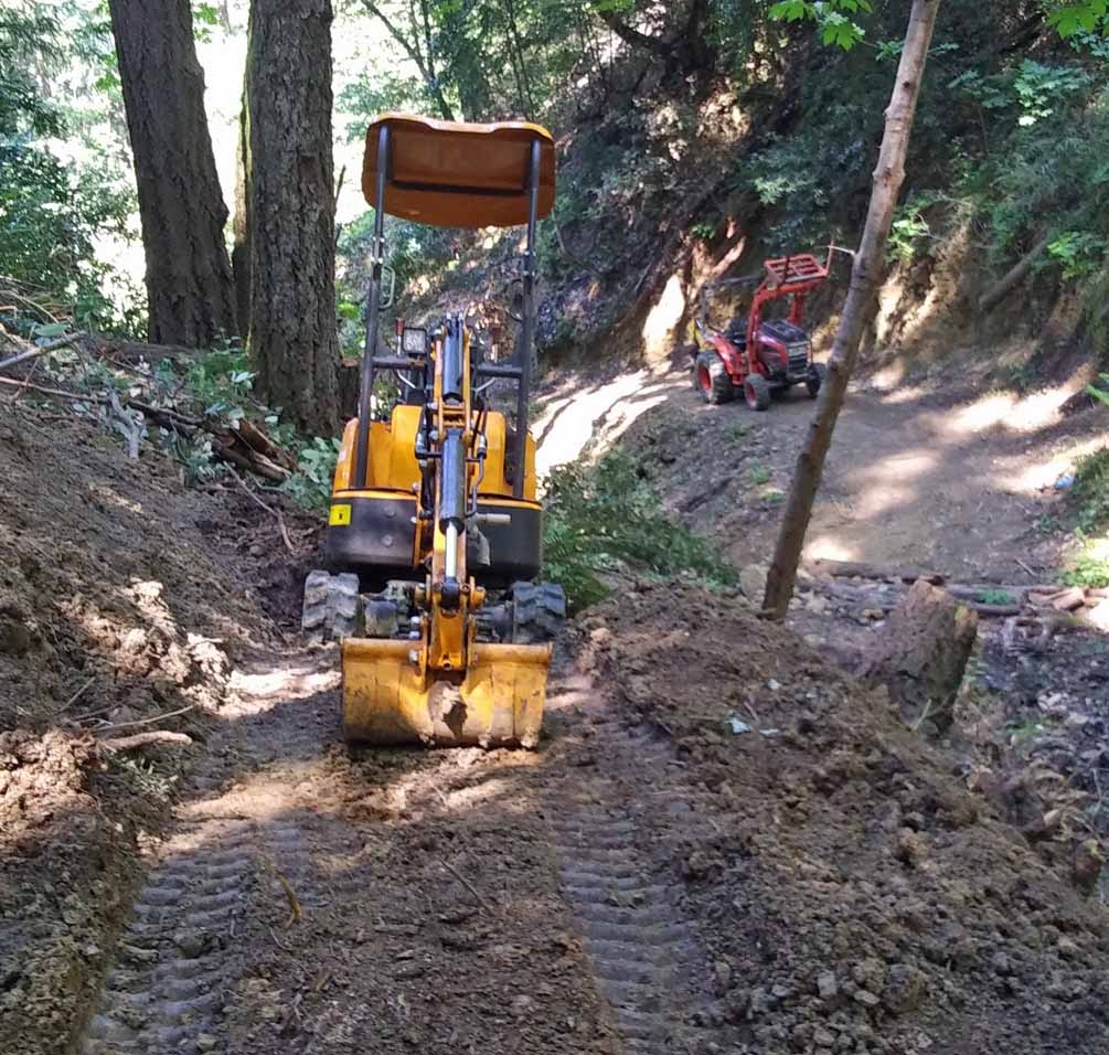

Mine goes up slopes like that (40%), but surface has to be smooth and damp (photo).
Impressive. I dont know if I can get used to going up and down hills that steep!! maybe if I had an E-brake and 3 point harness. Trails for hiking? Mountain biking?
