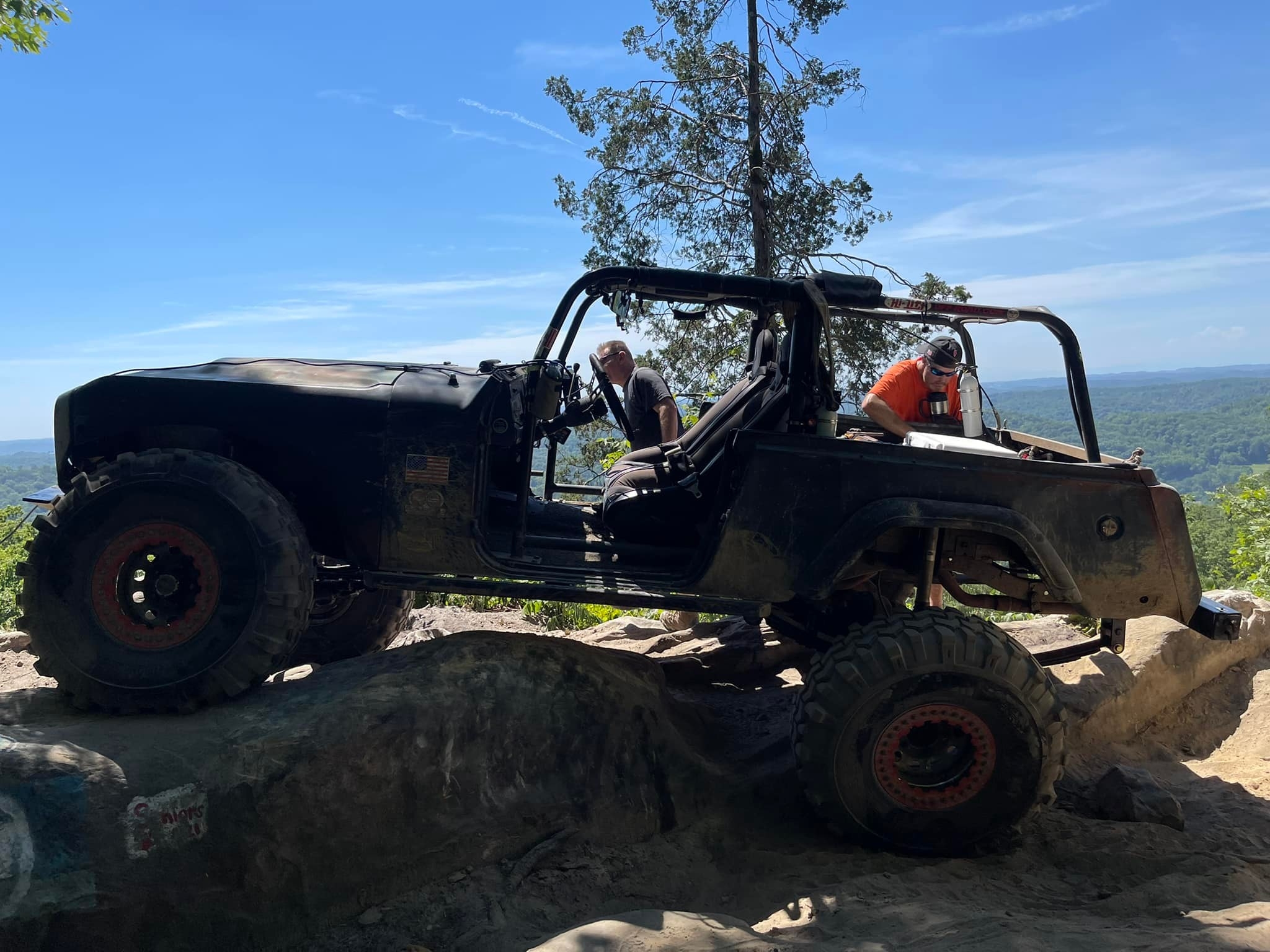

As a 4th generation hack (GGGF was a clock maker/repairer, GGF was a "loom mechanic"/mason, GF was carpenter/diesel mechanic, and late father was small engine mechanic), believe I've the braincells & tools to fix their shortcomings. Have been doing the same thing for 20+ years on my old Jeep...
