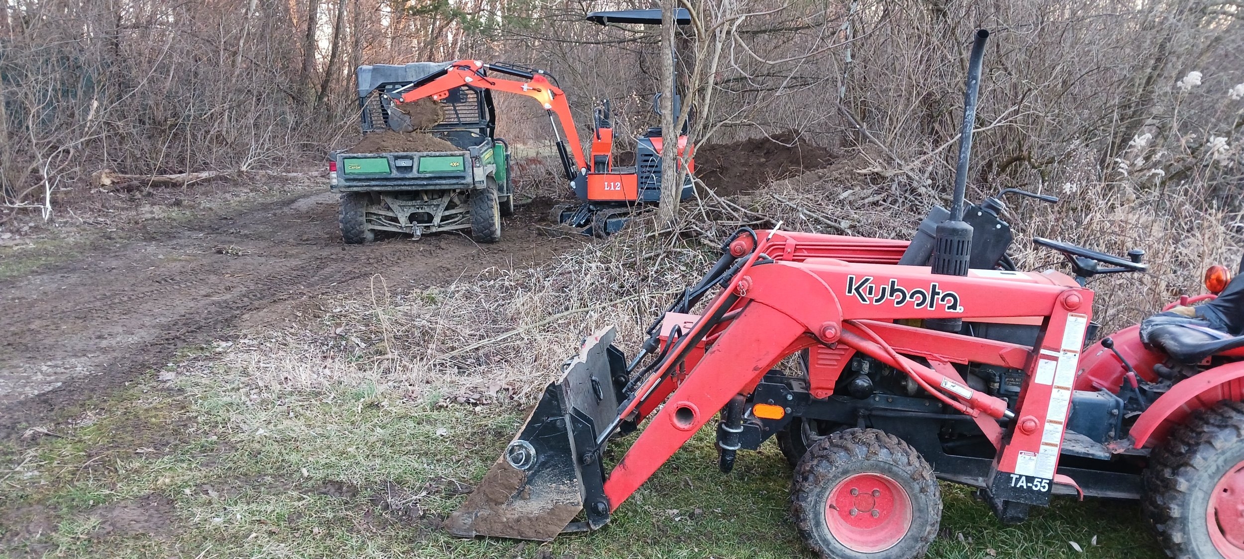

Another nice day, so went to work on the culvert repair.

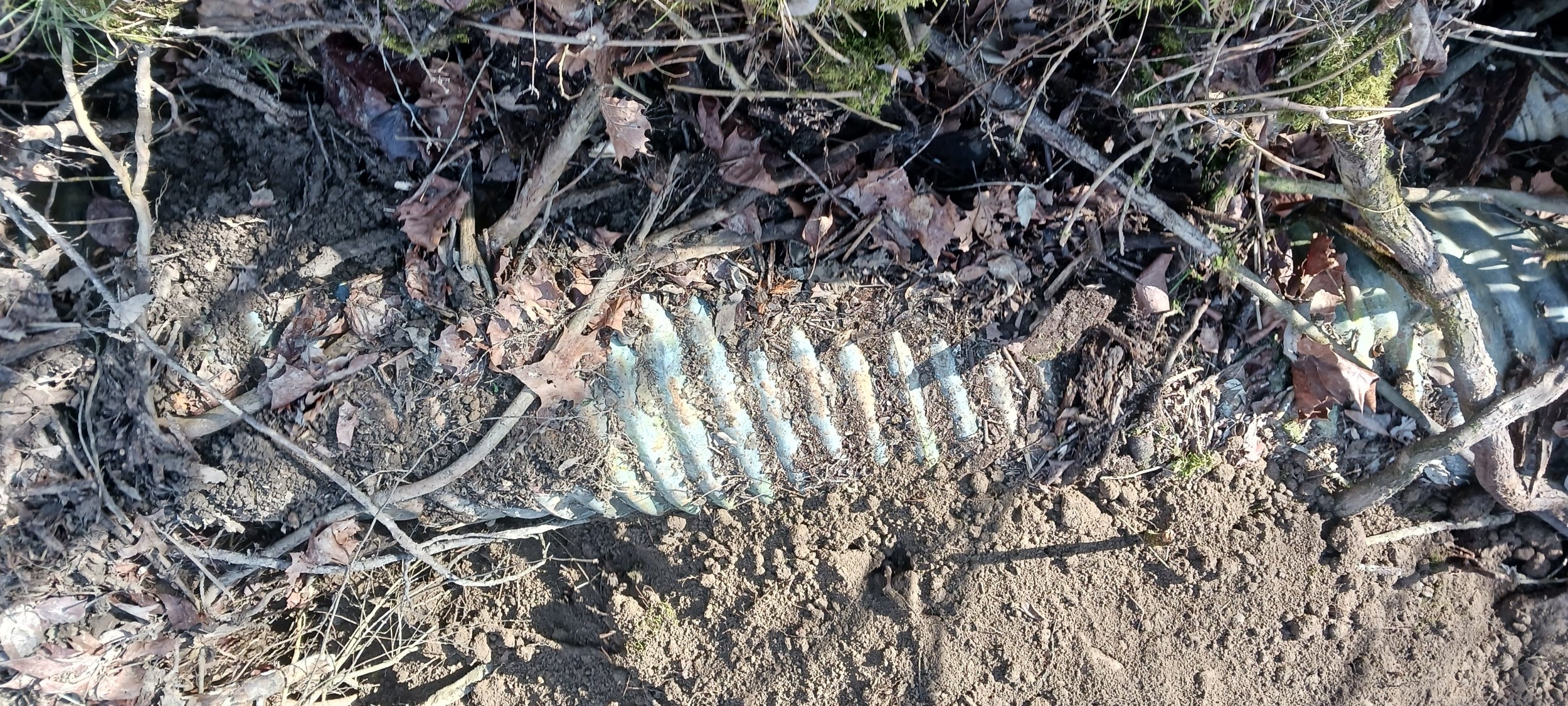

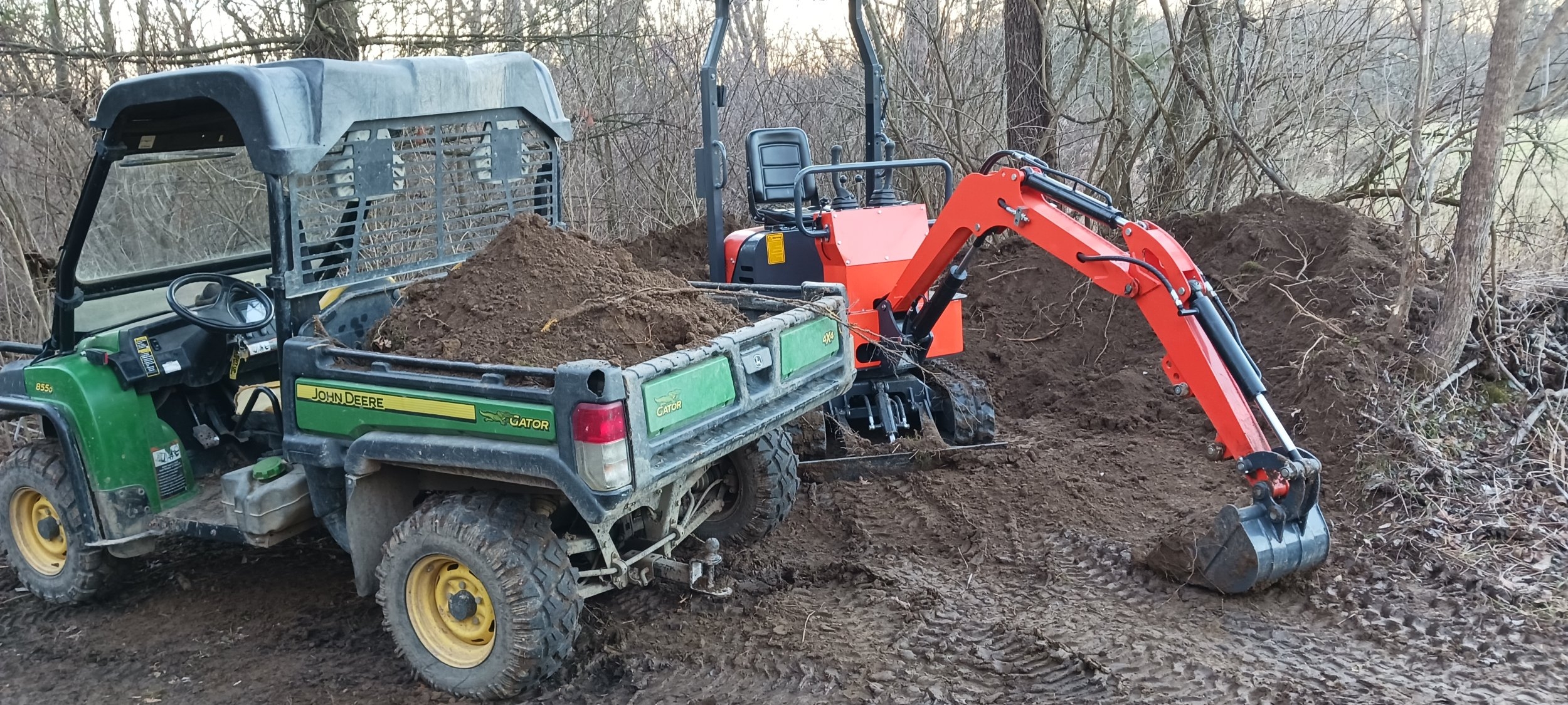

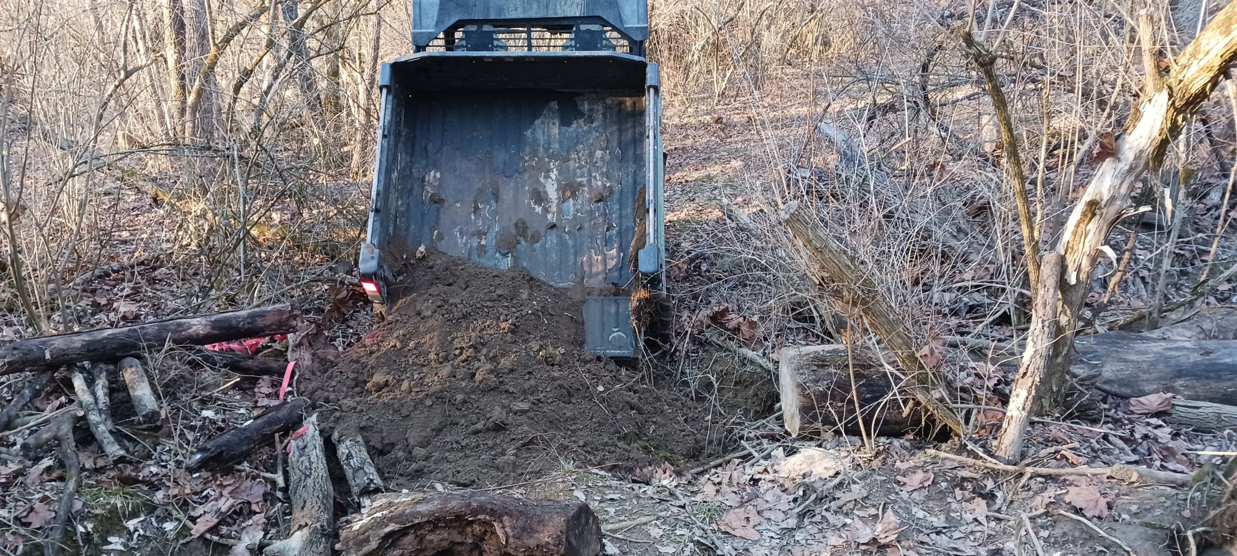

This 36" culvert was blocked and had washed out years ago. The Baby Digger, the Baby-Bota and I went to work cleaning it out and filling in the huge holes. Those are roots on top. 6 loads dumped so far.

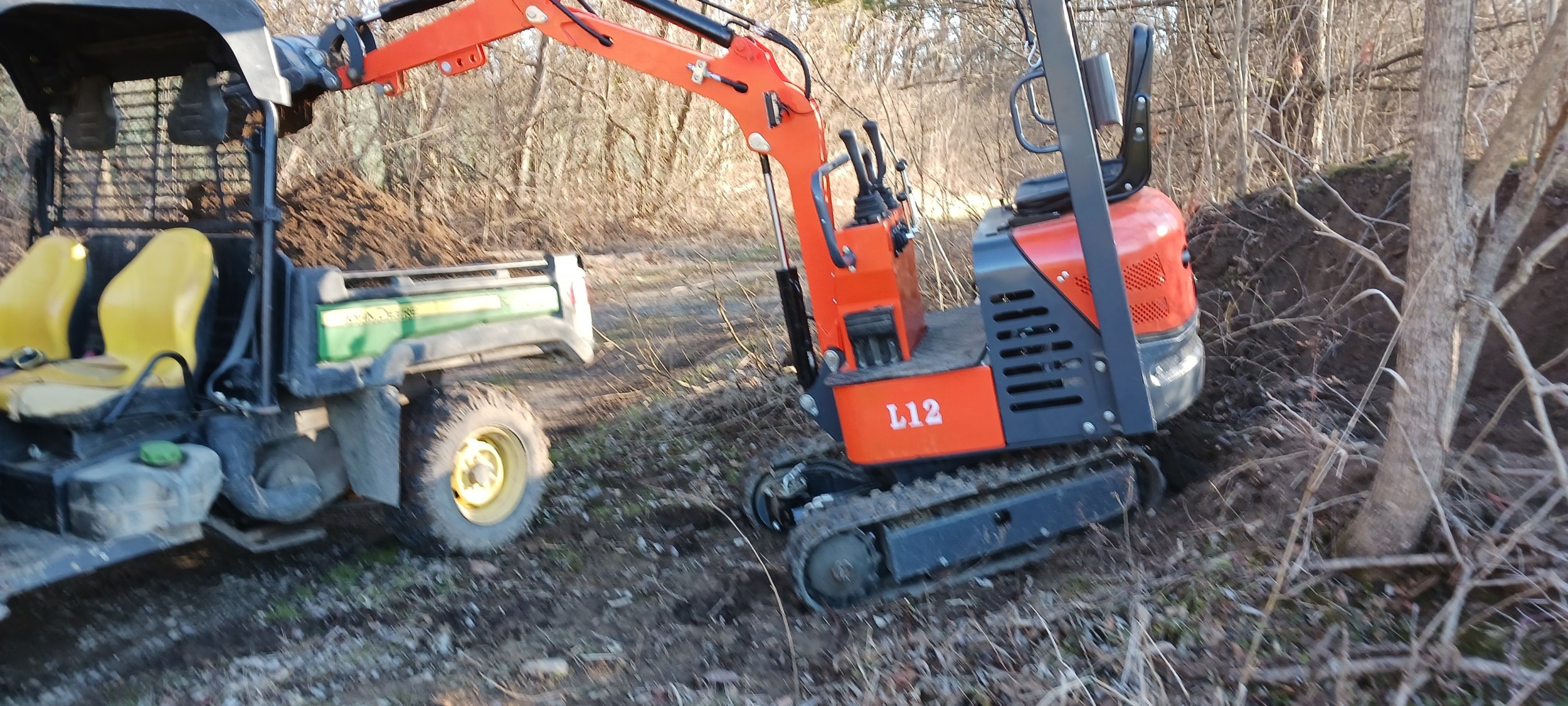

Almost 26 hours and still working better than it should. Thats 26 hours on the L12 not the Gator, it has over 2400 hours and over 21,000 miles on it. Quite impressive.
