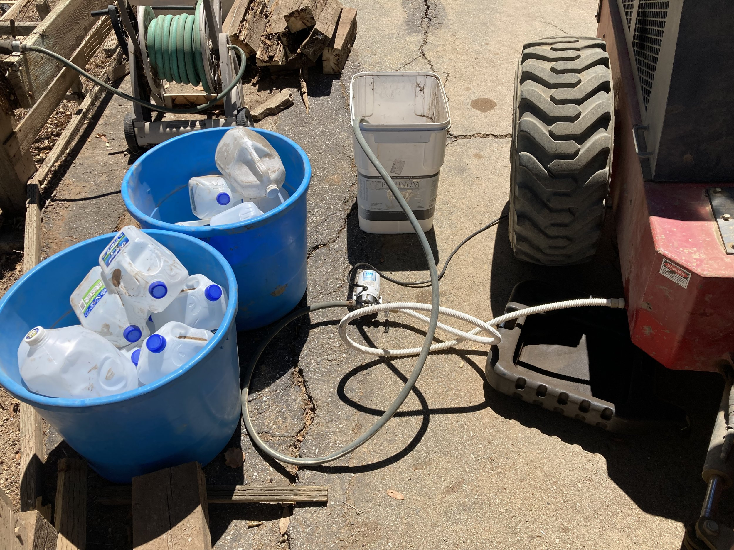

I had noticed that my hydraulic oil seemed to be getting darker, so I decided after eight years, it was time for a change. After the factory 15W40, I put in synthetic 5W50 in the hope that I might see a change in performance on hills at high temperature, but I can't say I noticed any difference. On the cold weather side of things, the 5W did seem to make low temperature cranking a little easier, but the glow plugs made the enormous difference. So, this time is back to 15W40.
Here is my setup;
The white item in the center is an old vane pump that is oil compatible, hooked up to an old white dishwasher hose that has a wonderful rubber fitting that fits over the PT drain snugly. On the other side, I have a ball valve on a short piece of left over washing machine hose, but usually just use a power strip with a switch to turn the pump on and off. I have found that this makes for a quick oil change, and next to no oil spillage.
The blue bucket has about half of the empty milk jugs that are required to hold the used oil for recycling.

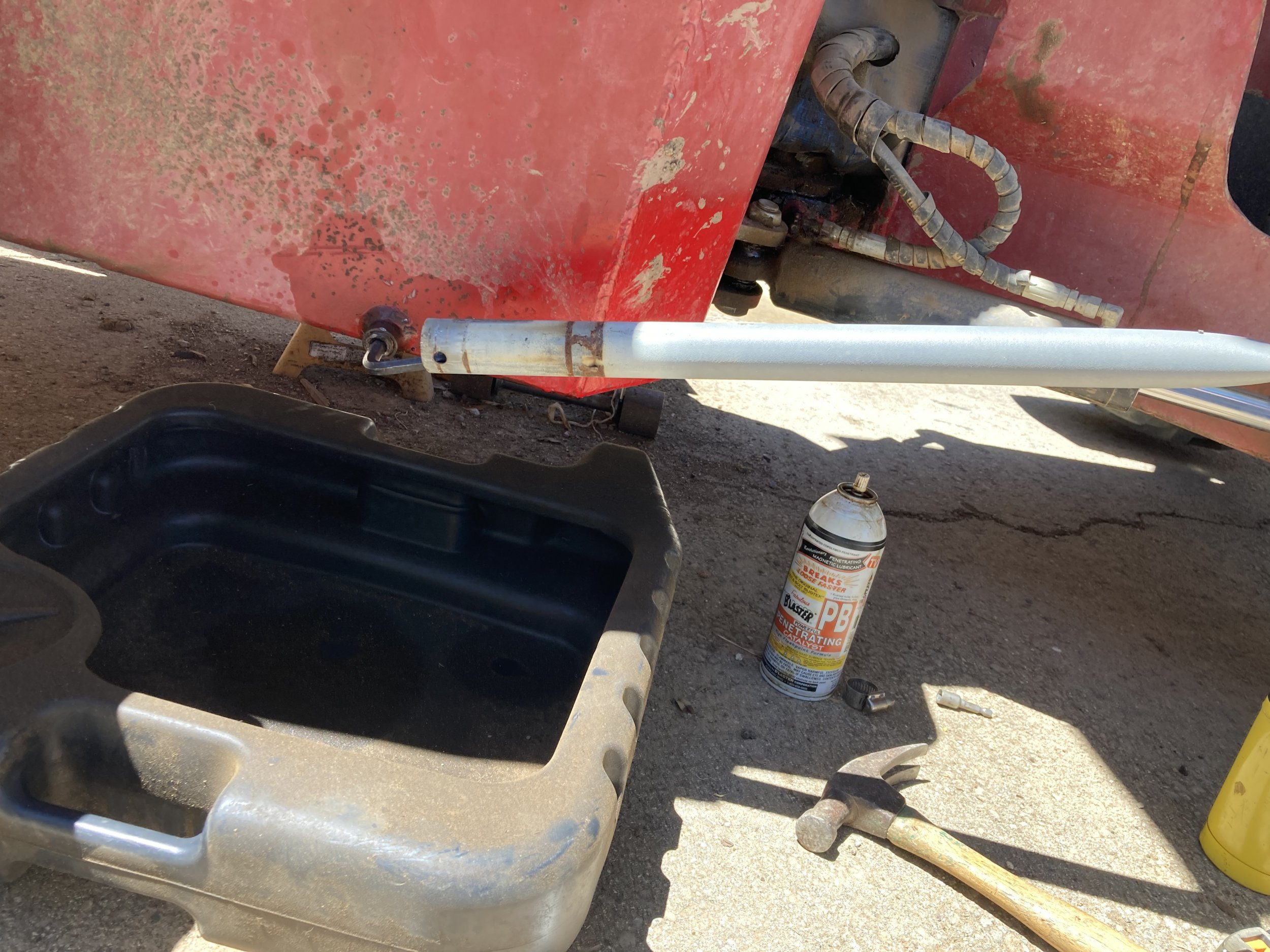

The hard bit was getting the plug out of the tank. I tried brute force, PB blaster, Deep Creep, a blow torch, two different impact wrenches, and nothing loosened it up. The first (cheap) Allen wrench that I tried was not up to the task.
With an extra two feet of leverage, the plug came right out. Does anyone know the threads on these? I suspect it is a hydraulic (nontaper) thread, but it didn't match any of my thread gauges. (In case you were wondering, this had Teflon tape on it when I put it in last time!)
Not shown: after removing the drain plug, there was a big glob of weld material halfway blocking the drain opening. I thought about trying to remove it, then started to worry about ever finding in the tank, or bulkhead openings if I knocked it off, and decided to just leave it. Later it occurred to me that as the threads on the plug are straight threads, the weld blob was probably just Power-Trac's way of ensuring the plug has a hard stop to thread up against. Thoughts?

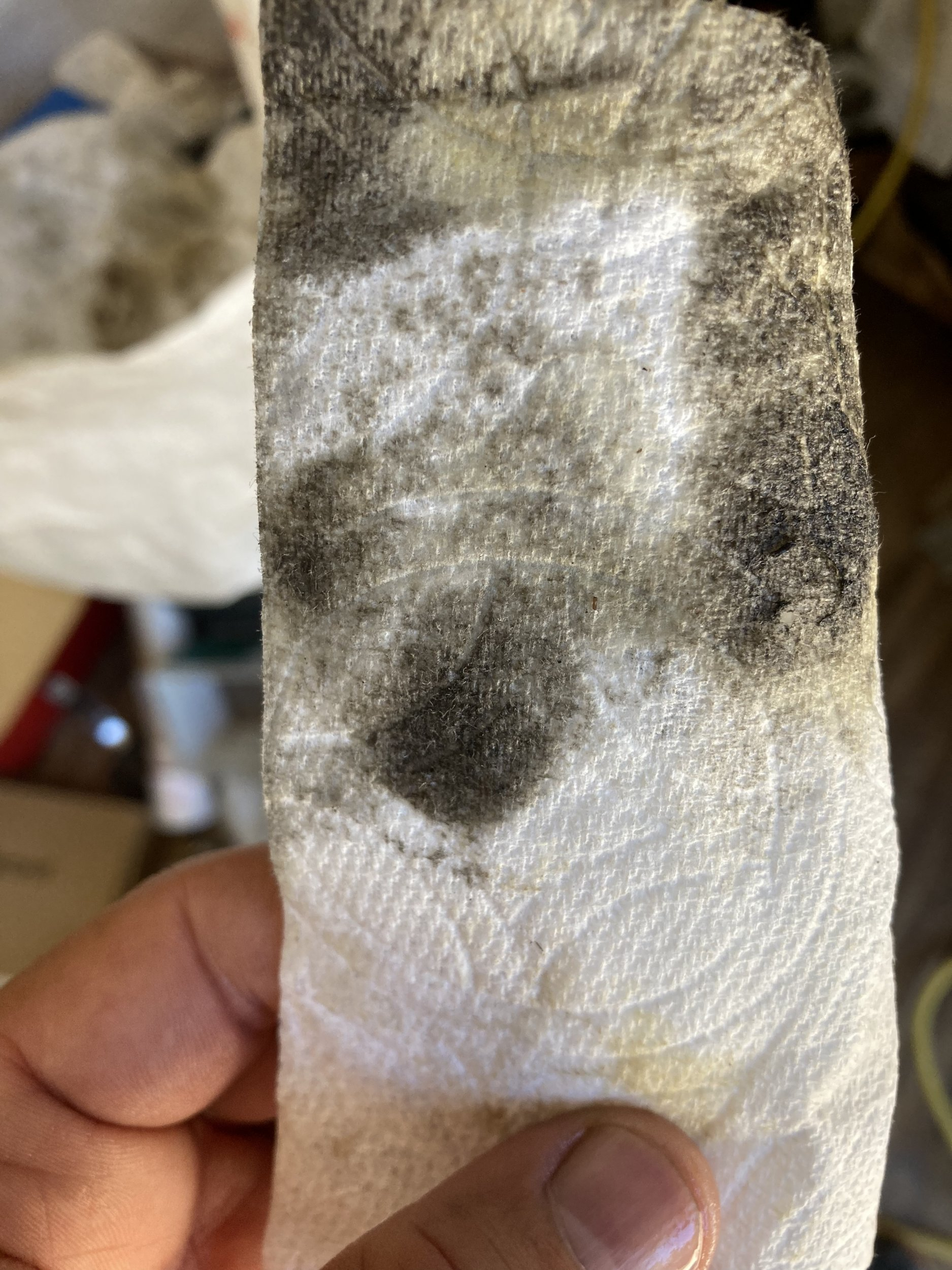

The tank was pretty clean, except for a faint film of black dust. It didn't seem to be at all gritty. Any ideas on what it might be? I have magnets in/on the oil filter, so I am leaning toward rubber worn off the inside of the hoses.
I let the tank drain overnight, but only another half a pint or so of oil came out, and no sludge.
With a new hydraulic filter, and some purging, it is now all ready to go back to work.
Today's tasks: getting hay for the animals, and moving trash and debris out to the garbage cans. (Like the 17 gallon empty containers of the new oil, and a couple of gallons of the changed oil. It took a little over fifteen gallons; I had a pair of partial gallons around from changing the engine oil.)

As a side note, the decrease in viscosity is noticeable, with faster pedal response; whether it is the change from 5W50 to 15W40, or thicker oxidized oil to fresh oil, I don't know. The old oil coming out was brownish black, and opaque.

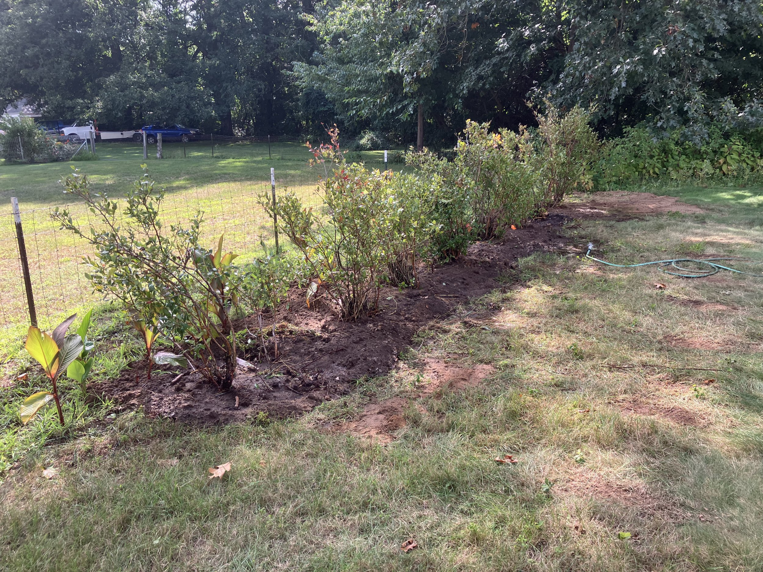

Found an ad in a local farm newspaper for free blueberry bushes. Spoke with the owner. She's getting out of the u-pick and commercial business for personal reasons. Hoping to get a farmer or grower to take about 12 acres of bushes, or she's gonna hire an excavator to strip the fields. She wants to plant hay for her family's horses and take it easy in her retirement. However, she was quite happy for me to take just 8 bushes. :)
In the small world department, her granddaughter owns a cider house that we've been to a few times.
So went there, dug out the bushes, brought them home, and planted them along a back fence line. Then went swimming. ;)

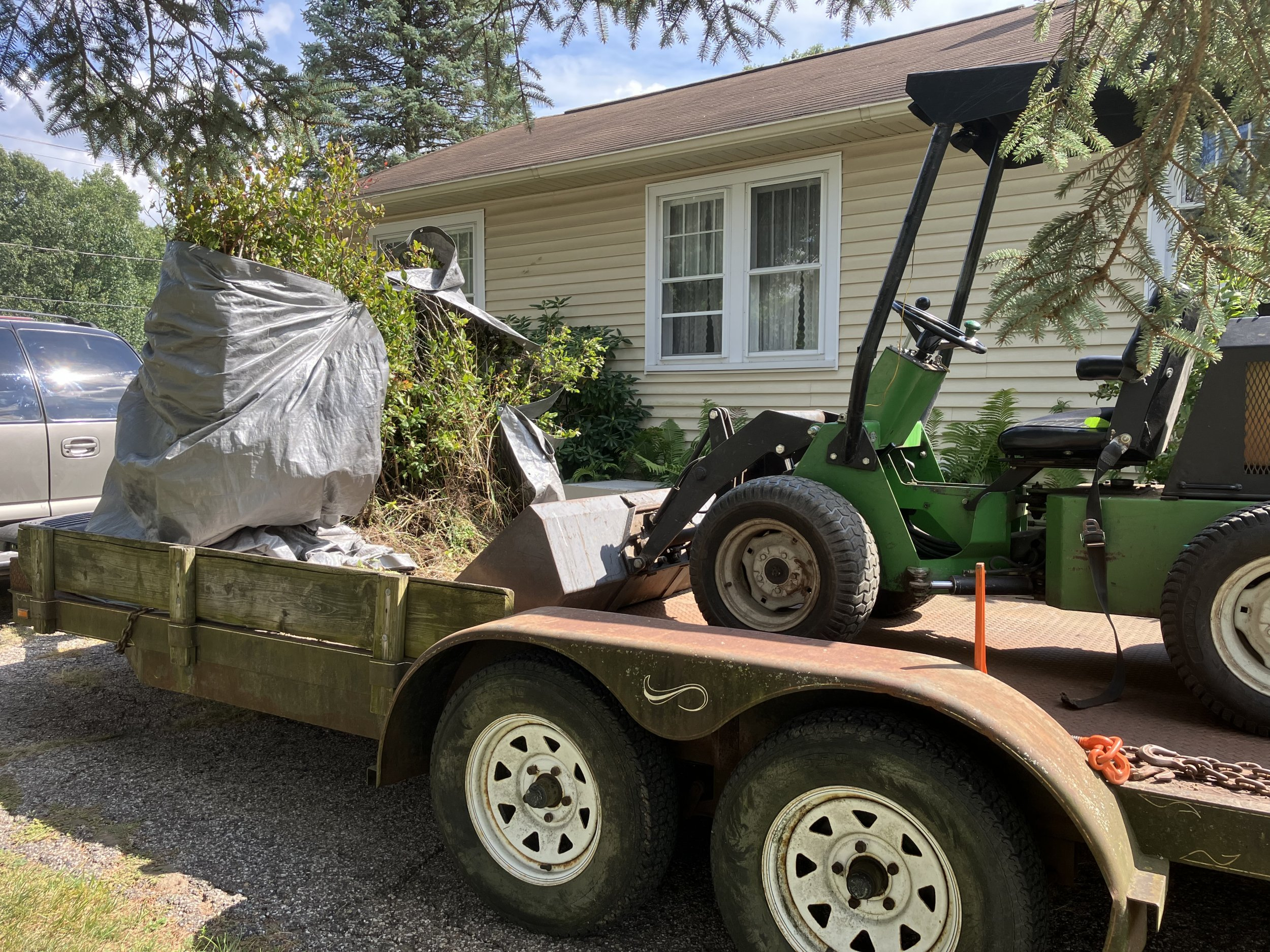

Nice portable setup Moss
Thanks. 18' car hauler with diamond plate floor. 5500# usable capacity. 2x12 removable side and front boards. 2" receiver welded in the center of the front on the deck to put a portable winch on if needed (borrow from a friend). Pickup truck tool box across the front for tarps, chains, binders, straps, ropes, shovel, axe, machete, spare linch pins, spray lube, grease gun, paper towels, some cable with hooks, all kinds of useful stuff, etc.

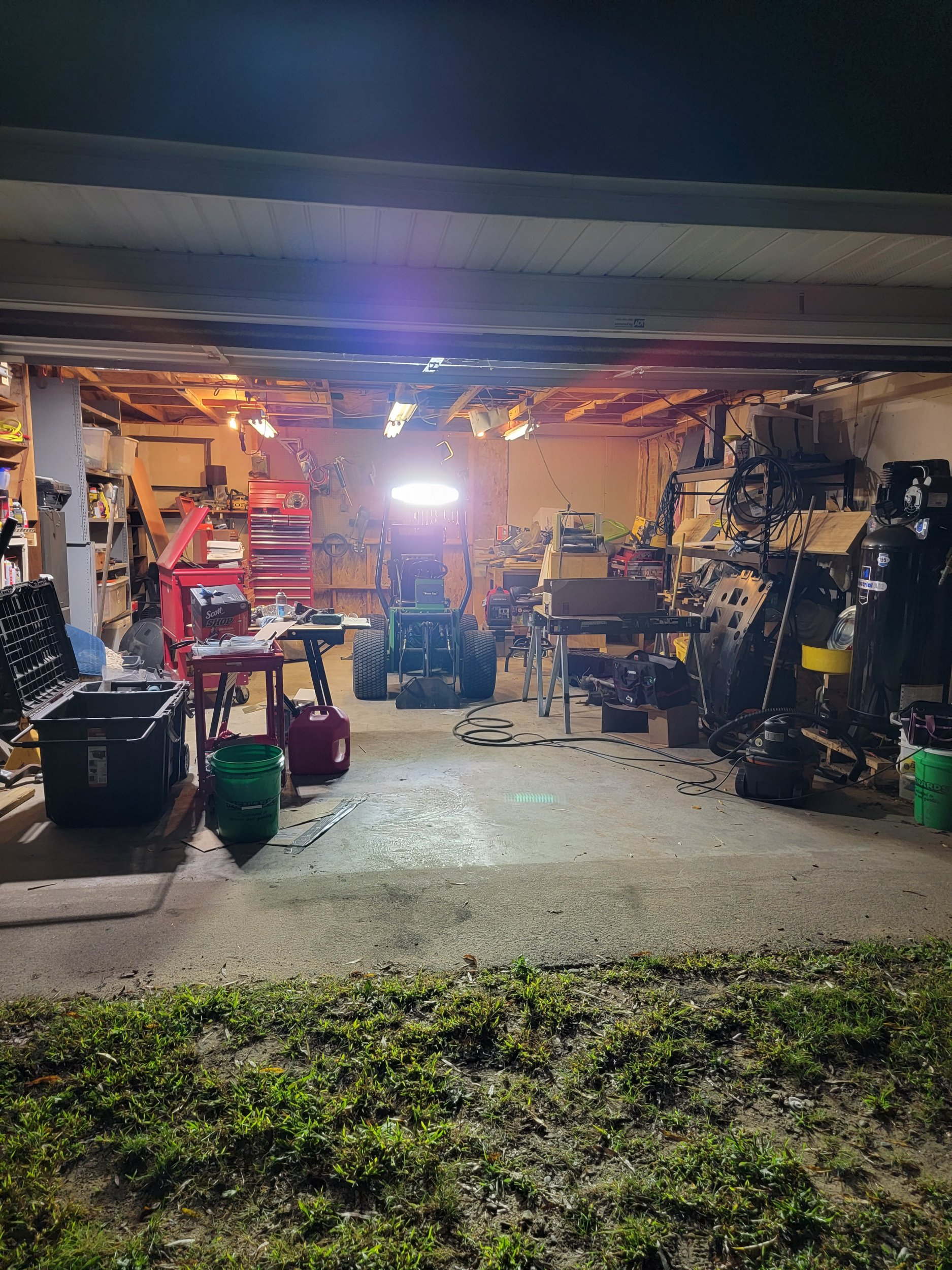

Getting ready for snow season here in Michigan. Factory halogens had been long burned out so I stuffed a light bar in to the roof. Tight fit, had to grind down the mounts a little. 22".
