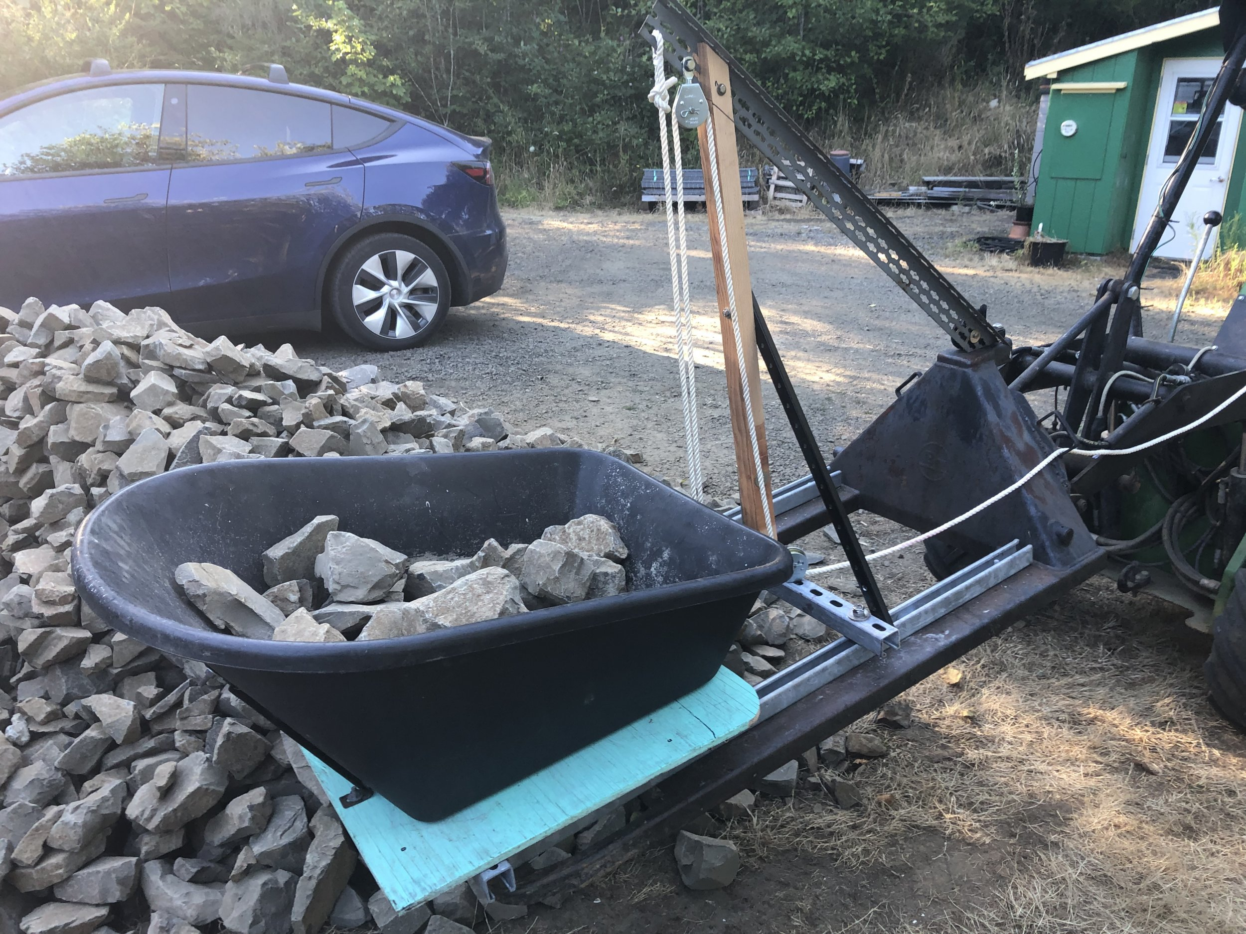

I am building a Gabion stone retaining wall. I needed a way to lift the fill rocks higher than Artie’s bucket could reach. I had made a forklift attachment from an old pallet jack so I used that as the basis for a high lift dumper made out of an old wheelbarrow some pulleys and a rope. It worked out great.
I’ve got a cool video of it in action but couldn’t figure out how to post it.

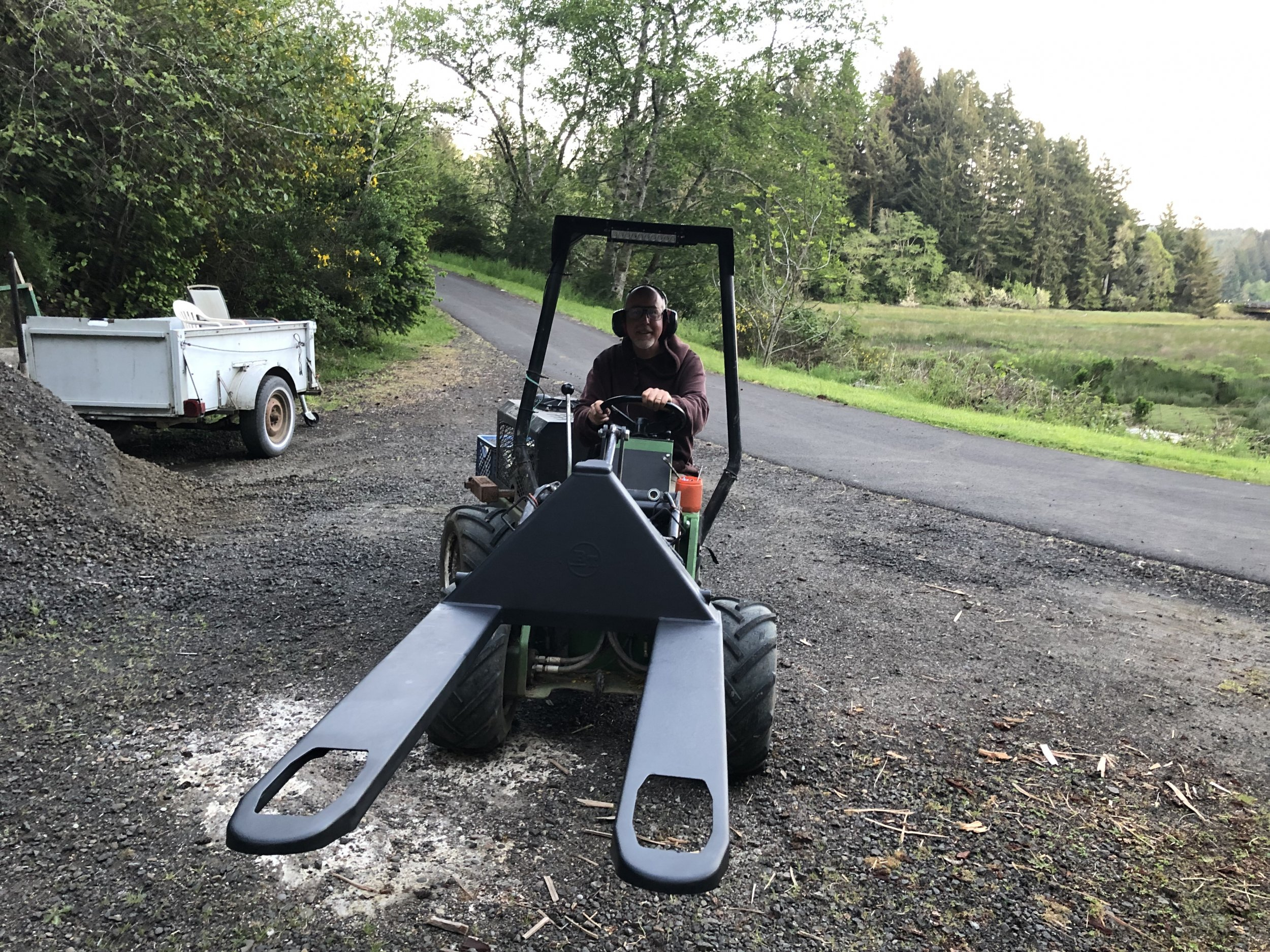

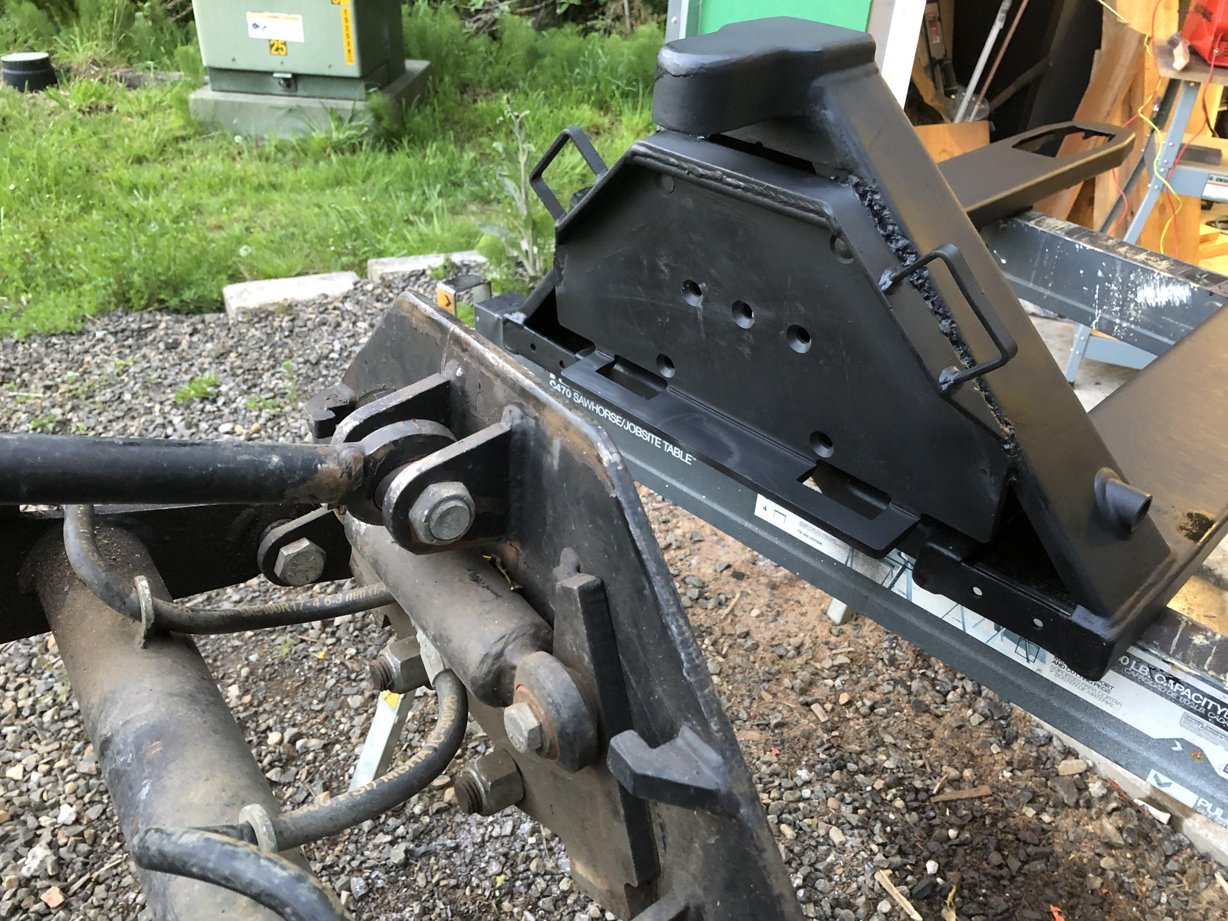

Here is my forklift attachment mod. I welded it to a quick attach plate.

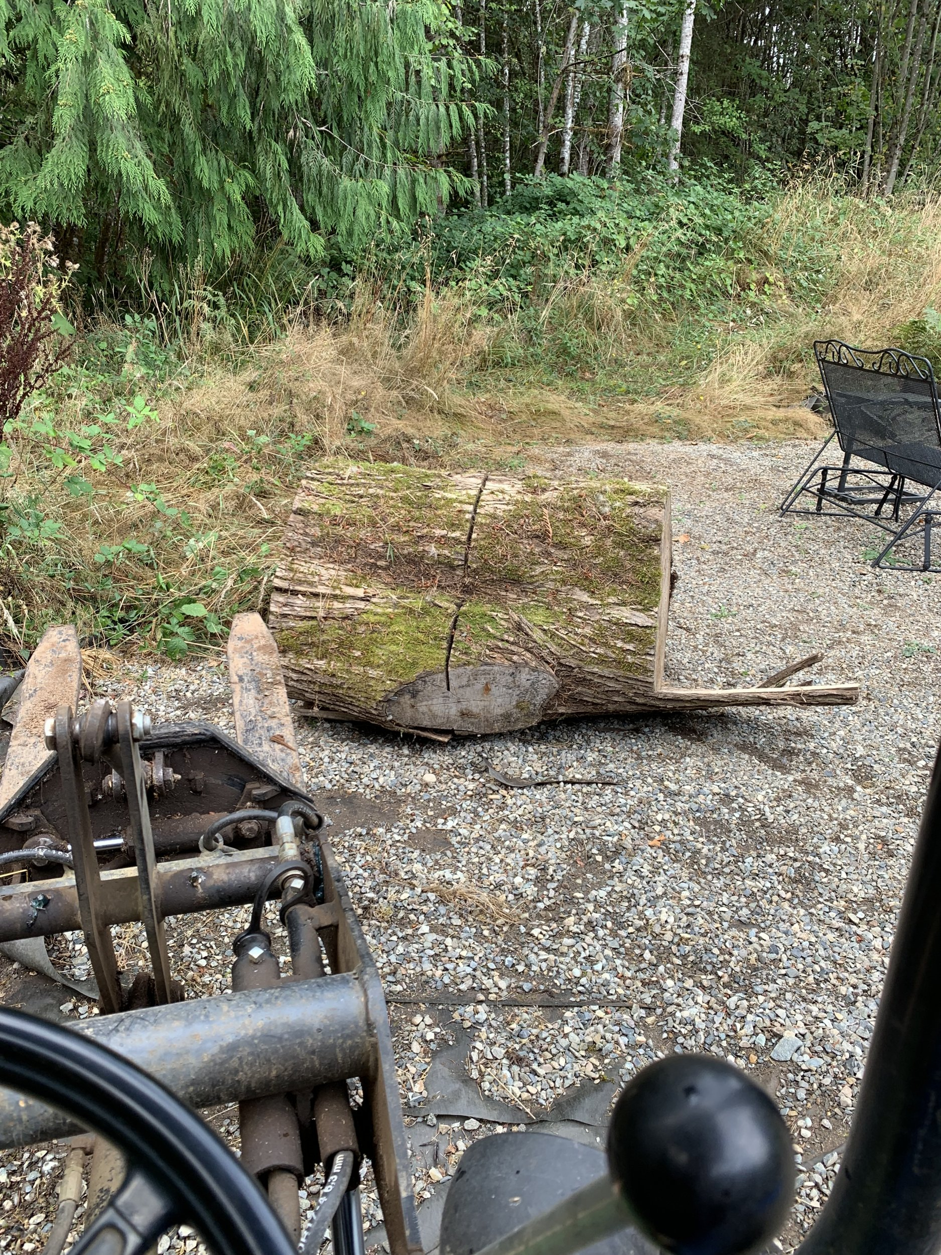

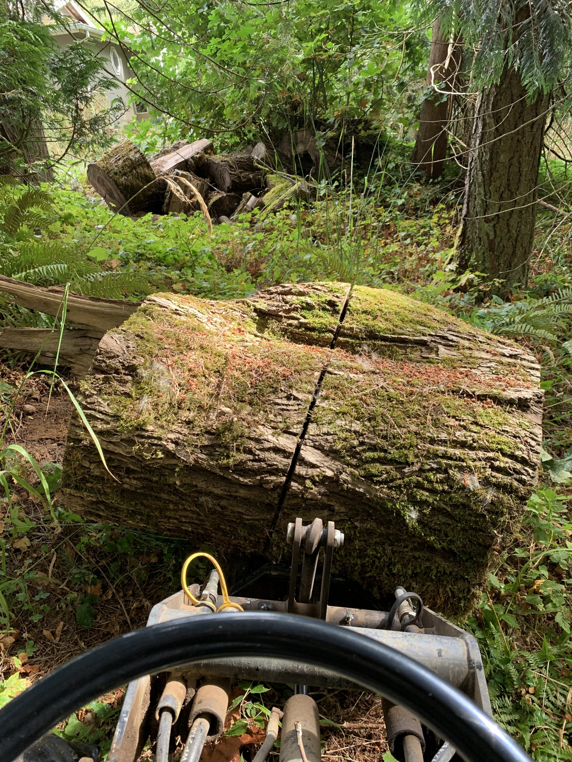

Got it on the forks, but a little tippy. Then the ground sloped slightly down hill and the back end tipped up and off it rolled.

I've got a 20 year old video of me lifting a huge piece of log like that with my 425 and my first experience with the PT Pucker. Unfortunately, it's in WMV format over on my old website.

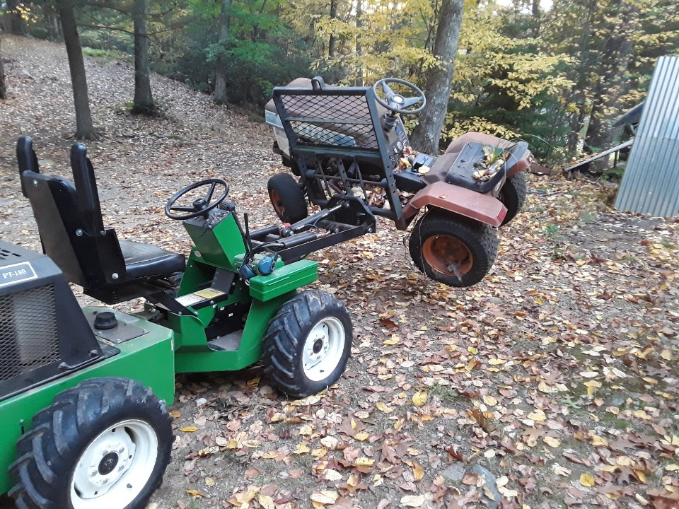

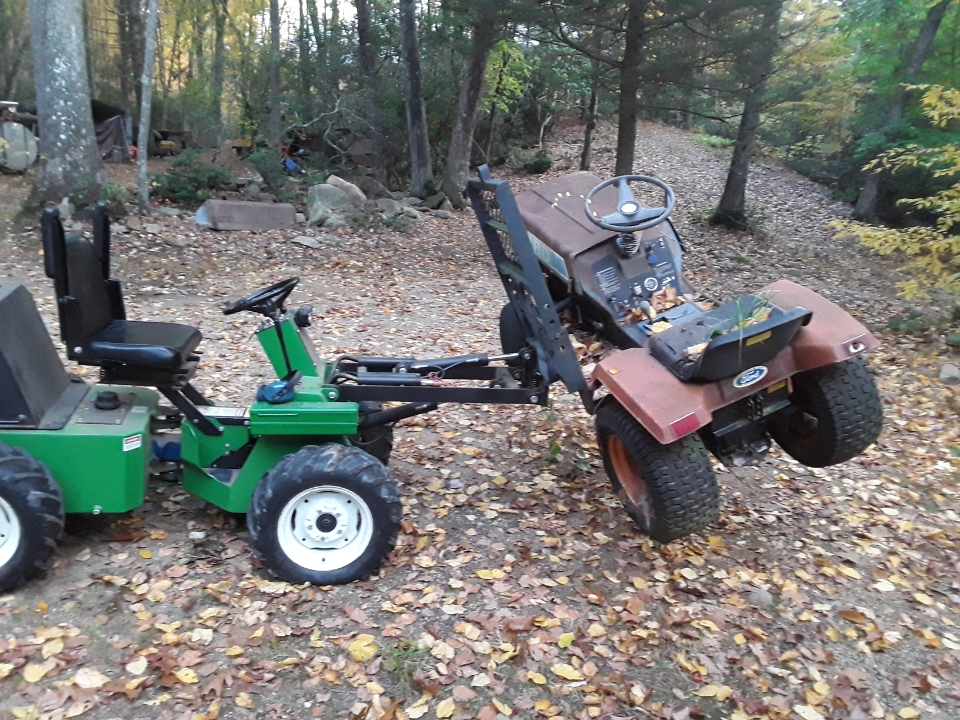

Cleaning up and getting ready for snow. Moved an old tractor out back. The hose going to the lift cylinder leak a bit on this move.

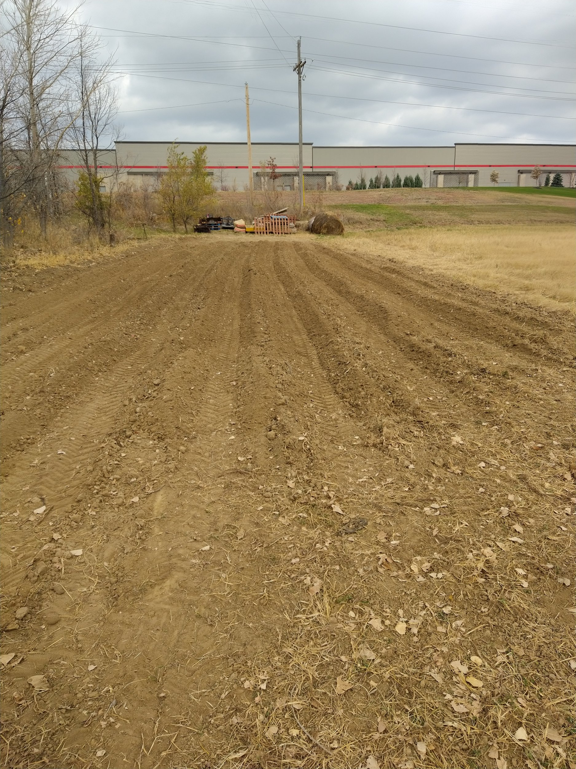

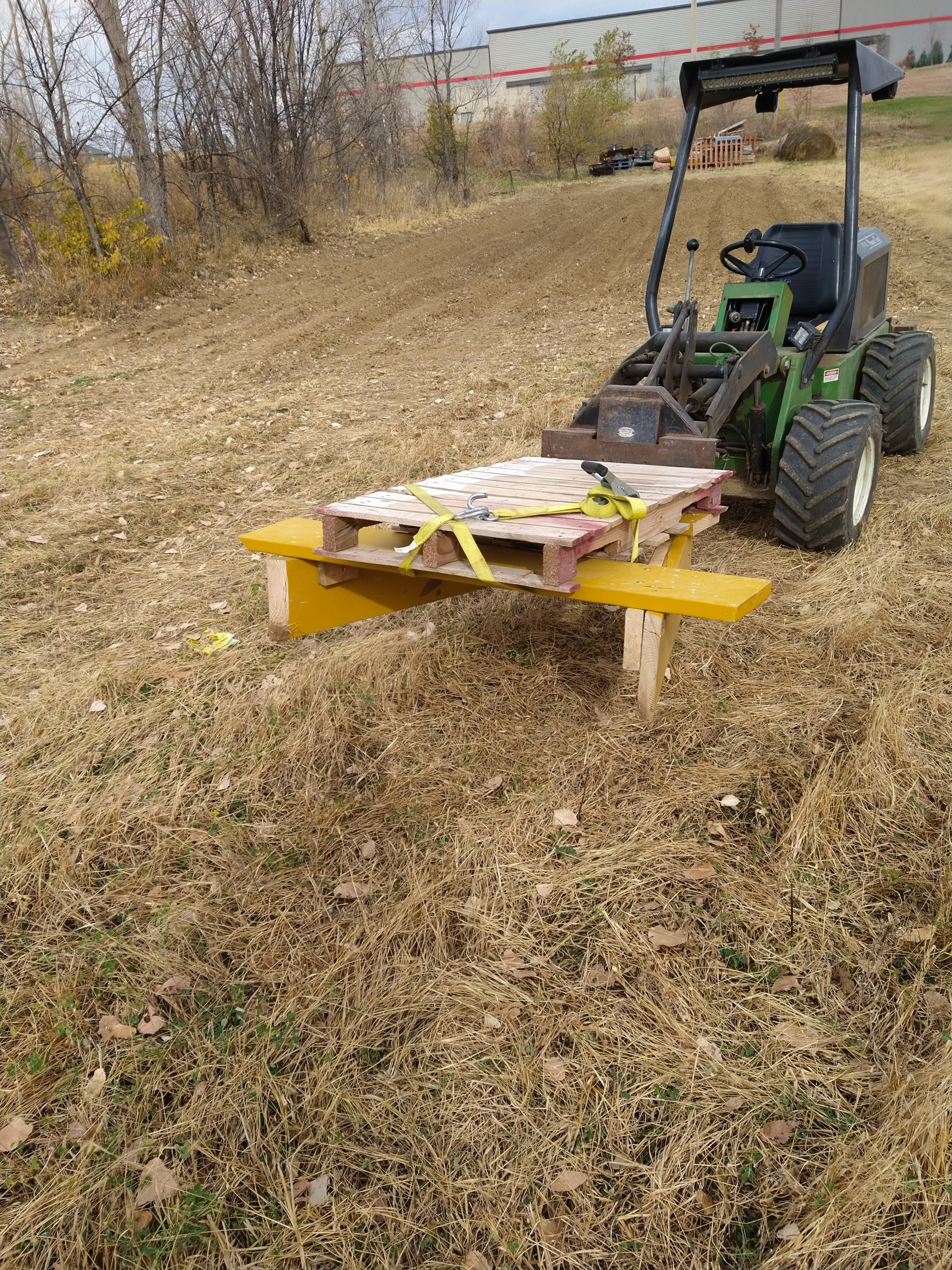

Planting some garlic again this year and I had my dad run my 48" Buhler tiller that had been used once before according to the owner, looks like it too. I picked up on FB for $800 (on his new JD 1025r) I bought to modify for my 425. I got to say the tiller ran better on that way better than mine ran a 42" Dingo tiller I rented last year. I don't think it even gave his tractor a workout.
Didn't have enough time to make a dragging bedder so I had some scrap wood laying around and made a pretty rudimentary one and attached to a pallet and used my forks to just push and make about a 8in deep bed. Worked pretty well and it made a good hard walking path on the sides. Dropping in about 1300 cloves of garlic in the ground in the next day or two. If I could figure out how to drop them every 6in in with the PT, I'd be in heaven.
