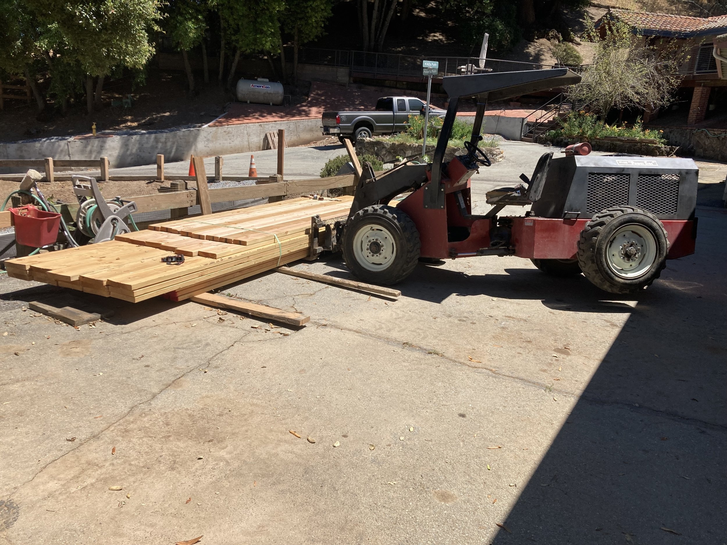

Lumber moving. I needed some boards for fencing projects, and they were too long for my truck, so I had them delivered. 18' 2x10" boards to redo a guardrail, plus new "true" ground contact pressure treated (0.31lbs/cu.ft.) 6"x6"x12' posts. Each bundle is just at the pucker point for the 1445.
One of the many challenges is that none of my gates are 16' wide, much less 18'...
I strap my lumber together to reduce warping/splitting until I can put the board up. The 0.31lb/cuft 12' beams are right at my comfort limit for lifting as they are still drying out from being pressure treated. (120lbs?)
Moving these boards through a couple of gates and down a steep slope was rather interesting, and I managed not to hit too many items, though I did break a railing trying to swivel the sixteen footers through a 12' ranch style gate with a top cross bar.
I also augered a couple of fence post holes for gate stops to hold gates open when not in use. One had rotted out because the drainage put water on the base, and I wanted a post with packed gravel to at least try to get the water away from the wood.
I'm still not wild about using an auger for fence posts. No shade on the auger; the one I have is a planetary drive and is super powerful. It chews the remains of old fence posts without slowing down. I find I only need to use it slightly above idle. My issue is that I have not developed the knack of lifting the auger up to clear the hole of loose dirt. I'm finding that it takes four or five auger/lift/dump repeats to clear a 3-4' deep hole. Any advice is most welcome.
I will admit that I am not using the auger on anything approaching flat ground.
All the best,
Peter
On a standard tractor or the PT, I've always had to do as you say. You might try going to high RPMs with the auger slightly raised, once you reached final depth, to see if it will "throw" the dirt out. I think the problem is related to hole being bigger than the auger. As the dirt starts up the auger, it moves to the side of the auger then falls back down the hole.
I did try the high speed maneuver, but with my dry clay soil, that tossed a couple of quarts out the top, I.e. not much. The dry clay turns to a nice dust/powder, even 4' down. Dry.
Of course, I can guarantee you that my hole was oversize, as I have trouble eyeballing the shifts in the plumb of the auger and making timely corrections to the tractor position and alignment. I find augering holes on my uneven slopes makes for lots of "rubbing your tummy, while patting your head", which I am not good at. I feel as if I need four more eyes and two more brains and another pair of arms.

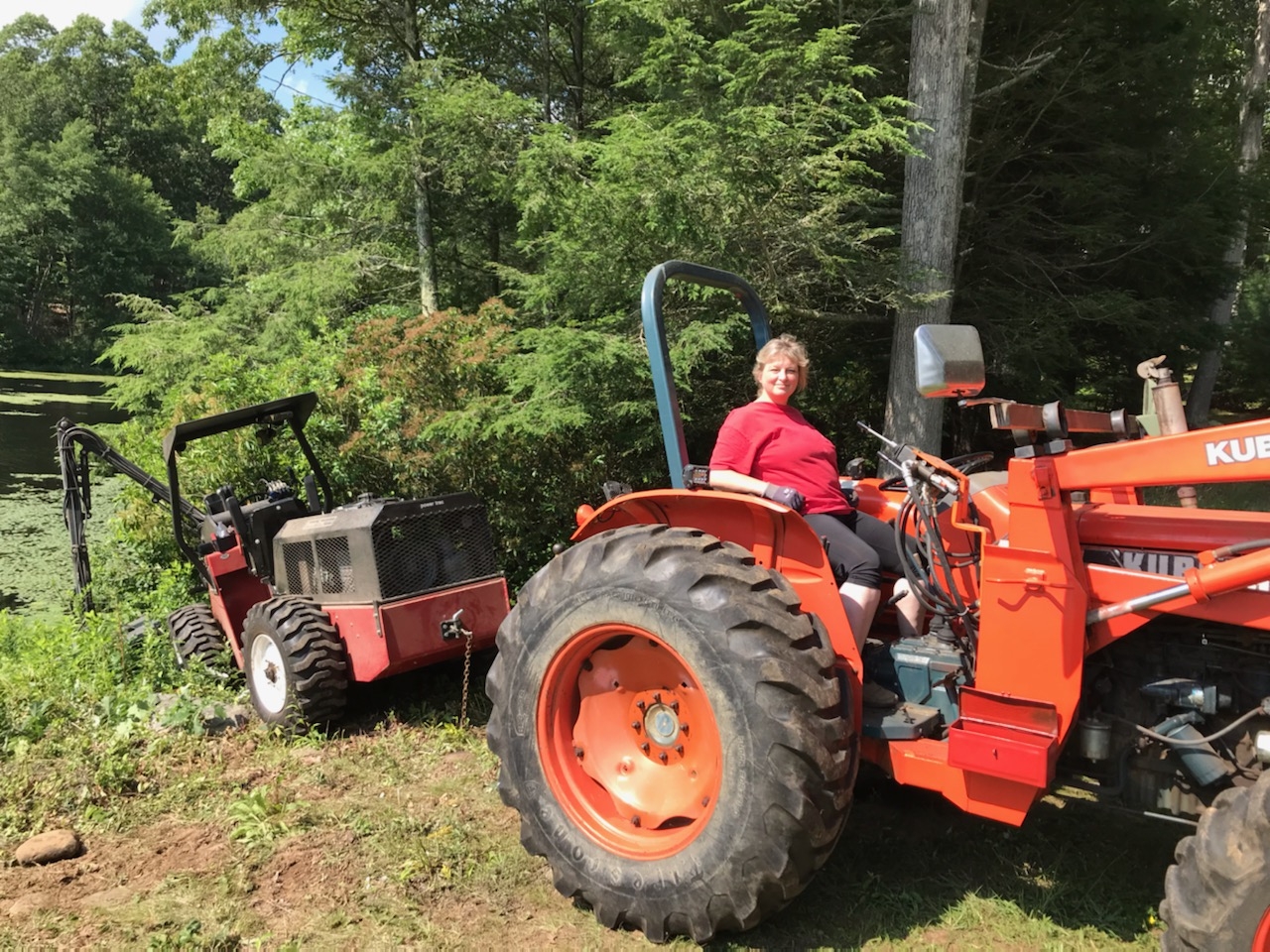

How does that county song go? "Get a chain I'm stuck". Kubota is still good for something. (the PT was high centered on a massive rock and couldn't push off with the boom mower)
