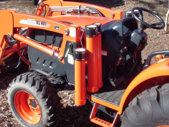

Well, I have heard it best to keep log chains oiled. But I can't imagine then using them when necessary. So I keep mine on the tractor hanging inside PVC tubes where I can readily use them.

That riminds me of some gunslinger with a pistol (or cannon) on each hip!
I have never seen anything like that! My saw always lies on the floor of my loaders inhibiting my operation of the pedals. I had planned to make a saw carrier out of recycled plastic sheeting, but what I have seen here, just blows my mind!!!
How did you attach the PVC tubes? How did you paint the PVC without the paint coming off? Or even getting scratched getting on and off the tractor?
Man, I'm sure I'd hate to see your shop! lol

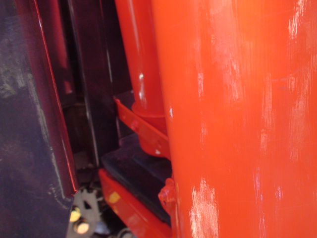

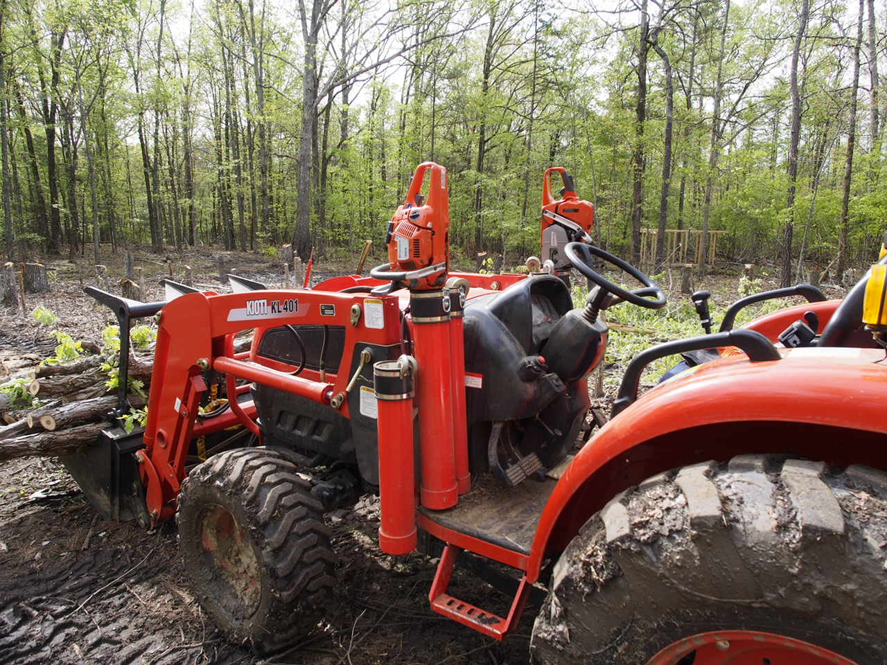

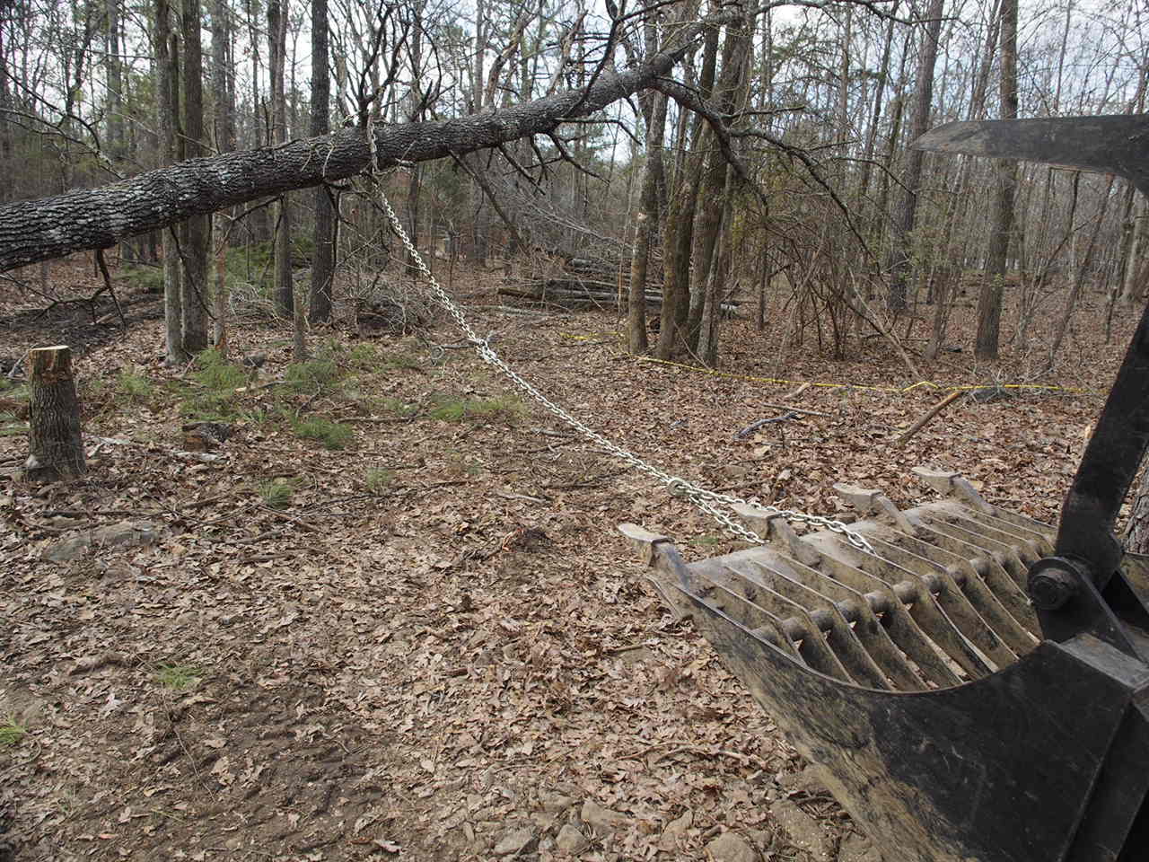

I could not find a commercial method I liked for carrying my chains, saws and things with handles. So I stumbled upon this idea somehow. Most parts are from the big box building stores. My Kioti has a bracket on each side of the cowling to mount the clear Plexiglas that stops mud, etc. from coming into the operator's station from the front tires. I just mounted the tubes to those by adding a few Stanley flat strap brackets and angle brackets. PVC tubes attached with carriage bolts from the inside out. Difficult to mount these as I could not get my arm far enough down in the tube for each bottom bolt so used a string tied to the bolt, gravity and a long stick to get the bolt through the tubes. Insert the string from the outside of the tube and work it down until you can grab it. Tie to the bolts and then pull the bolts into the hole and then mount the tube. The end result is very secure and functional. Here are some pics but nothing really showing the mounting specifics. My guess is I probably do not have more than $100 or so in material.
Meticulous sanding of the PVC with ~220 grit paper. The paint is Kilz or Binzer as a primer and then Rustoleum Allis Chalmers orange for the finish. I have been told they look factory made with the tractor. If the finish coat is thinned just right, no brush marks show and they appear to be power coat or similar (I used to be a skilled commercial building painter in a past life). I hung the tubes from rafters in the basement, through the 3/8" drain hole in the bottom cap. Two or three coats of orange, 24 hours apart and let them dry for a week or so. As you can tell from the working pics, the tractor is used and the paint and mounts are still holding up well. No touch ups needed yet.
Edit: On the outside tube in the mounting closeup one can see finish scratches from the sandpaper. The two outside tubes were sanded using 150 grit paper I think and then sprayed using an automotive gun. The four inside tubes were done as mentioned above, do not display the sanding marks and have a near flawless finish.
