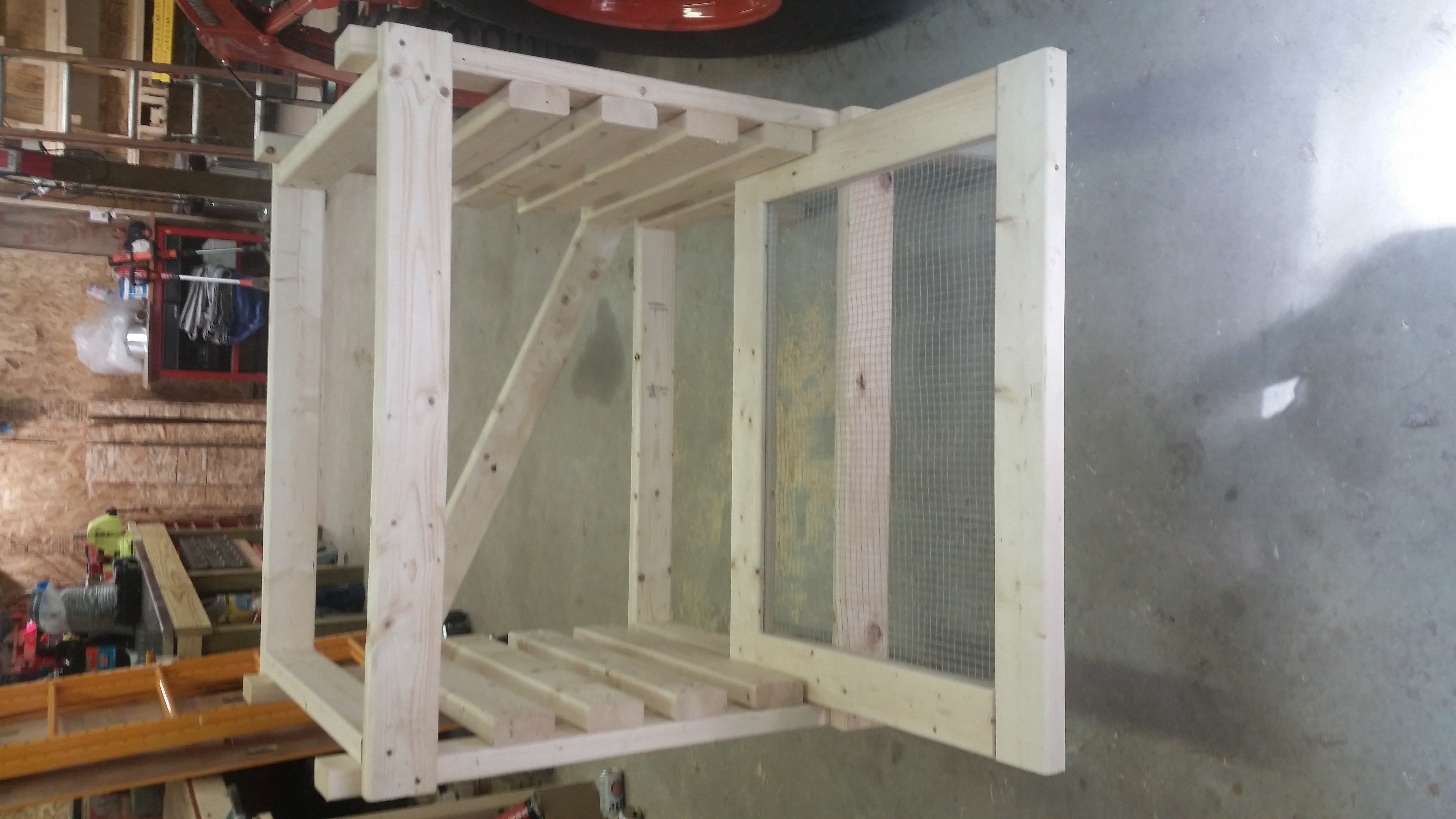

Well TnAndy, I stole your shelf design. And proved if you can over build something, I'll do it. :laughing:
This shows one of the shelves half slid out.
Now all I have to do is build more shelves.
Yeah, I thought about that route.....but my design allows for as little as one in a stack, or as many as I can reach/stack in height. Plus we use them in the root cellar, sometimes in the basement, and sometimes in the greenhouse for drying seed heads we're saving.....so mobility is an important factor to us.
But yours will certainly work !
One thing yours will allow is covering the outside with hardware cloth and making a door with the same.....sometimes we have a chipmunk or mouse get in the seed we're drying (say like corn seed) to save, and chow down.
My,biggest concern and the reason for building it the way I did was I just know that I was going to get asked 5 times a month this winter to get to a shelf at the bottom. :laughing:
We grow 3 types of potatoes, so this way my wonderful wife can just yank out whatever shelf she wants to get to whatever potato she is after.
I also thought this would make it easier to check for spoilage through the time.
For the apples we pick, I think I will use more what you had. Certainly a better use of space.
Thanks again for the shelf idea!
