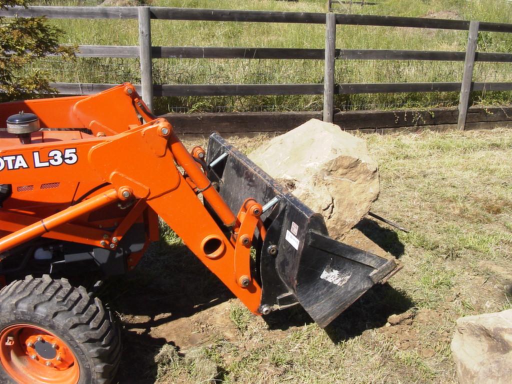

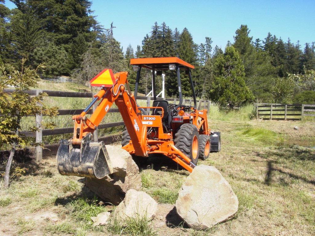

Here is a rock (rock #1) that measures 36x30x18 which = 11.25 cft. My FEL lifted it without any problem so it has to weigh less than 1500 lb. or less than 133 lbs/ cft. The other rock (rock #2) measures 36x24x24 which works out to be 12 cft. And my FEL lifted that without any problem so again that has to be less than 1500 lbs or less that 125 lbs per cft.
So if <125 lbs/cft is a good number (looks to be the same type rock as yours) than your rock should weigh something less than 8x125 or no more than 1000 lbs
If you're saying the rock weighs around 1500 lbs and is about 8 cubic ft than the rock weighs around 187 lbs/cf, that's more than granite. --- I don't think so.
I'm going to say Wroughtn Harv is probably right.

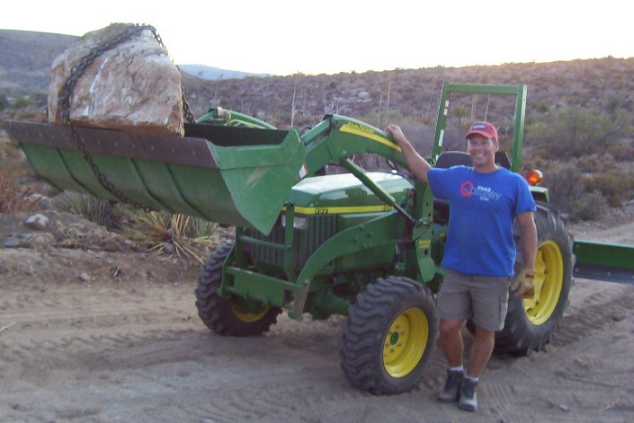

I am not sure how accurate the 3pt rating or FEL ratings are I think they are conservative. I am guessing your rock is just about 1500 pounds and I think the rock in this photo is about 1800 pounds or more based on the table from the site you listed. You have my curiosity up now and I'll have to measure that rock tomorrow. One thing I do know is rock types and yours looks more like basalt than granite you can easily tell by it's hardness. Basalt is much harder. The rock in my FEL is granite like 99% of the rocks I own.. (makes me feel rich to own so many)
