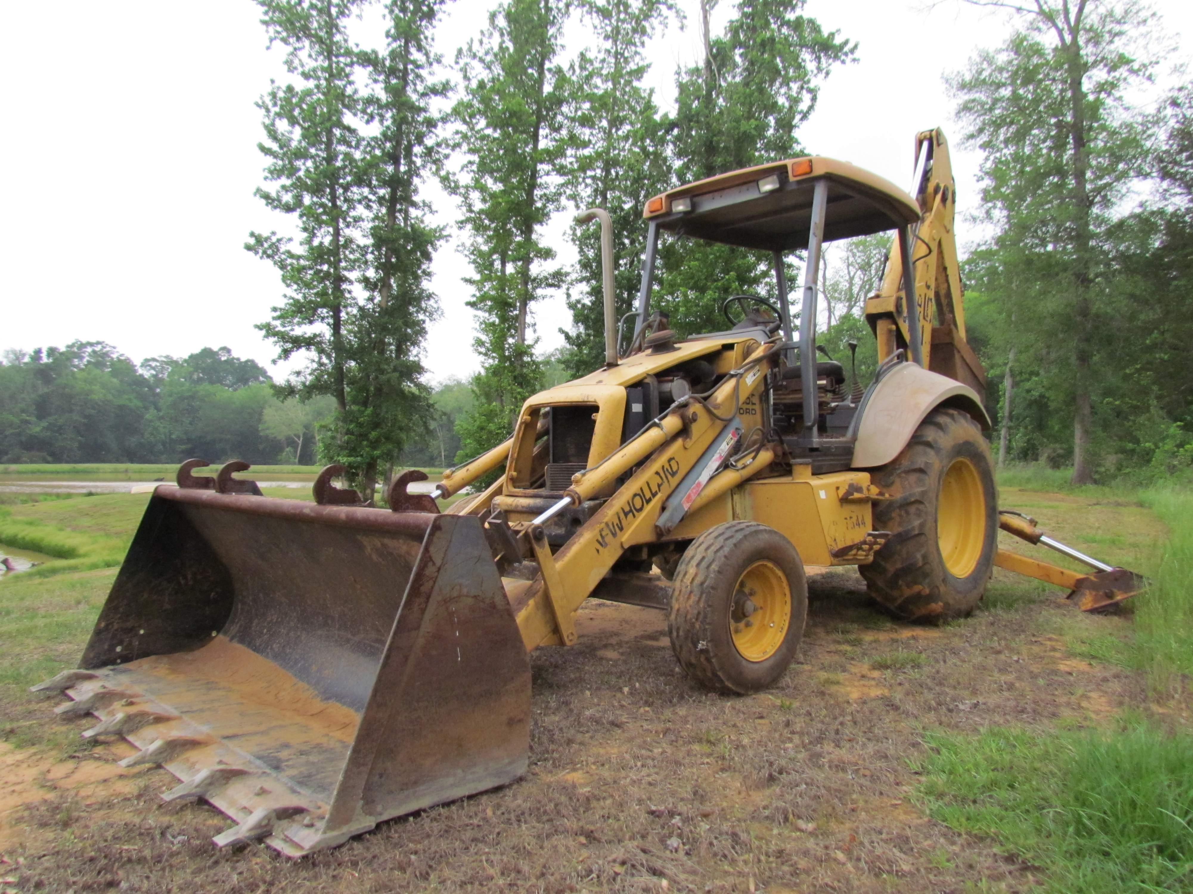

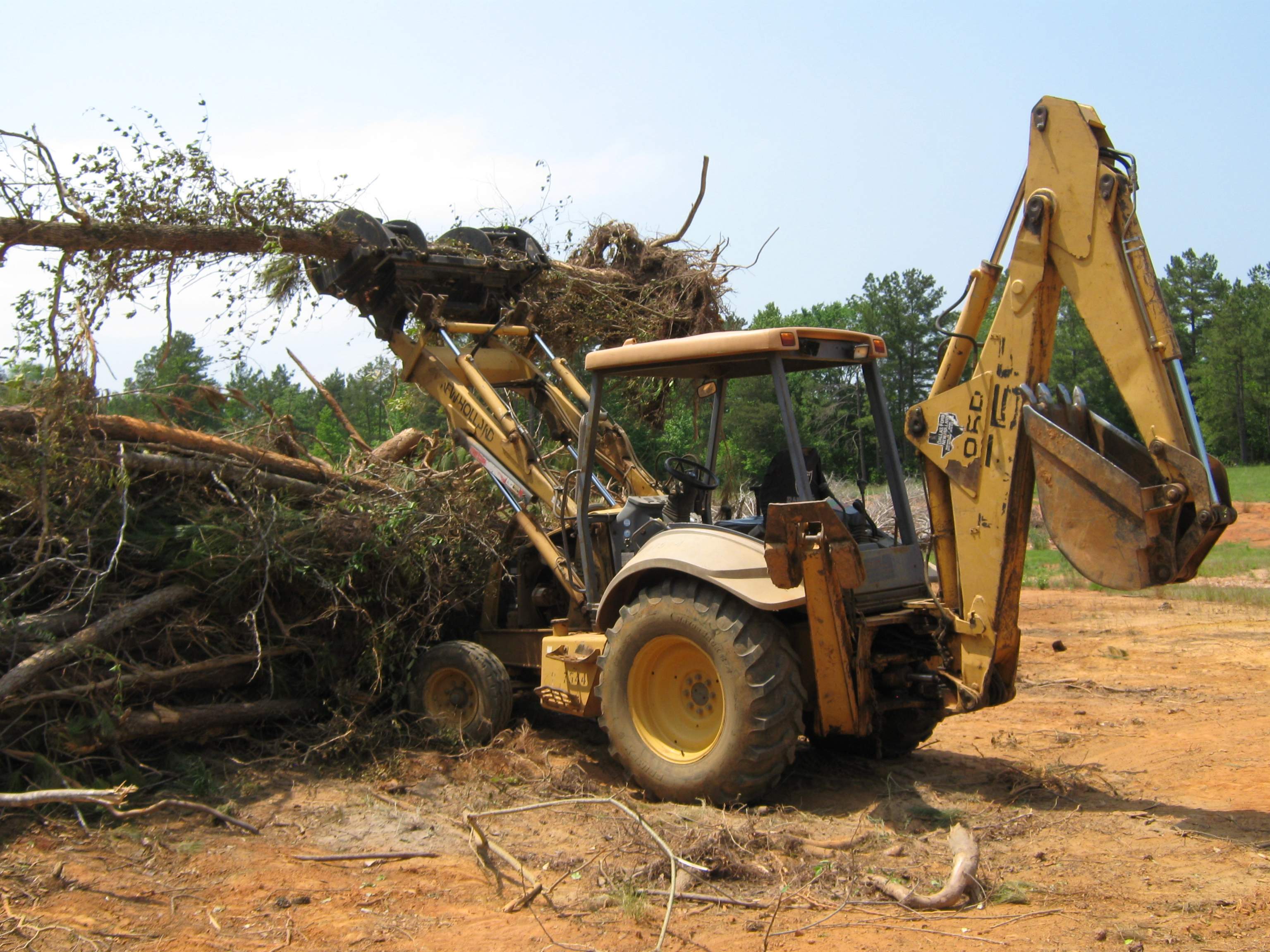

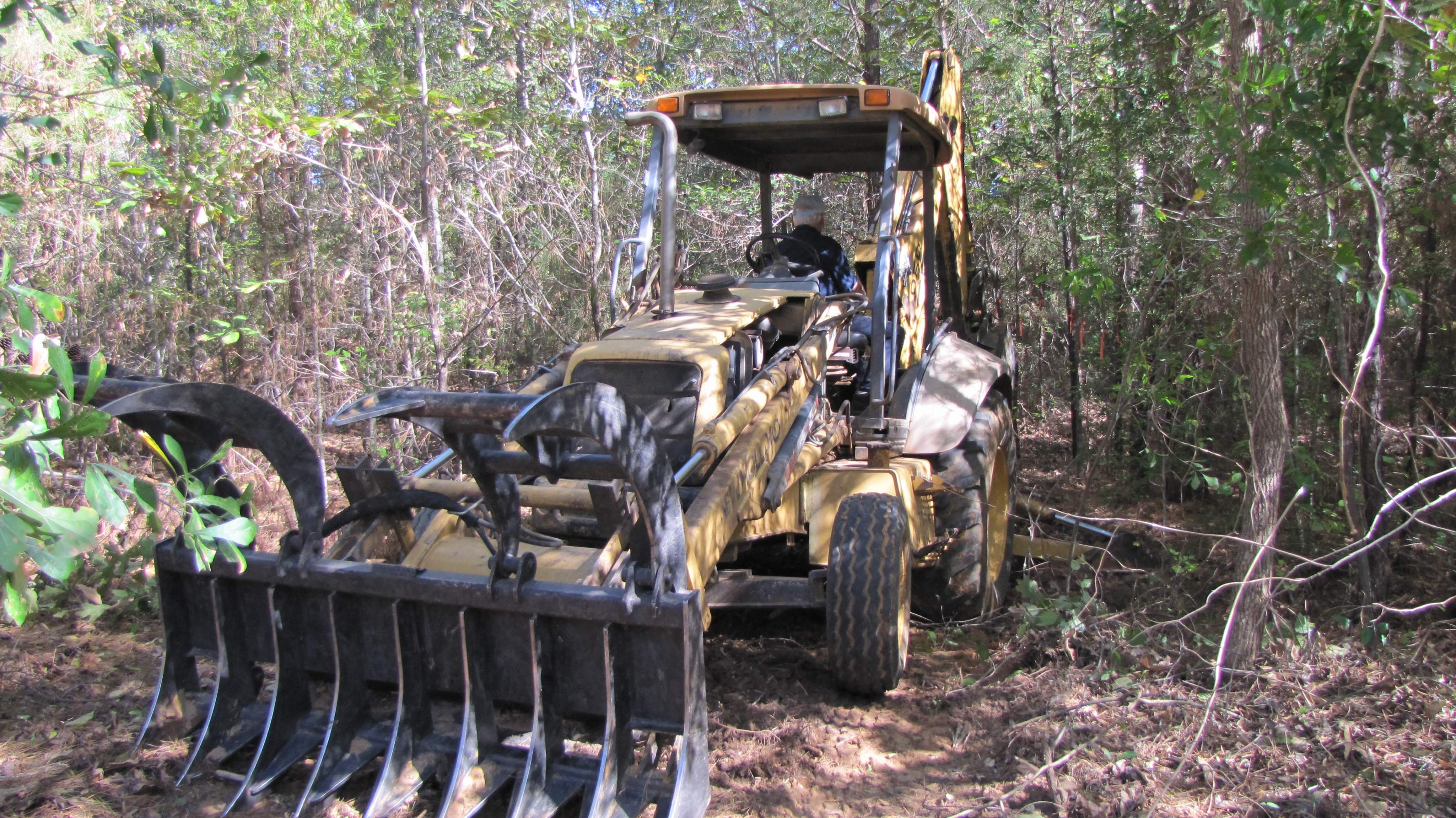

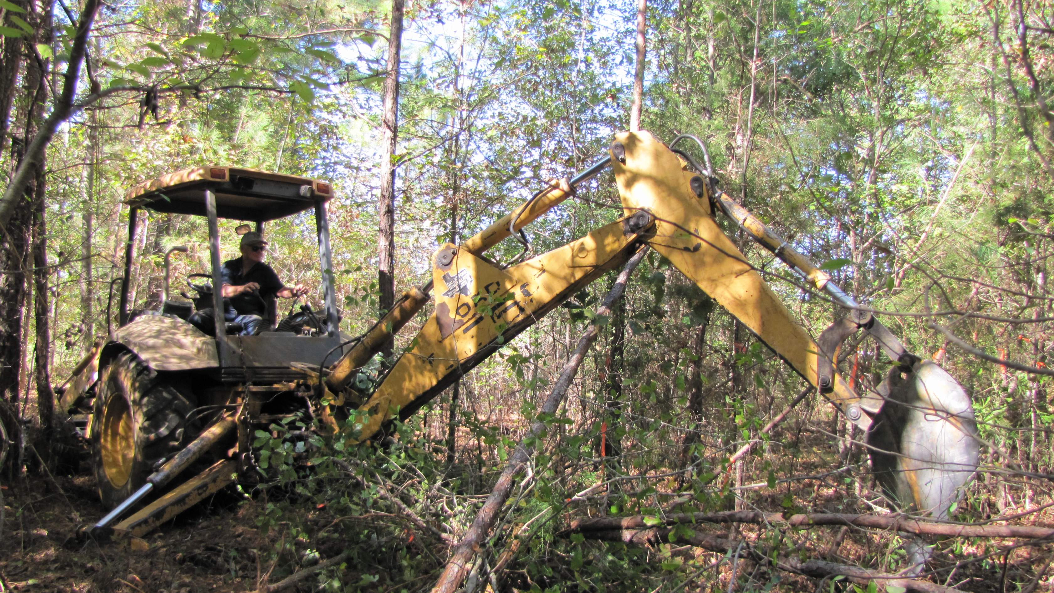

In my opinion,you either need a variety of machines to do the job, or one machine that will do all of it. If money wasn't an option, then we probably wouldn't be having this discussion. For me, I chose one machine that I feel does it all. Obviously, it's not as good as a specialized machine for each aspect of clearing land, removing debris and shaping the dirt. But it does it all, and it does a fair job of it.
I have a full sized, loader backhoe. Mine is a New Holland 555E 2 wheel drive, open cab. In hindsite, years of experience and thousands of hours doing this, I would have bought different if I could do it over again.
I want a cab, I want 4x4, and extenda hoe and a 4 in 1 bucket. More HP would be nice too!!!
All that is more money, and I bought mine for $20,000 with around 1,500 hours on it. With what I've put into it, and for those days it was too muddy to run because 2 wheel drive doesn't work in the mud, I should have spent $30,000 and waited until I had that much money to spend.
The biggest modification that I've made is to change my loader bucket to a Universal Quick Attach so I can take off the bucket and put on my grapple. Just being able to do this has saved me thousands of hours in time it takes to clear up debris and get it to the burn pile!!!! Truly one of the best things ever invented.
I can take out any sized tree, stump and all. I can either carry that tree, or parts of it with my grapple. You still need a chainsaw to cut off what you don't want, or get it down to 4,000 pounds so you can pick it up, but that doesn't happen very often in my woods. I also drag them with a chain when it's a tight trail and I just want to get them to the burn pile. Once at the burn pile, I take off the chain, then pick them up with the grapple and put them on the burn pile without any dirt on them. It makes for a much cleaner, better burn when there isn't any dirt in the pile.
