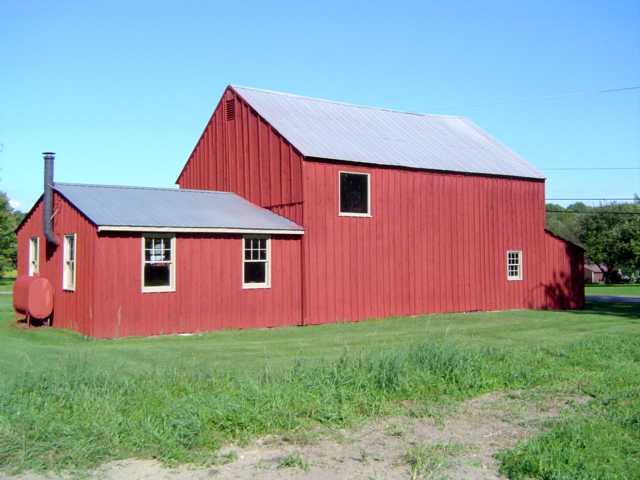

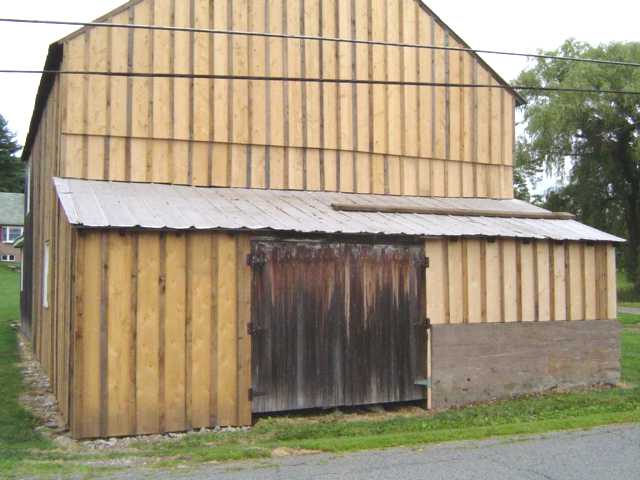

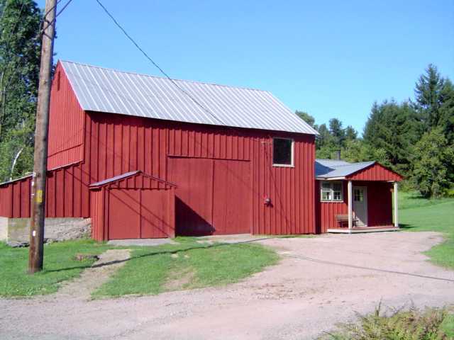

I am thinking about going to airless later for getting things done around the ranch. It takes some practice to get good at spraying with an airless as you can get runs very easy. You have to spray fast but steady to avoid runs with airless but with once you get the rhythm on using them they are as good as anything.
I, also, have a an old Wagner Airless, which I used to spray the barn. It WILL APPLY paint! I believe, it was around 20 gallons for the barn. It is an old barn, which had never been painted, with a lot of new rough-cut restoration.

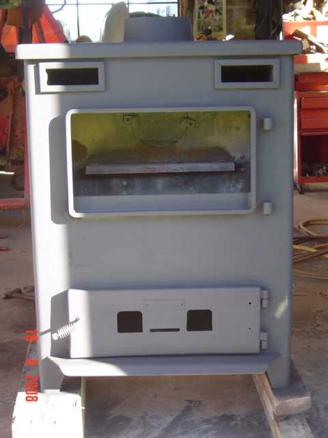

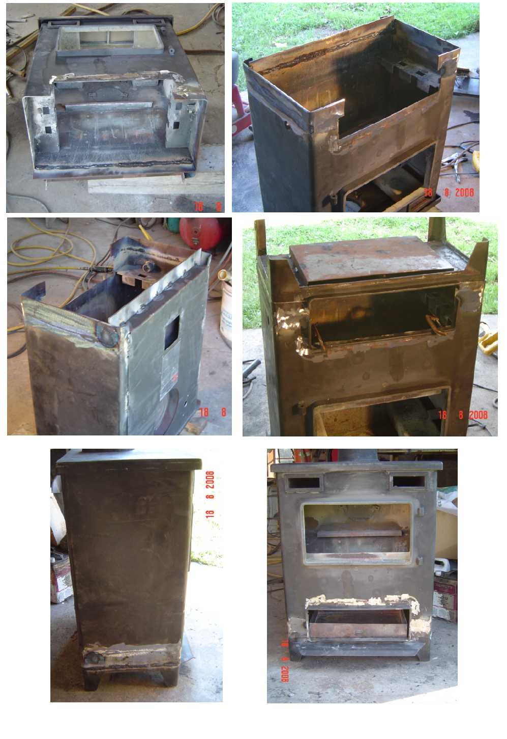

And, then again, sometimes a "rattle can" fits the bill.
I rebuilt my coal stove to have a larger ash pan, as it was a transition model, with only a small ash pan for wood burning. I repainted with the flat, high heat paint in a rattle can. Re-fabed ash pan not shown.
