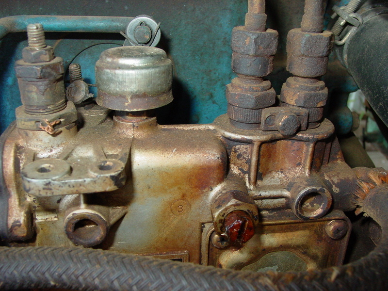

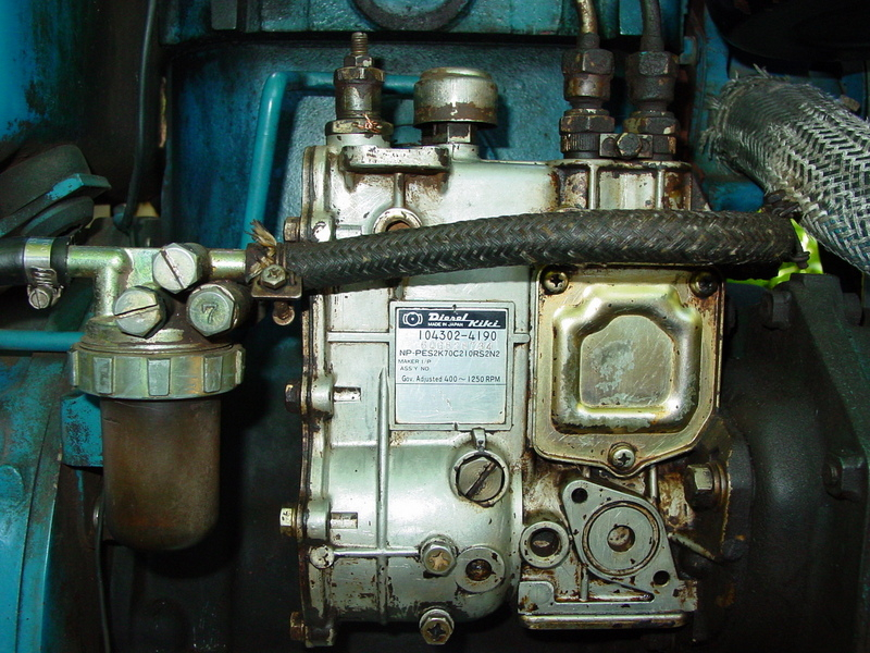

I did not make a thread about it but did have bunch information but it is all scattered. I will add it here with pics , it is pretty self explanatory;
Pic above shows the whole pump. You see two Philips head screws of the same size. The bottom is oil drain and top one is level hole, meaning as you fill the injector pump and when the level get to the level point then the oil will be coming out so you would stop filling and put the screw back in. That is how much oil you would have normally in the crankcase of the injector pump. The governor is 1/2 submerged in the oil and it slings the oil all over. The big flat head screw on top right behind the black fuel hose is also air bleed up to top of the injector pump, slightly higher than top of filter assembly to bleed all air up to that level. look the pic below for vent screw.

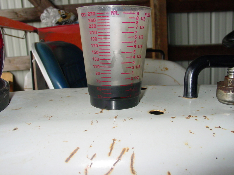

Picture above shows how you capture the oil without making a mess and its about 2 oz.

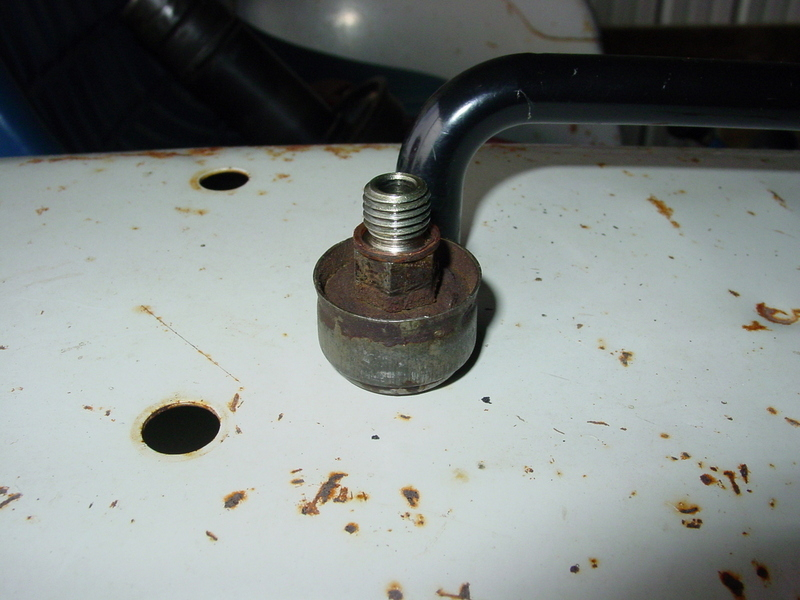

Pic above shows a cap that is ventilated where you fill oil. you can use either a quart bottle with a tip or a small funnel that I normally use. The cap spins freely because it is a vent cap. Need to use a box end wrench to remove the cap as the pic indicates. Reddish looking screw is also air bleed port for the injector pump itself.
All and all , it take 5 minutes to do it. I personally change the oil on every other engine oil change to maintain longevity of the pump. The oil used is same as engine oil.
