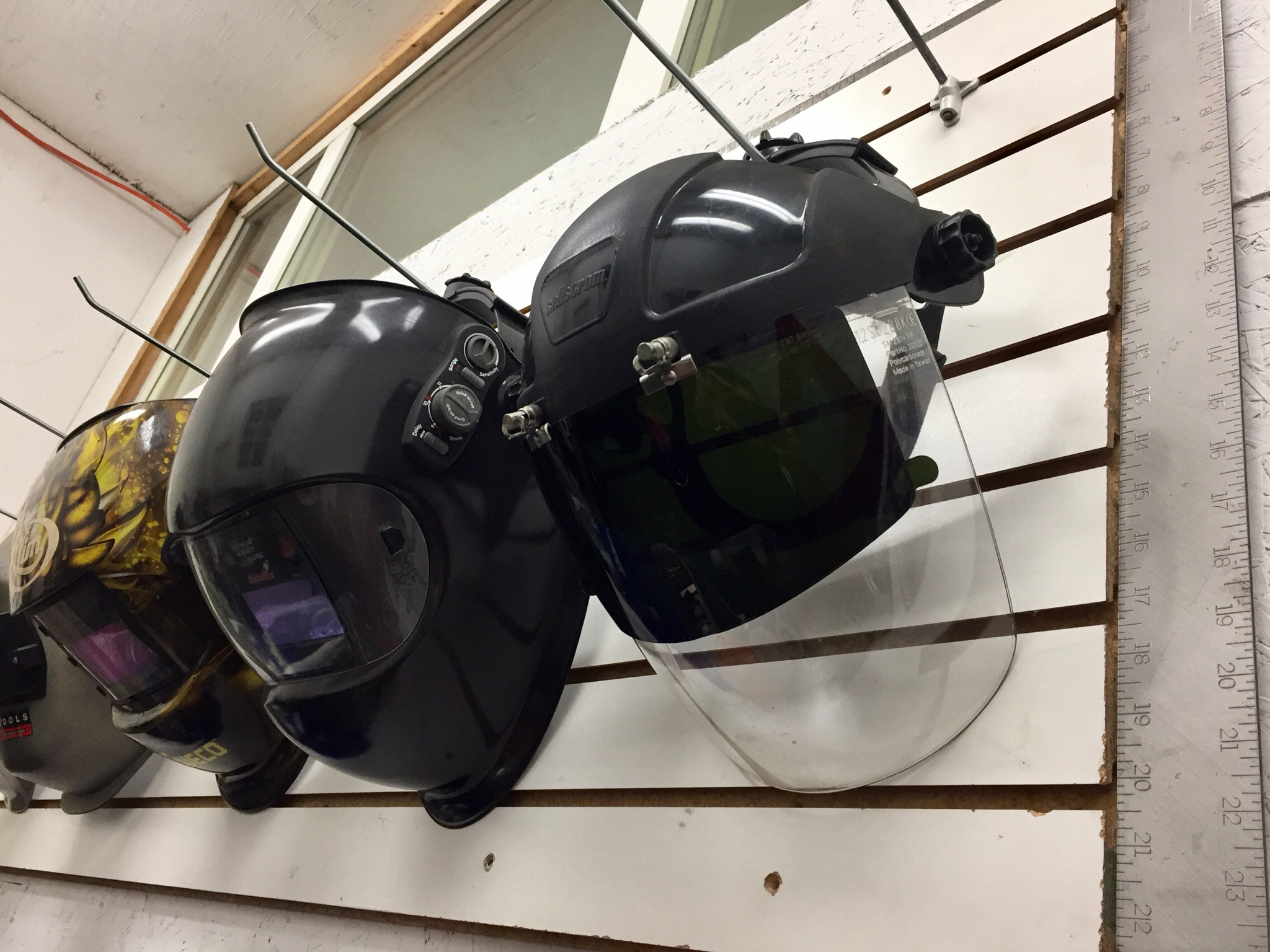

Another alternative is a clear face shield with a flip up shade 5 visor. Most times I use the sunglass type for both oxy/acetylene and plasma. IMG_4485.JPG

Another alternative is a clear face shield with a flip up shade 5 visor. Most times I use the sunglass type for both oxy/acetylene and plasma. View attachment 535252
Terry, that one on the right looks like the ticket! I think I found it on Amazon for US$56. Not too bad... on the xmas list for next year unless I get antsy! :D
Sellstrom 32251 Clear Anti-Fog Polycarbonate Face Shield with Shade 5 IR Flip Front Window and Extended Chin, Side Guard, Universal: Amazon.com: Industrial & Scientific
Edit... I think this one is it w/o chin guard at US$41
Amazon.com: Buying Choices: Sellstrom S32151 DP4 Multi-Purpose, Plasma Cutting / Grinding, Flip Front Shade 5 UV/IR Face Shield - Black Crown and Clear Anti-Fog Window with Ratchet Headgear
Now I am even closer to not waiting until next xmas!
