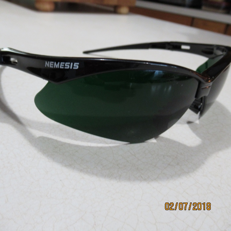

Let me ask a question. I also have some shade 5 glasses from a high class welding shop that I never got around to using but don't have the packaging to say if they are UV protected as well as the shade 5. Are most shade 5 welding glasses UV protected as well?
Is there a name on them, that you can search for the info?

Good thinking. I checked and they are UV protected. Nemesis glasses.
Jackson Nemesis Safety Spectacle - Shade 5 Lens 25671
I use these under a face shield or simple cutting and for plasma serious I use a full shield with shade five as JGriffin suggests below. That really is the best option for most of us. Plasma cutting is dangerous and I have has sparks fly everywhere they shouldn't.
