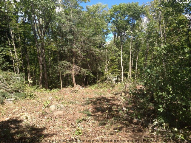

Forest setting is rough, rocky, and I have a dozer coming in to clear wide trails.
That first pic looks a lot like my property. I'm able to creep around pretty well with my Yanmar 276D. (27hp, 12 speed forward, 4x4) It's small enough to usually get to where I need to be, and the 12 speed lets me go really slow if necessary.
