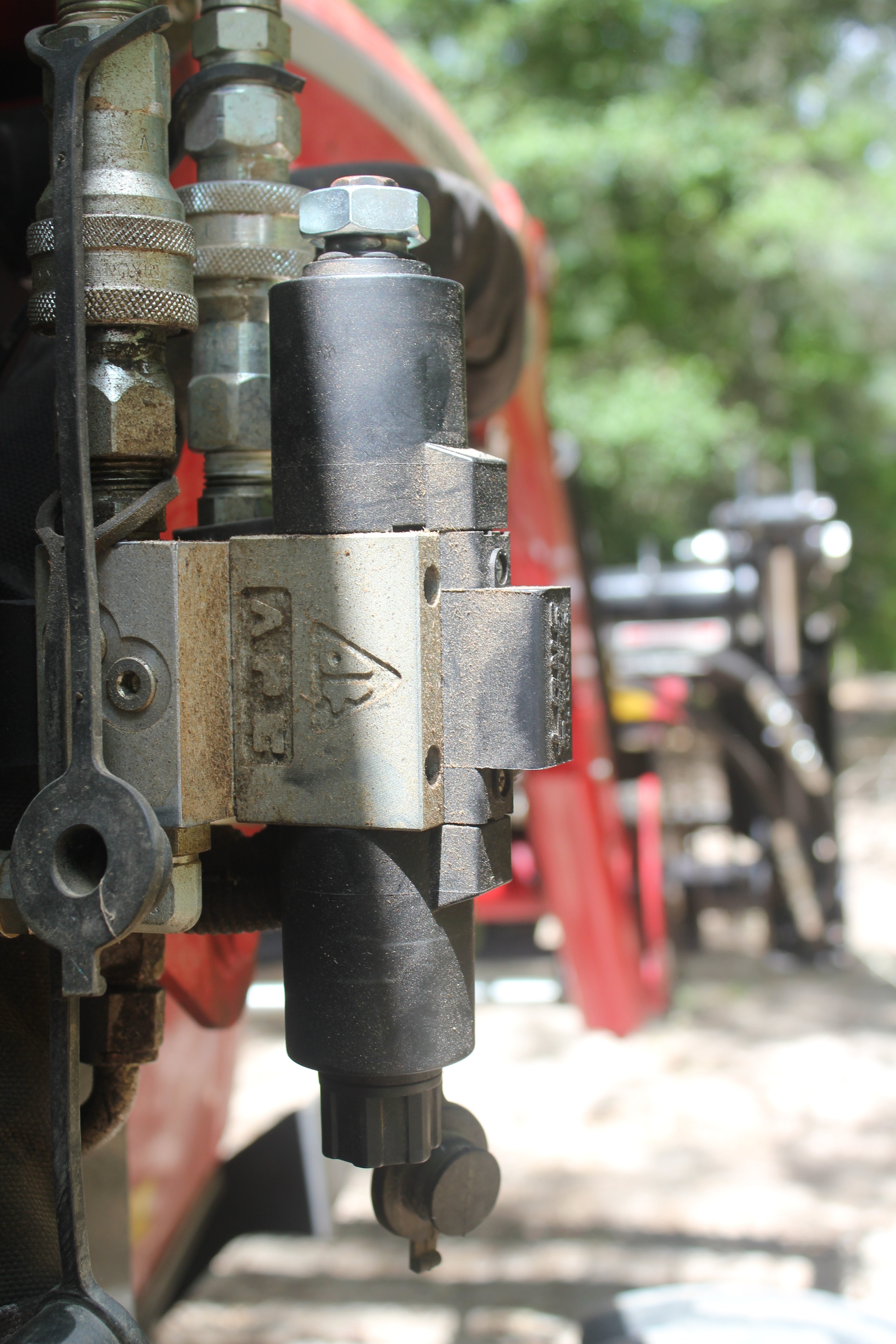

I've had a rash of these things happening to me lately.
The picture shows a hydraulic diverter valve on the tractor, I was clearing some brush and the plastic screw cap came off that keeps the solenoid on the bottom coil from falling off.
Not a major issue, I popped the solenoid back on and used the screw cap from the top one to keep it in place. I reasoned that gravity would keep the top one where it belonged.
So... I try and buy a new screw cap. Can't be done. The dealer is willing to sell me a complete 3rd assembly for $700+, but they did show me who made the diverter valve.
However, the manufacturer only sells complete units for ~$150.
So, I get out the thread gauge, figure out what I need, and order a nut from McMaster-Carr.
