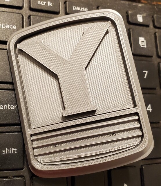

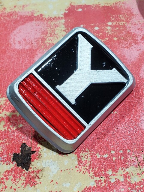

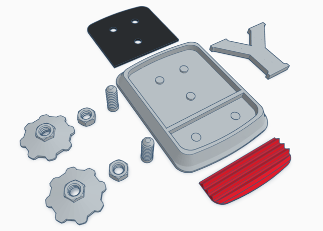

For small hard to find parts, yes, Grainger, McMaster-Carr, Mouser, US Plastics, ULINE, etc. Once exhausted, turn to the 3D printing community for help.
3D printing is taking over where dealer-stealers fail to provide. And with the last 4 years of a broken supply chain, it's become more critical to learn some 3D software to make your part, send it out for a 48hr quote bid and have the part in your hand within 2-weeks.
Not only can 3D printing do plastics, it's now into CARBON FIBER and sintered metals.
FreeCAD is just that, Free. For Kubota and Yanmar many in our community know CAD software and have stepped up making replicated 3D models to have parts made.
Test print in 1 color
Printed in each color and fused together.
Finished 3D printed part

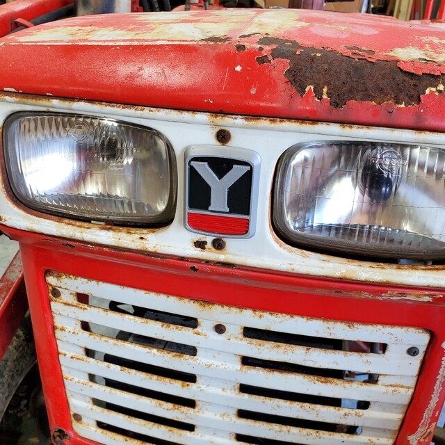

What it looked like years ago new on another model tractor,
We can do dash clusters, headlamp bezels, grills, and other needed parts that can handle up to 180F.
