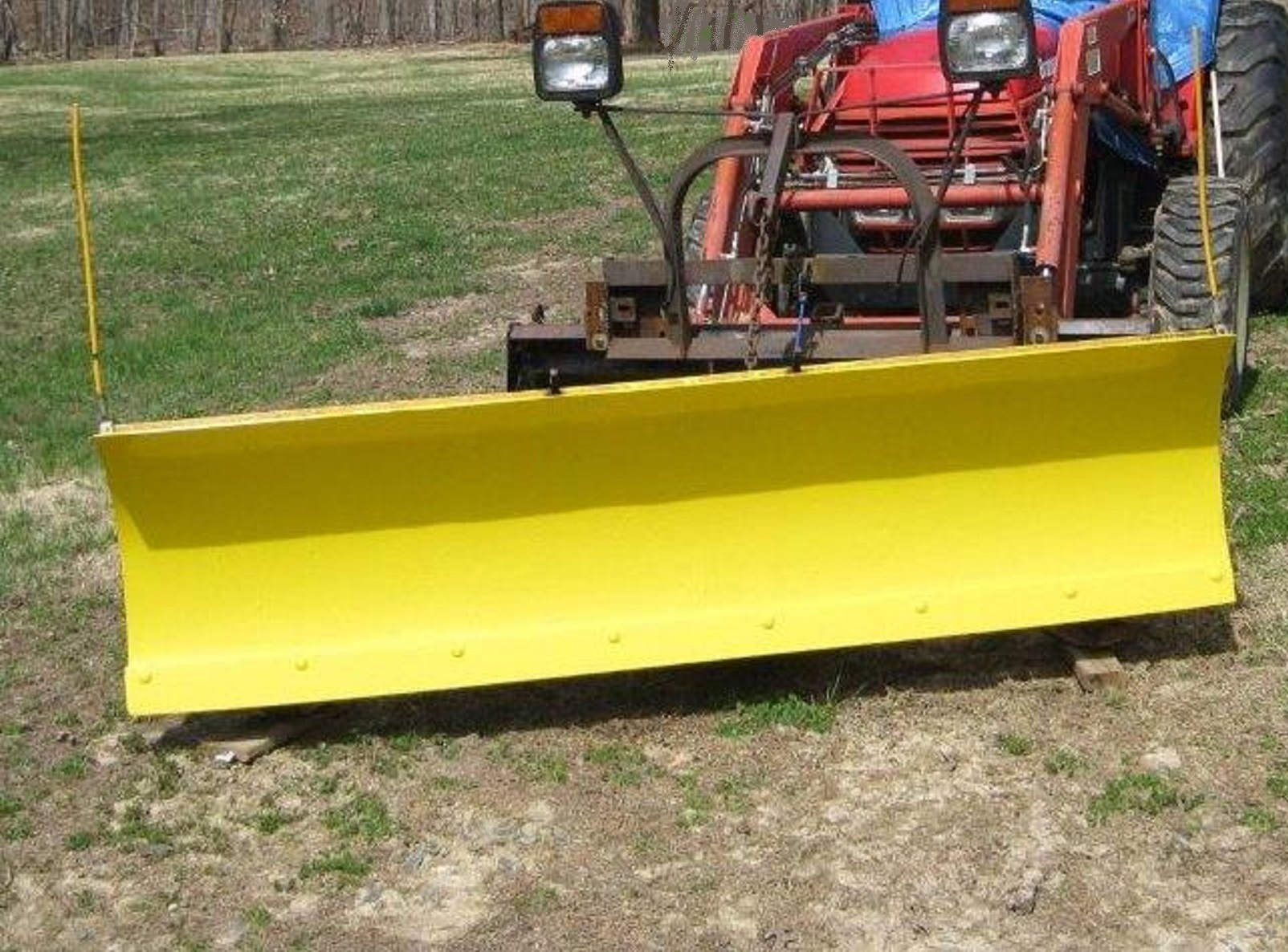

I added this 7.5 foot meyers a few winters ago (?) but I had problems controlling it. It worked flawlessly this winter after changing the mounting system. I removed the upper mount and chain connection and went with a rigid link. I had minimal gravel/slate loss.
