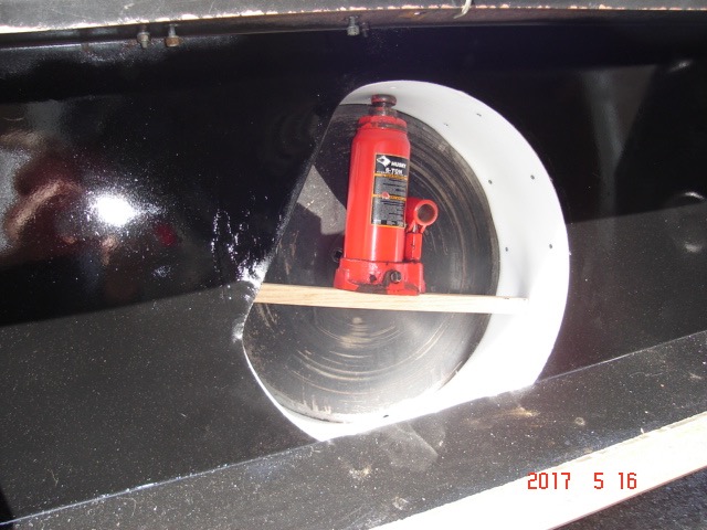

I have been thinking for many years about getting better performance from my MF2360 Snowblowers discharge chute, and I have finally started this little project.
I purchased a sheet of UHMW for $48, 1/8" x 24" x 48".
Removed the discharge chute and have begun making patterns from 1/8" cardboard.
I intend to heat up the UHMW and reshape it to an approximate size of 6.375" diameter.
I also intend to close off the opening in the front of the chute with this design, don't know if this will cause any problems, but if it does, I can do some cutting to open up the front of the chute.
After I finish with the chute, I intend to add this UHMW to the snow side of the 3 fan blades and also reduce the clearance gap of the fan blades to the housing (I may use some rubber or belting at the ends of the blades).
Here are a few photos:
KC
(next update about this project, see post #28)

Yep, I did that, KC -- worked very well. Instead of adding to the fan blades, I covered the cylindrical space, as well as the inside of the chute. Made an amazing difference.
I am hoping I'll notice a big difference.
