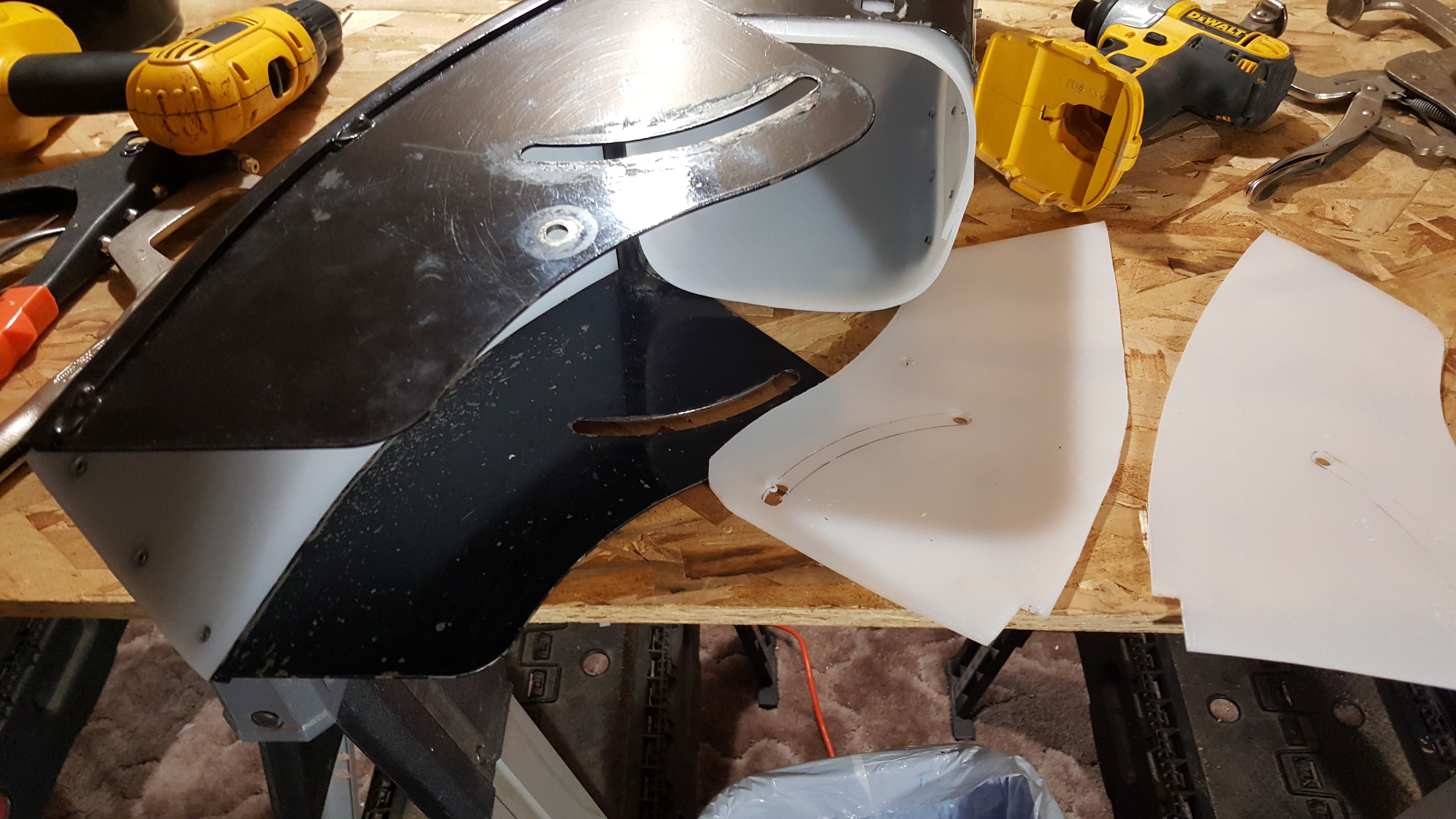

My UHMW MF 2360 Snowblower chute lining project is progressing slowly, but I know it will be done before I usually switch the MF 2340 Dozer Blade out for the Snowblower for the winter.
Today I am going to try to finish the chute lining, and then it's out to the unheated garage to work on lining the 3 fan blades.
It's -2 degrees F right now on the back deck and we are to get a little more snow later today.
Here are 2 more pics of the project:
(next update about this project, see post #32)

Is it due to time or is that plastic just hard to shape and attach ? Be nice not to get snow build up in the chute when done. 8-15 inches of snow expected for us between now and Saturday late afternoon plus high winds.
