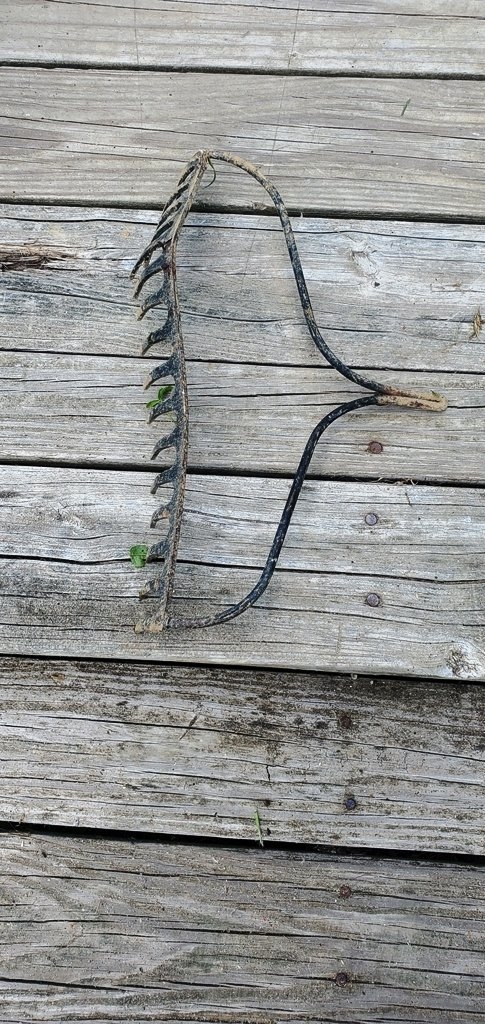

In the process of fixing one of my 2325 MMM wheels... apparently the snap ring fell off, then the washer, then the wheel shaft dropped down. Had no idea until I raised the MMM and parked the tractor, noticed the front right (pivoting) wheel was hanging down. Have no idea how that happened, but will replace washer & snap ring...
least you didn't break half the mount off deck like I did LOL
heck of a time heating, aligning, welding to get brackets close to correct angles so wheel sits where it should on cement and maintains front to rear level. mine looks odd now due to ribbon bends in mount but axle sits w/i 1/16 inch of stock now.
mine was left rear, only time I ran full throttle 4wd low range when mowing. caught wheel on landscape timber as cutting corner. didn't even really feel it. almost (7/8 was tore) fully tore one section of bracket and bent the other.

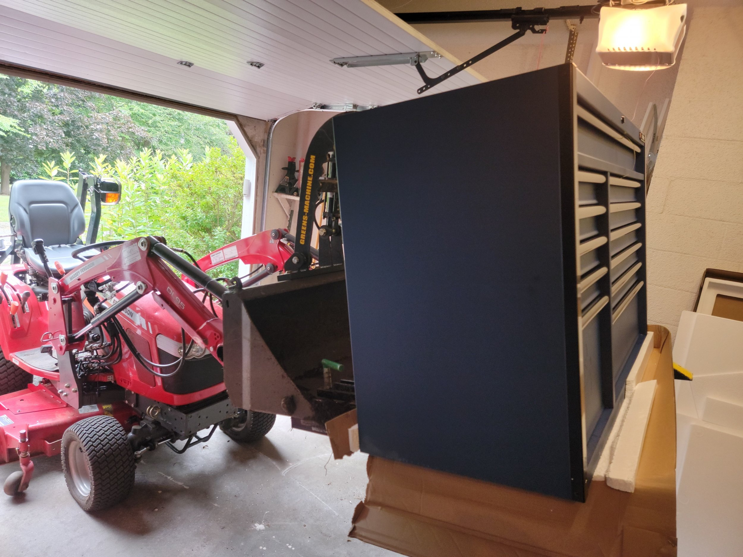

Got a new toolbox, this is the bottom of the 56" Husky. Lifted it up on some clamp on pallet forks to install the caster. Gotta be 300+ lbs. The spec weight on the pair (top and bottom) is 542.

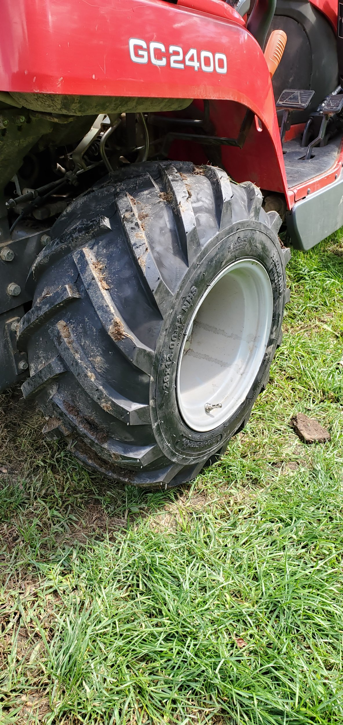

10 ply r1 tires replaced r4 on rears. these things dig in and go.
   / What have you done with/to your GC Series 2300, 2400, 1700 Tractor TODAY #1,008
What is the tire brand? Where did you get them. All the Massey dealer will sell me are 4 ply
ebay
like most lugged tires I've dealt with they are about 1 inch shorter than r4 tires and of course little narrower. just for the use I have the added traction needed, snow/snow bank clearing as well as tilling.
r4 tires plugged up in mud and snow.
   / What have you done with/to your GC Series 2300, 2400, 1700 Tractor TODAY #1,009
I'm curious if you looked at they newer versa turf/R14T/hybrid tires when deciding which tires to get?
I did, made choice that works best for me in the worst scenarios.
my lawn is old cow pasture so don't care about marks.
due to way my truck and town plow interact at entrance to this private road I have to clear banks on edge of a 6 foot drop off and need traction.
lot of clay in area that r4 get messy with when tilling.
Ah. Ya that's about the right tire for that mess.
