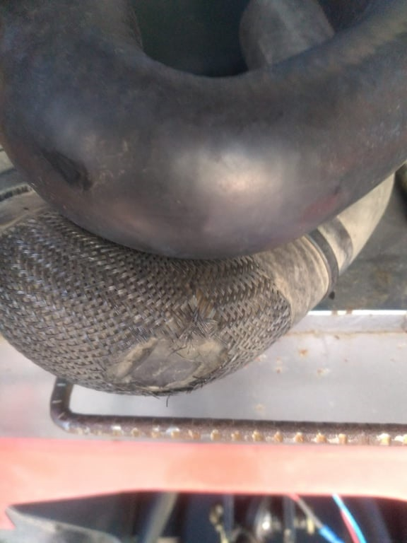

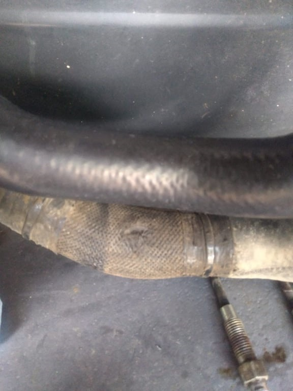

Maintenance day today. Changed out the glow plugs, motor oil, anti-freeze and both rad hoses. Both hoses had gooves worn in them from the throttle lever and the air filter hosing, down to the cords. 2nd time they have been replaced for this issue.

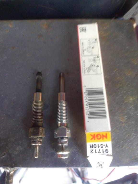

Couldn't start this winter without using a heat gun on the air intake, glow plugs were shot, inexpensive NGKs picked up on Amazon.

How did you cross ref the Massey to ngk numbers for plugs? Mine are ok right now on the gc2400 but being 11 years old I was gonna start looking for aftermarket to have info on hand.
   / What have you done with/to your GC Series 2300, 2400, 1700 Tractor TODAY #985
It was an old post from a GC2400 owner. I let someone else do all the work.
   / What have you done with/to your GC Series 2300, 2400, 1700 Tractor TODAY #986
ah so the 2300 and 2400 used same plugs. good to know

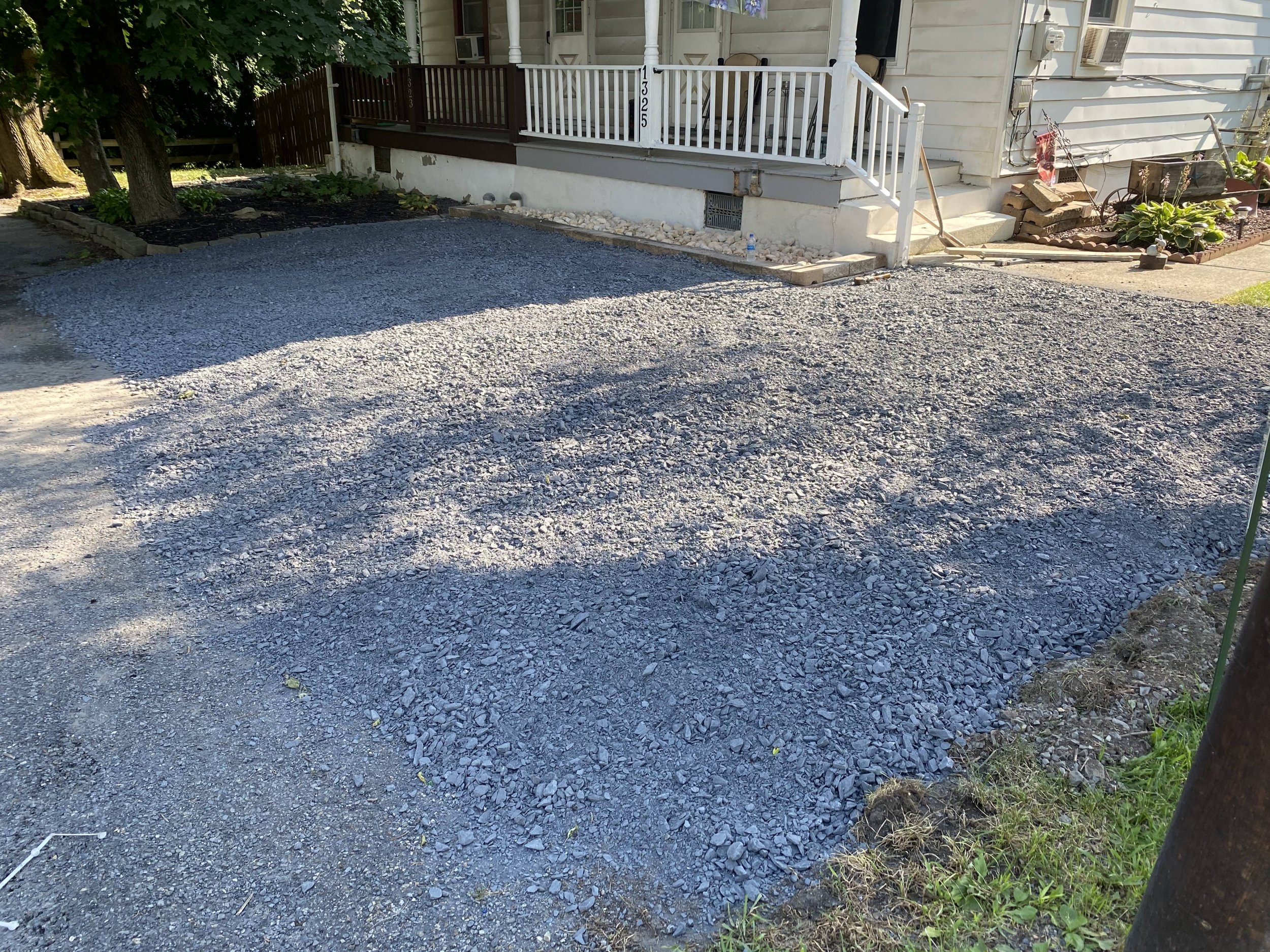

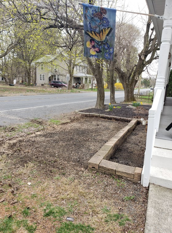

Reset and level retaining wall, some decorative stone and a parking area for a customer.

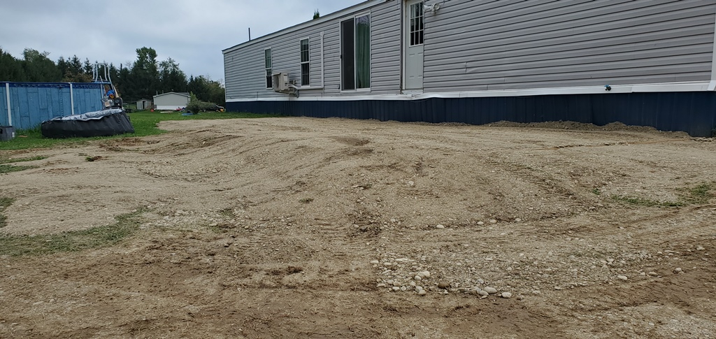

need another 5 yards gravel to fill low spot and keep grade but homeowner decided to just vuild deck on it as is...advised against but due to money they had to.
oh well.
20 heavy yards placed, depth runs 4 inches to 32 inches.
length 43 ft long and 13.5 feet wide.

Huh. By "customer" you mean a friend you helped out? Where's the retaining wall - I see borders but no wall. Just curious, since I need to do a retaining wall in my back area - also, that's a really casual job to get money for - particularly out where I live.
   / What have you done with/to your GC Series 2300, 2400, 1700 Tractor TODAY #990
Paying customer. The wall is the border. It is surface set, not a proper set wall, that is what the customer requested. I removed wall, graded, removed and hauled overburden/sod. Leveled and reset wall, provided fill, fabric and decorative rock for within the wall. Supplied modified stone and placed for the parking area.
