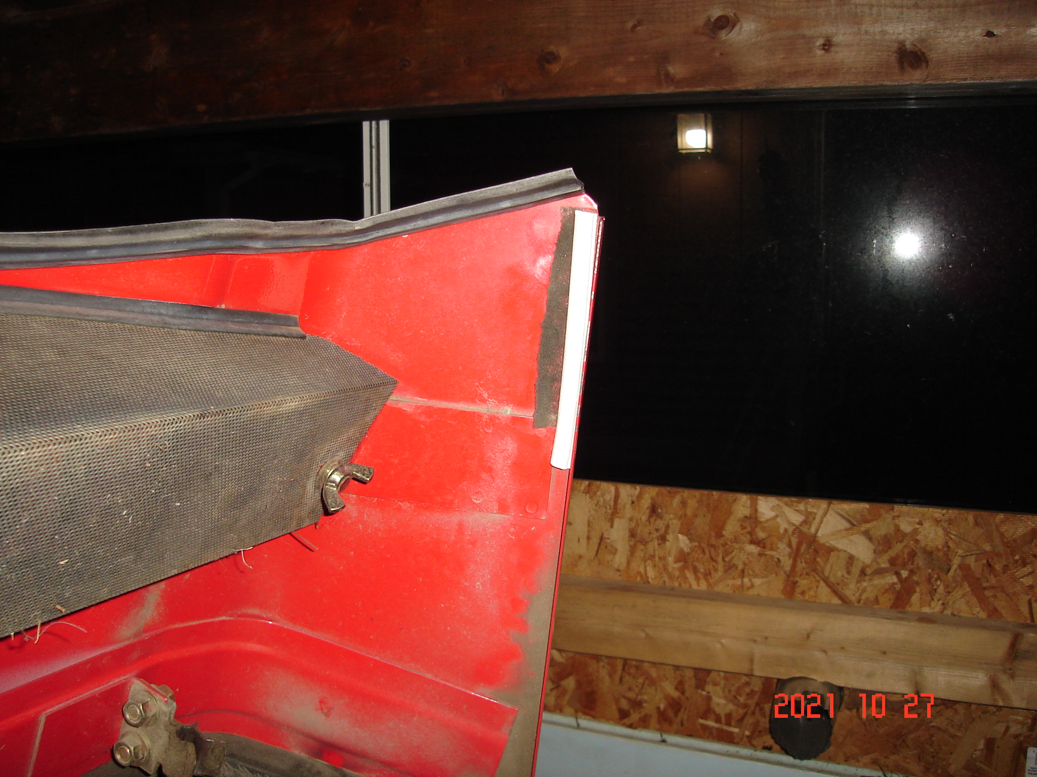

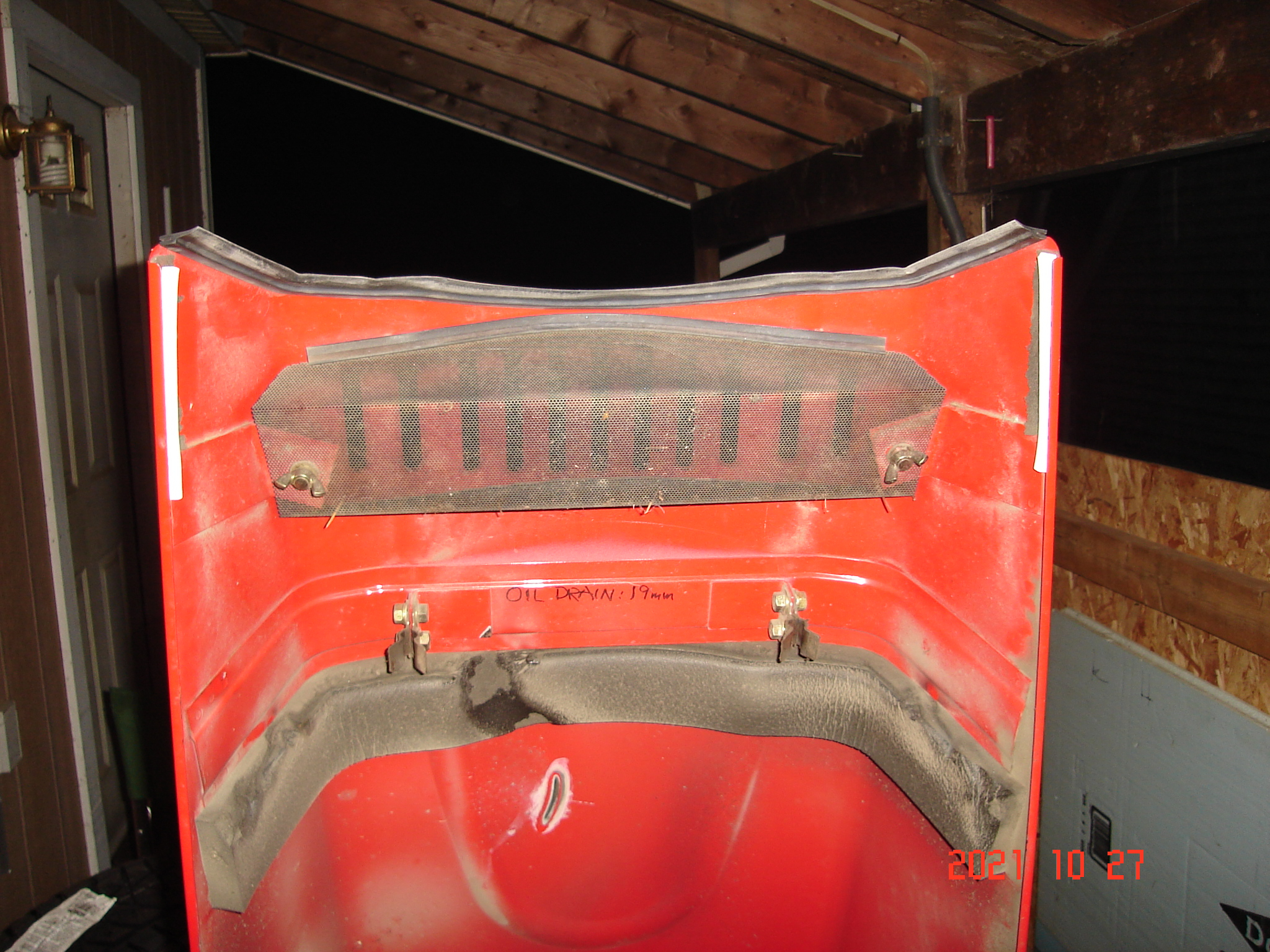

For those of you with older GCs -- I thought I had an engine knock (!) but it turned out to be the hood, vibrating left & right at idle. The OEM foam anti-rattle strips had just worn off over the years, so I added two strips of P-Strip insulation stuff. No more knock!

even got the oil plug mm written there JUST IN CASE :);):D

Hey, gotta be prepared! Oh and btw Irving, mine's been doing the same thing, rattling and all. And I also did think it was the engine until I pressed against the side of the hood...that was a relief!

Right -- I thought for sure I had a rod knock -- it sounded just like one-- until I finally put my hand on the hood. That was, yes, a big relief.
