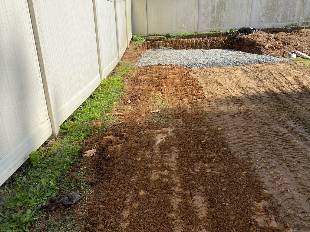

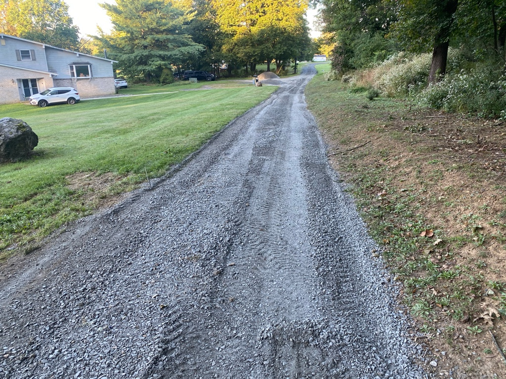

Been busy!
Driveway and parking area for 1, shed pad for 1, large driveway resurface for 1 and a new tow buggy!

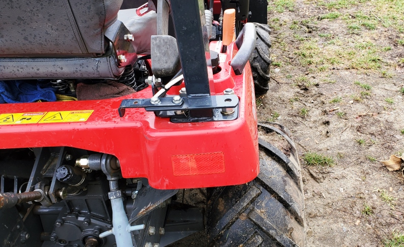

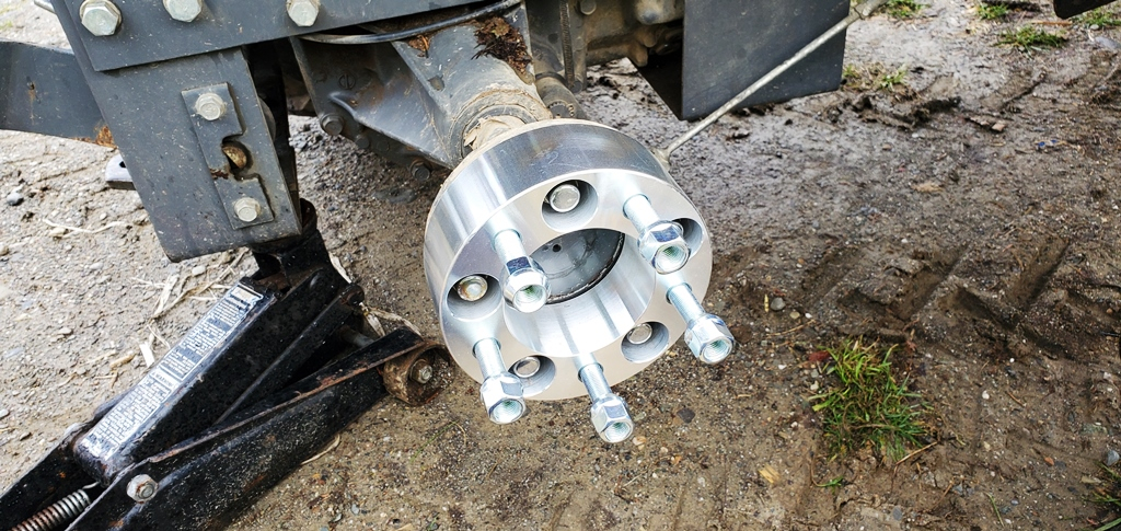

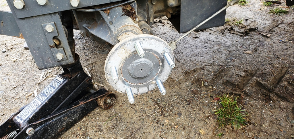

added my 1.5" spacers today
stock no spacers
1.5" spacer added
since my backing plate was in real good shape I did not want to alter it. I picked up some M12 1.5 pitch 50mm bolts and drove them thru backside with loctite on last few threads. do not use lock washer/etc here if you do this, you want the bolt head as tight against axle flange as possible. I spun them in to approx 50 ft lbs torque and let loctite cure a few minutes.
then just bolt on the adapter, I had a bunch of old lugnuts from wifes 2013 explorer which were also a 12m 1.5 pitch so that worked out well.
and then just toss tire on like normal. even if I hadn't been going with a spacer I would have done this as hanging a tire off a stud is a LOT easier then holding a tire up to a hole and inserting a lug BOLT.

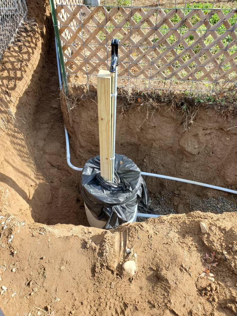

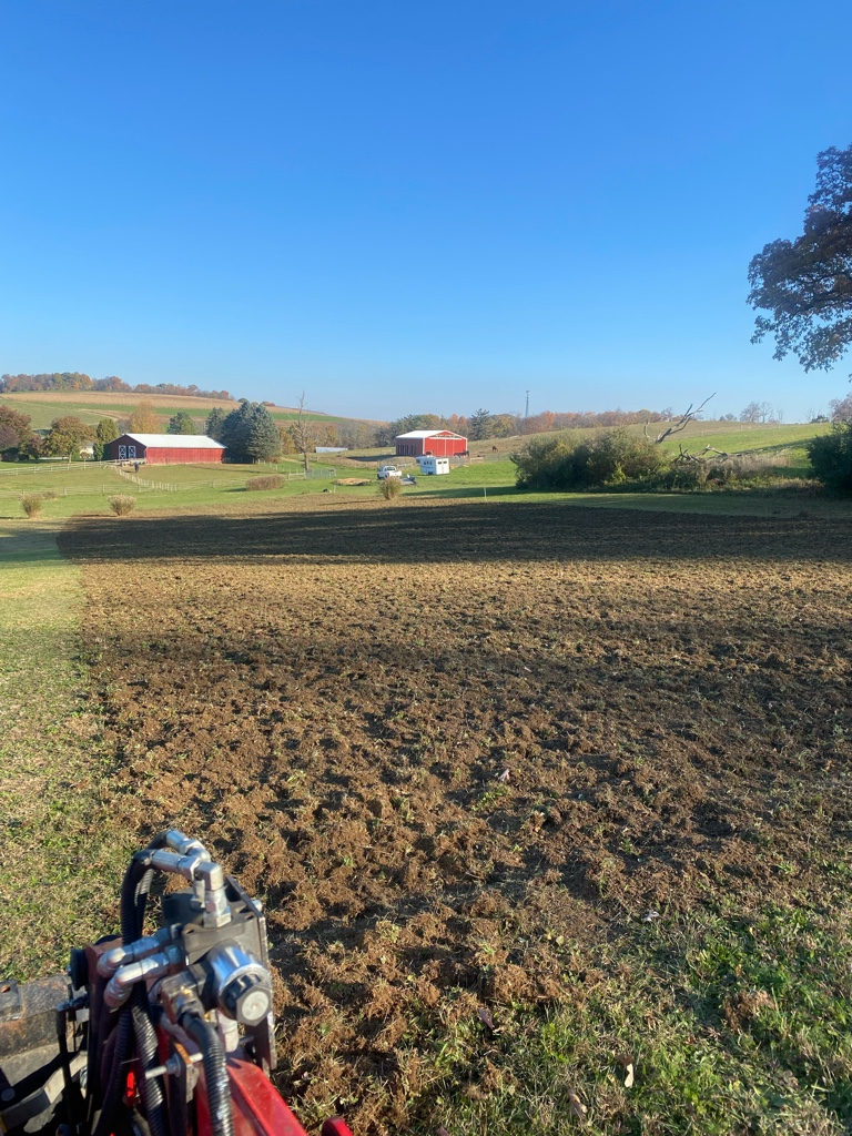

After starting the project in mid-August during a vacation, to breaking a piston which delayed 3 weeks for parts. Then having to wait till the refuel outage at work was over, we finally have water and power to the animals.

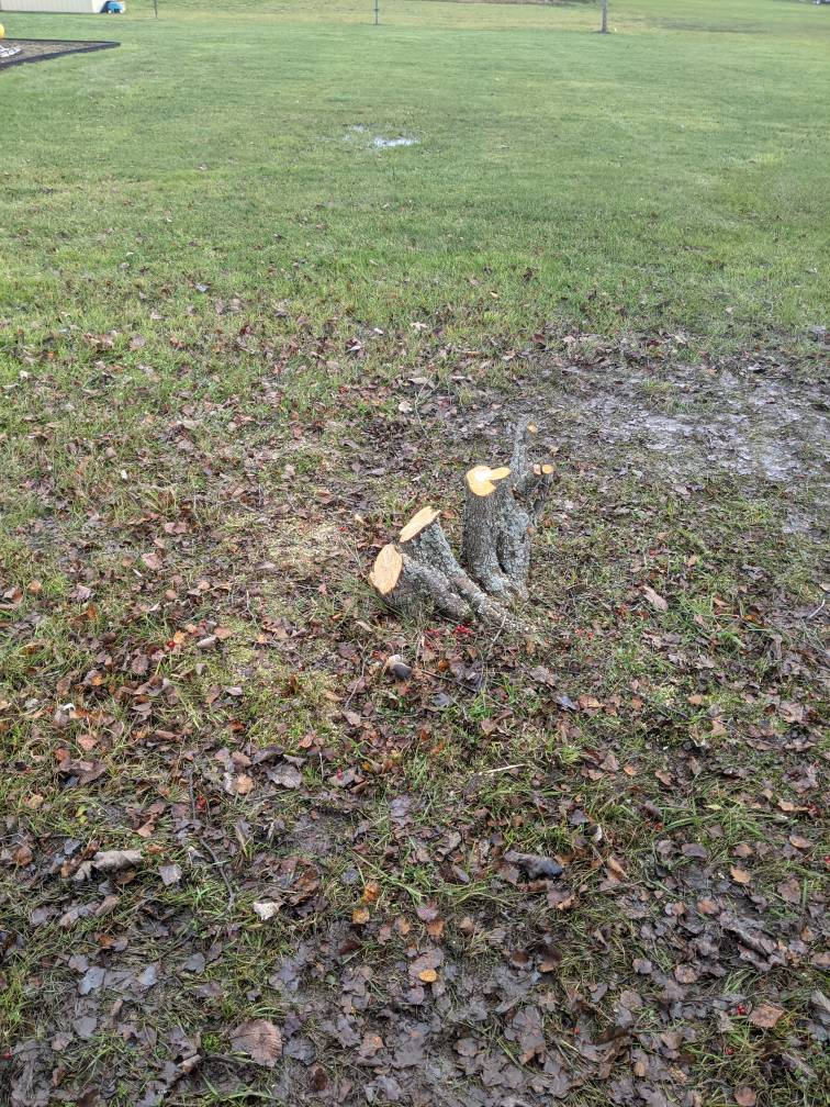

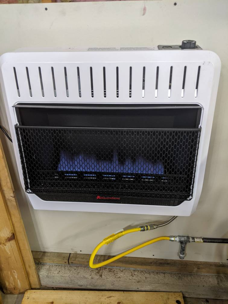

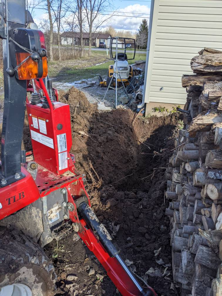

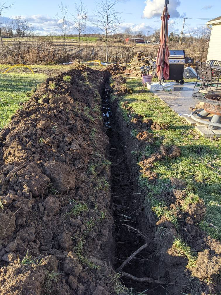

Been a great week of vacation. Did the 500 hr service on the machine then got to work on a series of projects. I trenched a gas line to my garage to power a workshop heater for the winter before it really sets in. Then backfilled the trench once everything tested out ok. Then strapped up the chipper and whipped out my trusty Echo CS-400 and turned a crabapple tree into woodchips. The little tractor never ceases to amaze me.

What size garage? How many btu's?
On my time do list next year
   / What have you done with/to your GC Series 2300, 2400, 1700 Tractor TODAY #1,149
30k BTU unit with built in fan to dispurse heat over a 480sq ft garage that isn't really greatly insulated. Unit itself is advertised for 1k sq ft
   / What have you done with/to your GC Series 2300, 2400, 1700 Tractor TODAY #1,150
Ahh, I'll probably need 100-125k btu and I'm looking at midline or similar.
