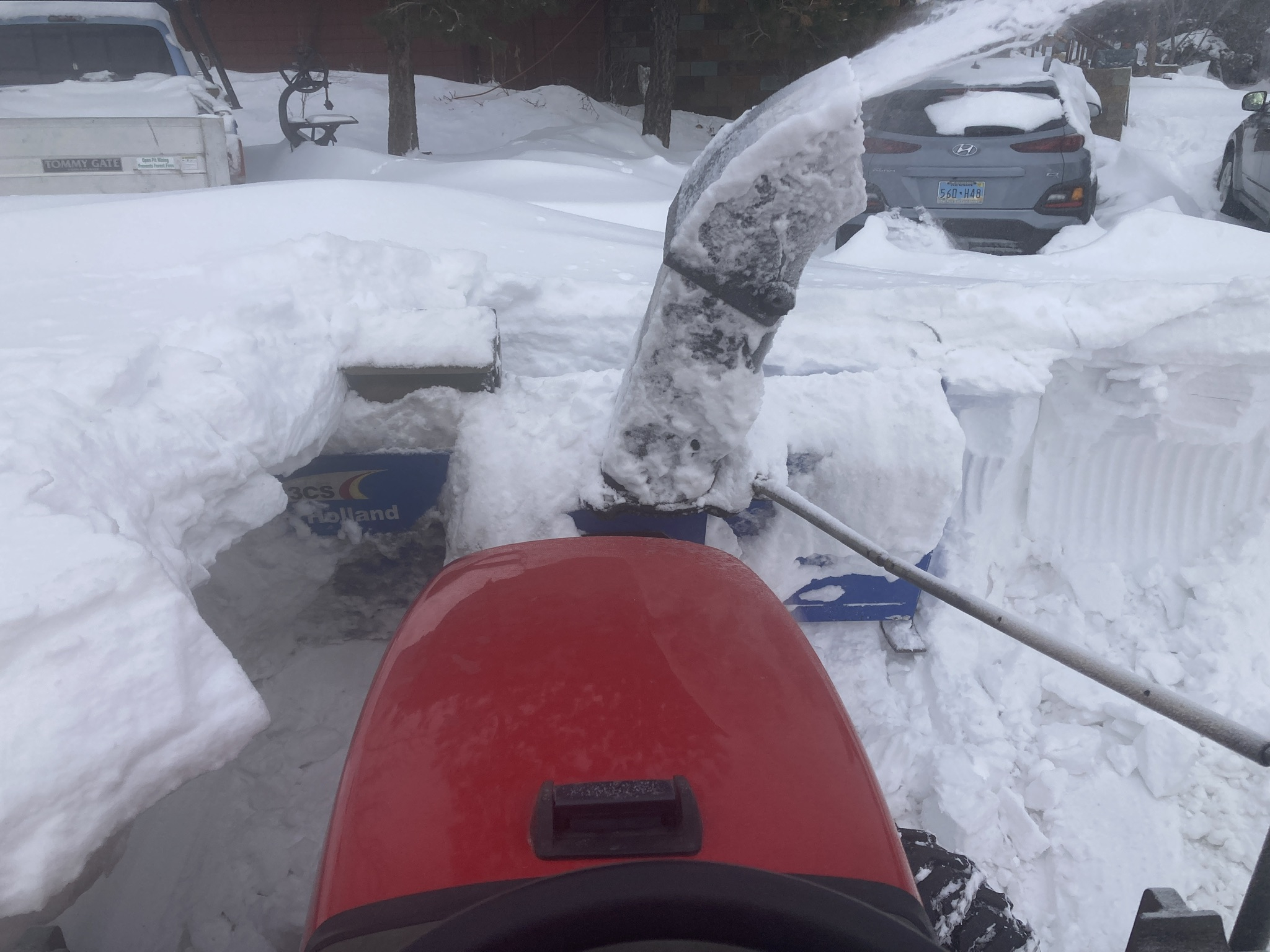

Doing some serious snowblowing with a 63” blower on my GC1720. Works perfectly and plenty of power even at 6,000 feet elevation. Real happy with the blower and the GC1720.

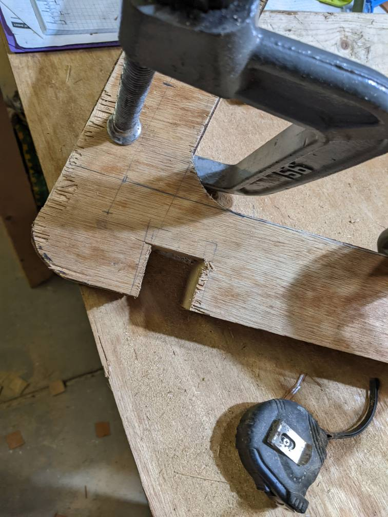

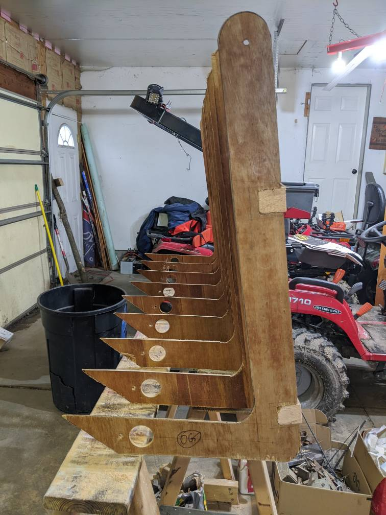

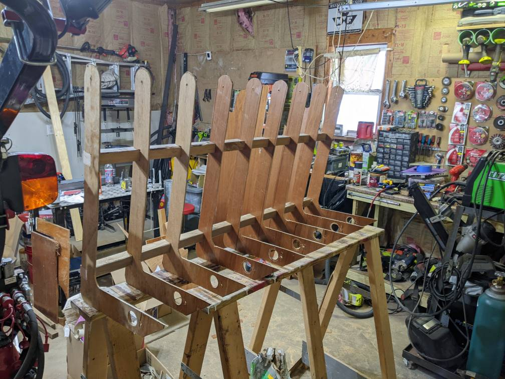

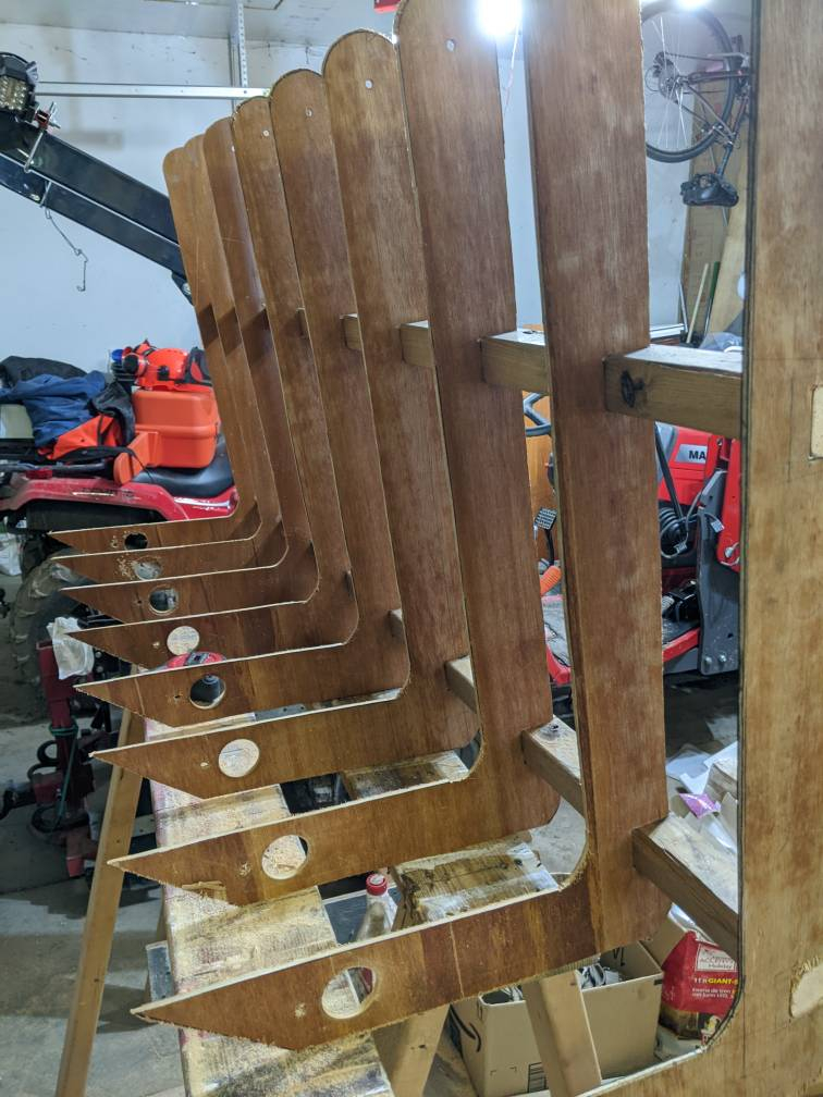

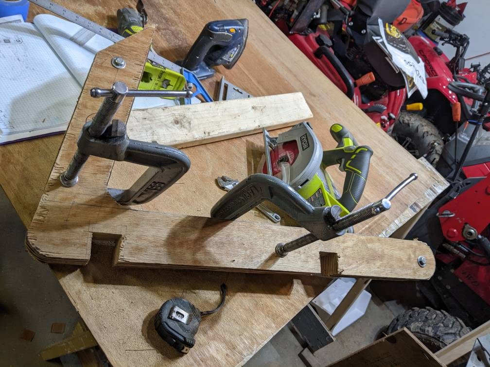

Got the tines indexed for the grapple model I'm making up and ripped a 2x4 for the backing piece. Drilled holes down low for a round tube cross member. 1st 2 observations are that I want to round the bottom angle at the top of the tines and cerate the top 6" from the tip or so of the tines to grab and hold material. I'll probably start design on the upper jaw tomorrow

That's a super-serious wood mockup prototype, CG.

It'll be a fully functional model. I won't go use on debris per say but I intend to attach the hydraulics and put it on the tractor to test dump angles, clearances, function, etc. A sheet of AR400 is nearly $1k around here so I wanna make sure I'm absolutely sure on design before I pull out my plasma cutter and cutting.
