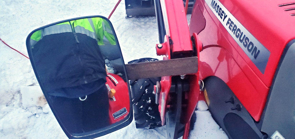

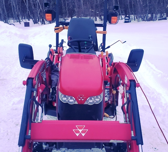

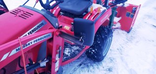

mounted mirrors today.
could not find anyone making set for DL100 FEL (prob due to gc2400 having loader control 2" from loader frame) so had to mess around.
bought these only due to size and characteristics of mirror itself. the mount did not matter to me.

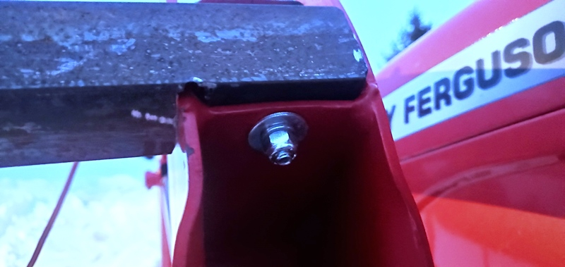

then grabbed 2 12" pieces (12" to get past the loader controls) of 1.75x3/16 angle iron (1/8 was not stiff enough) and slotted it to fit on top of horizontal part of DL100 fel rear frame.
then bolted bracket there. now on that outside 3/4 inch edge there will be a weld bead top and bottom for more vibration control. this will allow me to remove that angle iron in moments if needed.
I'll wire brush and paint in warmer weather, any attempt now would be a waste.
there is a little vibration now but...on mirrors mounted to loader frame there always will be. but its not bad at all.
I have been looking for a way to mount mirrors since I got mine. I don't remember if the FL1805 has that bar where you mounted the angle iron, but I don't recall seeing anything like that. I will need to look at it next time I get it out.
