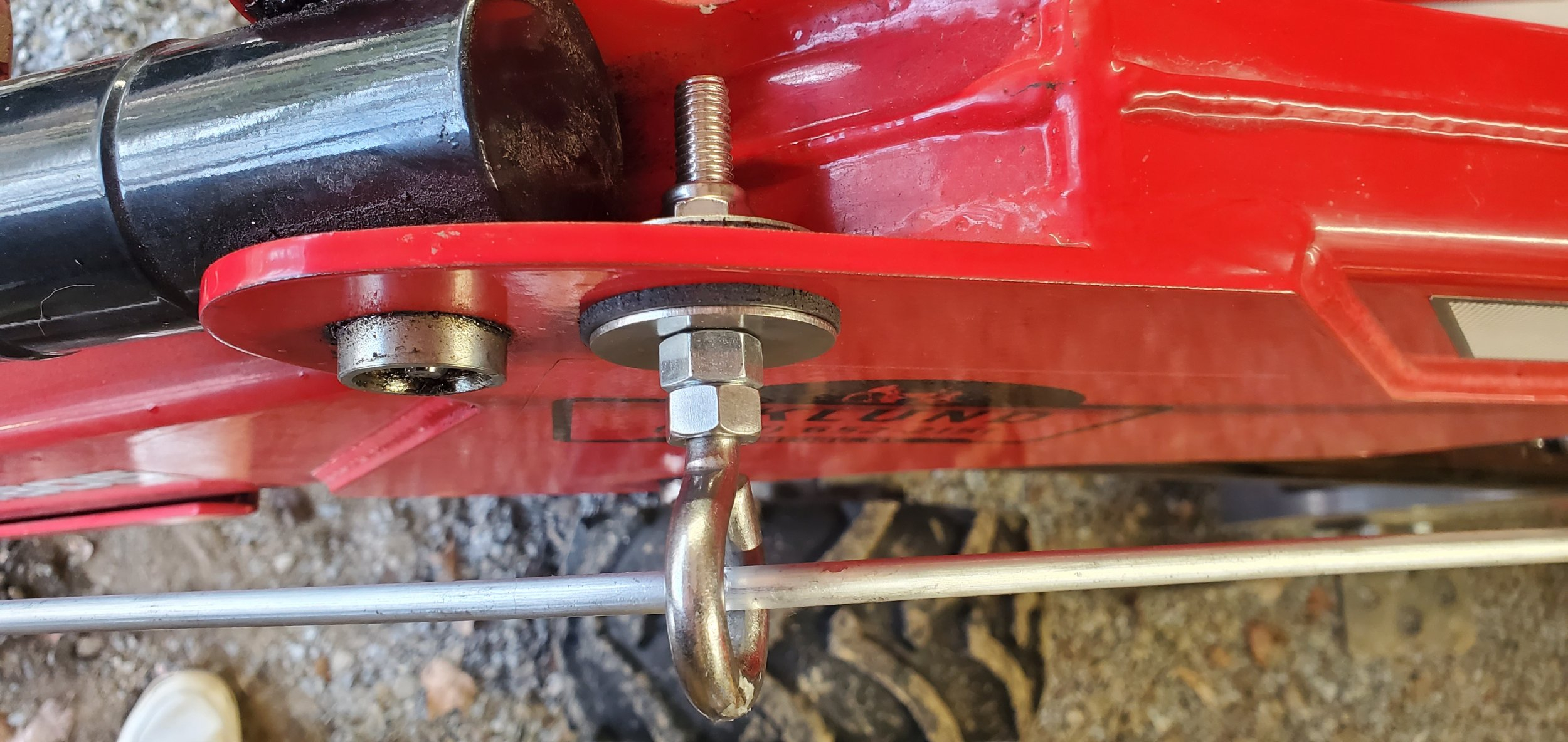

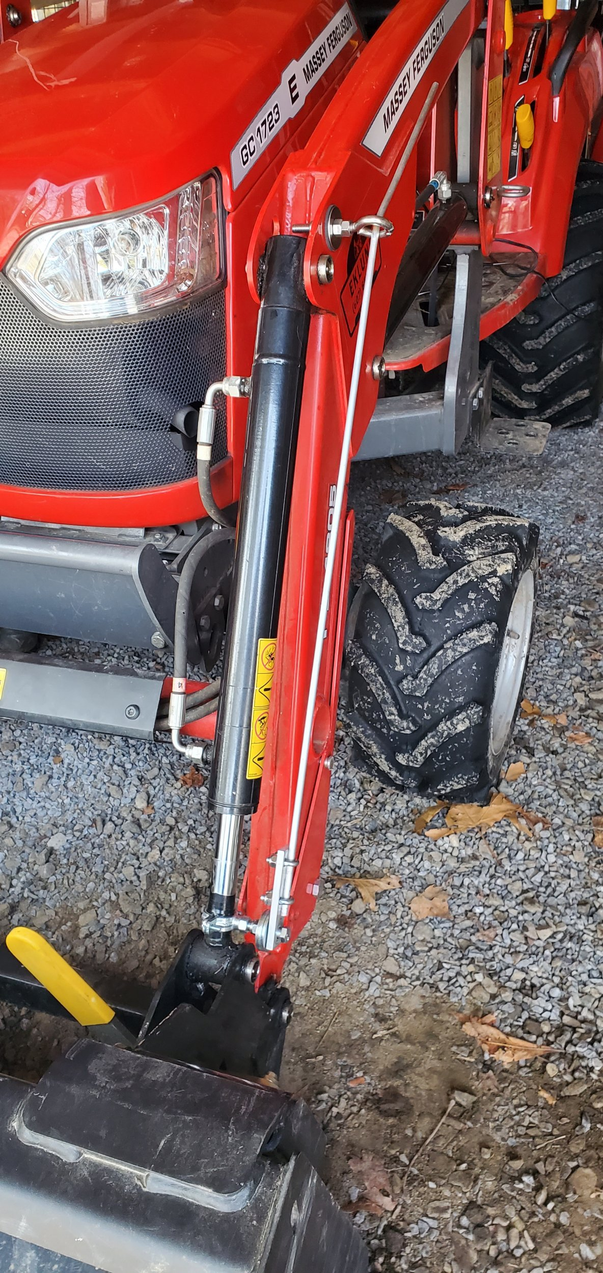

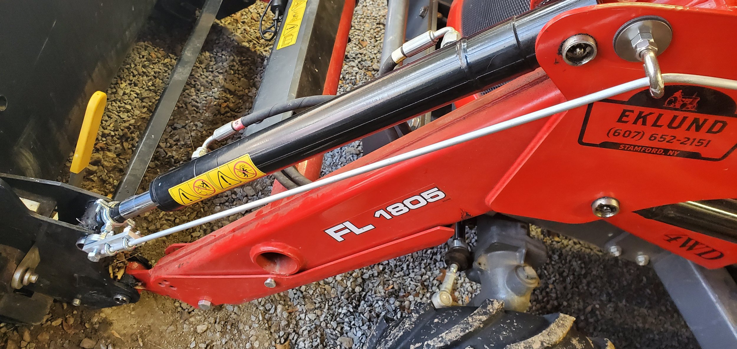

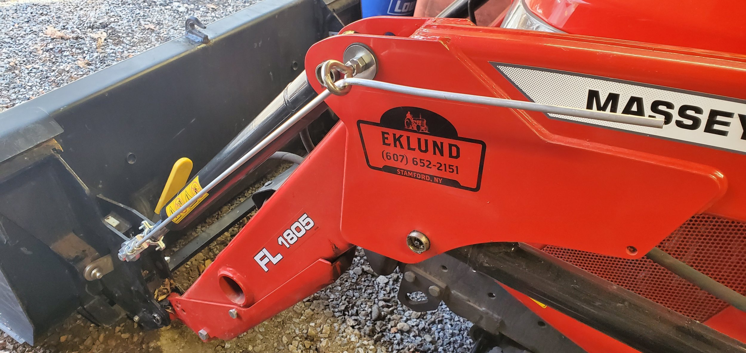

My homemade bucket level indicator. I used a 36" x 1/4" aluminum rod from Lowes and assorted hardware. I did have to make a bracket out of some scrap aluminum for the rod to pivot on at the bottom connection point.

I really got to do something like that
