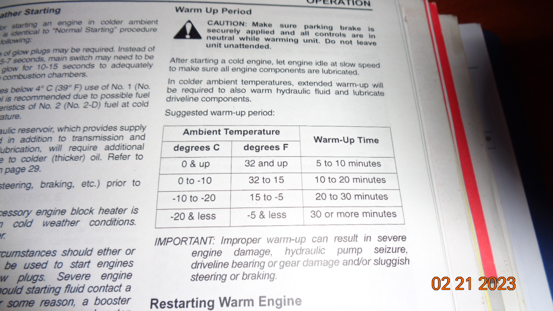

   / What have you done with/to your GC Series 2300, 2400, 1700 Tractor TODAY #1,799
Here's the chart from my GC2310 manual. (Apologies: I hate this camera!)
   / What have you done with/to your GC Series 2300, 2400, 1700 Tractor TODAY #1,800
I guess mine idles around 10 min overall. I normally hand shovel the walkway while she's warming up.
