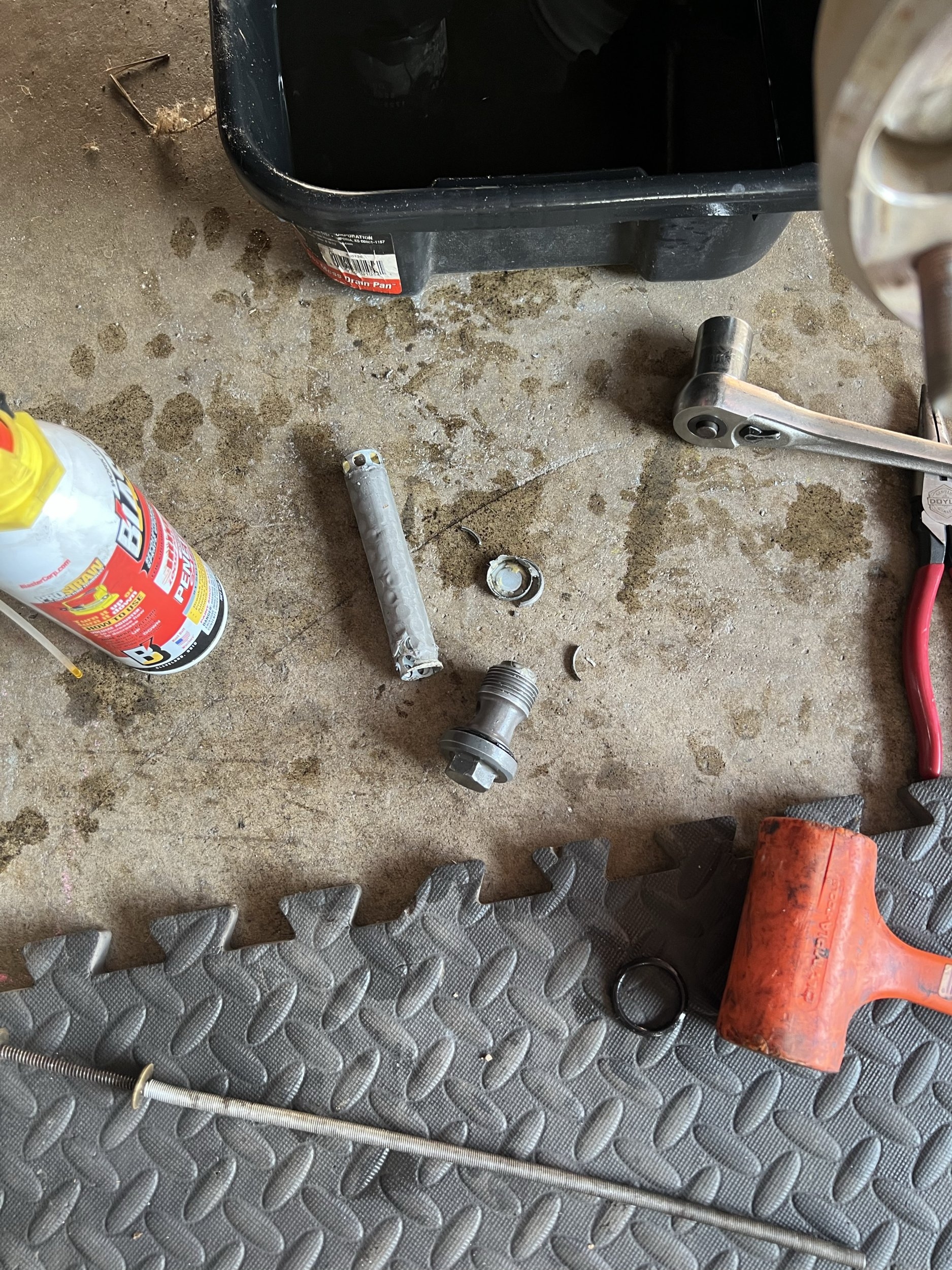

800 hr hydro service and that F’in aluminum filter got me…..
Was not cross threaded, went in about 1/4 of the way and about 3 threads just snapped off.
Best I can figure there was a price of debris in the threads.

thats the suction intake behind left tire correct? wonder if retailrems has repair kit for that like the main hydro filter.

The suction screen is designed to keep any debris that are in the system, at the bottom of the sump.
If you haven't done any repairs, and you removed the screen for the initial fluid change, I wouldn't worry about taking it out. Yes, they can get cross threaded, and break.
You would have performance issues, if there was a restriction there.
If it's not broke, don't break it.
